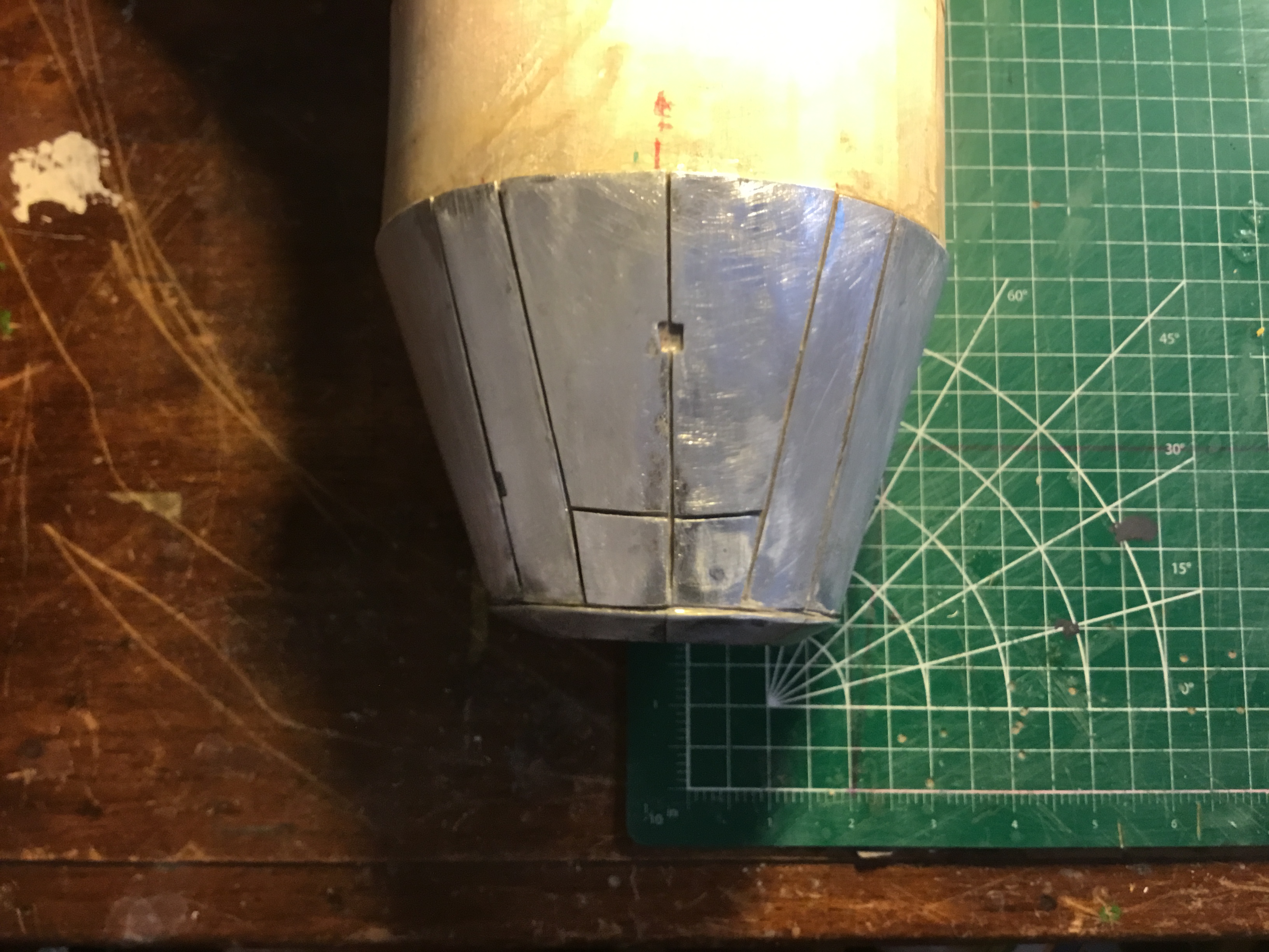

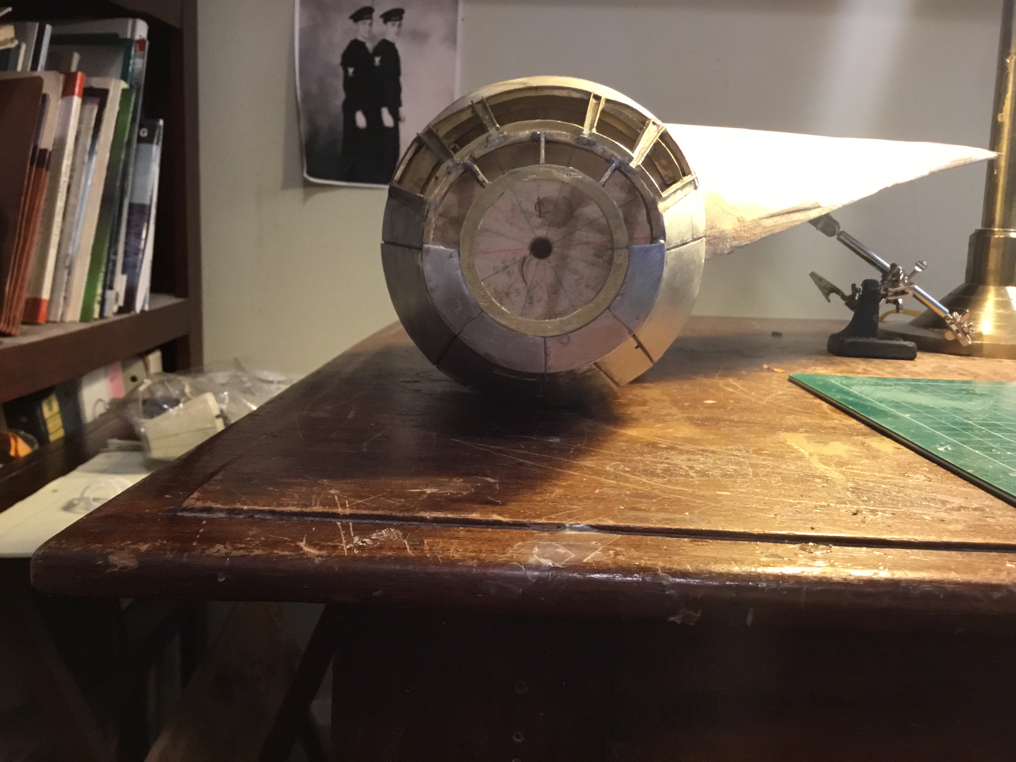

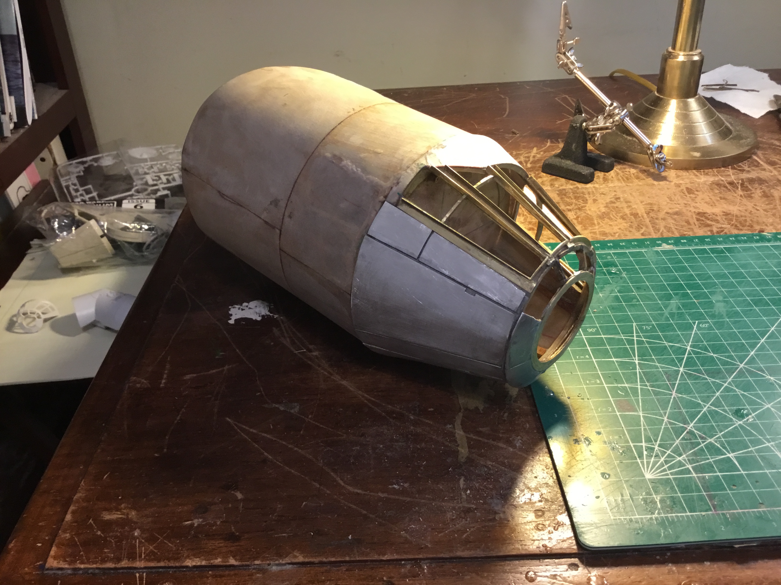

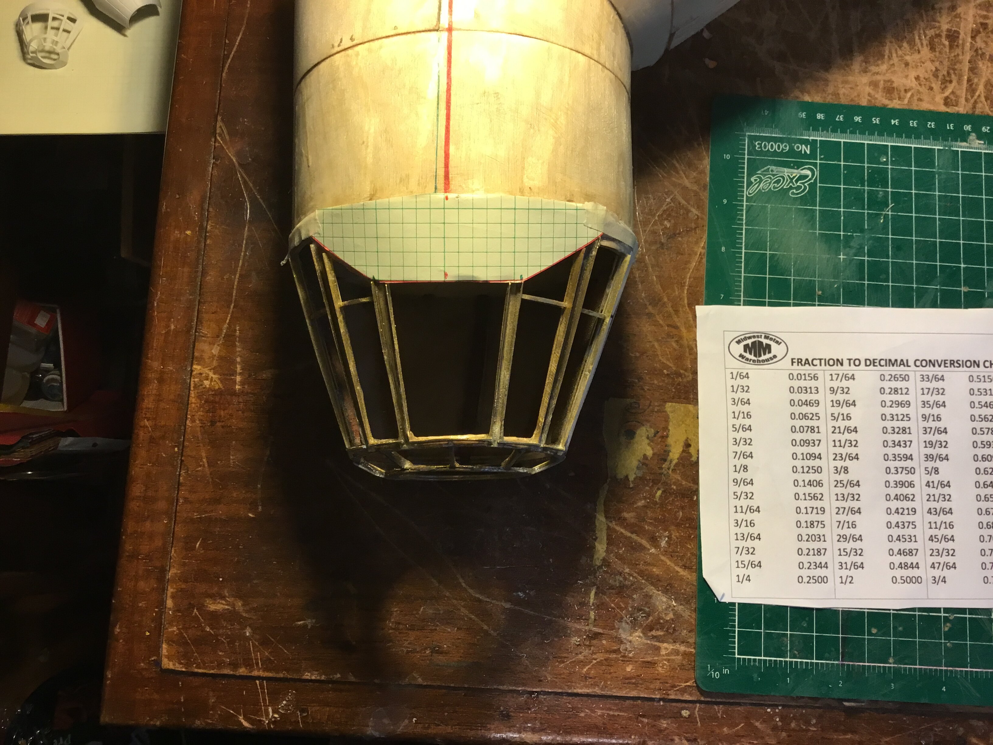

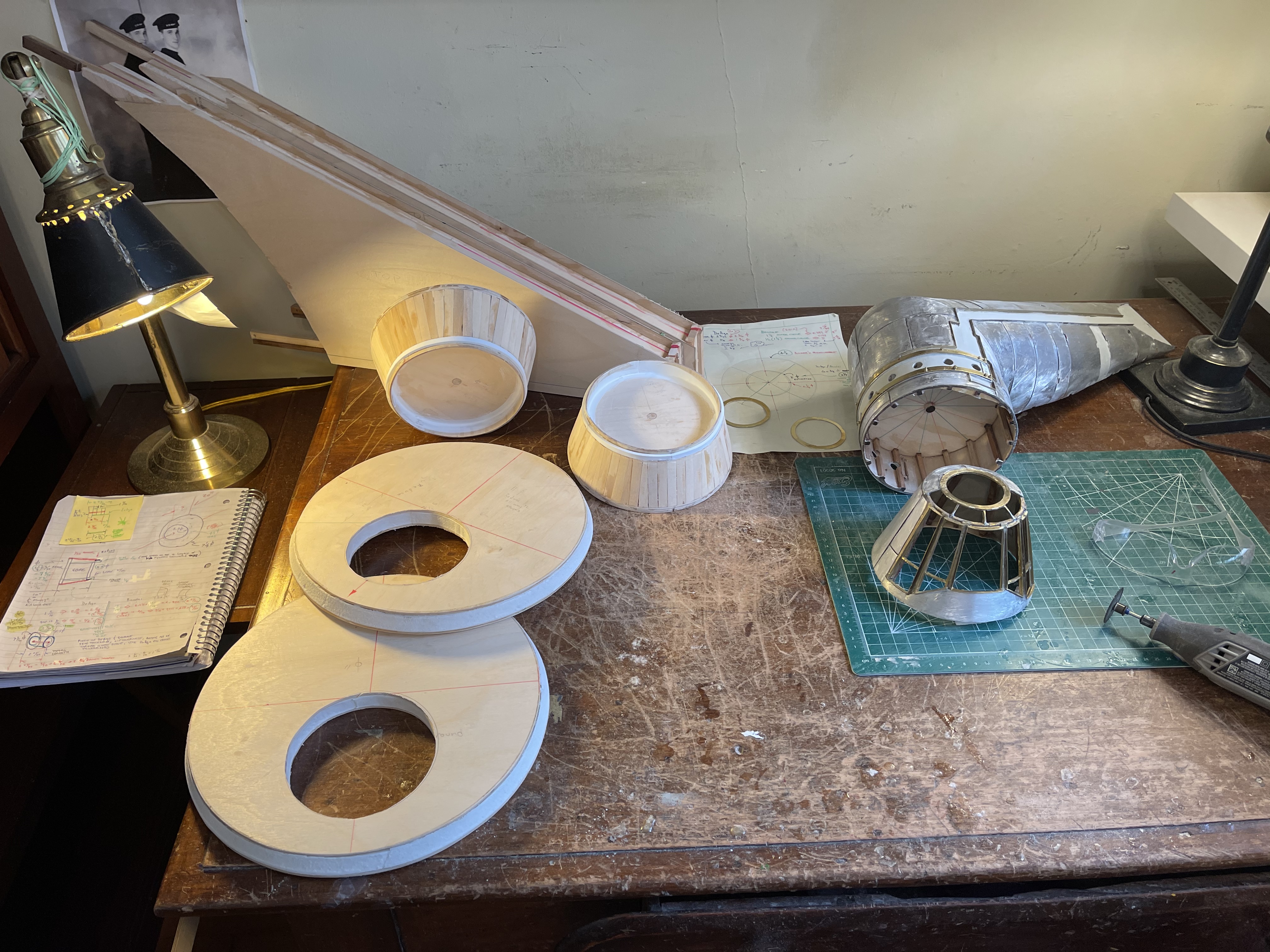

Took a break from initial skinning of the disc & mandibles. Can understand why the veterans on the 5 ft. model prefer blown plexiglass saucers. Attached some “raw construction“ of the cockpit cone.
Changed out the wooden mock-up widow frames to brass and wanted to see how my .032 aluminum armor technique will work out. Using ratio method from the Bandai model to determine segment dimensions. Note the picture of the engineering paper used as a pattern for the cockpit skull cap. May need to take a 3D printing class since I can clearly appreciate how the computer calculates the little squares to get the curved measurements. If your measurements are “wonky” just a little, the squares tell you.
Not sure this model will qualify as a 5 ft. Studio Scale ANH MF given my approach to the project. But, it’s design is worth the effort and I enjoy the challenge. If any of you know a good number for the width of the channel that runs down the centerline of the cockpit and cone body, it will help when I get to the armor platting in that area so that sufficient space is provided for greeblie detail in this long run. Many measurements I can ratio or estimate along with this site’s threads, but under estimating this, by trusting Bandai and my math, is too risky. Again, I know that kit parts & 3D greeblies are required for fidelity. However, my major goal is airframe accuracy.

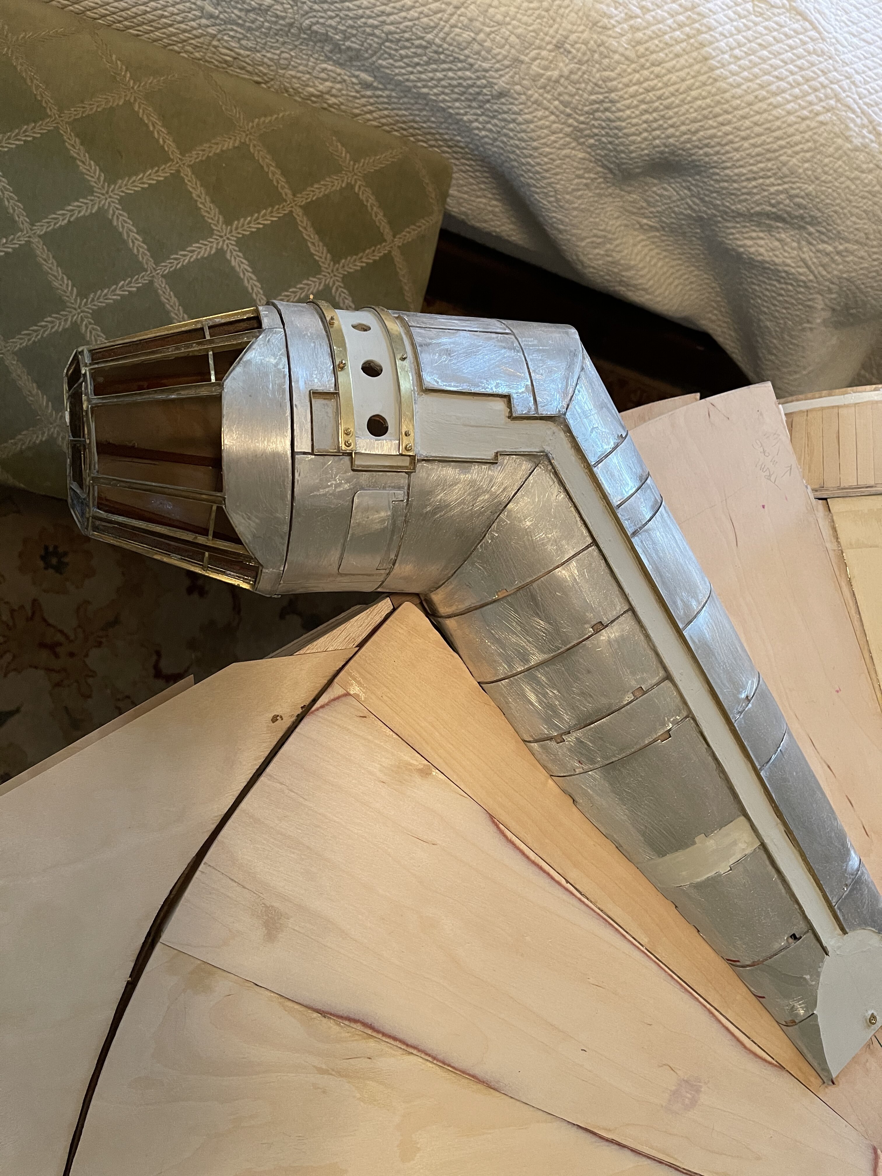

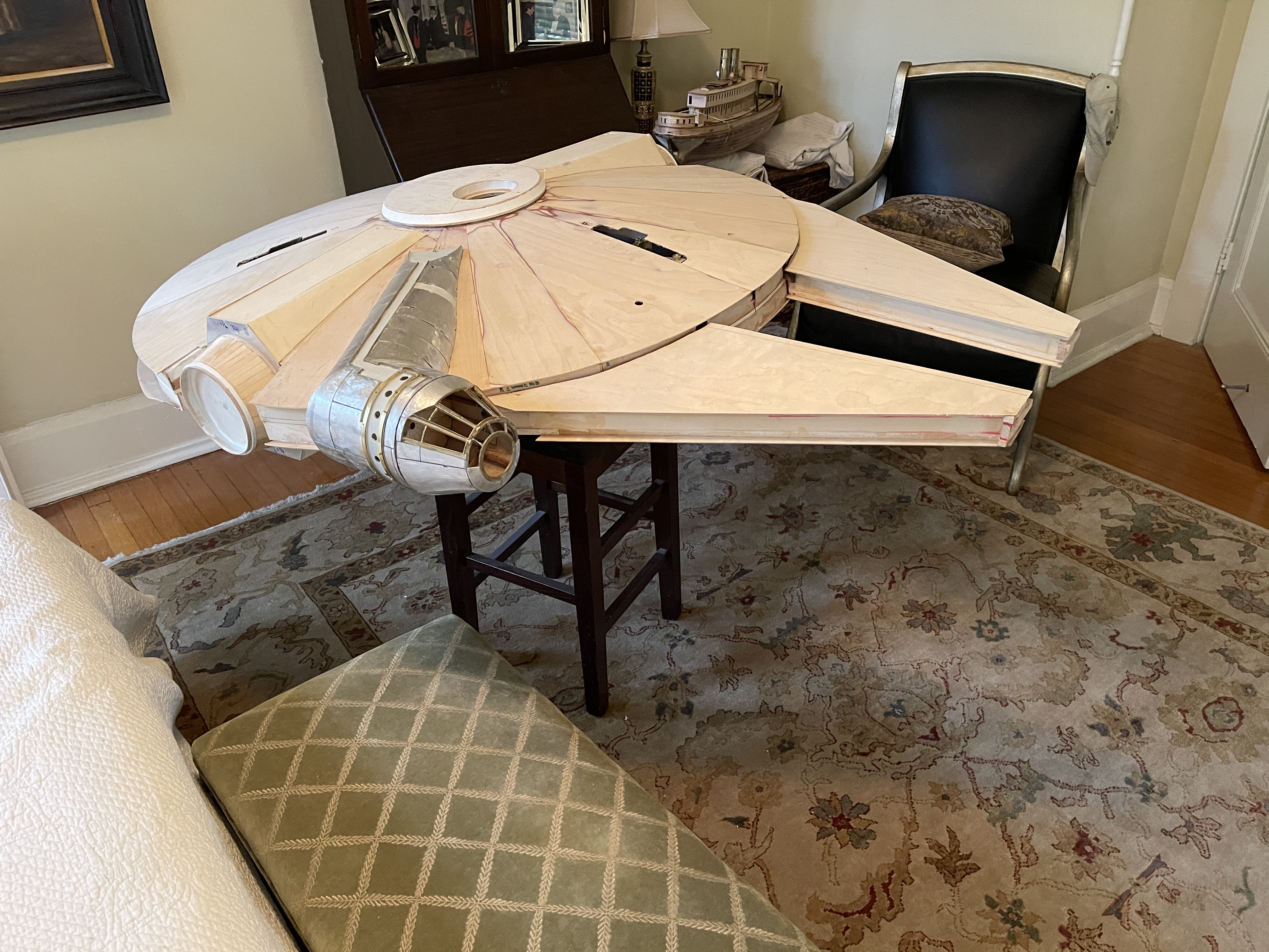

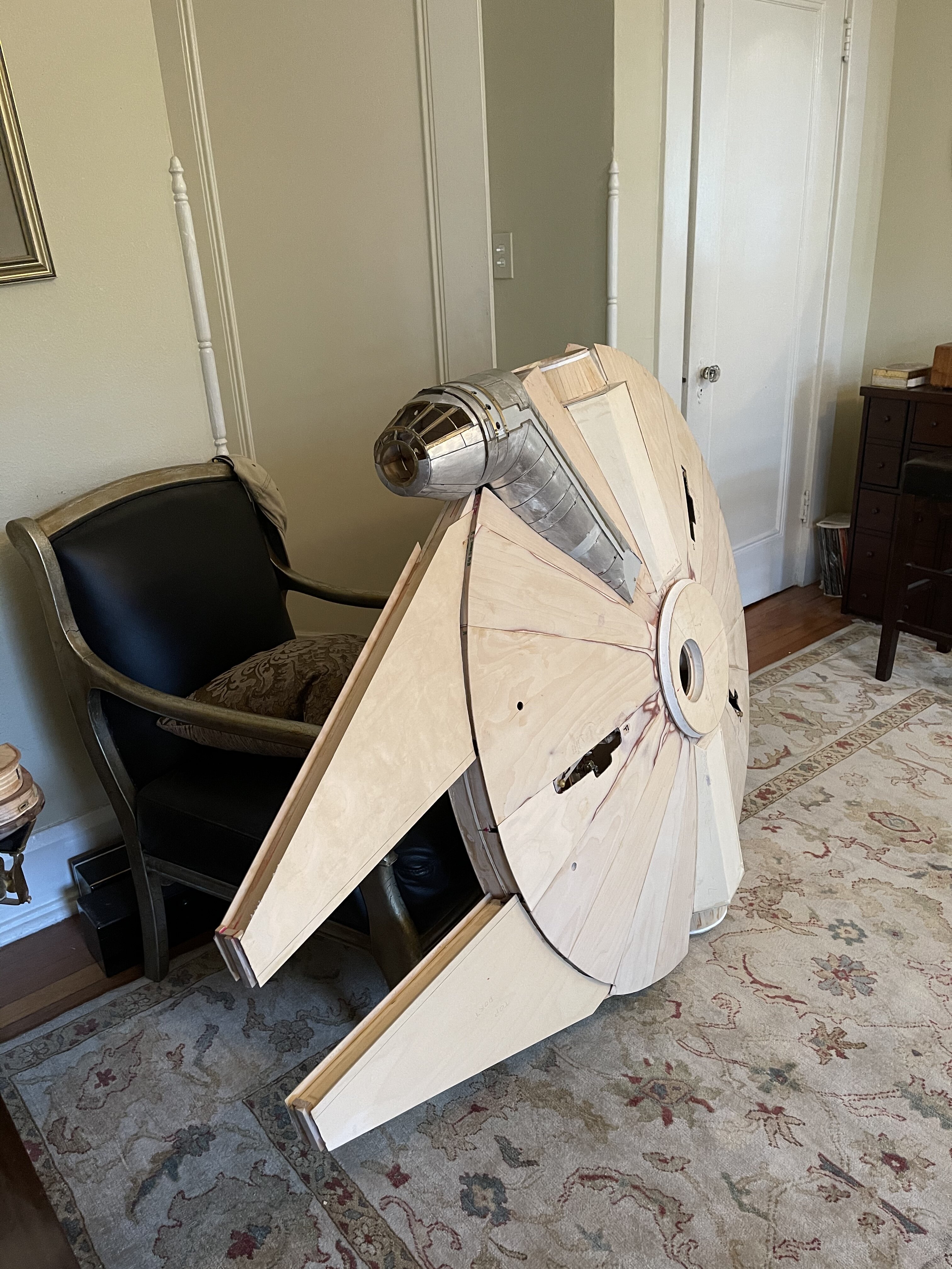

Attached are a few pictures if I have taken and transferred these correctly on my I-Phone since I-Pad is down. Bottom now skinned, Air Lock hubs & passage ways fabricated (ramp to be cut out later). Took some time off on major airframe construction to complete applying armor segments on cockpit tube. Gave the cockpit cone a labotomy when done in order to access interior later for detailing and to permit turning for “Sun Fish” orientation when not sitting on its landing gear. Slots on top of disk are to allow access to retractable landing gear thrust blocks. That way the motor & strut internals can be readily removed from wheel well elevator shaft below for maintenance and adjustment. Removable Jaw Box and Engine Deck sections will cover these skin slots.
My gratitude, again, to the team that put together and open sourced the overall dimension drawings on this site. While one must research and answer many of his own measurement questions, if you watch your material of construction measurements and account for thickness properly, the drawing accuracy is extremely accurate. Parts alignment during assembly validates the care these folks took in obtaining accurate dimensions, sketching, drafting and they must have repeatedly checked their work.
