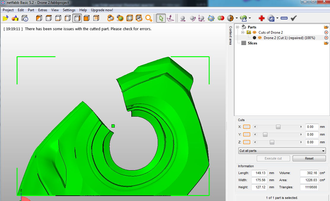

Sure thing. Let's take this Ultron drone head I'm working on printing. I'm printing it in about 9 parts and here's how I did the face.
While this model could theoretically fit inside of my printer's volume, I don't want to print it as-is because there is some severe overhangs in the bottom of the mouth. You could print with supports, but I try to avoid printing with them whenever possible - especially if I would be supporting from 2 points on the model (as opposed to supporting from the print bed).
The first cut I made was along the inside of the mouth. I want to cut anywhere there is an overhang greater than 45 degrees, and the upper part of the mouth is within that. I chopped the face from the rest of the head where I did with the orientation of the mouth overhangs in mind.
You repeat the same idea for the lower part of the mouth. The middle section will print flat along the original cut like the upper part of the face, but we need to cut the jaw so that the lower lip is under our 45 degree angle.
So now my object is 3 prints instead of 1, but I know that all 3 will have the best results and won't have ugly or misshapen overhangs.
All you are doing is rotating the model to find a good orientation, and slicing the model along that plane. Here I'm using Netfabb because it's quick and easy and I don't need to make any super complex cuts. You can use pretty much any modeling suite, and for something complex I might chop up the model while I'm building it.
