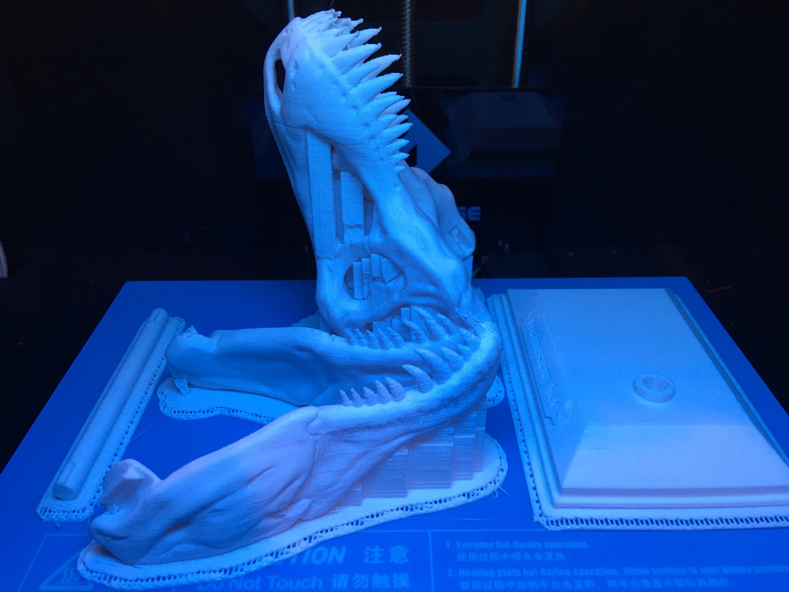

I have a 2015 model Flashforge Creator Pro that has been excellent. I crossed the 450 hour mark today with zero maintenance, which I imagine to be normal as my boss and coworker also purchased one and their printers are running strong as well.
Here are some prints, some with post processing. At 0.1mm layer height the lines almost vanish.
I'm not affiliated with flashforge, just a happy customer.
Also, I would budget in a good slicer as well, it really can make a difference. All of these prints were sliced with Simplify3D which runs an additional $150.

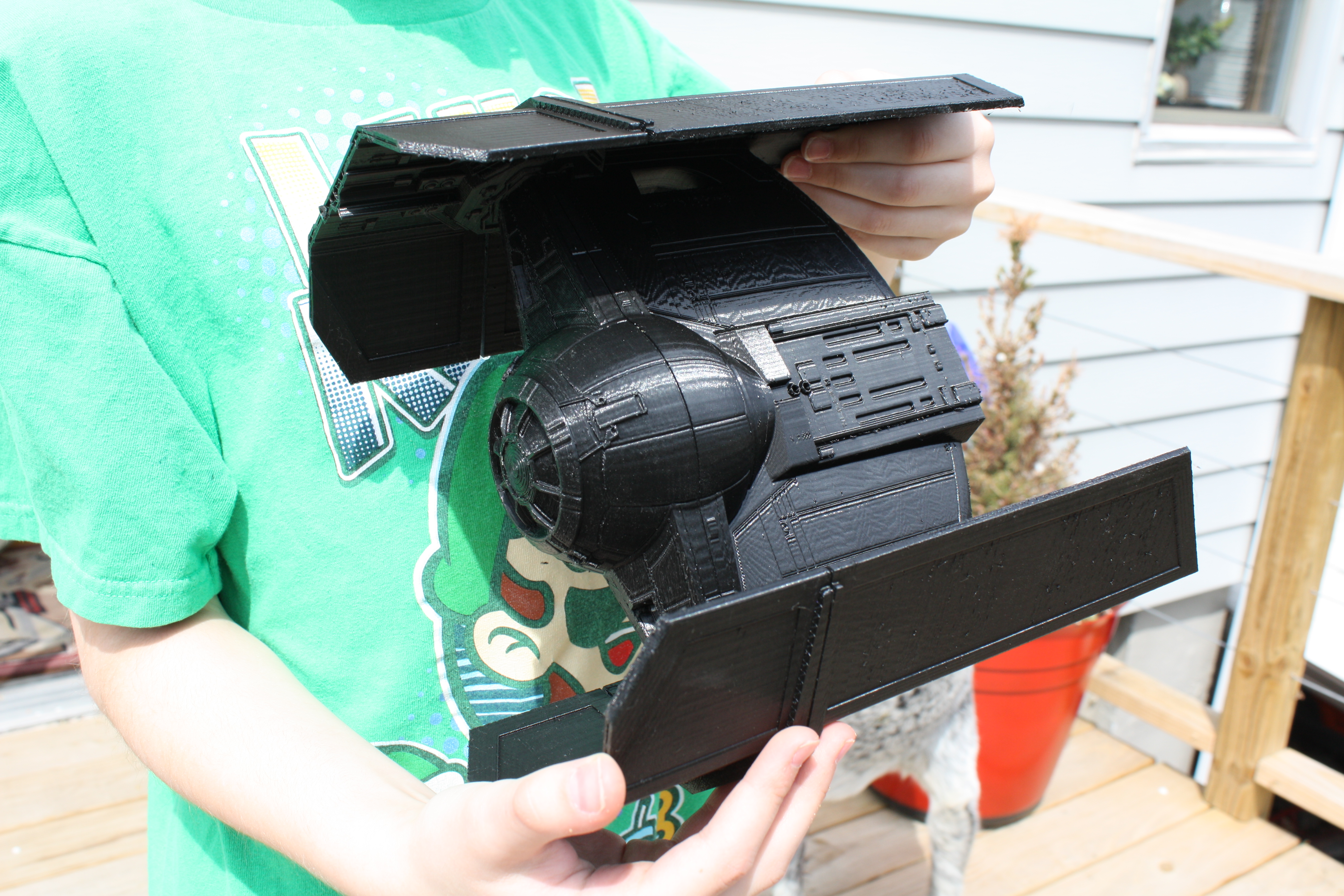

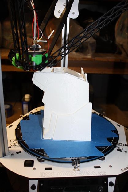

I have owned a Rostock Max V3 by SeeMeCNC and the printer is excellent! It is a kit so there will be assembly but me and my 12 year old son put it together in 2 weekends. I has a large capacity and very good accuracy. All printed on my Rostock MAX...
10373141_771346652884353_3893146149753893082_o.jpg10255664_755161971169488_5244330697358540985_n.jpg10250198_755457241139961_6069401097343316510_n.jpg10436329_771346722884346_1069259369248824314_n.jpgIMG_2932.JPG[/h]
