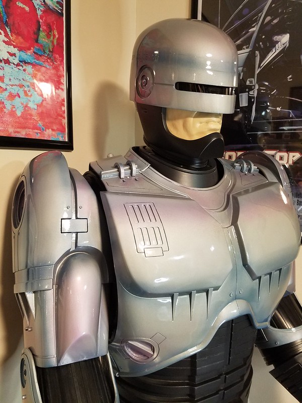

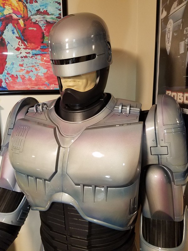

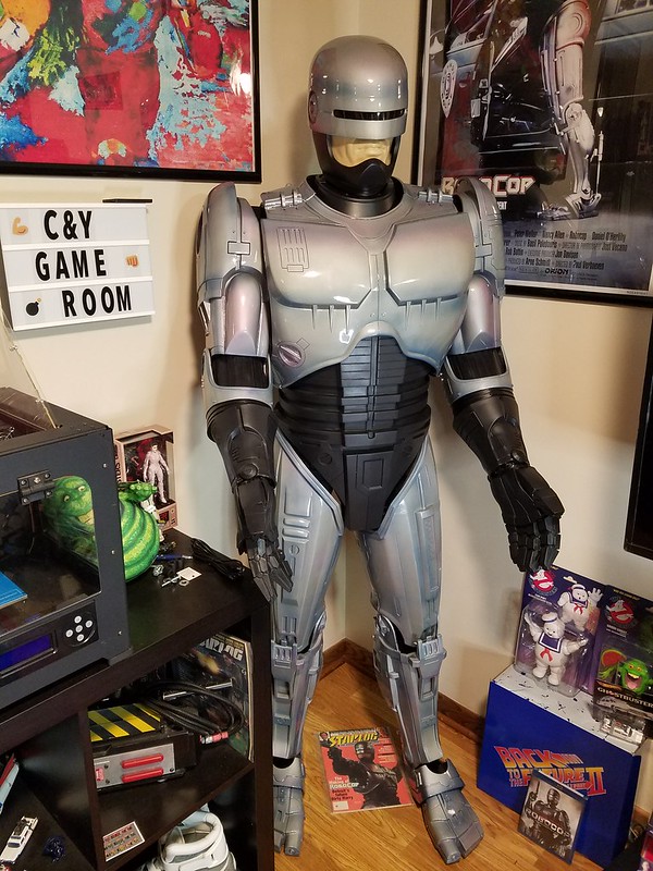

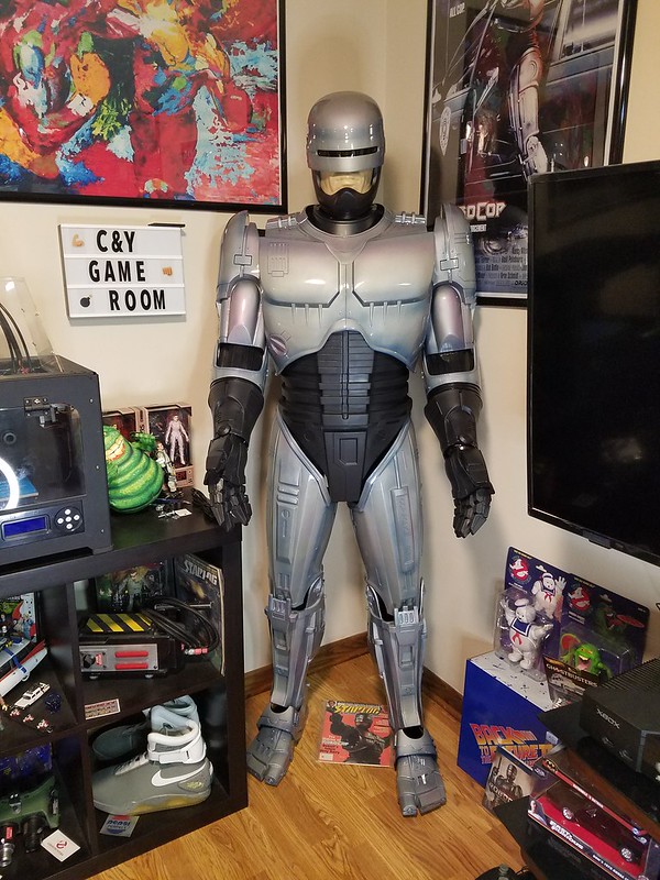

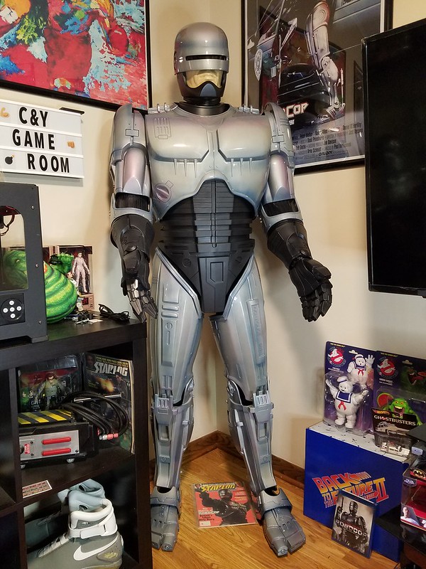

3D printed Robocop Suit V.2020 Build- OCP Visit - Project Complete
Incredible job, makes me want to get off my arse and keep going on mine
Thank you Dave. Trust me I know what you mean. It took a lot for me many a day to get out in the garage and do anything....I would literally have to force myself especially when you put hours in and it seems like you got nowhere but believe it that the work does add up eventually. Now that it's mostly over it's a huge relief and joy to be done with it. I wish you well and hope you get going on it!

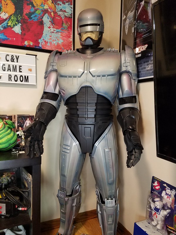

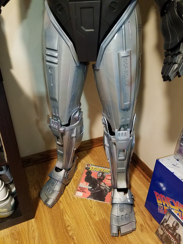

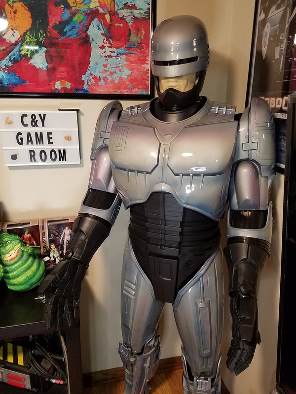

Some higher res photos of the finished product.....

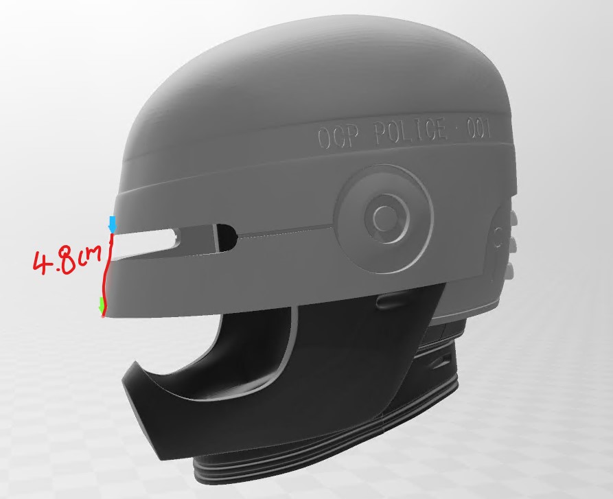

Hi Chris,
Suit looks really awesome. I'm about to start printing my suit starting with the helmet. The default size is ok and is maybe slightly bigger than my head which shouldn't be an issue. The problem I've got is the distance between the bottom of the helmet and top of the visor, i.e.
If I measure my own head from top of my eyes down to end of my nose it's around 6-7cm. I can't resize the helmet as then it will be too big. So question I've got is what is the visibility like with your helmet? Like can you see out of the visor or is it too low down? I'd rather not spend 2 days printing it to find it doesn't fit, i.e. I can't see out of it.
Many Thanks!
Alex

Hey Alex I kind of had the same issue where the visor hung a little low on my head there is actually a video on my YouTube channel where there is a thumbnail of me holding the helmet up with my hand so I can see out of the visor. To correct the issue you'll have to put some Eva foam for padding inside to help balance out the spots you need. Pretty easy and once you do that visibility is fine. Hope that helps.
