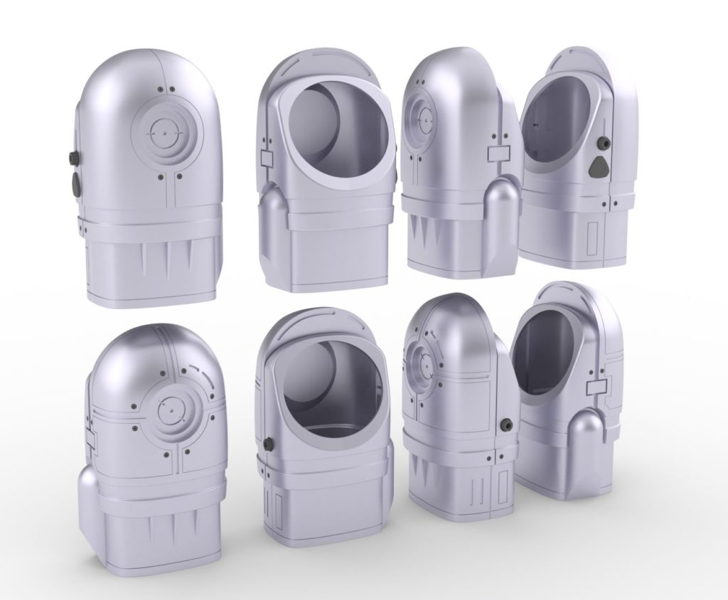

How are the legs on this? especially the knee joints, as they needed quite the rebuild to be wearable.
I've started modelling parts that were too inaccurate in 3d, but seeing this, I'm going to shell out for this model as well.
Unfortunately, I've already printed at least one of everything needed in the old suit, but I think this would seriously cut down on rebuild time in order to make it actually wearable!
Thanks for both your old build and this one. You inspired me to make my own a few years back! =)
(Here's a render of the biceps piece I modelled, btw)
Those biceps look great man. Yeah I completely understand your pain. The Do3D suit although great at the time was just far too much work to get half decent and more accurate especially the knee joints like you said which I completely cut up and re-sculpted. I spent more time modifying parts and rebuilding then anything else. The parts on this new suit are far superior and I really haven't had to modify anything at this point. There are a few small tidbits I'm going to rework but they are really nothing in comparison.
