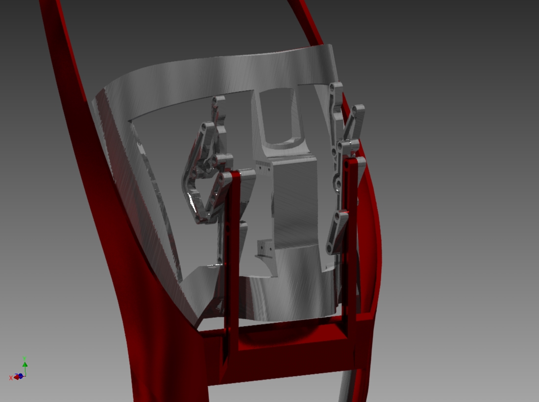

And, I use Autodesk Inventor, which is virtually identical to SolidWorks. I sat down for a weekend about 8 months back and taught myself how to use it. It's become my most valuable tool yet, I think. The technique for making the helmet is adding a front and side view of the helmet into the software. Then, map out all of the necessary points with a 3D sketch. Change the view point so that the points line up with both the front and side images. Then, connect the points with lines/splines/arcs, and then create surfaces from the curves. It takes some finessing to get it just right, but that's what it took to make mine. Then I had to separate the pieces so that I could make the base of the skull rotate up inside the helmet - again, lots of planning and tedious work, but it pays off! :)

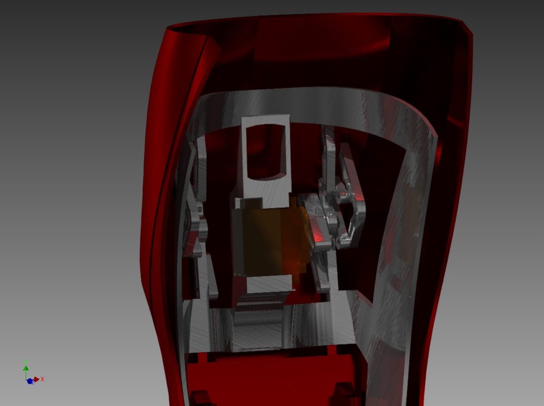

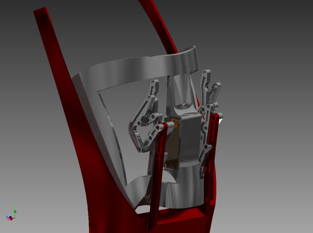

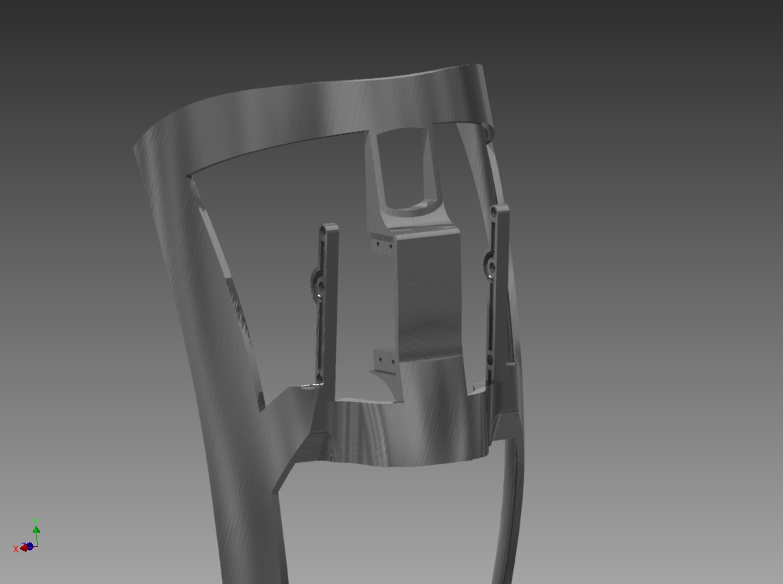

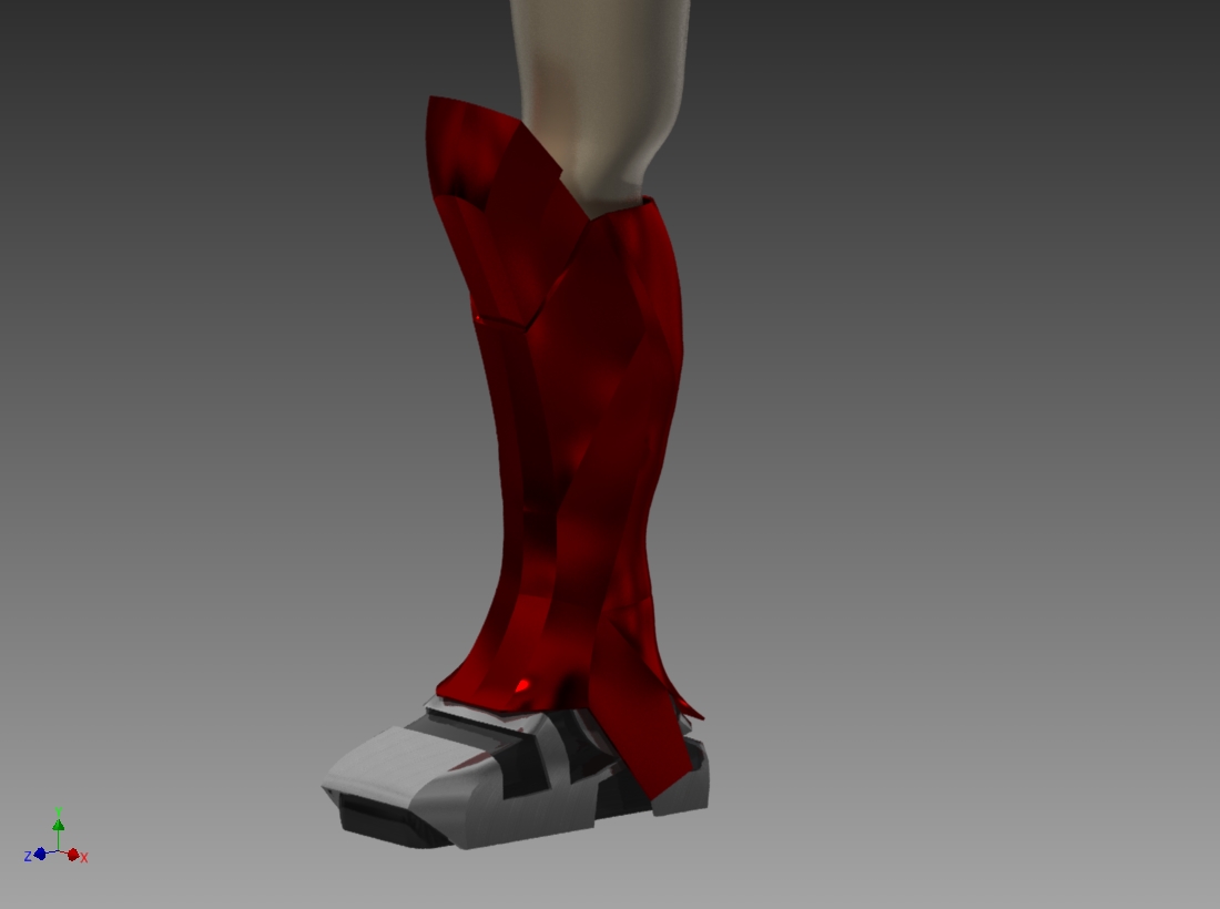

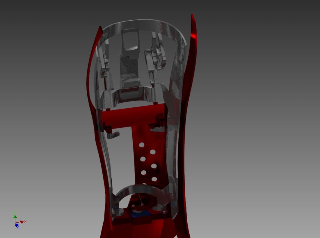

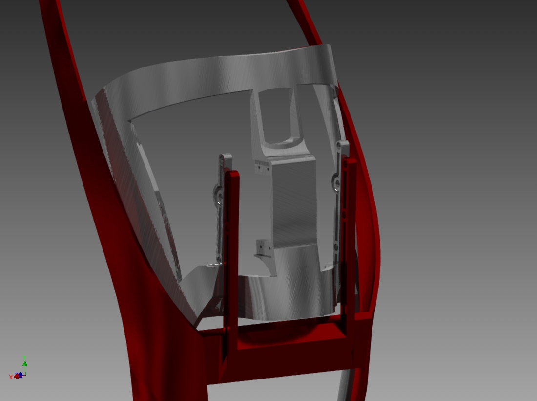

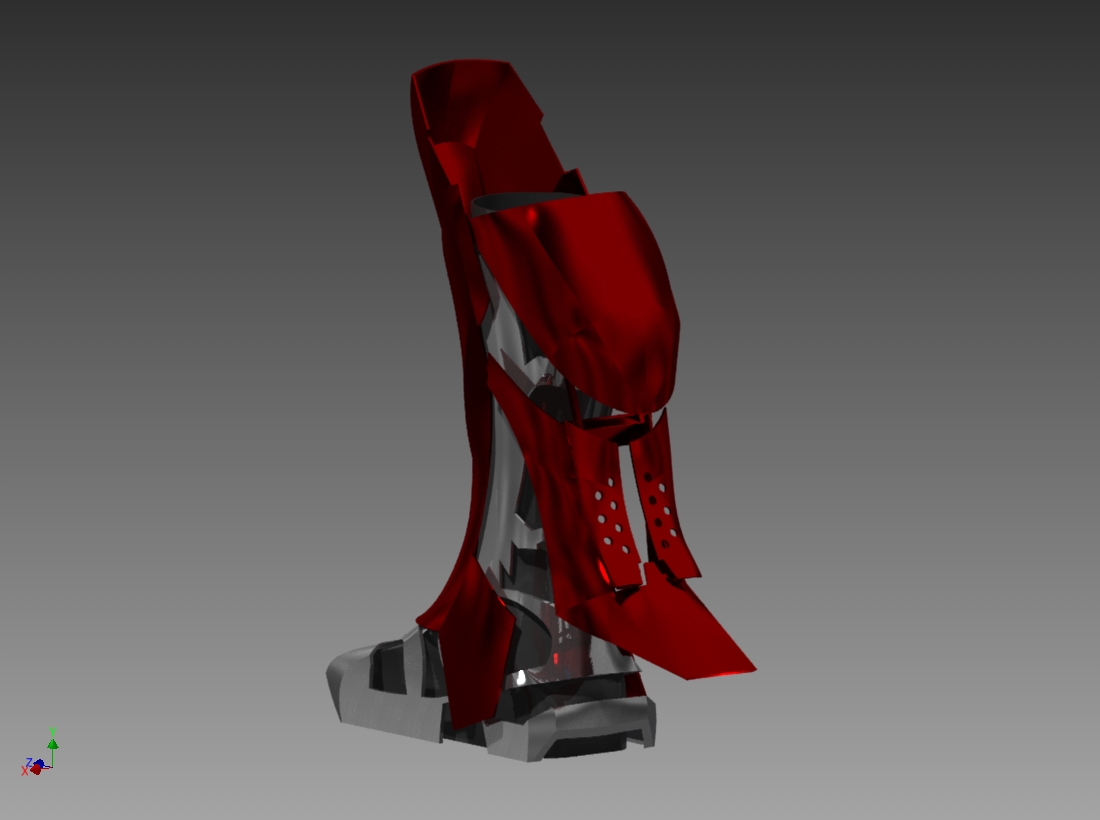

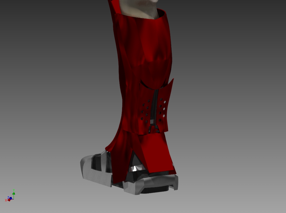

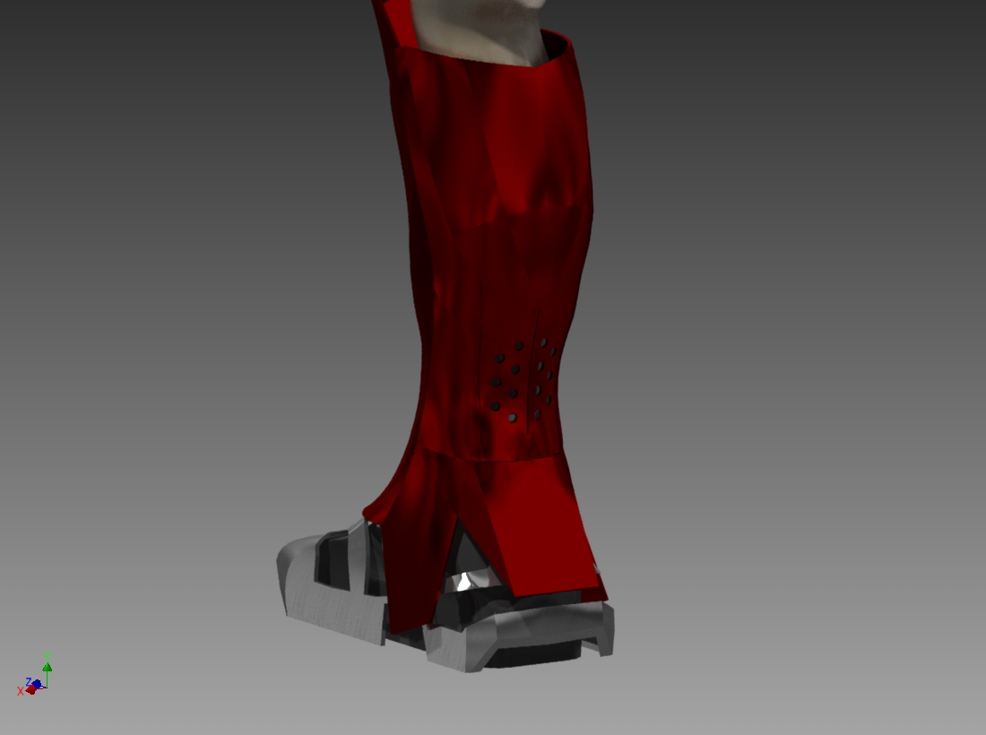

Here is the leg armor. This was the most complex portion of the suit, requiring a lot of pre-planning to ensure I can achieve all of the functionality intended.

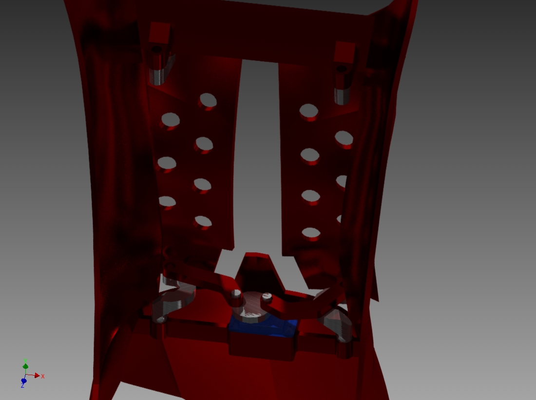

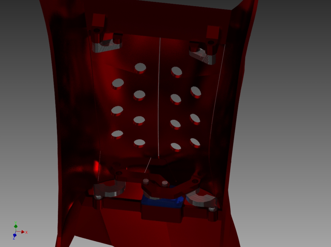

There are multiple moving parts contained within the tight space between my leg and the armor. If you watch the Mark II suit up scene, you'll notice a series of flaps moving on the back of the calf.
I designed a custom mechanism that would enable the flaps on my suit to mimic the motion seen in the movie. This required the armor to be able to separate from the endotech underneath, and the mechanism that opens the "vent doors" to be contained on the armor piece that moves away from the endotech. So, it was a challenge.
I have managed to pull it off though, and the only things I still need to do are make the toe-section of the boot pivot, add the boot armor, and then enable the back half of the boot to clamp around my leg once I step into it.
Progress continues!
