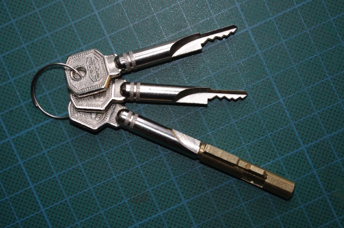

Here is my spare key:
2001-memory-deactivation-key-hal-9000-space-odyssey-2001_key.jpg-85743d1330554143

For anyone else wanting to make one of these themselves - a quick look on Ebay Germany reveals these keys are still readily available. The German for key is Schlüssel; look in the Heimwerker section (there are other places but this is the easiest) and the maker's name is Burg Wächter. There are a number of variations with different knurling (some of which have longer shafts than the example AP333 has found). Here's what I just got:
Note this set includes the distinctively-shaped lock part. Price was Euro16 plus postage. I just went straight to Germany because I saw AP333 was German so assumed that would be the best place to look - thinking the keys might be old and rare. This particular key is a type E7/3, so perhaps if you try your local locksmith first you might save on postage from Germany.
