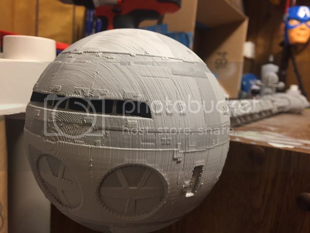

Here's one for now. I should have at least a few more later today.
I'm having a bit of trouble being able to tell which panels are different colors of gray. Im going to do the best I can, but I may end up having to take some artistic liberty.

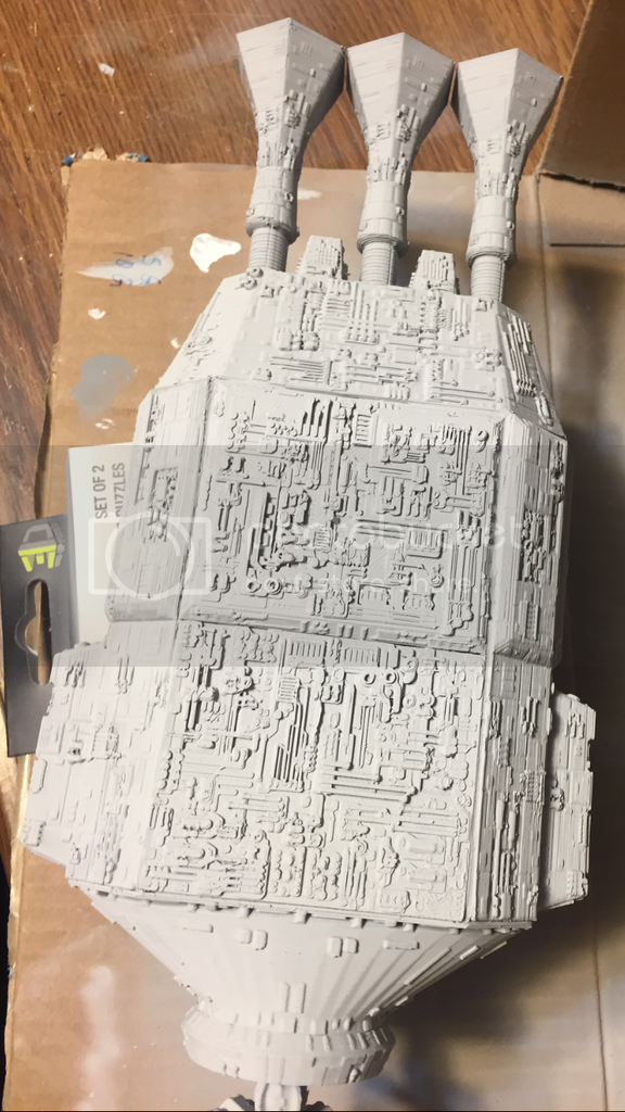

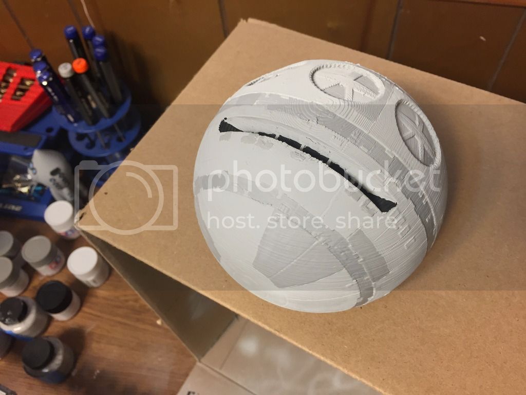

I started to do the detail work on the control module. I'm trying to decide how I want to go about the slightly different color panels on it. Screenshots from the film are a bit hard to decipher as the colors are all so similar, and models of it show panels that aren't present in the 3D files...ones that are very small.
The finished model from from the guy who made the 3D files only has the four "lines" across the control module painted differently, and I think it looks pretty good like that.
I'll be finishing up those lines tonight while I try to decide on the panels.
So I did some of the detail painting today. I have decided that I probably will NOT be painting the individual panels on the ship. I will sacrifice some accuracy for this, but basically in several spots due to the way the pieces print it's pretty difficult to tell exactly WHERE the panel lines would be. It's the nature of the beast, and part of what I accepted when I set out on this build. That said, I think it will still ultimately look very good.

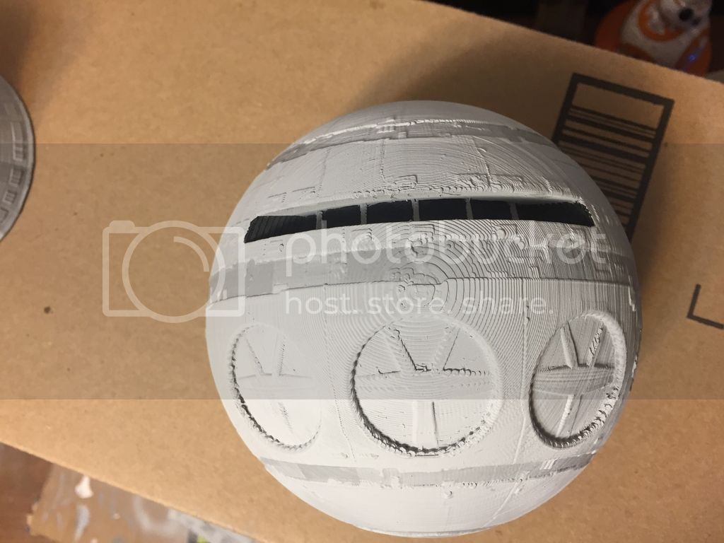

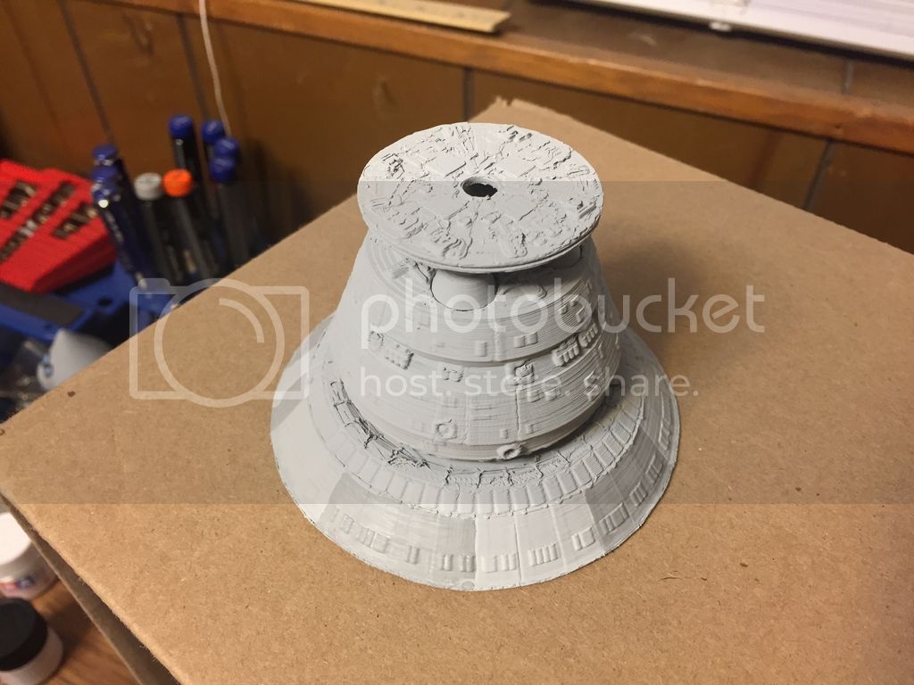

Here is the collar with the first bit of detail painting done to it. The color differences are very subtle, so it's kind of hard to tell in this photo...but the panels on the very bottom edge are different shades now. I utilized a few images that I found that were good of ONE SIDE of the ship, and just kind of carried the overall design around the entire piece...so again, it might not be entirely screen accurate, but it will be a good representation of what the vessel looked like.

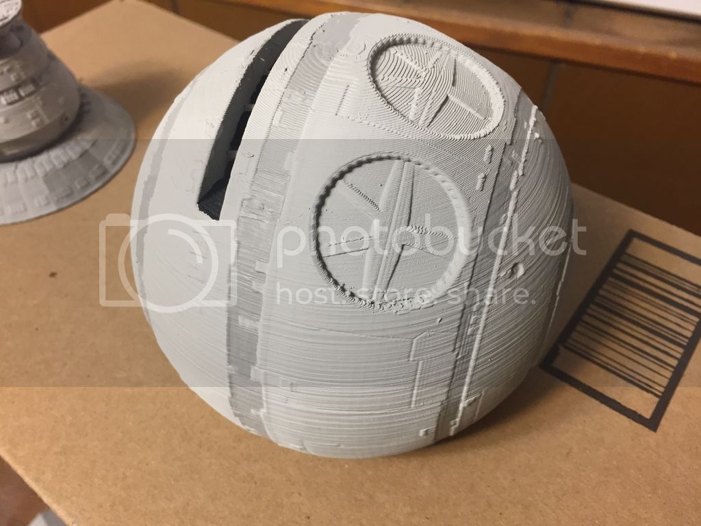

Here is the front of the control module. You can see the differences in the shades a bit more easily in this photo. There is the main color of the body, 3:1 white:gray, the slightly darker which is 1:1, and the even darker which is 2:1 gray:white. You can also see that I did the windscreens. I did these 2:1 black to gray.

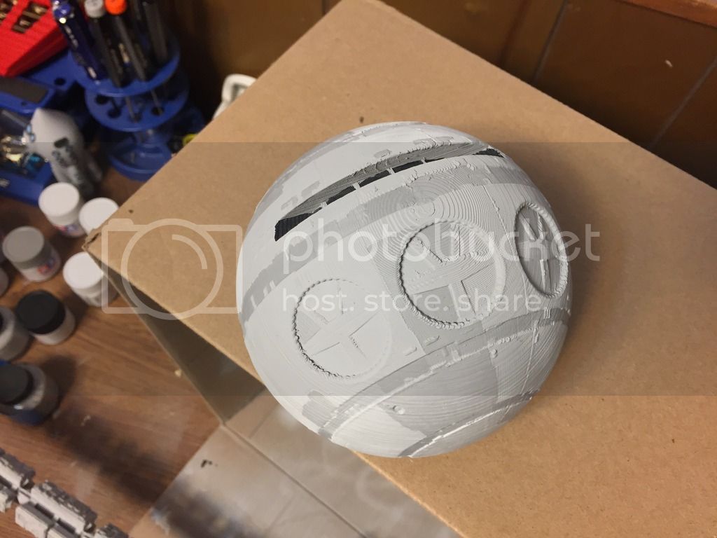

Here is another view of the control module. You can see the shades in this one as well.
So, I have a few things left to do. I'm going to do some more along those darker lines on the control module with even darker gray...just a few very small pieces. I will probably do those at 3:1 gray:white. I also will be doing some lighter panels on the collar...I used the 2:1 gray:white on that, and I'll do a couple of panels with the 1:1 gray:white.

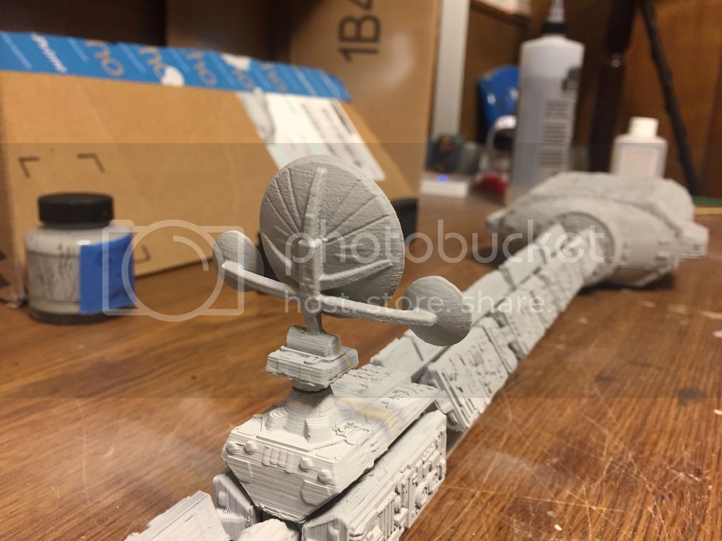

I attached the collar and the dish assembly last night.
I also touched up quite a bit on the control module. Tonight after work I hope to finish up the touchup work, then tomorrow I can mount the control module.
Dish assembly in place, facing the aft of the ship.
Control module in place.

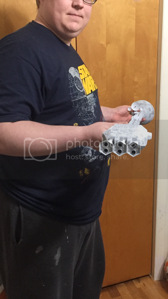

View from the front 3/4...
View from the rear 3/4...

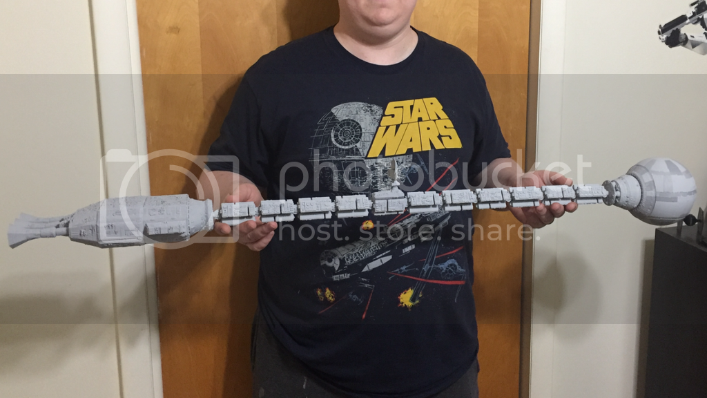

View showing the overall length...
It is pretty much done now. I will probably seal it with some clear when I get a good few days of warmer weather, and I'll be getting started on the display case/stand/box soon. I need to get it hung up, though, because right now I'm extremely nervous that I'm going to manage to damage it.
It's been a very fun build...there are, as I expected, a few parts of it that aren't exactly ideal...but for it being a 3D printed model with no actual finishing done to it other than paint, I think it turned out very well. You can definitely tell what it is, which is the most important part I think.
