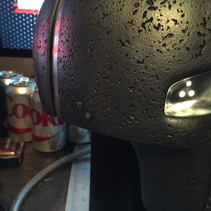

If any of you guys are still building up your 2-1B skulls, I had some great luck when it came to adding the silver band over the dome of the skull. I purchased a roll of 1/2 inch aluminum embossing tape from Amazon and it worked perfectly. I secured it by using some thin 3/4" (cut to fit) VHB tape I had laying around from my R2-D2 build.
You may be able to use a glue like E6000 but this stuff is quite thin and I was afraid any unevenness in the glue application might create some surface marks through the aluminum tape (It is designed for making embossed labels). I believe they do make a version of the aluminum tape that has an adhesive backing so you might be able to give that a try.
This stuff, at 1/2 inches wide, sat right down into the skulls groove with out any need to trim the tape's width. Like it was meant to fit in there.

Here is a quick pic.
Great Solution.
That's funny too, as I redid my alice band too recently. I HAD aluminum tape, but I got a piece of AL flashing and cut it about 1/2" wide and then used VHB tape also to adhere it down. It looks great! I need to take some more pics.
I also have some 5mm Nickle Silver disks coming that I was able to find for saleon Etsy that I might be able use to replace the pair of cast in greeblies on each side of the Skull. I don't have a manner to make my own so I though this was worth a try. I will let you all know if they work out.

I finally had a chance to get my disk greeblies mounted. I like how they turned out.
