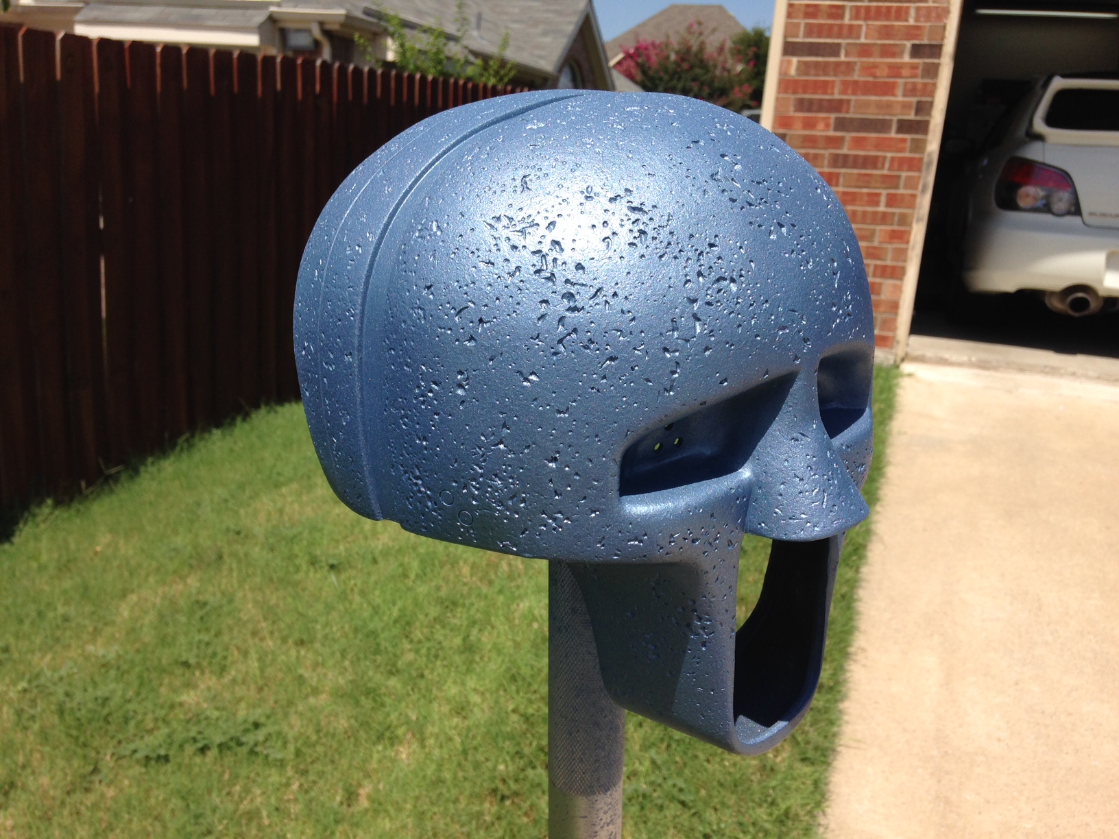

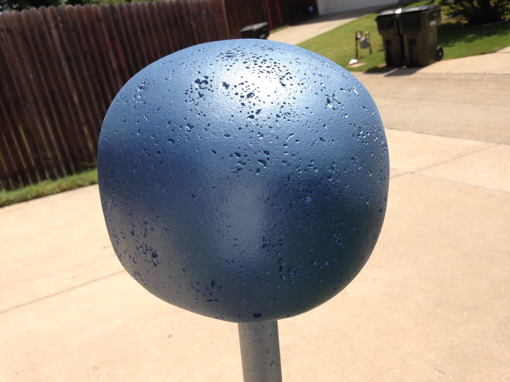

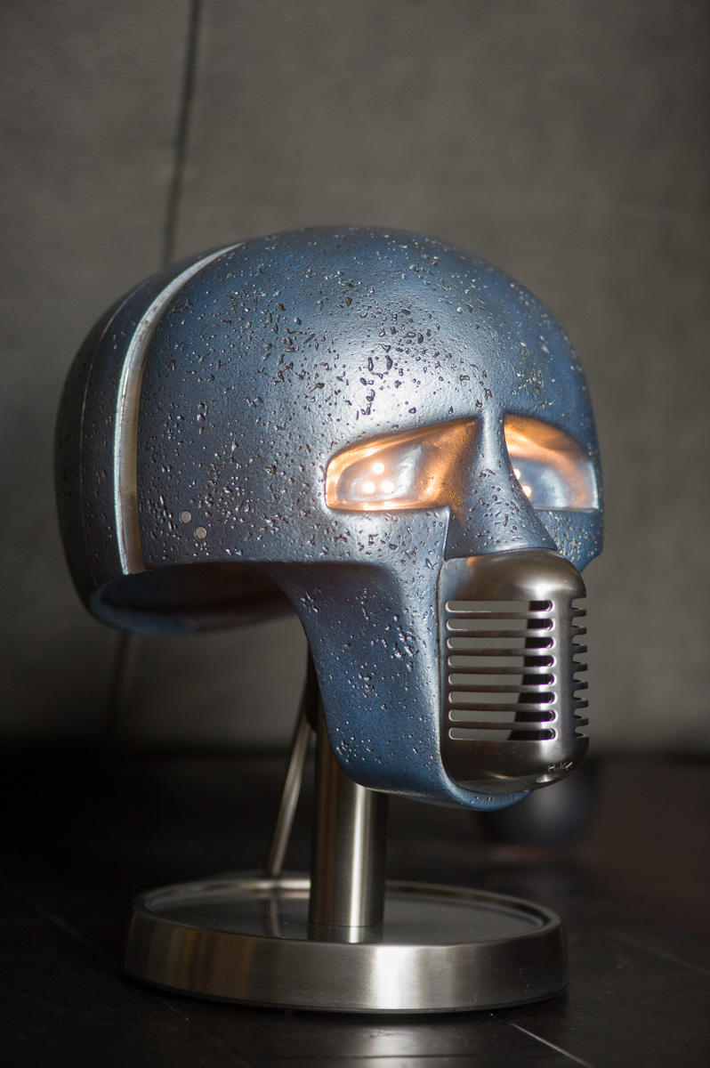

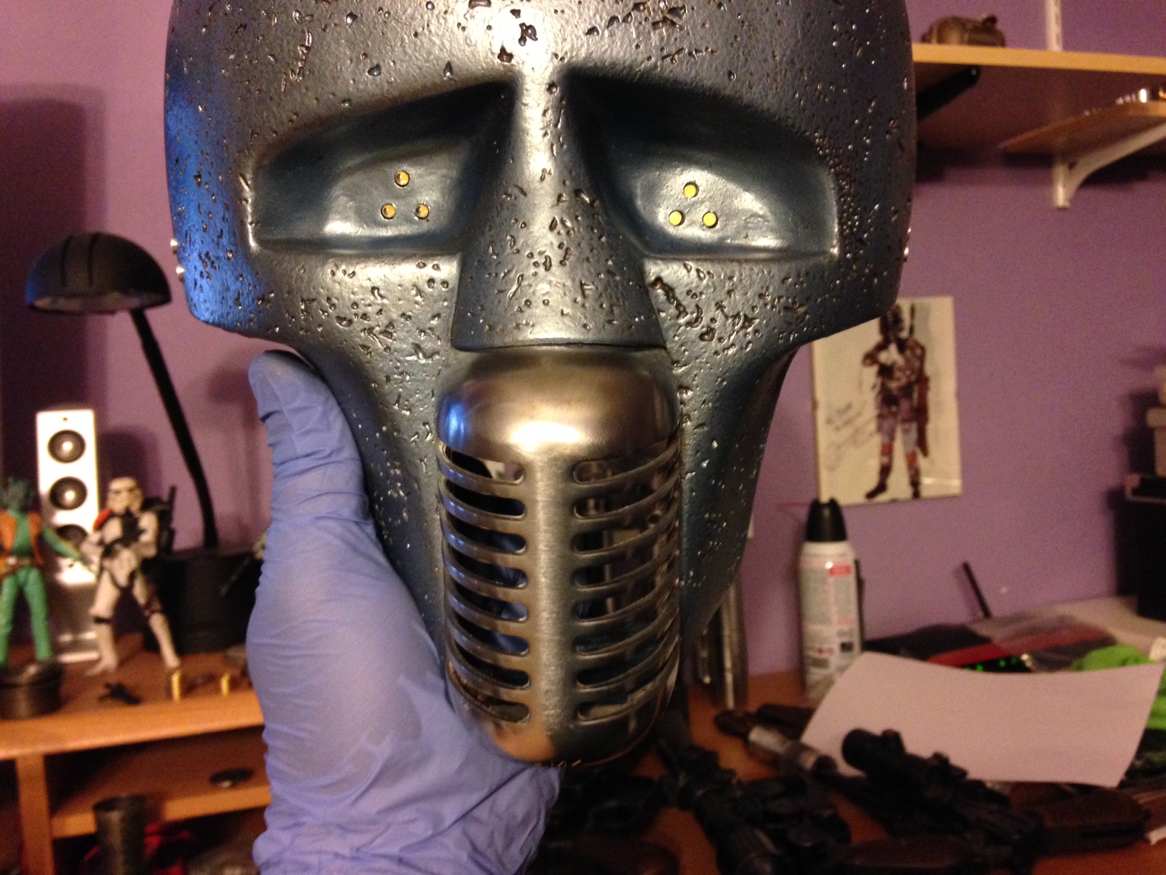

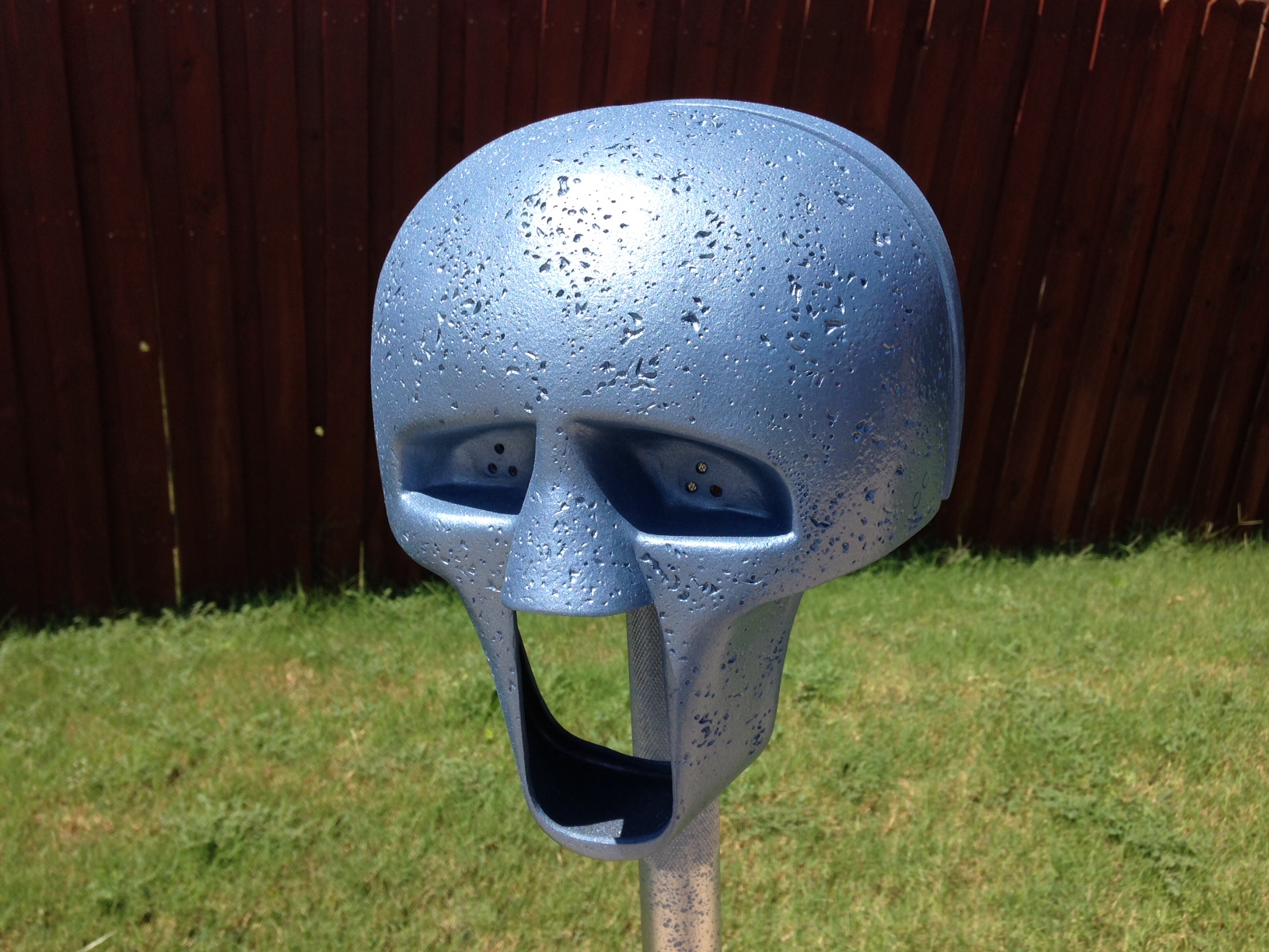

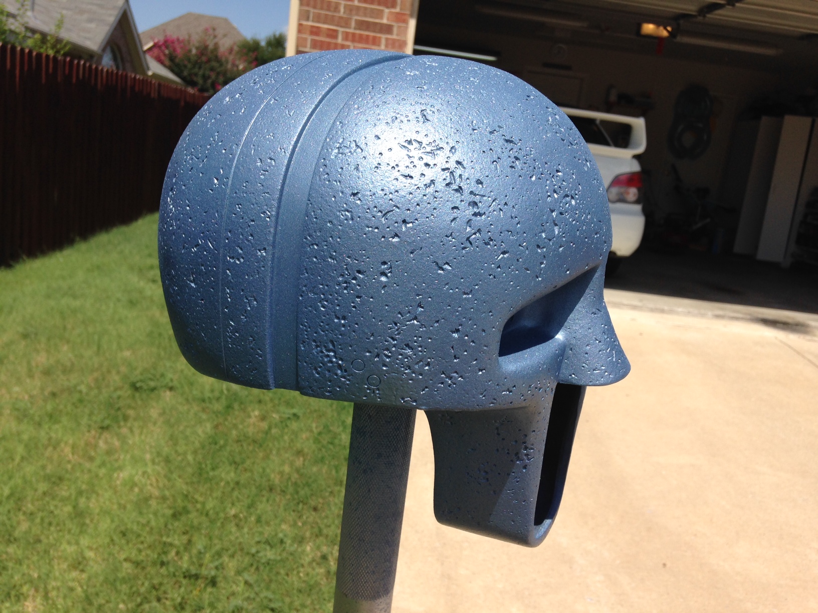

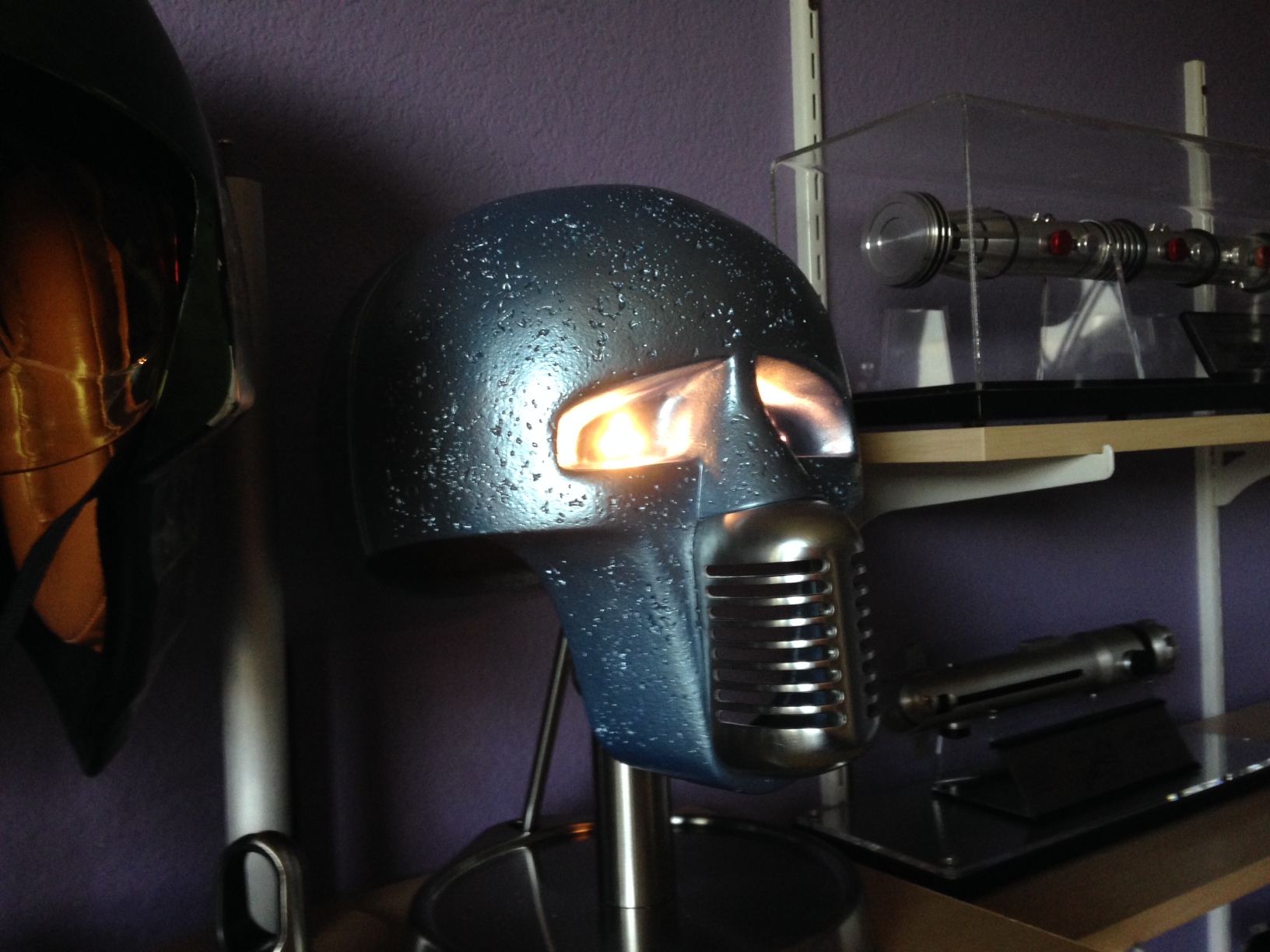

painted mine, cleaned inside edges, drilled, and wired mine today. I found two colors that can be found at O'Reileys or Autozone: Duplicolor Light Blue Metallic and Avondale Blue
These first are with mostly the base... and later pics after wiring for the final color. I think it's pretty close. ^_^

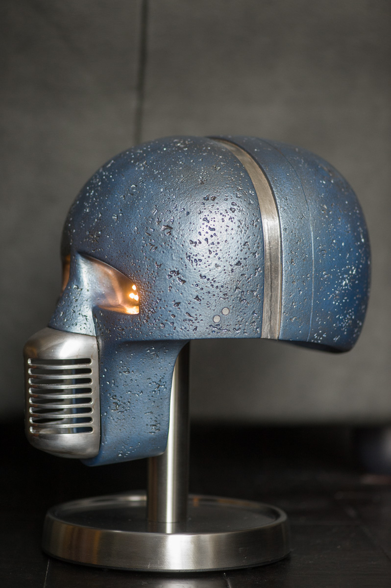

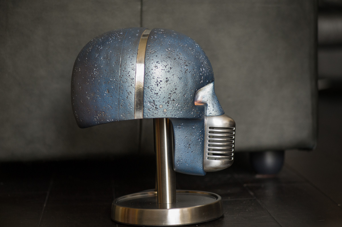

Not pictured is aluminum tape on the alice band, but I think I'm going to copy Dan and do a strip of thin AL stock instead. Also gonna machine the side dots tomorrow... and a dirt/weathering wash.
Then I'll tackle the tube and mic insides.
Also... tomorrow I'll take pics with something other than my phone..

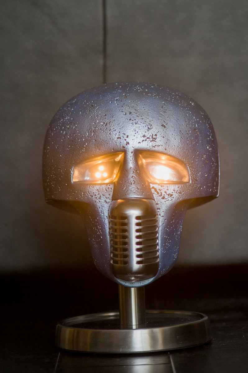

nice one scott, looks maybe a little too dark, how about a misting of silver? (nice scooby btw)
i could not find the shade of paint dan used at my local car place, all they have was a touch up brush thing.
you guys are making real neat jobs at cutting out those mics.
clinton, i used a dremel with a cutting disc for the majority of the mic removal. then a sanding drum attachment for closer in work, the thin areas around the nose was done by hand with sand paper. it needs a steady hand so probably best to go slow with the nose part. keep putting the real mic (if you have one) up to check progress. its easier to take away than add resin ;)

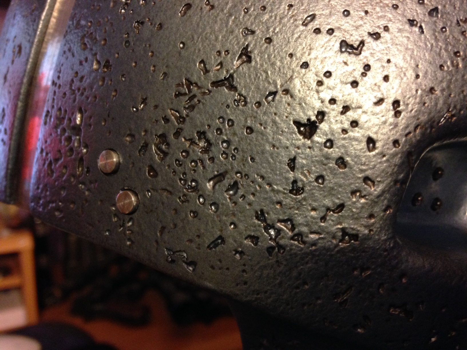

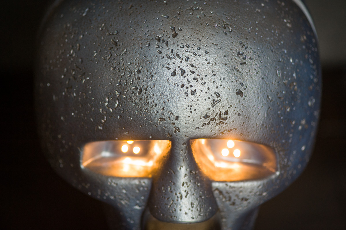

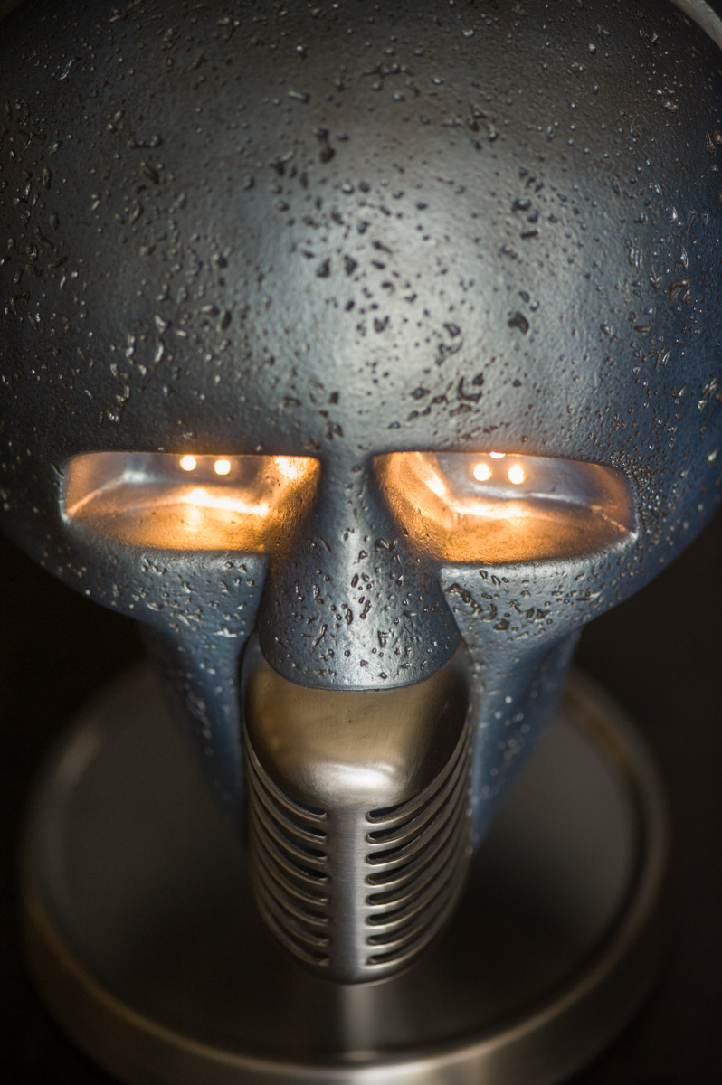

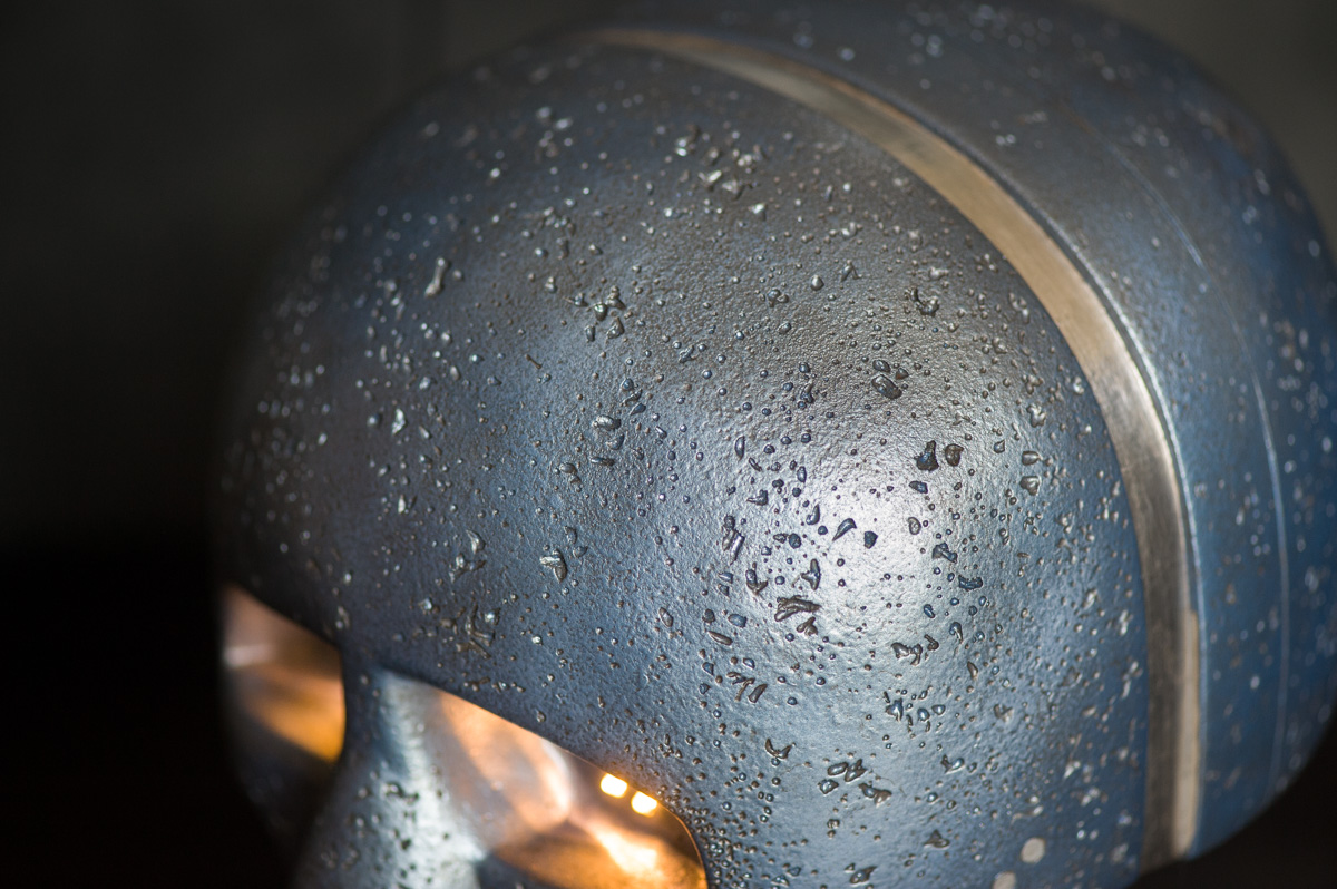

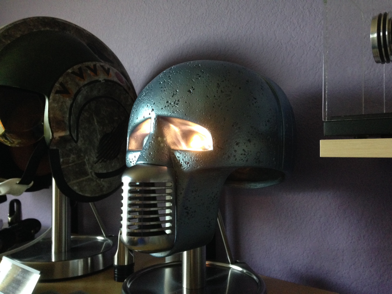

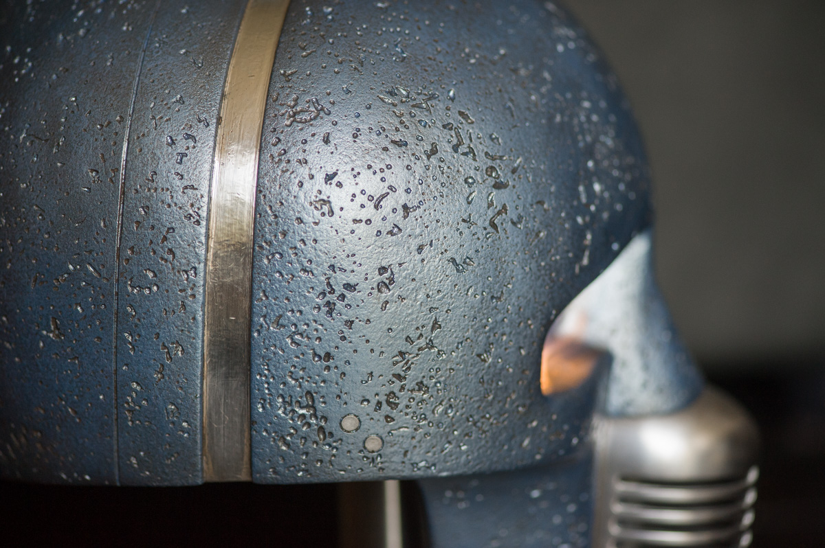

Thanks to Dan for the weathering/wash tips. I may have overdone it a bit and there's definitely some dirty droid action going on. But I like it.
Pics are still a little more blue saturated than real life... Real life looks more silvery....
You can really see where the paint soaked up more of the wash than other spots... Hey it's my first time. ^_^
Very porous... that wash came out more hardcore than I thought. At firs I though it was too light.. ^_^

How are you guys wiring the LEDs?
Scott and Dan, Where did you get your display stands?
Thanks!

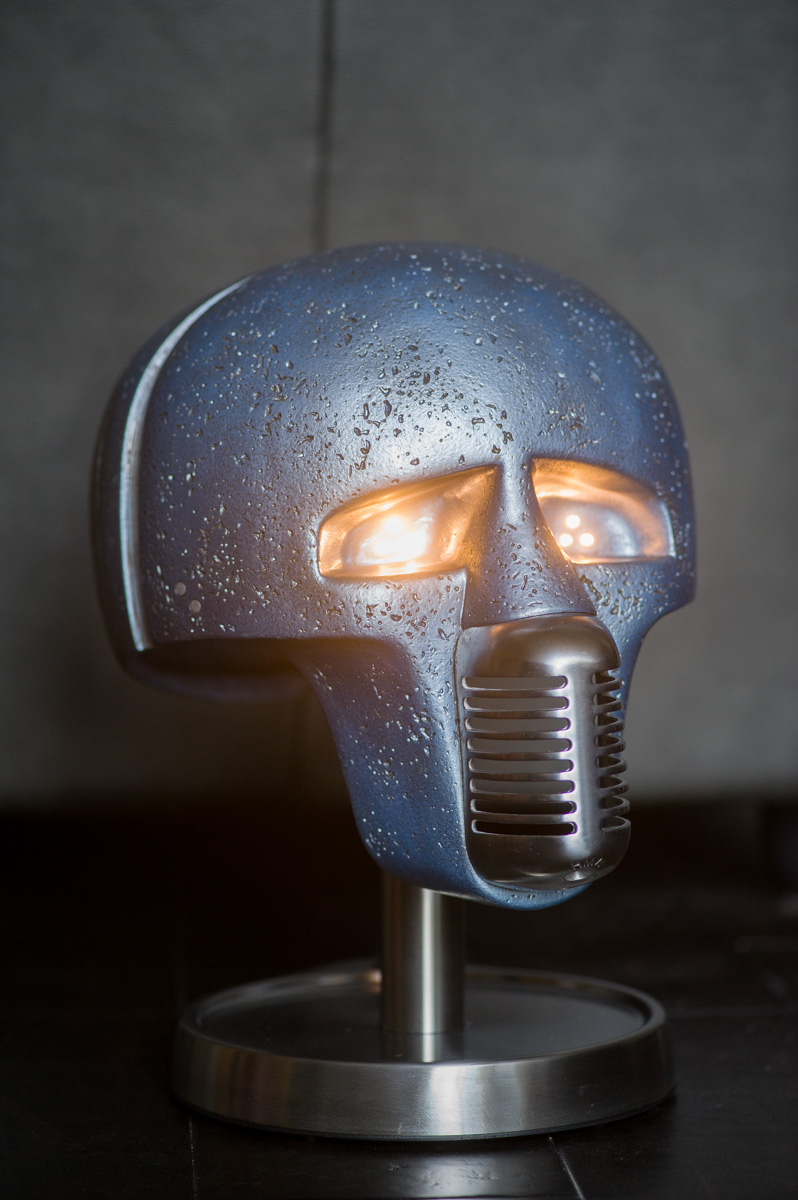

I didn't prime it at all... not a lick.
I wired them parallel... resistors on the positive leads. So each positive wire from the leds has a resistor...
So one eye's LEDs (3) positive and negatives are about 2-3" long... Then all three positives are soldered together to one longer lead. Same with negative. Then the two sets of positive leads are joined with the one positive lead from the battery box. Same with negatives. You have two wires running to battery box only. Simple but tedious.

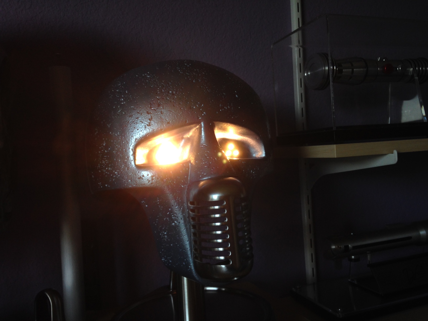

Also these are BRIGHT.
I think Dan's is an Aldi paper towel holder... and My paper towel holder was from Bed Bath Beyond.

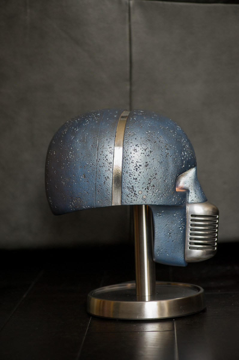

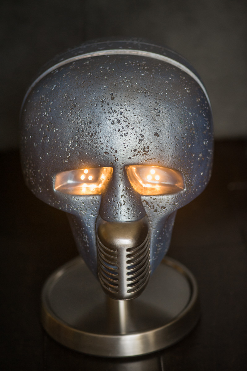

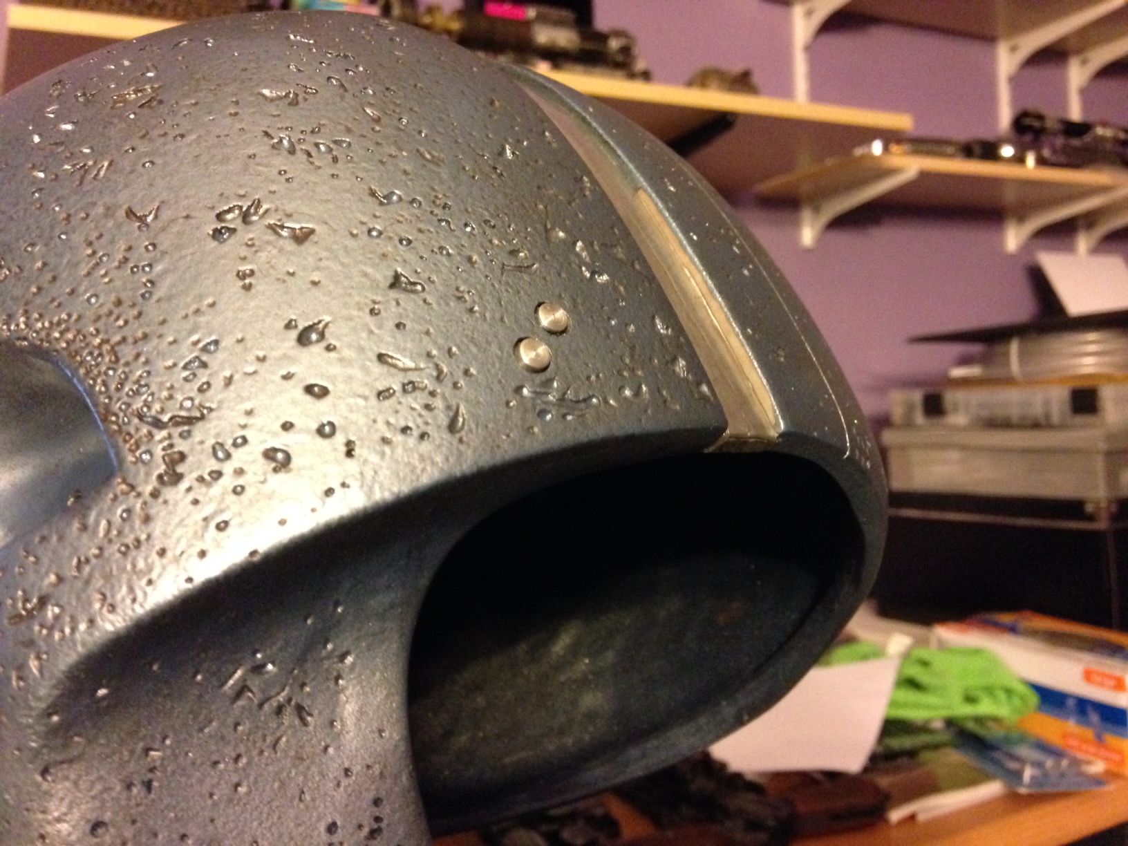

Tonight I machined and fitted the side dots. I have them sticking out a little as I see in the movie, but they're adjustable to suit my taste.

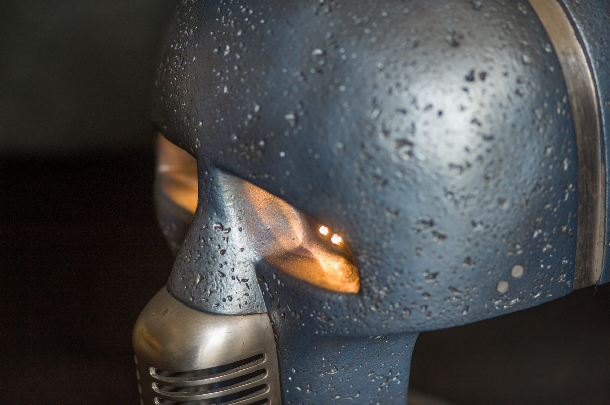

whats happening on its right eye, can't really make it out?
-z
