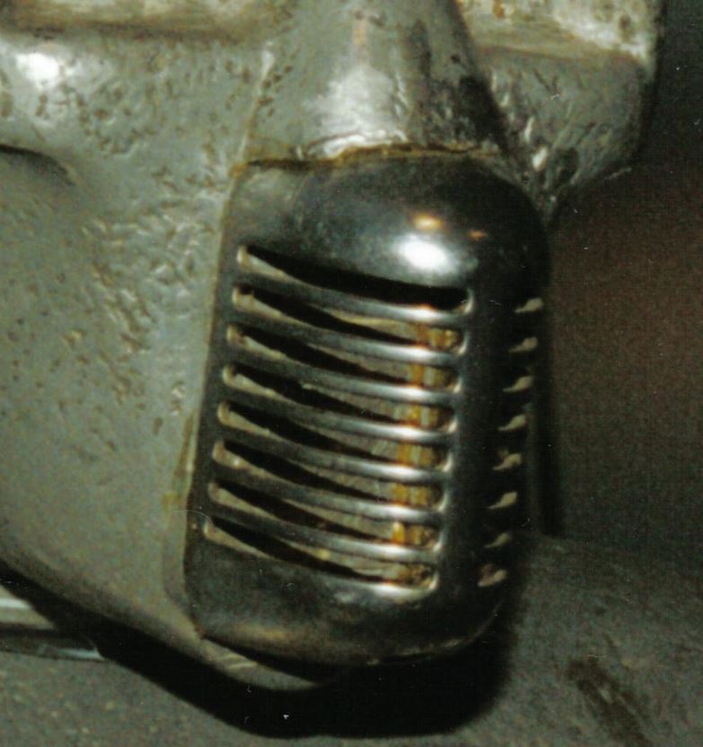

there was nothing behind the grill when on tour in scotland (art of star wars), they keep changing stuff and replacing bits and bobs on these exhibits so unless you can confirm it on screen i would take a lot of parts with a pinch of salt. the side spikes on the side of 2-1b head for example.
That would explain why I didn't see it. Yaaay.

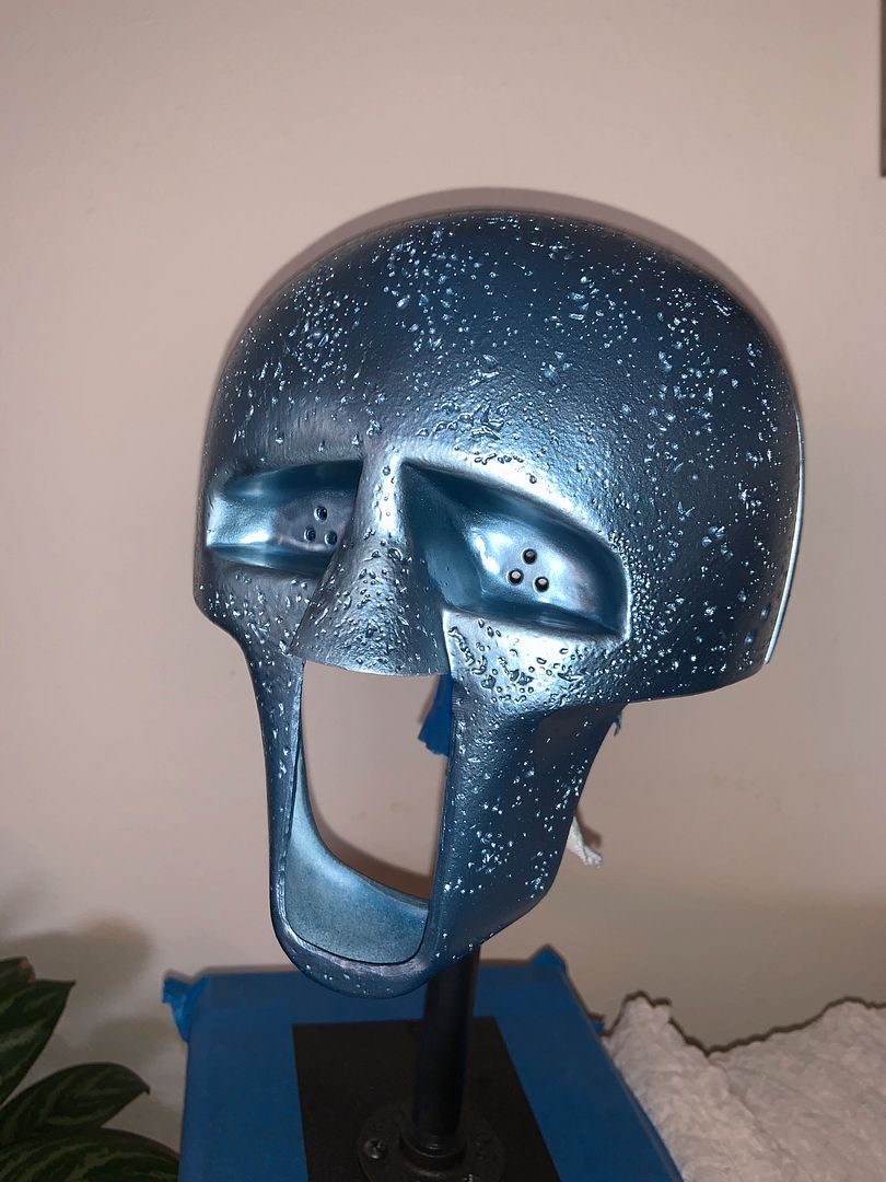

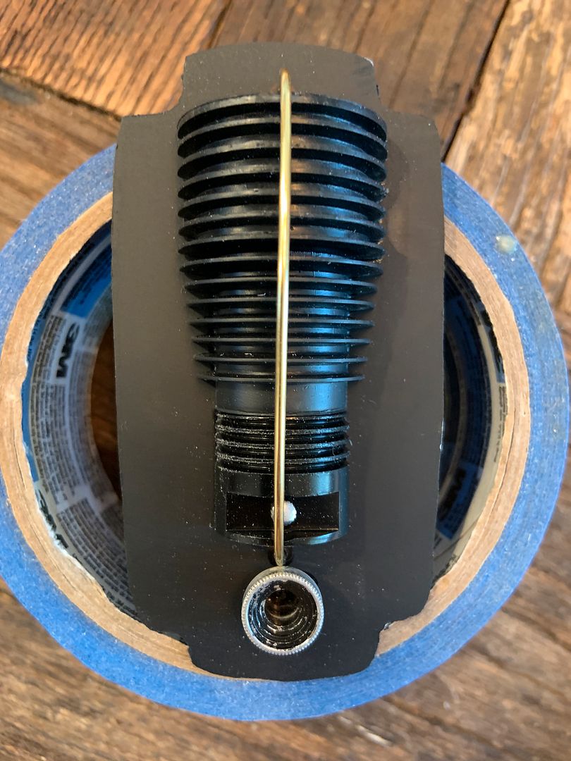

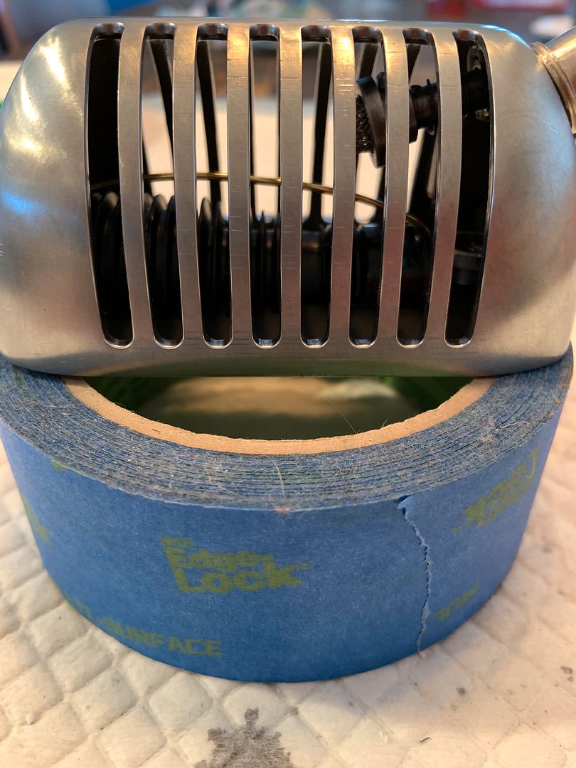

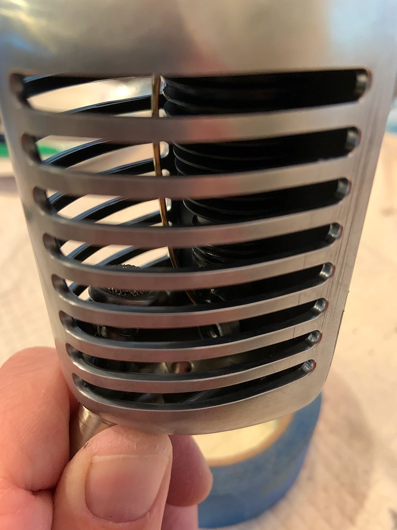

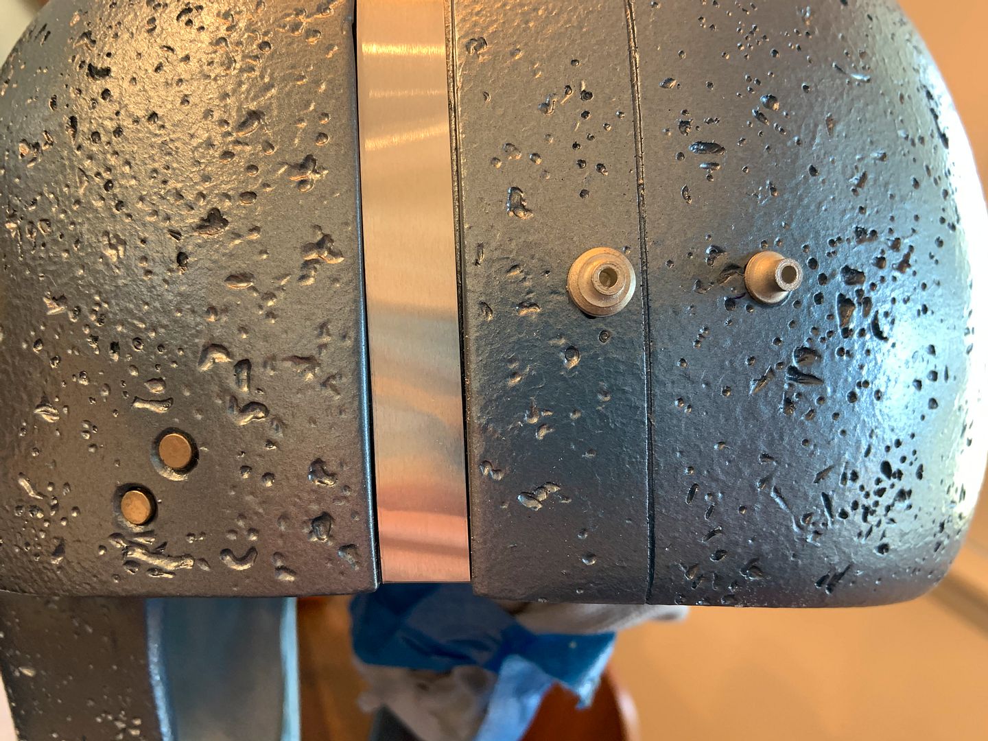

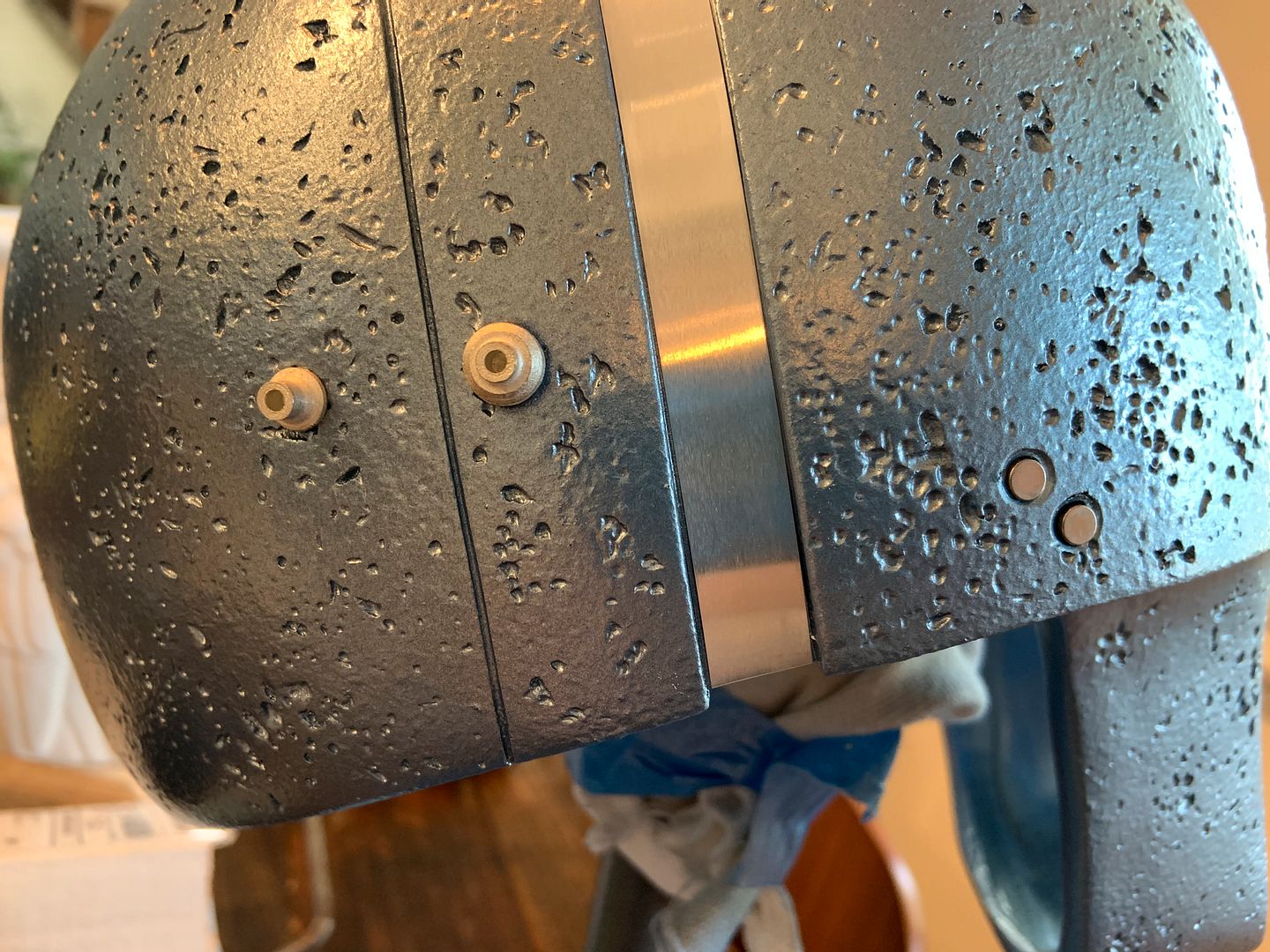

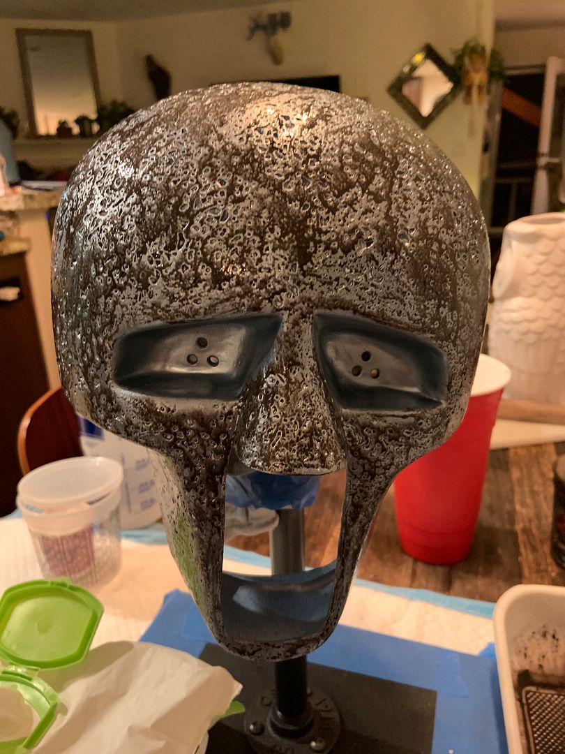

Got the lights wired up and installed. I followed Zorg's method and used Apoxie Sculpt and it works brilliantly!
Eye details all glued in place
Neck install tonight and final weathering!

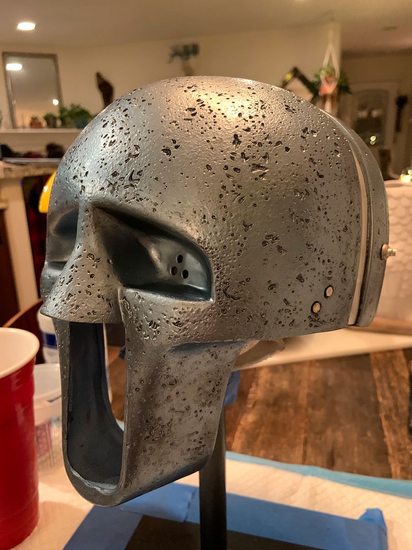

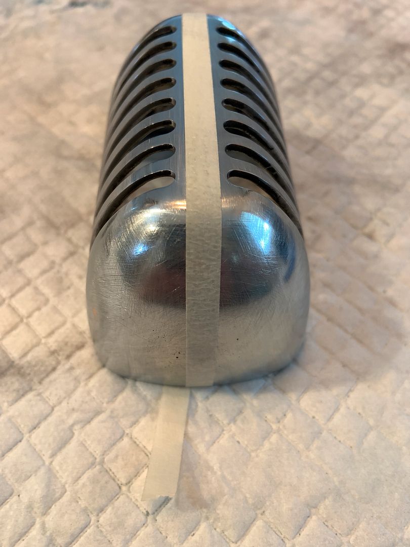

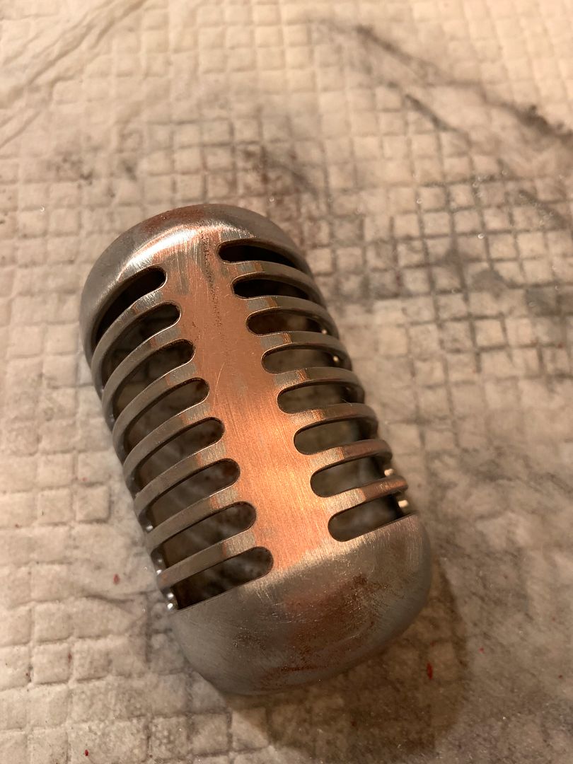

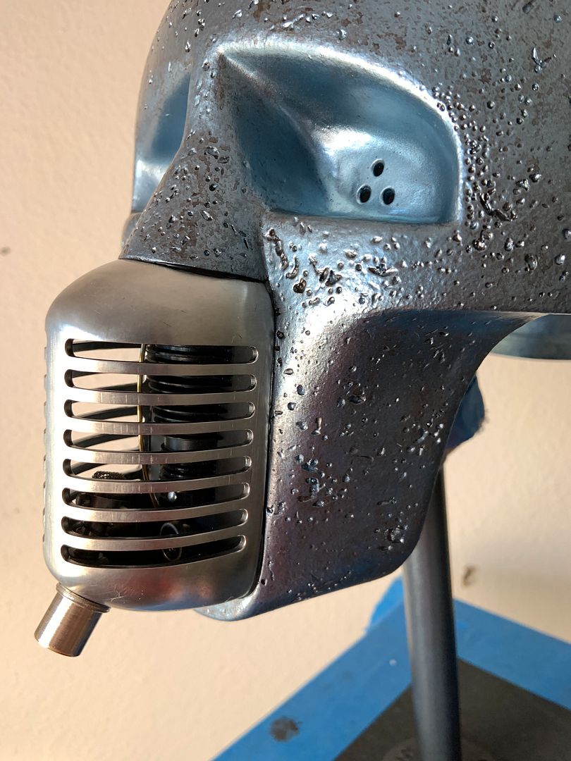

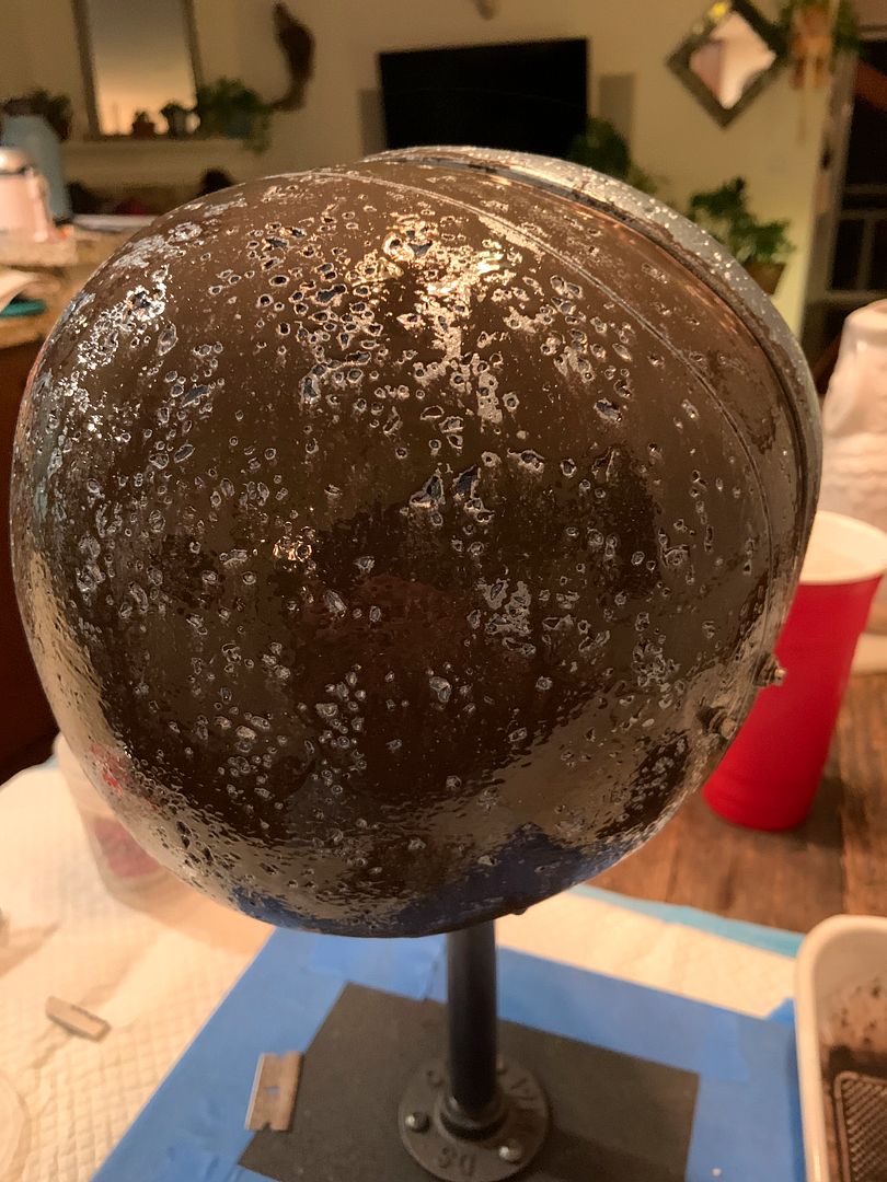

2-1B's paint was too shiny, so I masked off the mic, neck, & alice band and shot a coat of flat lacquer over the weathering and I like it much better now! Hose will arrive tomorrow and he'll be done! After building two of these and working on a commission to add details, I’m much happier with how this came out over my first.
