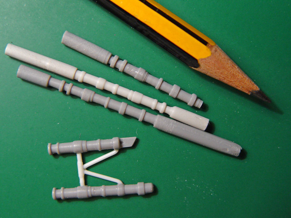

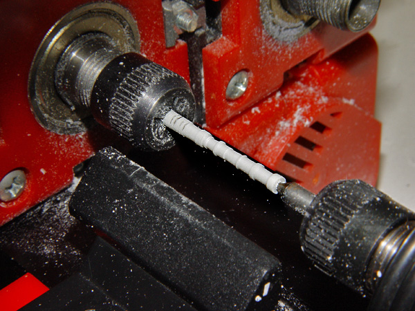

Hello friends.

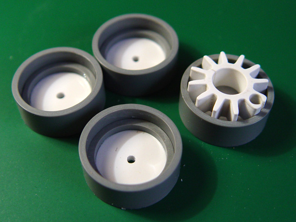

As I said in previous post, I'm currently working on the details that complete the rear engines.

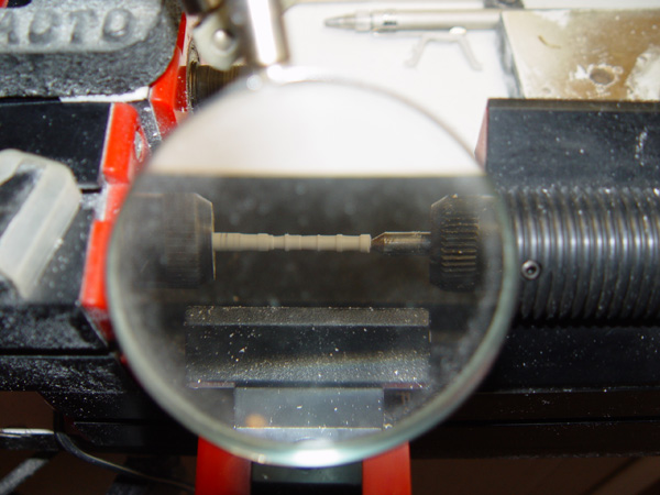

Both the Frog Whitley part, as the one from Nitto / Fujimi Jagdpanther has given me the opportunity to return to work with my old and loyal UNIMAT mini lathe.:love

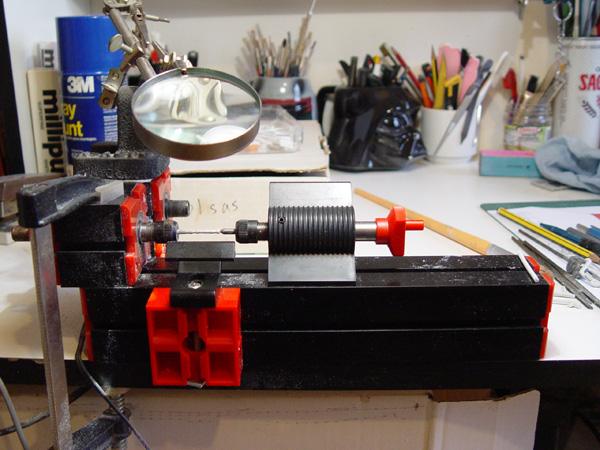

To operate these so small pieces, I helped with my also old and loyal X-ACTO magnifying glass.
I've mounted the magnifying glass on the lathe using a piece of padded tape with two selfadhesive faces, and it works well for my purposes.
Once the Whitley part was finished, I've noticed that turned parts are too thick, so I'm currently working again to build a new piece more closer to the original. :behave

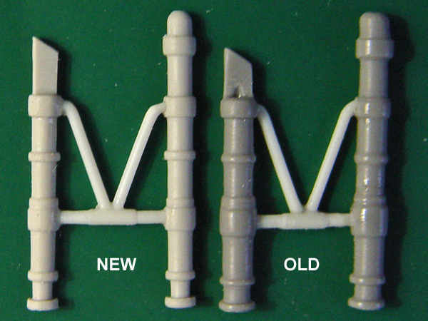

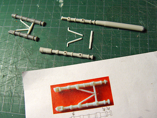

Well, my second version of the FROG piece is finished. In the images may not appreciate well the difference between old and new, but really looks best when the new piece is into place.
The same thing happened with the part of the JAGDPANTHER. My first attempt was too thick and again I had to do a second version. :behave

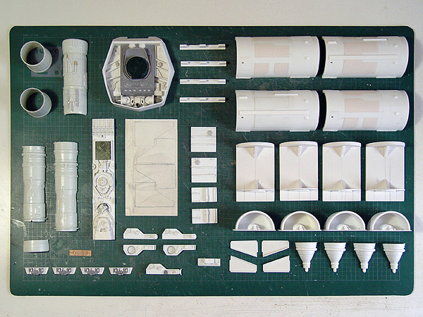

The part to create the rear engines is finished now.
After some months of work, my project is taking shape and there are more pieces in my drawer, ready to be placed on my X-Wing.
Thanks for looking. :)
Rafa

That little lathe of yours sure seems to be doing the trick... are you holding the cutting tool by hand? Who produced your lathe?

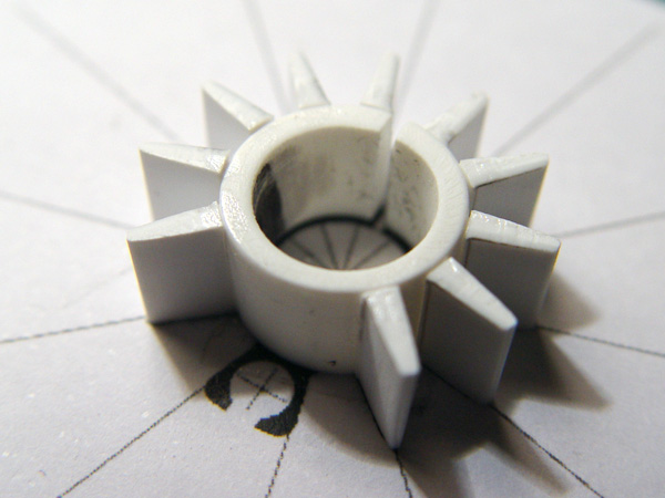

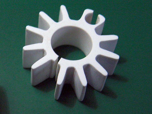

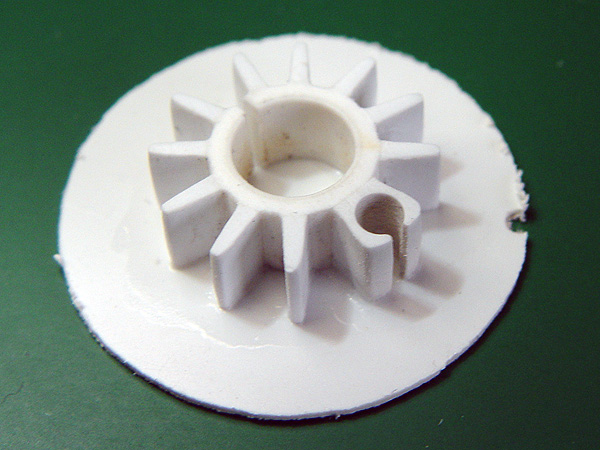

Two new pieces completed.
After my failed attempt to get the heatsinks by laser cutting, I decided to build a master for subsequent copies in resin.
First I got a plastic tube of the correct diameter, and then I did the fins using 1.5 mm. styrene sheet and, with the help of a printed template as guide, I stuck them around the tube.
Then I carved the remaining piece on a block of 7 mm. thick styrene and stuck it also on the central tube.
Finally, I pasted the group on a piece of 0.5 mm. sheet styrene piece to strengthen it and get a better finish when sanding the upper and lower sides for to get the right thickness.

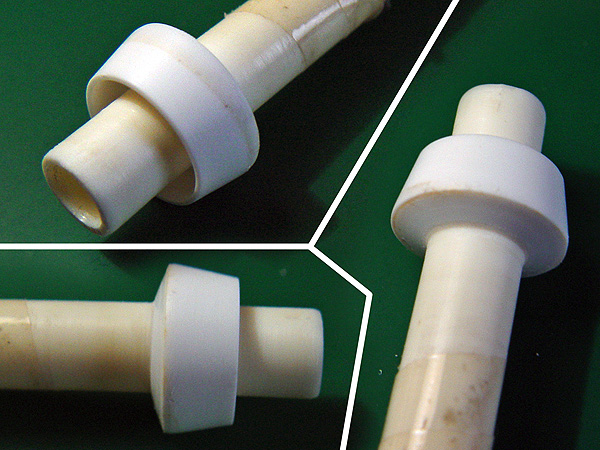

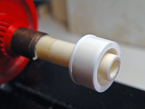

The rings of the cannons, which originally comes from the Bandai kit 1/15 Hummel, I built a master starting from a central plastic tube and a outer tube, joined by a circle of 1 mm styrene.
Using my mini-lathe again, I worked on the outer tube to give it its conical shape, both on the outside of the tube itself as its base.

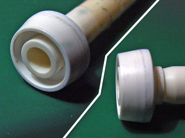

The next piece that I build is the rear of the cannons.
Does anyone know the donor kit of that circular piece? :confused
It seems clear that is a wheel of some tank, but I don't know wich specifically.
Thanks for looking.
Rafa

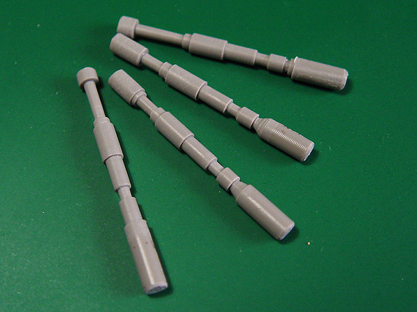

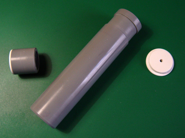

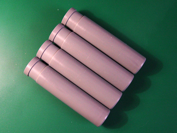

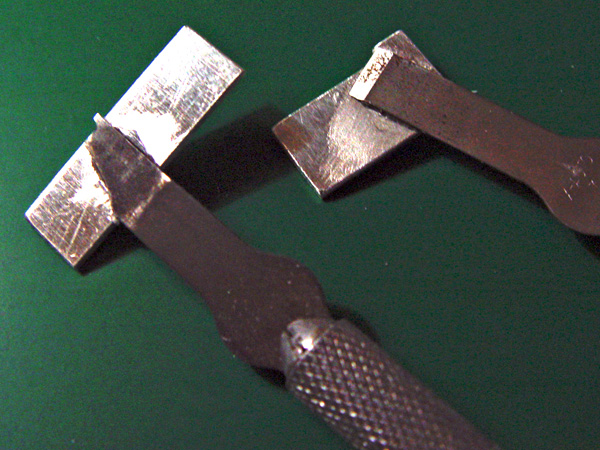

New updates.
I decided to work again on the ring of the guns to make the step that shows on its outer surface.

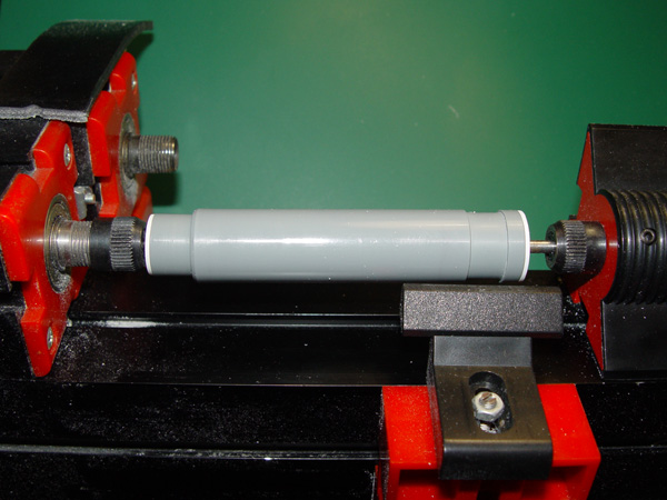

The rear cover of the guns was easy to build with the help of my mini-lathe.

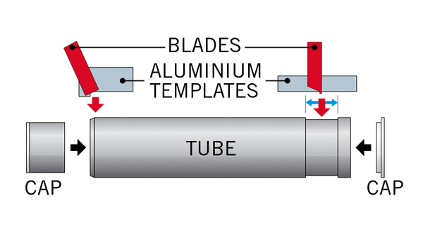

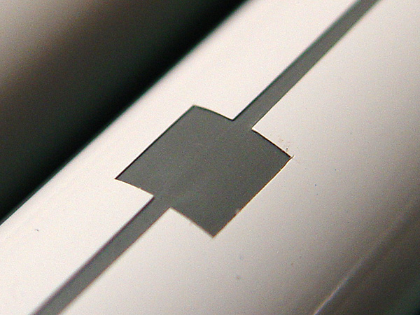

I used again my mini-lathe to make the main bodies of the guns. As the mini-lathe is very basic and I have no clamps for large diameters, I had to make a plastic caps that fits well in the pipe ends to fix them on the lathe.
Also, I made a small aluminum templates on which I paste the cutting blades which helped me to make the four equal bodies. The templates limited the depth to which the blades could go, making it easier to work.:)
I have also finished the larger rings that goes in the front of the main body.
Thanks for looking.
Rafa

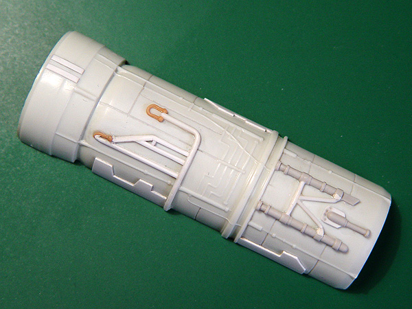

New updates:

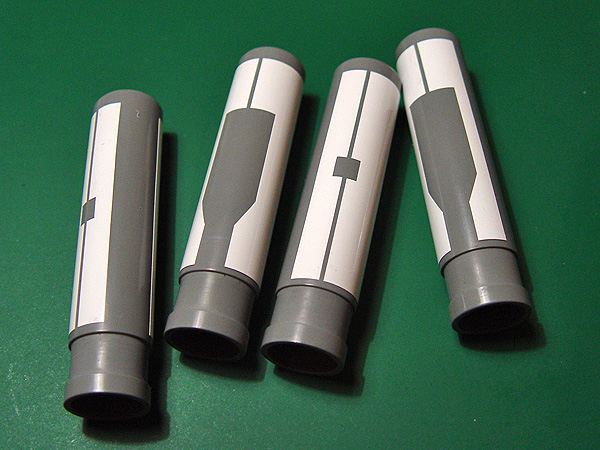

1. - I finally got the suitable vinyl for paneling the bodies of the cannons. There is a wide range of vinyl tape and isn't easy to find the appropriate thickness. I asked a friend who works in a signage company, and they use a type of very thin vinyl for cutting plotter. Too thin for my purposes. According to my friend, thick vinyl is poor quality and that's why they use the thinnest. I asked for a thicker vinyl and he advised me that they use for printing. Of course, only in white, but the thickness is right in my opinion.

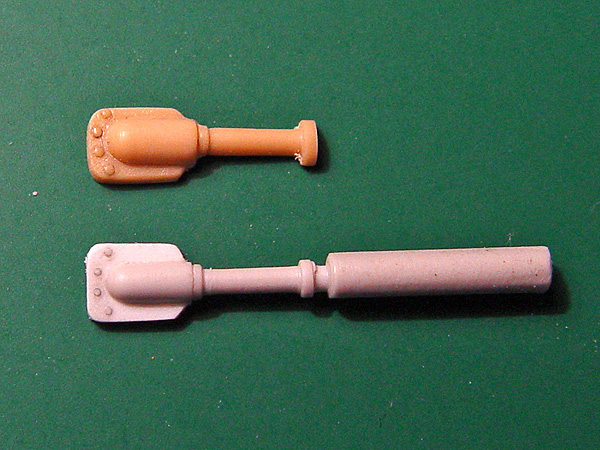

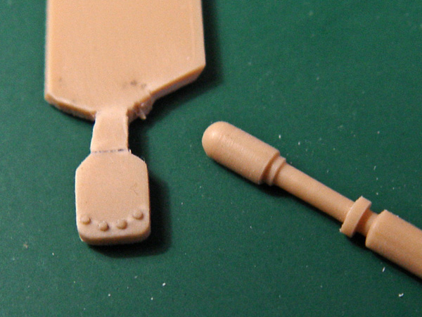

2. - Once again I used my mini-lathe to make the Hanomag parts that go into the rear channel of the wings.
3. - I've also done the part from the Sealab kit that is like a gas cylinder and that is placed next to the wells of the internal motors.
4. - Finally, I've also done the grill shaped pieces from the Sealab that are placed at both sides of the inner engines.
For inner engines, I preferred not to use the same parts used in the rear engines. To me it makes no sense to use the same parts in both areas. Okay, all four engines are equal, but isn't very logical that the pieces are the same in two such different areas of a single engine.
Fortunately, there are two different type of internal engine configuration, so I can choose which I prefer without losing accuracy.
To make these pieces, which at first seem complicated, I made a simple template on a piece of wood and a piece of plastic that helps me to fix and align perfectly the four curved rods. I've also done a channel in the piece of wood with a hole in the center to hold the small parts that make crossbar. Once they are subject in that hole, and using the channel as guide, I can use a small round file to give the U-shaped at the ends of the crossbars so that fits well against the curved bars.
The small step I made in the plastic template helps me line up the crossbars.
First I use liquid glue to paste these pieces, so I can make small corrections and adjust their alignment perfectly, and once the unión is near dry, I further reinforced the area by using a few drops of cyanoacrylate on the bottom of such unions.
Thanks for looking.:)
Rafa
