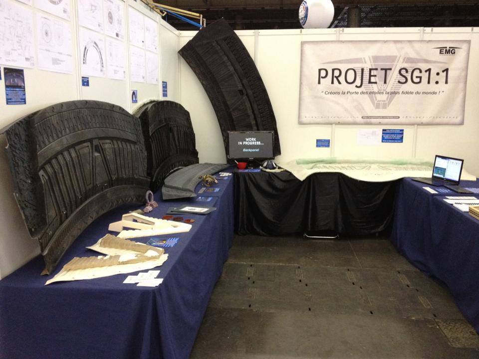

Hehe, last week we were at ComicCon Paris for that. It's the 4th convention were we're presenting the project. There were a lot of people, we gave something like 500 cards with our website written on it. We also made the acquaintance with some journalists and model-makers.
A member of my team was also at ComicCon London. Both Jason Momoa and Amanda Tapping were impressed by this project.
Dedicated to andy19422 and cheech9898 (the blueprints were low-res so it wouldn't be copied). ;)

I had some trouble with my casts, it takes bad shapes (not easy to see, but it's there) because the silicon mold doesn't fit exactly in his resin shell. I'll try to add weight on the entire surface after my two first layers of gel coat will be no more sticky and let it cure for a week. After that I'll do the last two layers to finish the cast. It sould be fine.
For the parts I already done, I can reshape it heating them. So I have one question for you all. I'm working with polyester, but the Gate will stay under the sun for a long time in many occasions. Is there any paint that can prevent it to be too much heated so it wouldn't take bad shapes ? Maybe I should use polyurethan instead of polyester.

For paint, maybe try one of the metalwork paints, like a home radiator paint or something similar?
Polyurathane seems to be more heat resistant according to the internet, but I don't have much experience with resin to make an informed comment...

For the paint, I'm not searching a paint that is resistant to heat but that is preventing the covered part to be heated. Something like that : Insuladd - Insulating paint & paint additives.

Might consider looking into an epoxy resin system for fiberglassing. I usually use West Systems epoxy resin whenever I've done fiberglassing gotten from my local aircraft/racing supplier. Epoxy tends to take the heat better, but it'll most likely be less forgiving if your mold is out of shape.
Also, not sure what your actual thickness is with 4 layers, as that will depend on the weight of the cloth mat your using, but on the pieces of the off-world gate I have from Legends they're nearly 1/4 inch thick.
