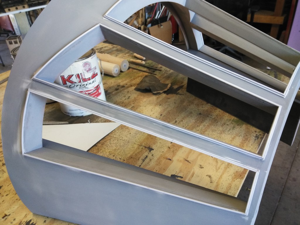

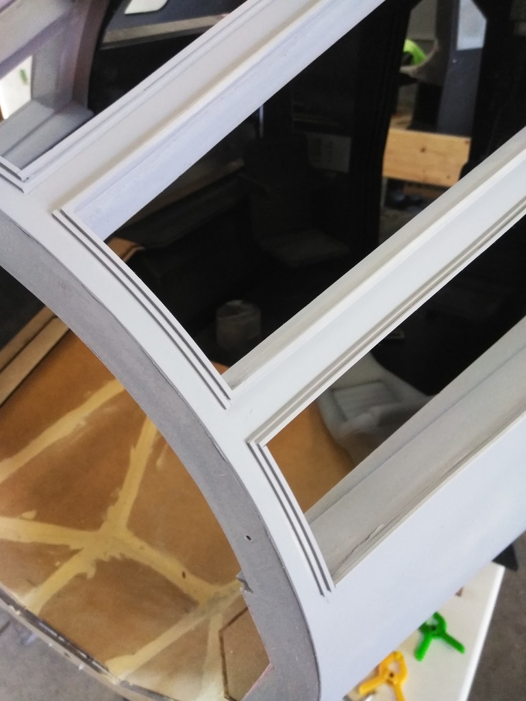

The upper canopy and window are near perfect... I still need to go BACK and fix the lower nose section
The lower part of the nose is pushing out just a bit too far
I primed the window to help blend with the canopy. I love this angle!

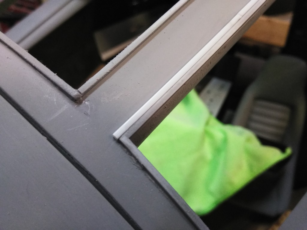

I have to remove the trim from the top window and replace - dried slightly out of place
Yucky gap!
Flathead screw keeps the window in place with the canopy. BUT, I might double up the trim to give them a little more bulk

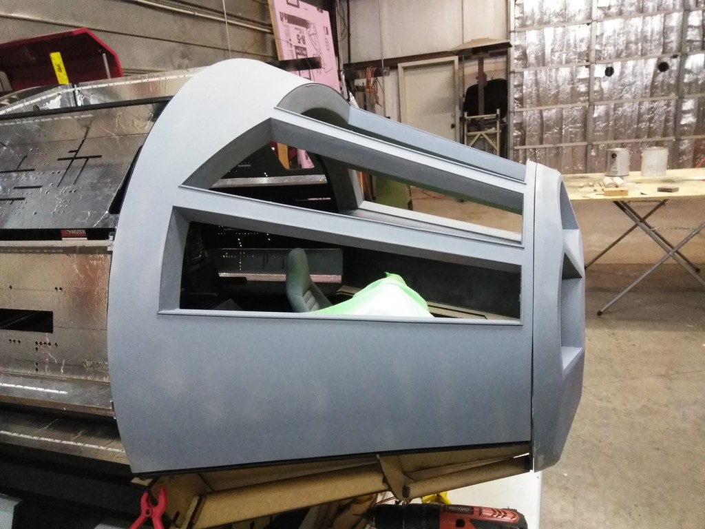

And this...
Is where we are!
A bit more work is required on the instruction manual. I really want to knock that out so I can get back to work on the 1/4 scale.
Images of the Full Scale Cockpit Coming Soon! Stay Tuned! :)

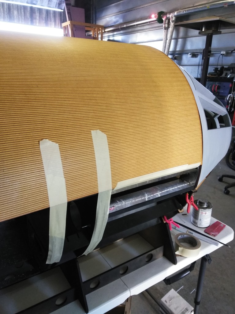

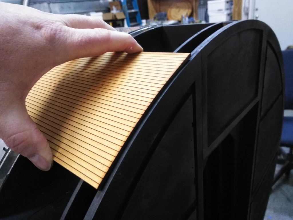

I laser cut this practice piece from MDF
I'm trying to find the perfect laser cutter settings to etch the MDF that will allow me to simply roll the panel over the main body
I laser cut a 44x30 in sheet
It's NOT perfect and the lines need to be a bit deeper but I'm going to see if I can use it - I need to relax the MDF
The idea is that the skin will just lift off exposing all the frame work
MDF was still a bit tight
Once its fitted, I'll cover with styrene to hide the MDF and then we have fun and add the armor plating and greeblies!

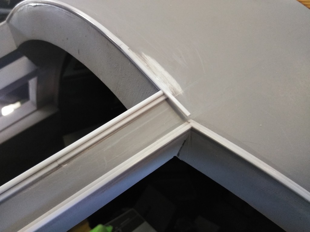

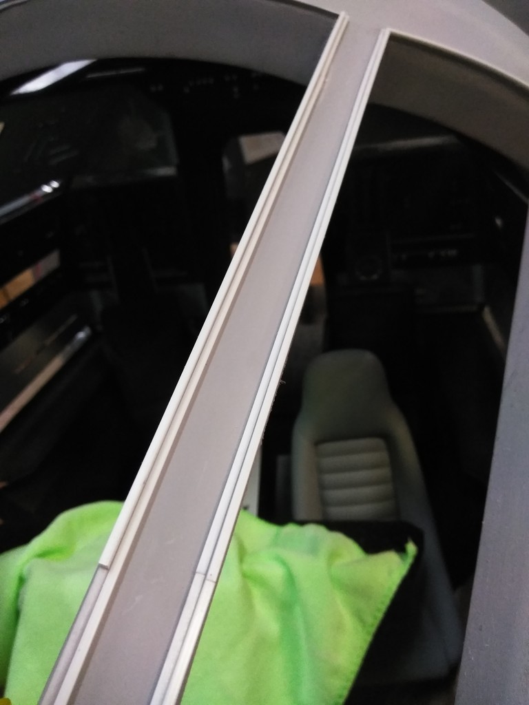

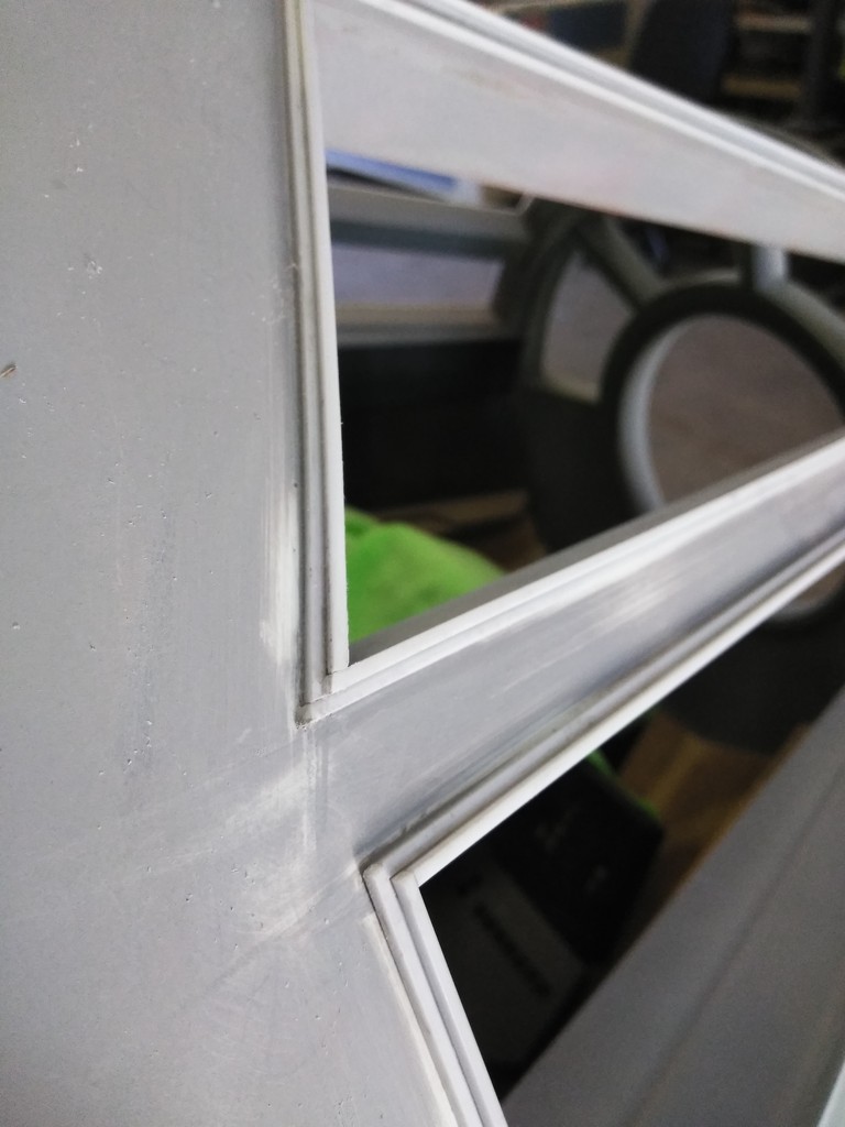

I then turned my attention back to the canopy window trim - I had to perform some minor surgery on the front center trim
Much better
I then doubled up all the trim
MUCH better

I love seeing these updates. What got me this time was the scale. I know it’s a 1:4 scale build, but seeing your hand holding the MDF really put it into perspective. Otherwise it still looks like you’re building a life size cockpit!
Looking good!
I wonder if you were to coat the MDF with resin or even white glue and let it set up, it would most likely hold form and act as a cap for the canopy like you mentioned. Just a thought anyway. If you fill all the voids it can't flatten back out.
Hi T,
Thanks so much! I love posting these updates - that means forward progress.
For years I sat and looked at the full scale build and over time I just didn't see the scale anymore. But the 1/4 scale sits at 28 inches (711mm) wide. Although its still 1/4 scale, I still can't get over how big it is... which doesn't make any sense! lol
As I've stated, all the greeblie flies exist at full scale. I simply scale them down and boom... 1/4 scale. My hope is to have a near identical copy to the full scale build. Fingers crossed.
Looking good!
Thanks, K!
Just before work this morning I stopped by the shop and put the MDF into a barrel to help with the curve. If the MDF holds its basic shape, I was thinking of doing that exact thing - good call! Coat the inside with adhesive and styrene. My hope is both will pull the MDF inward. If the form holds then skin the exterior side.
