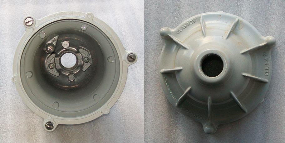

He 3D printed the Coughtrie Lamp base used for the corridor lights
http://i778.photobucket.com/albums/...ar/05 Mar/IMG_20180304_095237_zpsutwtzviv.jpg
I have an original base. Izzy's base is screen accurate to Starkiller's 3D model. I wonder if Coughtrie made several different sizes?
http://i778.photobucket.com/albums/...ar/05 Mar/IMG_20180227_180322_zpsfovzbsqg.jpg
love those buckles! I'm glad the model I sent you worked out for printing.

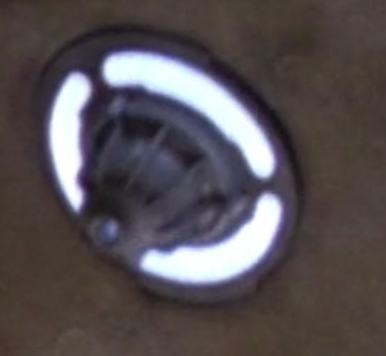

I think it's definitely possible coughtrie made two types. As you can see in the print of mine the bolts are lined up with the fins, and on your original they aren't. Now I know I didn't put those bolts there by accident so I looked around.
I can definitely see that coughtrie had at least two variants, one with bolts between the fins and one aligned with the fins.
the dimensions I got were off those specs we found of the coughtrie fixture for sale some years back. It's possible that either the specs were measured wrong, there are several sizes, or I'm bad at reading... haha. Anything is possible! Still, at least the shape is good, if I do say so!
looks like bolts on fins for ANH and ESB

Which size of lamp part is the correct one?
Hey Lt W,
Starkillers 3D model is the most screen accurate so I can only assume that Coughtrie made several variations of the lamp base for different applications. As of this writting, the model Izzy 3D printed is screen accurate. So... I'll do my best to fill, sand smooth and then we'll make a mold to knock out what we need.
The other visual clue is the top of the base. The screen used lamp base has a very rounded over top where as the larger version is the complete opposite. My money is on the smaller base.

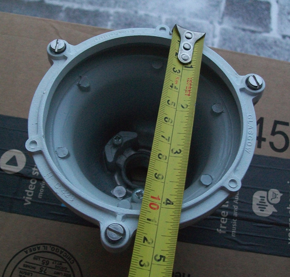

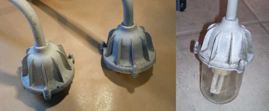

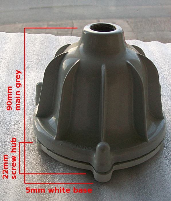

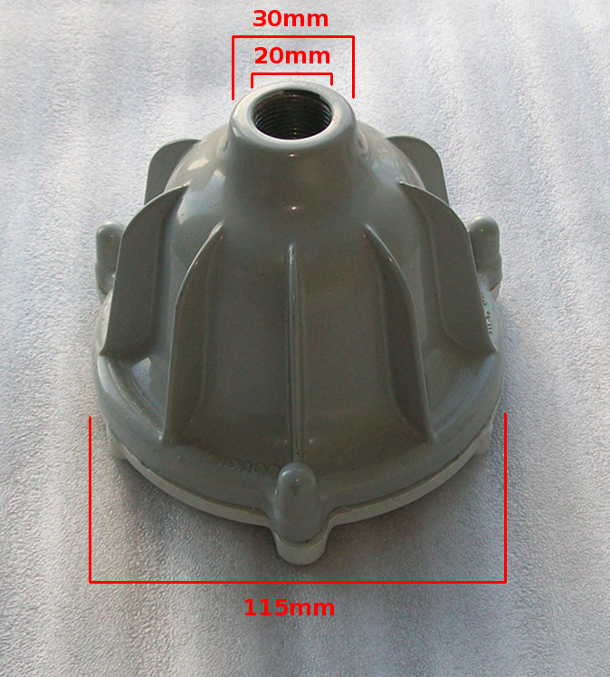

Some basic sizes here on the light part that I'm fairly sure is the correct greeblie, see how it measures up with yours SK.

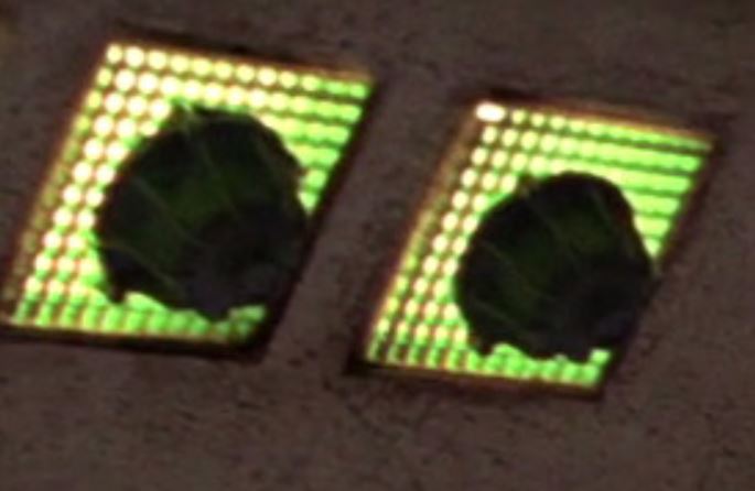

The glass bell that covers the light bulb can be seen on the underside of the ESB Falcon and on the tops of the moisture vaporators.
I like how every wall lamp in the Falcon corridors has GLASGOW in tiny letters on them. Even if they're not screen-legible.

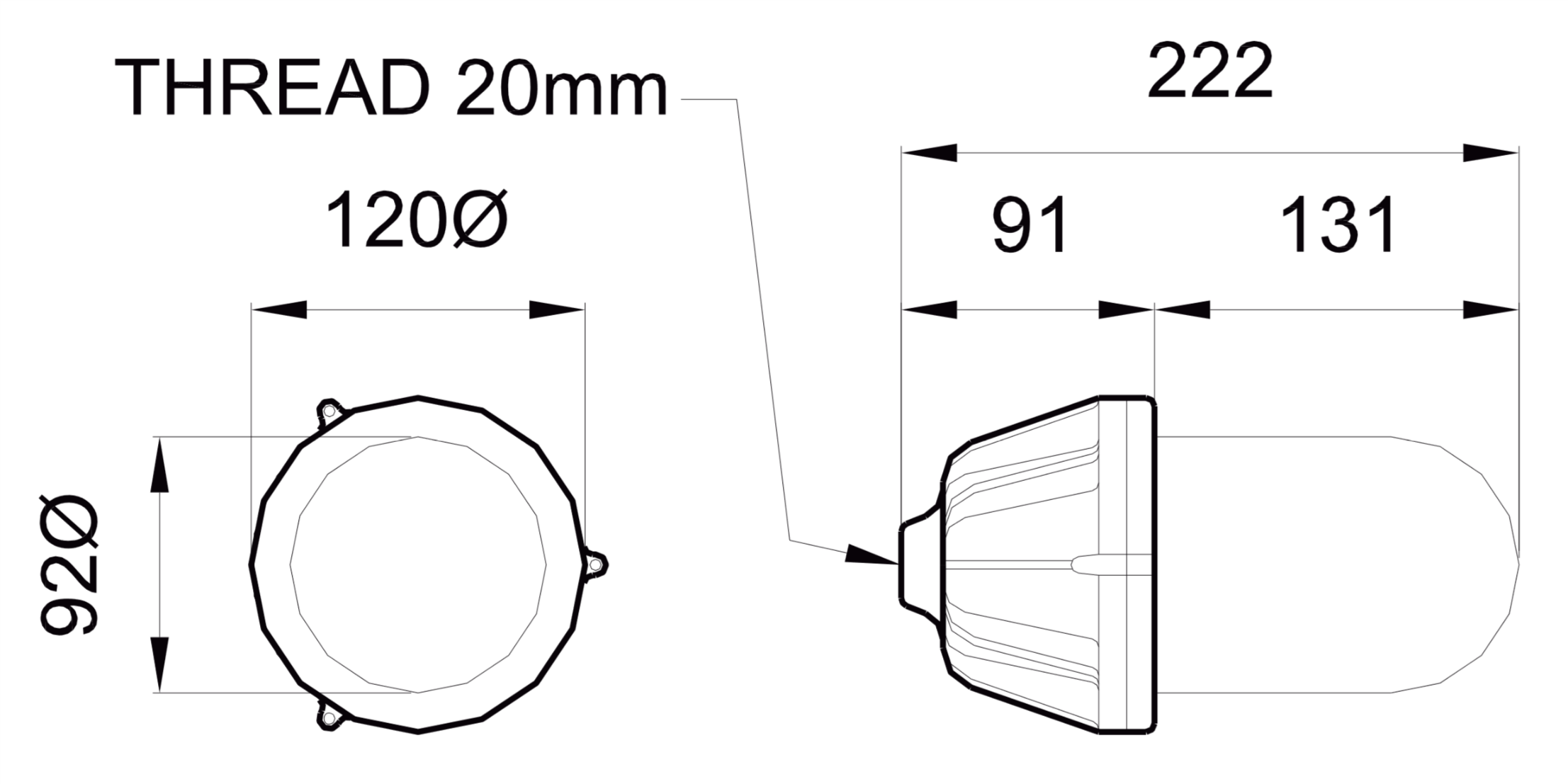

Here's a diagram from the product spec sheet.
Now that's an interesting size discrepancy, I'm seeing 115mm in diameter (there's a slight 1mm wobble with my tape measure). But a 5mm difference is huge in manufacturing terms - if indeed my light is the same product as in the document. It's possible that slight size differences like this are used to denote the year or decade of manufacture without spoiling the look, I've heard of that before.
Veeeeery inteeeresting.
EDIT: ....Ooh, unless the doc is describing the outer edge to centre of the screw fixing - that would be more sensible, lol!
I don’t think so. The diagram looks clear to me that their dimension is from outer edge to outer edge. I suspect that what the company sells now is a redesigned part to replace the ones we are interested in. Hopefully, the one you have is of the pattern we’re interested in.
