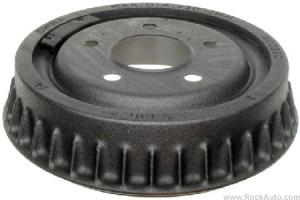

In case you didn't know the round part of one of your lovely greeblie panels looks like the original was a finned brake drum from a car, motorbike or moped, A bit like this one:
