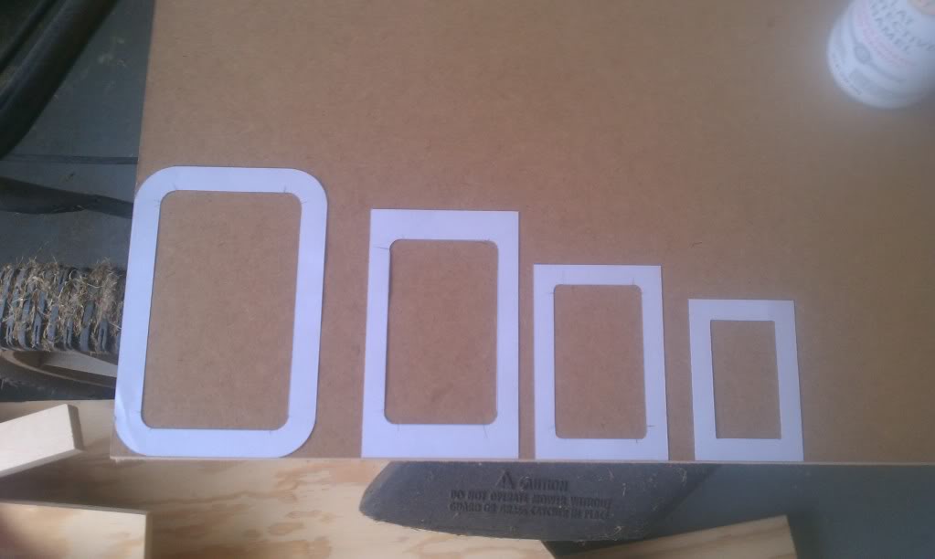

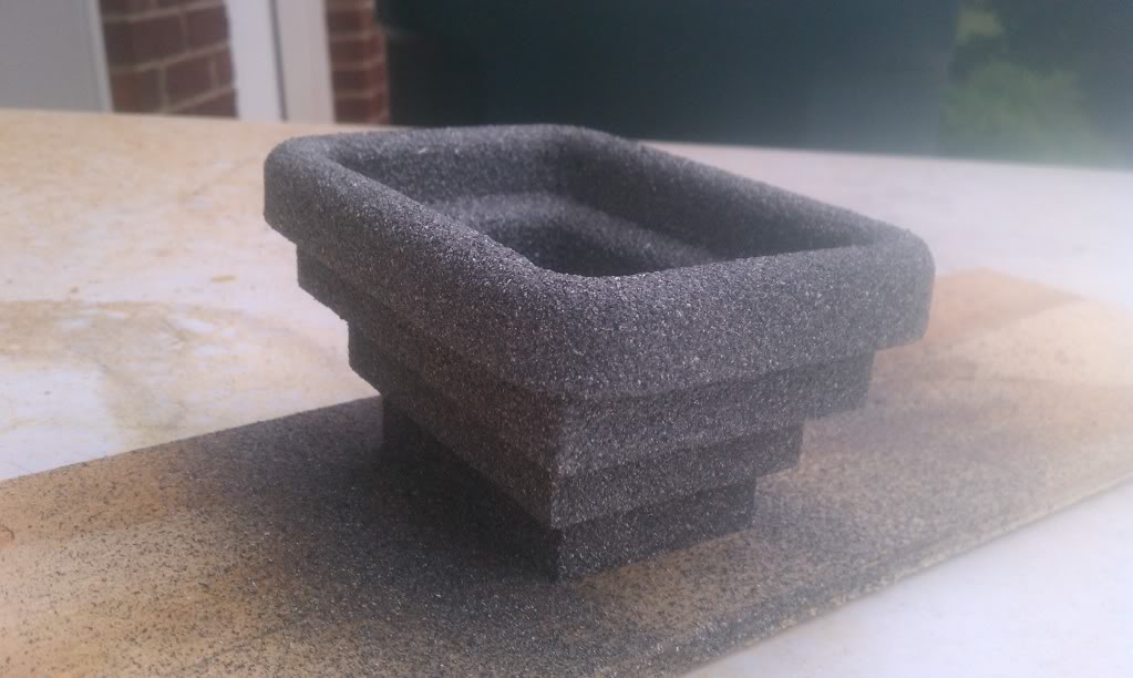

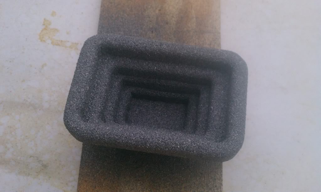

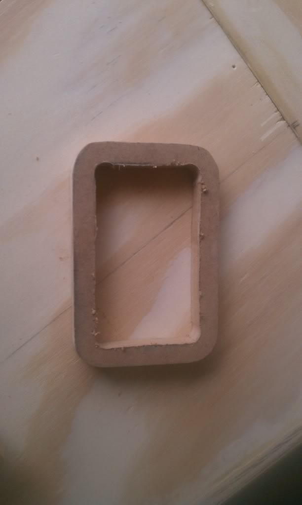

I decided to try my hand at building the Mitchell Matte Box. I dont have a lot of wood working experience and the dimensions might be off a little bit... but in all I think it turned out great!
I created a template, printed and then cut the pieces out and layed them all on to MDF
To save time I then sprayed a little black paint over top to see where I'm supposed to cut... I know I know... it's not exact...
I then cut out each shape and drilled the appropriate sized hole in each corner where I could then cut out the inside
I then routed both the inside and outside of the top piece
Then followed the same steps for each additional piece but only routed the inside
Once they were all glued together I applied rock textured paint and sprayed the inside and out (although the outside will eventually be covered). Once dried, I will lightly sand down the texture and paint with a flat black to give the appearance of the old bakaing method that was used...
Enjoy
Add a few little chrome knobs and other bits and we have ourselves a monitor! I really wanted to put the box in place but the paint will take a while to dry... The nice thing about the textured paint is that covered up/filled in all the minor (major) imperfections. I know it's not perfect and as I mentioned I dont think the dimensions are correct, but at least now I know I can do it. And it really didnt take that long. If the measurements are if fact wrong I'll take the little guy and mount him to a little panel, add some lights and make a display out of it. :)

Its raining today so I cant work on any of the panels... GRRRR... I will go to the home improvement store and pick up another piece of formica so I will at least have that if it stops raining.
The monitor turned out nice... but, as i predicted, was a LITTLE too small. Dont ask me how, but I got the measurements wrong. So, I am going to recreate the monitor screen in just a few minutes.
Yup... Just a little too small

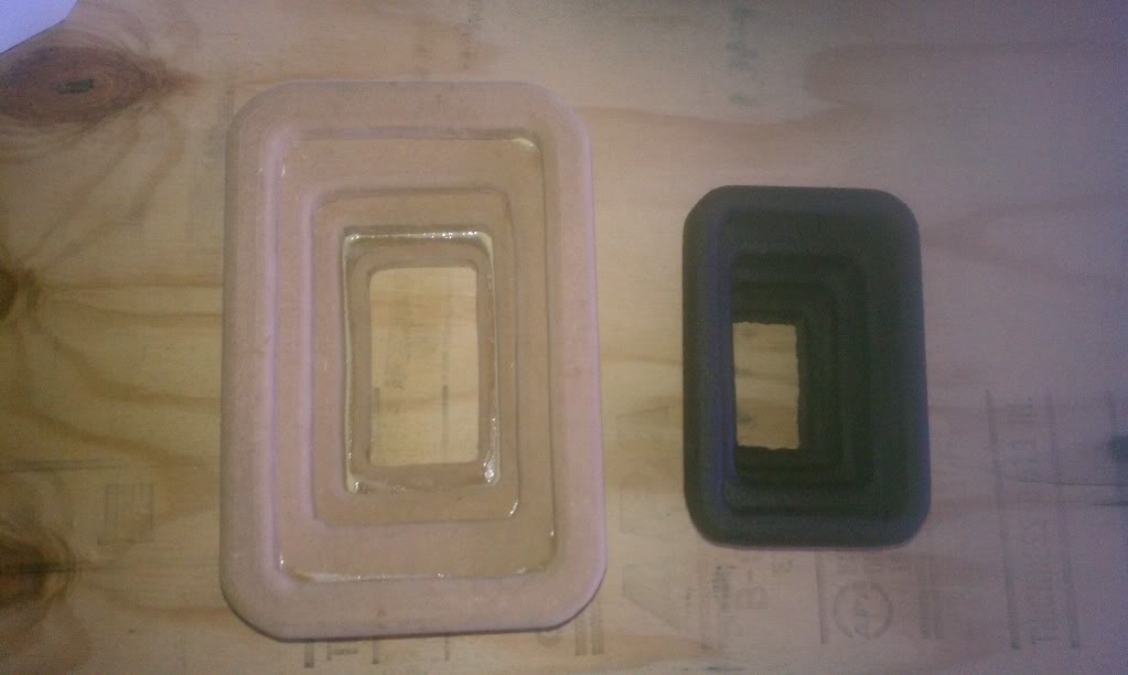

UPDATES!!!
I was able to pick up the LAST sheet of formica at the improvement store. It had several knicks on the edges so I got it for 70% off! I also picked some KILLZ primer for the practice Throttle Housing. And finally, created a larger monitor surround. Check out the results!
Followed the same process of cutting, routing and sanding as i did the previous version. Here they are side by side - slightly bigger this time
I also routed the inner edges as well to prep for the cover
The Throttle Housing with KILLZ primer and layer of flat black - it turned out perfect!
Both pieces resting on the console
A few coats of "Rock" texture paint. After it dries I'll lightly sand and give it a coat of flat black paint then add a few little chrome pieces I have laying around

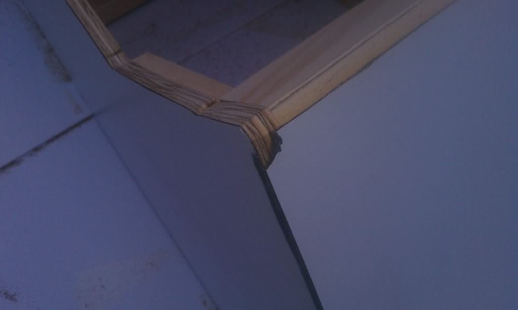

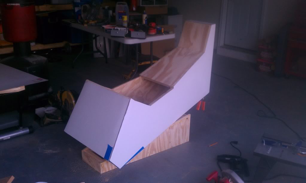

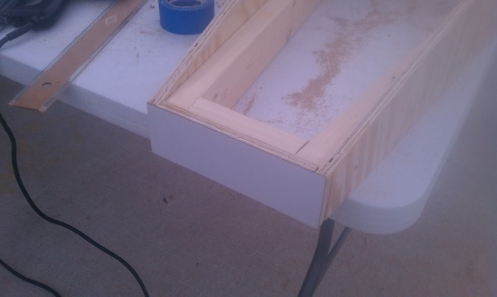

Updates... I think...
Its been a FRUSTRATING couple of hours... What could go wrong... did go wrong...

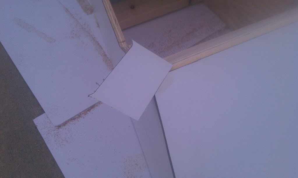

I skinned the front of the console and as I was walking past... I slipped and caught the corner and cracked the edge...
I cut off the edge and replaced with a new piece and then cut to fit...
I then picked the console up to move it and the bottom of the back panel formica popped loose... GRRRR
I then realized that the base was 1 inch off so I had to add a small pieces to the edges
And this is where we are... clamps holding the back formica in place... waiting for glue to dry on the base support and sitting at my computer extremely frustrated waiting for the day to end! LOL
I knew I was going to have one of those days... it was just a matter of when. I was hoping to be MUCH further along with the build. But I should slow down especially now that I have to figure out how to mount the buttons, lights, rockers, etc... I think I already mentioned that...
If I never have to work with formica again... I wont be upset...
Stay Tuned... I think

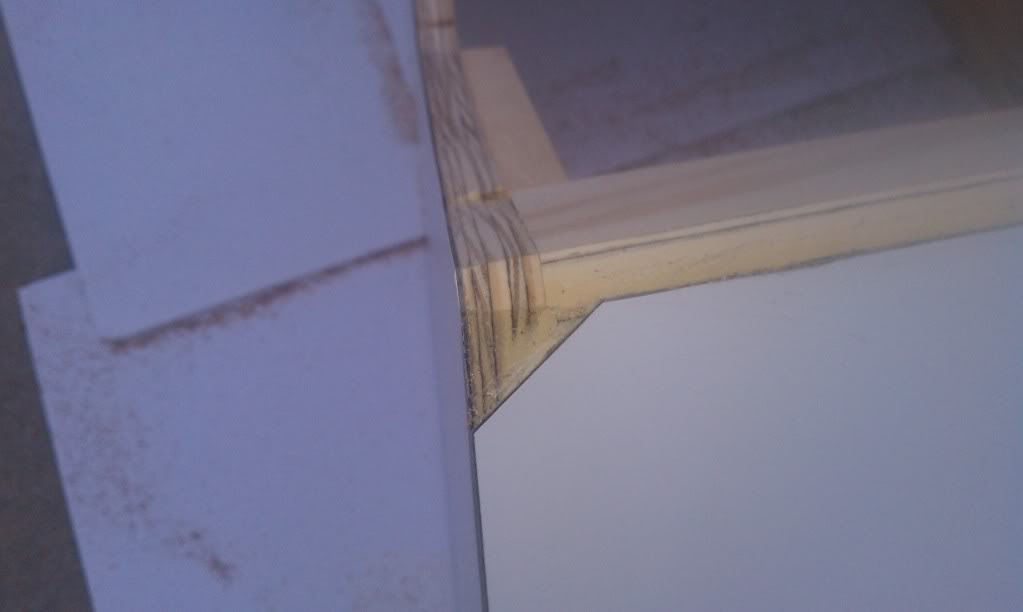

Re: 1:1 Millennium Falcon Console Replica

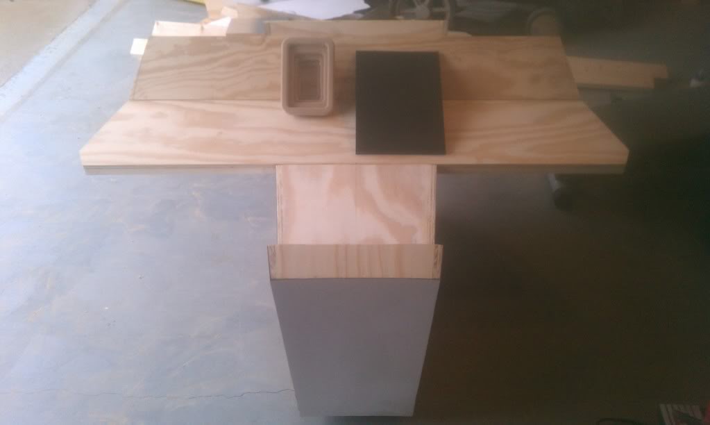

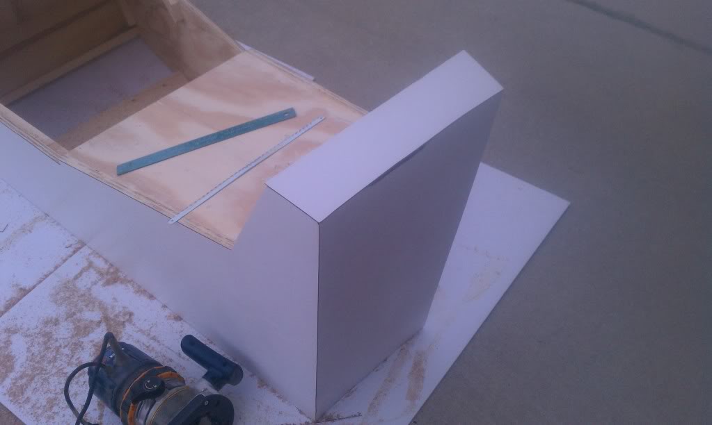

UPDATES!
Taking things a bit slower after yesterdays fiasco...
Contact cement applied and edges taped for proper adhesion... I hope
Bottom front of console
Support
More coming
