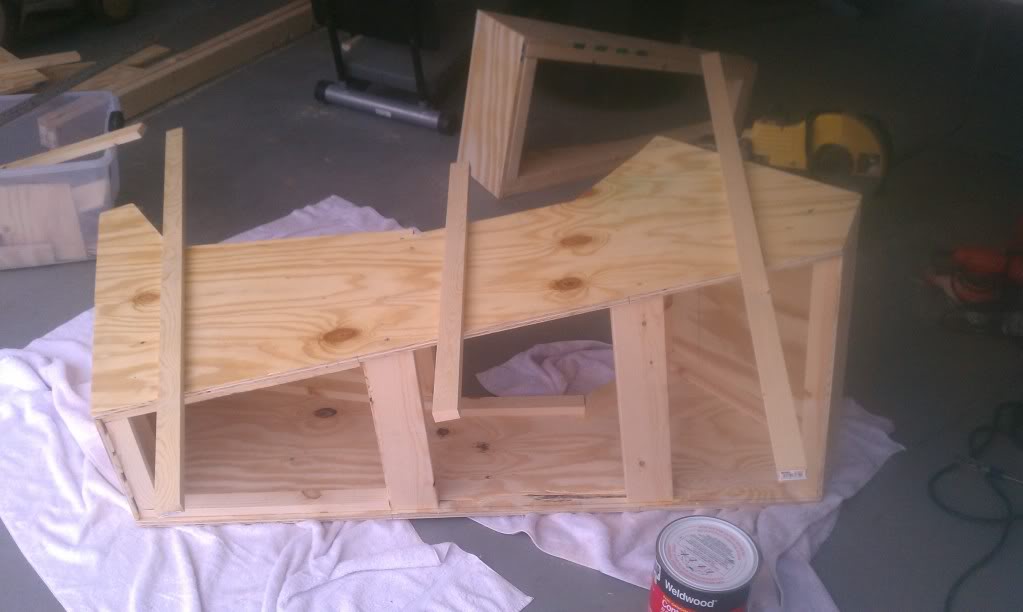

UPDATES! I built the underside support. Enjoy!
Almost ready to skin! Any ideas?

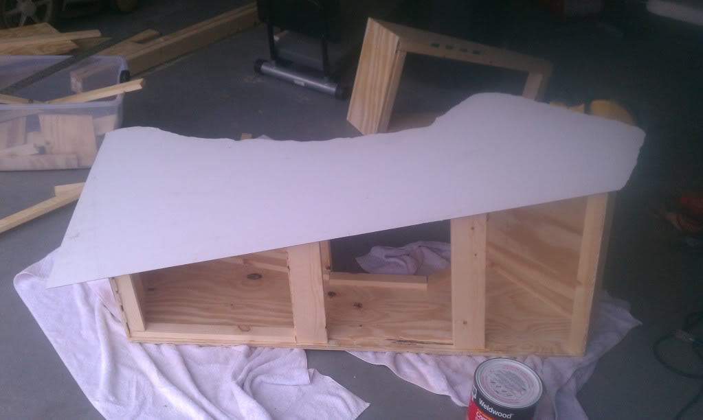

SofaKing01
Re: 1:1 Millennium Falcon Console Replica
Minor update. I was able to create a sample "Throttle Quadrant" piece. I'm going to use this to test the formica skin. I was able to find a few cool items on Ebay.

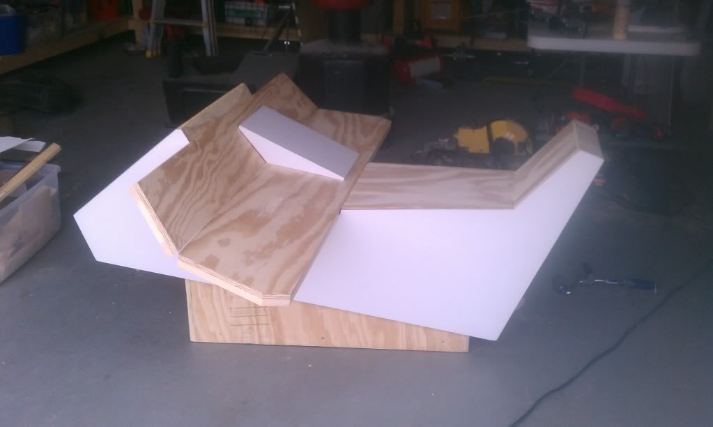

REAL TIME UPDATES!
I bought a HUGE piece of formica this morning and tested the sample throttle housing - other than cutting the formica to shape, the process is VERY easy. Cut a piece to shape, roll contact cement/adhesive to each piece, wait until dry to touch, and then lay the two pieces together.
I'm now taking the plunge to skin one side. With the piece this big I'll use wood to act as guides before laying into position.
Practice piece
Prepping for skin
Tough to see but there is a layer of contact cement...
Stay tuned for the results!

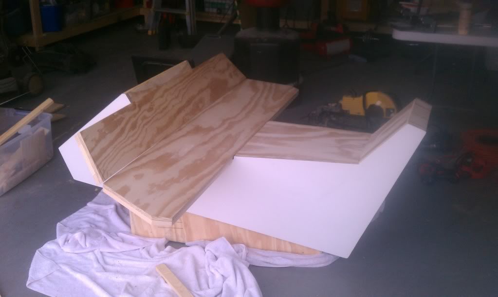

SofaKing01

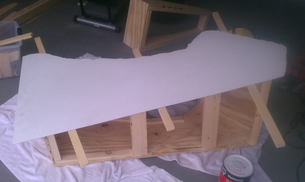

The skin has been laid... now we play the waiting game...
Lay pieces of wood across the panel and adjust position before laying into place. The contact cement is really strong and you have ONE SHOT to lay the formica!!!
I then laid the formica on top of the wood planks and adjusted/moved the skin to its correct position
Then I slowly removed each piece of wood, one at a time, while pressing the formica firmly into place. I then took a roller and rolled from the center out to make sure to remove any air bubbles and create a strong contact
I'll wait a few more minutes and then route the edges for a nice smooth finish. I then repeat this process on every panel... UGH...

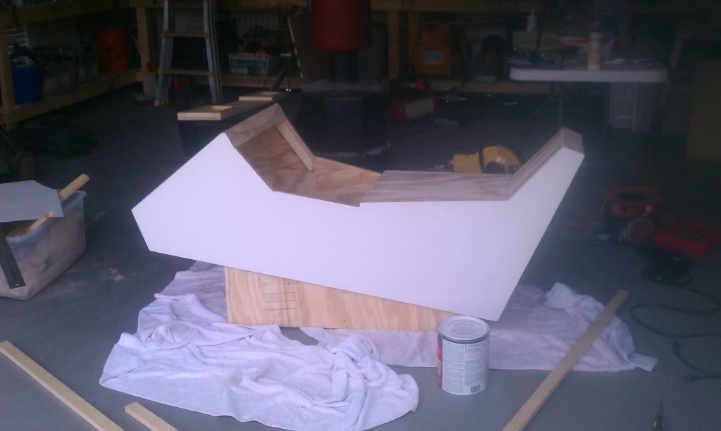

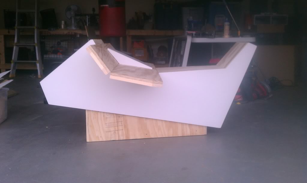

SofaKing01

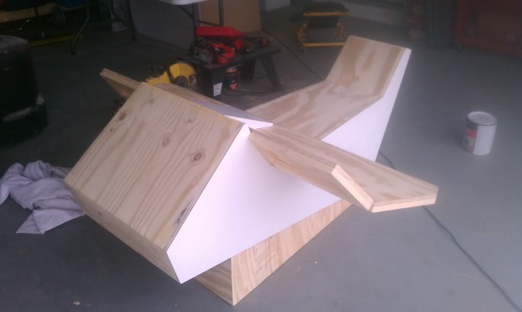

TA-DA!!!!
edges are all routed and looking pretty good...
Gee... only 8 more sides to go...

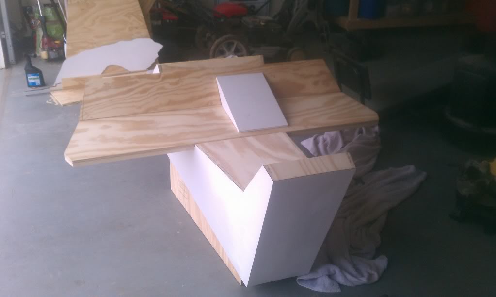

SofaKing01
UPDATES!
Both sides are now finished along with the back. I ran out of formica to do any of the larger panels... so I'm going to take the rest of the day off...
I have to go back to the home improvement store and get another sheet of formica. I hope to have at least the console and the support skinned tomorrow. I'm holding off on the 2 instrument panels until I have better idea of how I'm going to mount the rockers and buttons. Both panels, like the original, are very thick so I need to figure out what to do... Better safe than sorry.
I will also be priming the console and working with MDF to try to make the little view screen located next to the throttle housing. The original viewscreen is / was a Mitchell matte box from and old 40's / 50's Mitchell movie camera. An original will cost 400-600 dollars and instead of destroying something of that value, I'll attempt to make IT myself and then paint it with a texture paint...
She's getting heavy too...
