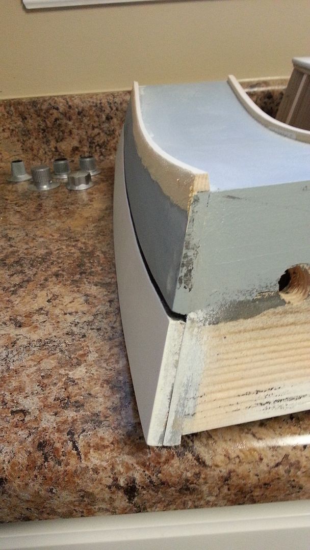

Hi Gang,

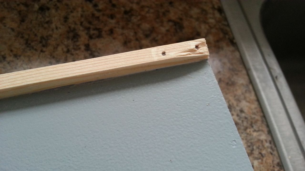

The canopy strips are all attached. I'm waiting for the filler to dry so I can sand and paint
I just love these little happy accidents... ugh...

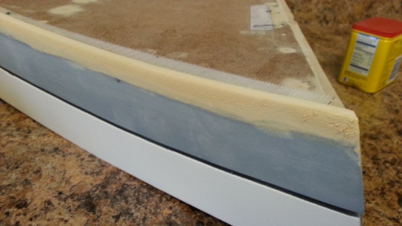

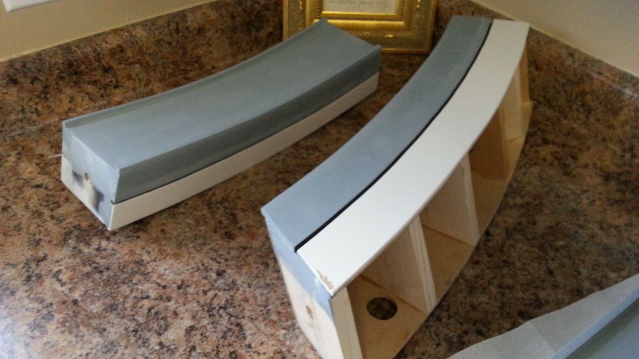

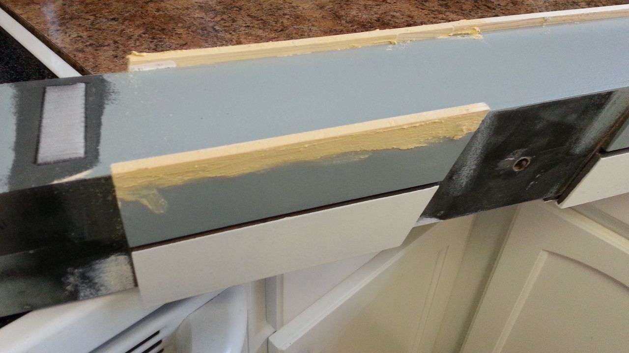

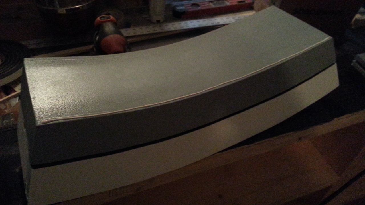

Hi Gang,
First round of sanding done. Another flayer of filler and then light sanding and then paint...
you can see how much materiel was removed from the sanding in order to match the flat surface
So much for all that painting I did earlier...
More to Follow!

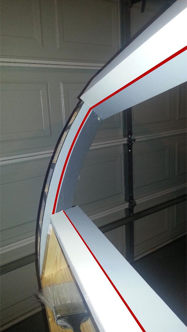

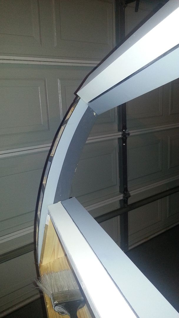

Hi Gang,
Well... I knew this time would come and I ignored it as long as I could. I didn't realize how "off" the alignment was until I really began to look at it.
Looking down the window channels (both top beam and lower side panel) all the way to the front arch looks cool - but they are not aligned at all
The red line shows how far off the window channels are
There are several ways to fix this without altering the arch...
1) Leave the window channels where they are and manipulate the channel on the arch so everything lines up
2) Follow the same curve of the front window arch but push the side panel window channels away from the interior
3) Meet somewhere in the middle and hope for the best
Options 2 & 3 will require another layer (window channel) to be added to the lower side panel
HMMMMMM... I can't go back and rebuild a new arch - that's non-optional. The canopy beams, for all intent and purposes, are set in place. Any change to the arch would scrap the entire canopy...
I HAVE to work with and manipulate the existing arch and hope for the best. Whether than means making the arch appear wider or thicker in certain areas... that's what I may wind up having to do...
I can and should, however, change the beam height to match the arch. This doesn't resolve the window channel problem, but it does keep the arch the same dimension as the 3D model. I think removing this material IS a must...
Lots to think about... Any ideas?
Re: 1:1 Millennium Falcon Console Replica
beeffin up the arch would be the logical and the most esthetically pleasing method i would think, this also depends how this effects the look from the front on perspective or our you more concerned with how the ship looks window out ?

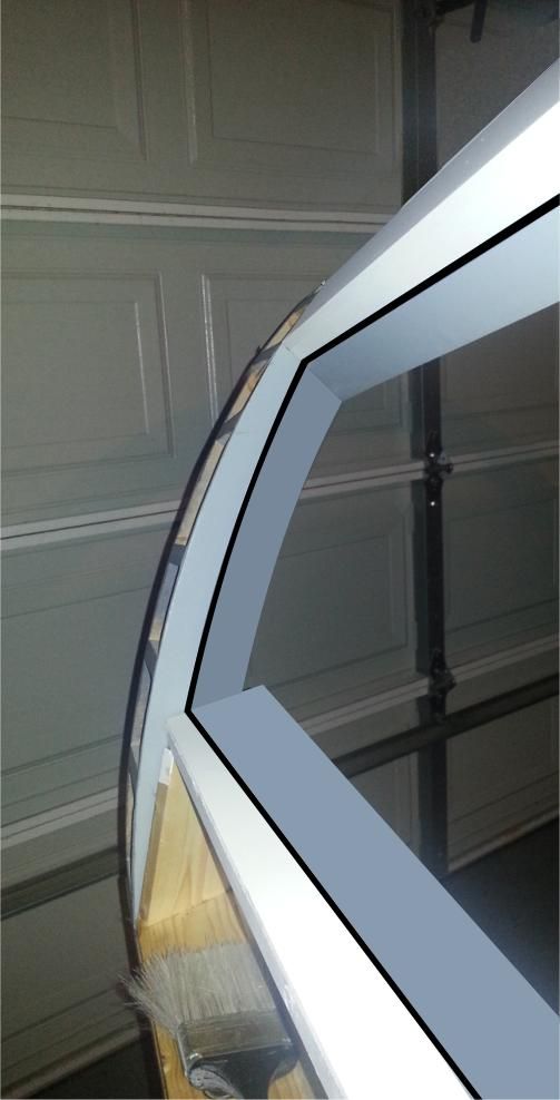

Hi Gang,
I think I may have figured out a solution - it'll be UGLY! The problem areas are only on the left and right sides where the arch meets the side panels - the center window channel on the arch is fine for now (they would eventually ALL have to be redone so the black window channel matches all the way around the arch).
Manipulating the horizontal beam(s) might be where the solution is. I have to first remove the top of the horizontal beam so it lays flush with the arch - as seen in the picture above. Then, if I can successfully remove the window channels from the questionable sides of the horizontal beams and reconfigure them (or just add another layer of MDF) they should meet up with the lower side panel window channels - we should be in business
The red line shows the existing window channel alignment / the black line shows the possible fix
Still working on it...

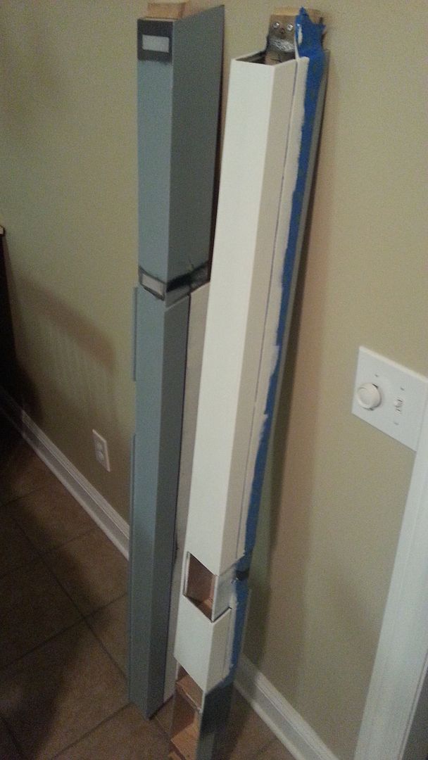

Hi Gang,

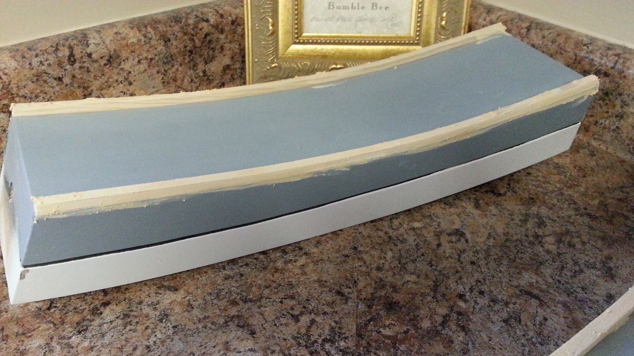

Work continues on the beam details...
This guy needed a little more attention
I'm still unsure how to move forward with the canopy / window channel issues. I see now EXACTLY where the error was - an oversight on my part. After looking at screen grabs I see exactly how the original designers addressed the transition. To do it right would require me to re-skin EVERY beam & panel - not a difficult task but definitely time consuming.
I'm considering taking a different approach. I still think I need to/should remove the top portion of the beams to make them level with the front window arch. Then add the additional window channel on the lower side panels with the channel pushed toward the outside of the cockpit to match the arch. See below
Again... not really sure which direction to take... Ideas?
Hi Gang,
That's quite a pickle... Short of remaking the rounded nose end to line up better, I don't know what else you can do without further serious rebuilding involving the side panels.

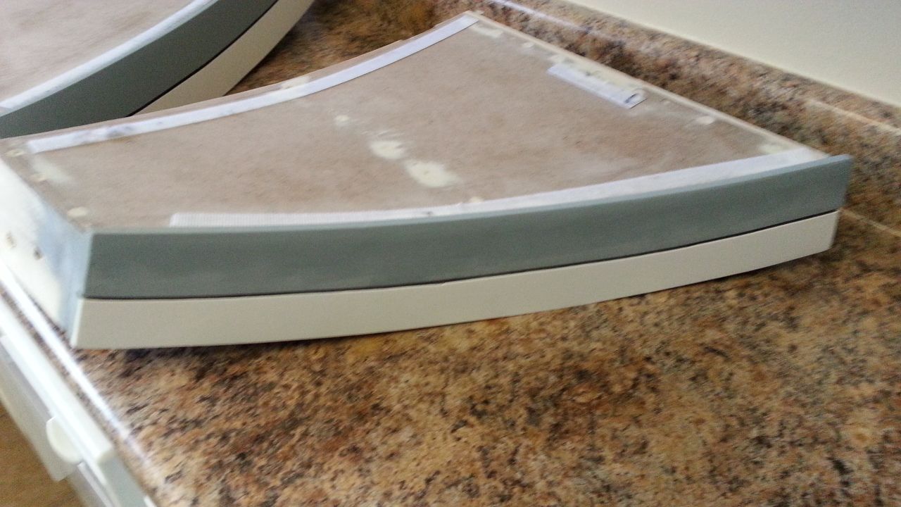

Hi Gang,

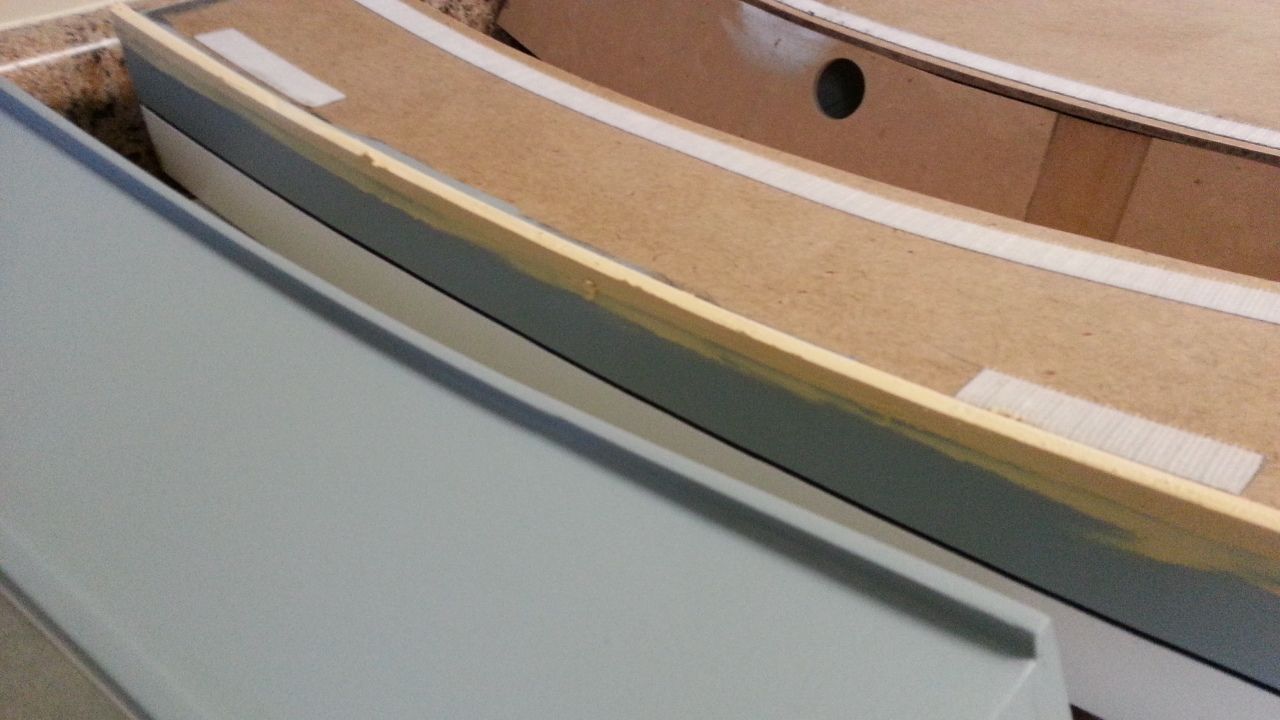

Some early Monday morning updates...
This panel was tucked away and still had the old paint - glad I found him before the show
The last of the sanding for this little guy
Done
These beams are done
Stay Tuned!
Hey T,
Believe it or not - the side panels are not the issue - it's the window channels themselves. Other than the extra height on the horizontal beams, everything lines up exactly where it's supposed to go. I just didn't take the time to think through how the window channels would / should be applied.
So... I'm going to look at how difficult it will be to remove the existing window channels (UGH - I'm crying just a little bit) and then reapply them in their correct positions.
I have to ask myself... do I want it done or do I want it done right? :facepalm
