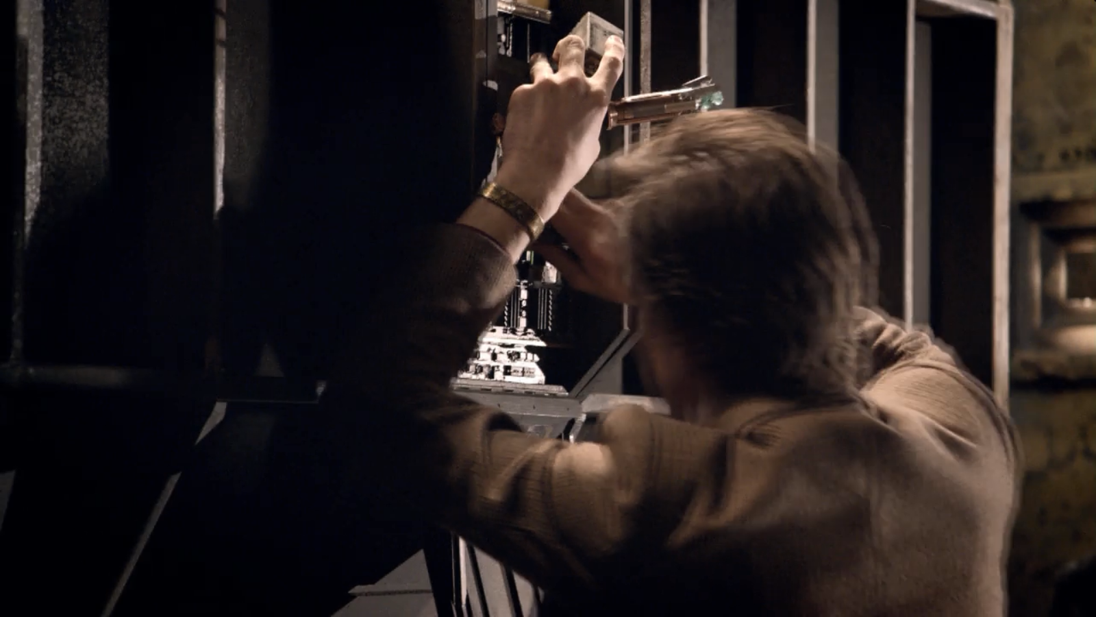

PROBLEM NUMBER TWO (the big one): Upon going back for some reference from the show, it became increasingly apparent that the sonic's core and emitter aren't really all that green at all. And I can't, for the life of me, figure out what color it really is, or what kind of resin/dye to use to replicate it. Here's some screen grabs to show what I mean:
Here is the very first appearance of the sonic screwdriver. It looks a lot bluer and more translucent than any of the ones I've seen.

According to Nick Robatto, the oriy prop maker, the emitter and core are made of a clear resin with 3 pigments mixed in: green, white, and black.
Would've never guessed! it just looks so... BLUE! D:
