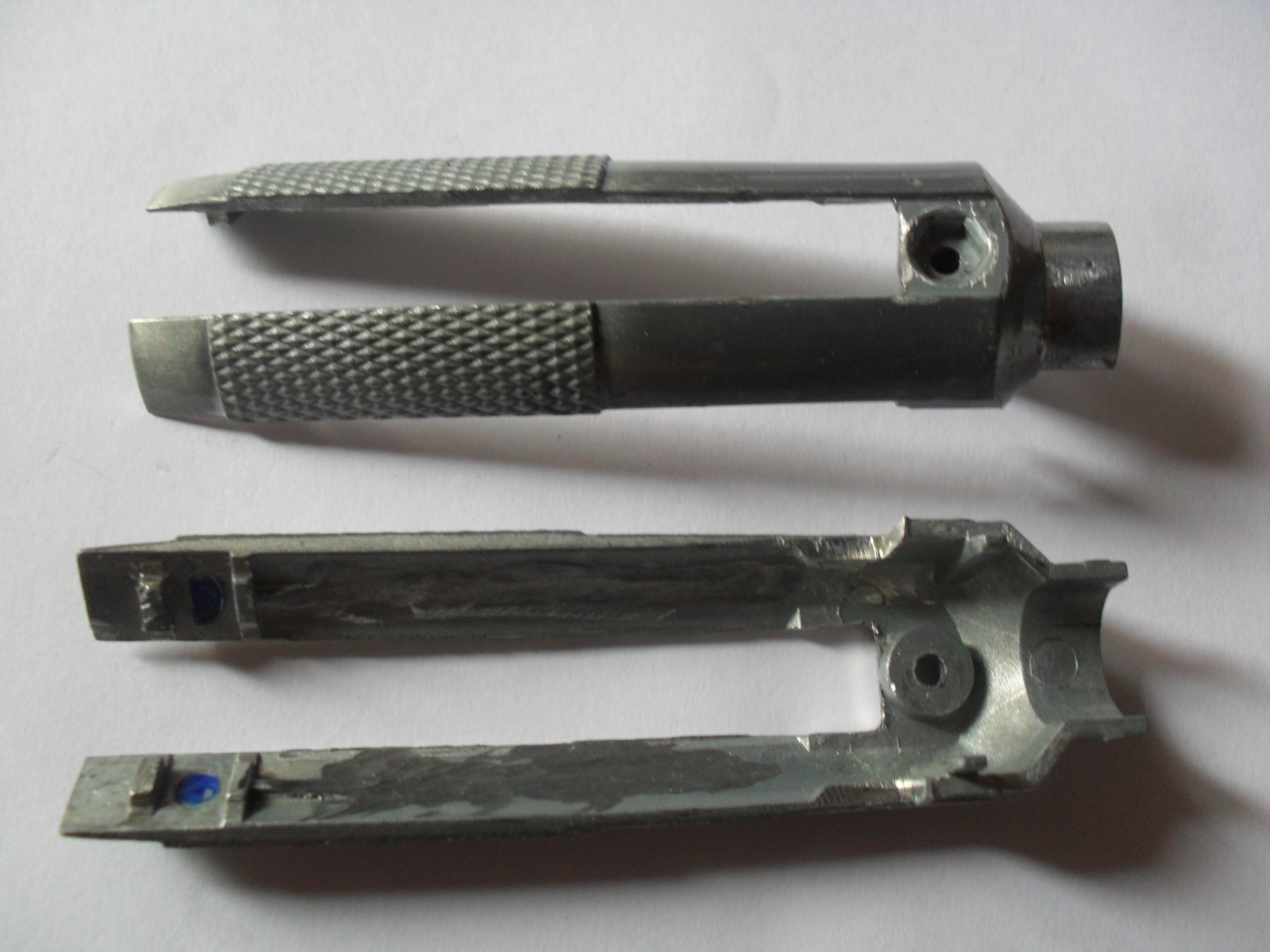

Now the claws are removed you can see the nut & screw that hold the head together' remove and keep the nut and screw , the head splits into two, 'arm" pieces leaving a copper core cylinder and a black inner core.
http://www.therpf.com/asset.php?fid=219207&uid=8861&d=1378310356
The black core end piece is cut off and retained - discard the remainder, the cylinder and arms need to be cut and filed down , to allow free movement , so the 'arms' that will hold the emitter head and core , can freely extend up and down. There is a lot of cutting and filing to be done and care must be taken to get this right or your sonic will not extend and retract properly , allow at least two days to this task alone ( it is that important to get right) the black end piece that was removed is glued to the bottom of the copper cylinder after adding an inner acrylic tube liner . The claws can be re-fitted to the head using the 'bracket' method outlined on the forum pages , you can see that the hollow claws have been filled with epoxy, but be careful not to cover the pivot point or they will not work , I preferred to use the claw holder available on Shapeways site and a custom set of tension springs , the effect is the same (you can use small cut down (steel only) safety pins - they do work! ) just make sure that everything in the head is secure.

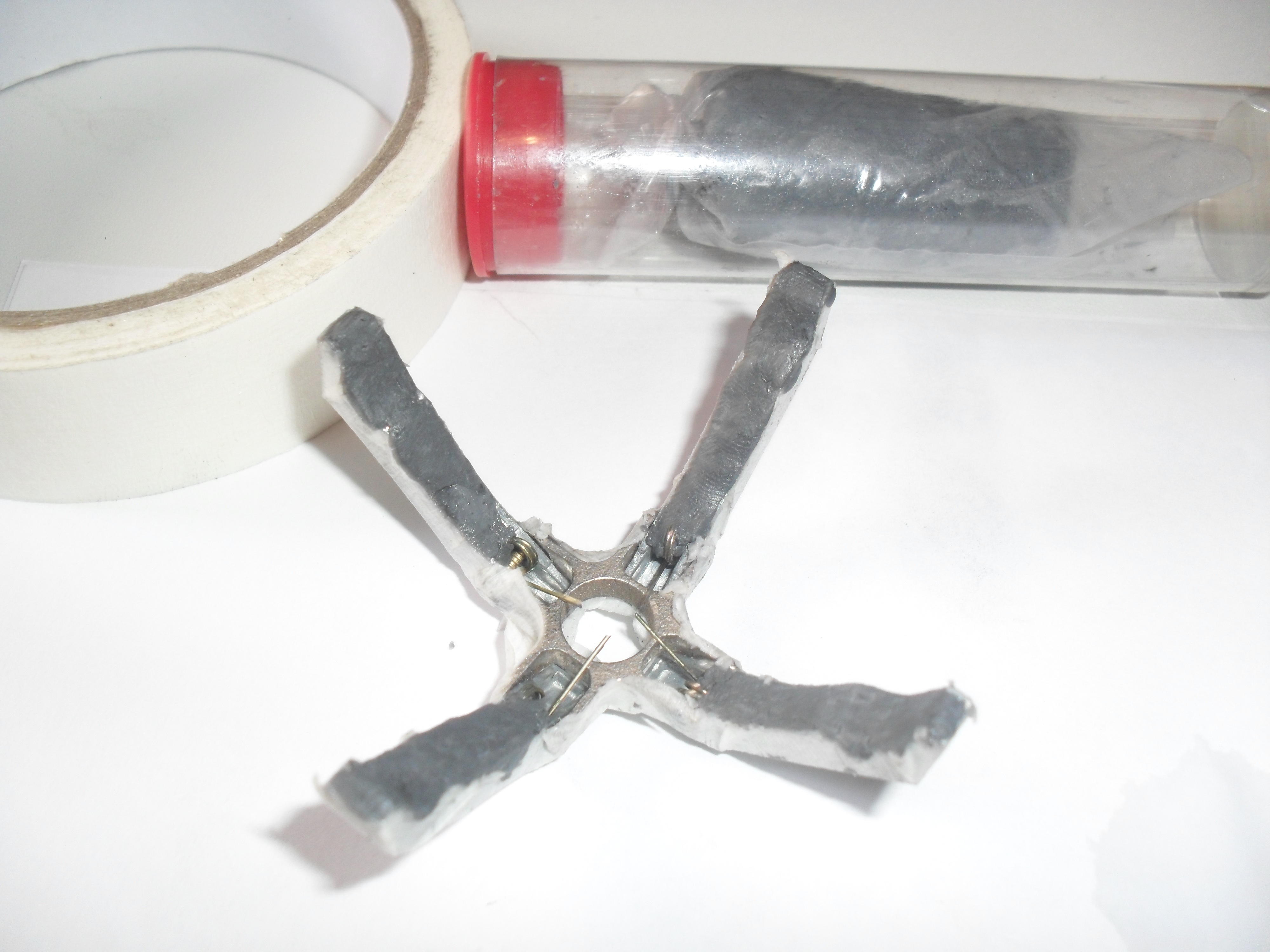

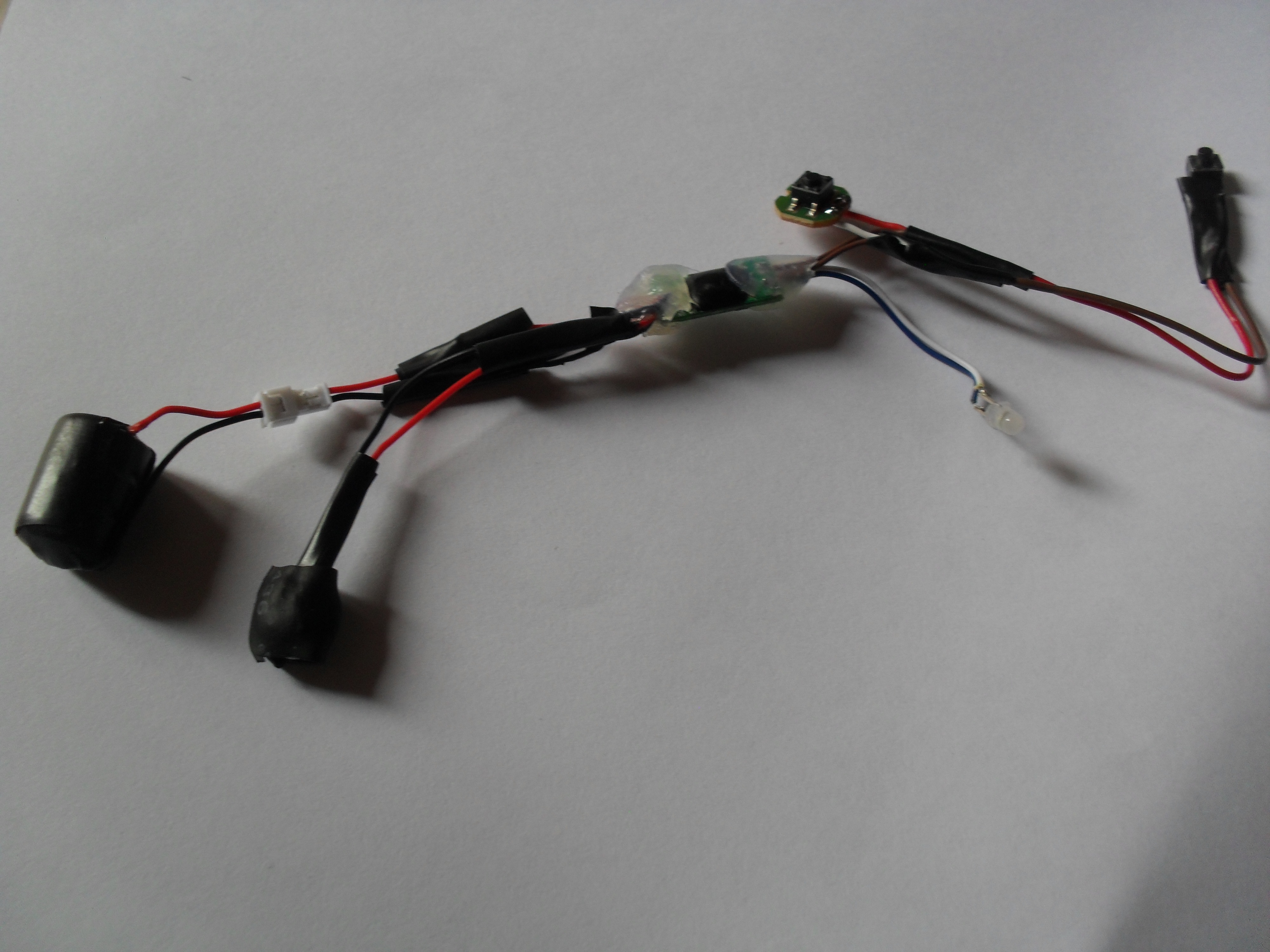

I now turned my attention to the CO toy and carefully removed the soundboard, power supply and led. Since the speaker on the toy is so small, I devised an additional fix and 'soundbox' made out of acryllic tube which effectually doubled the output sound . I also added an additional connector to the board and battery pack , making the power pack replaceable.

To the outer 'inner core' piece I re-fitted the bottom switch and the copper button . A further micro button switch was fitted to add to the inner core, these two switches were connected together and then connected to the switch position on the sound board and tested. The battery pack & sound board were the fitted in place inside the outer handle . I also added a high power 3mm green led replacing the CO toys original.

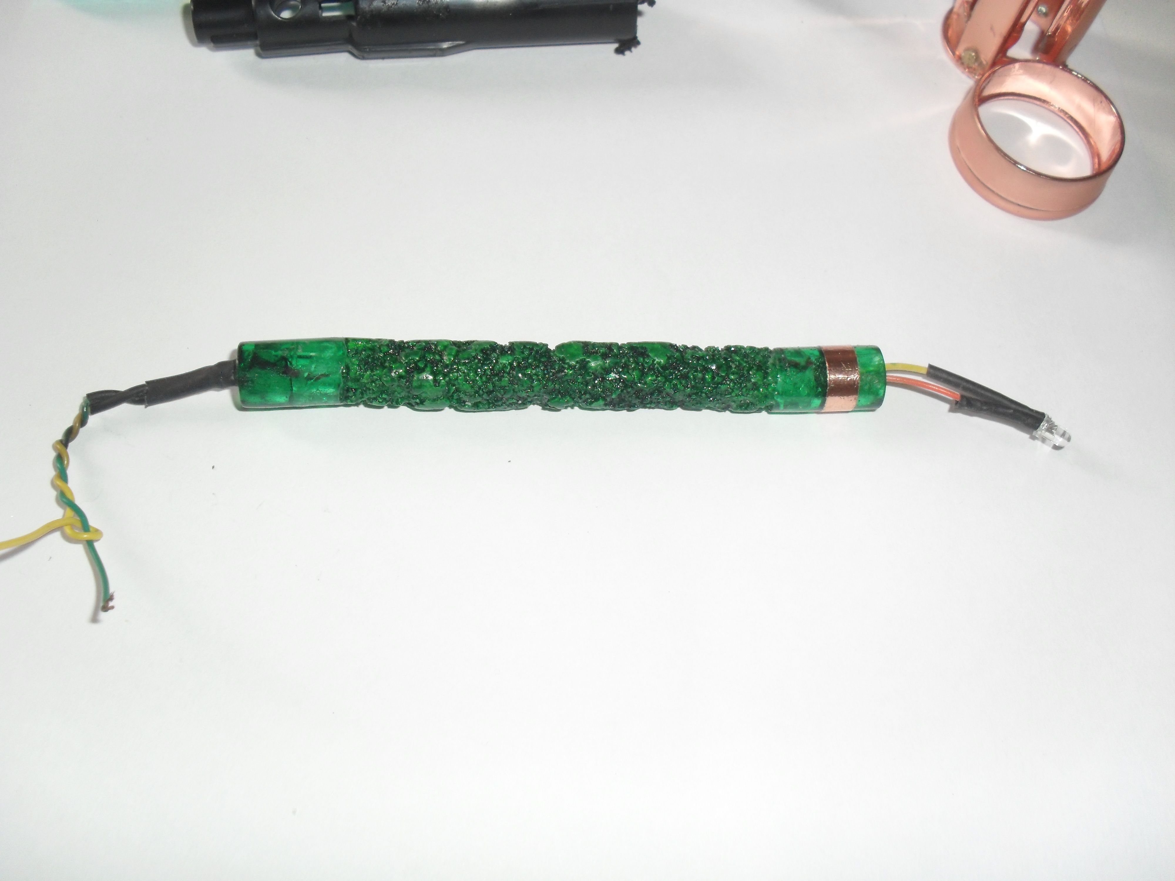

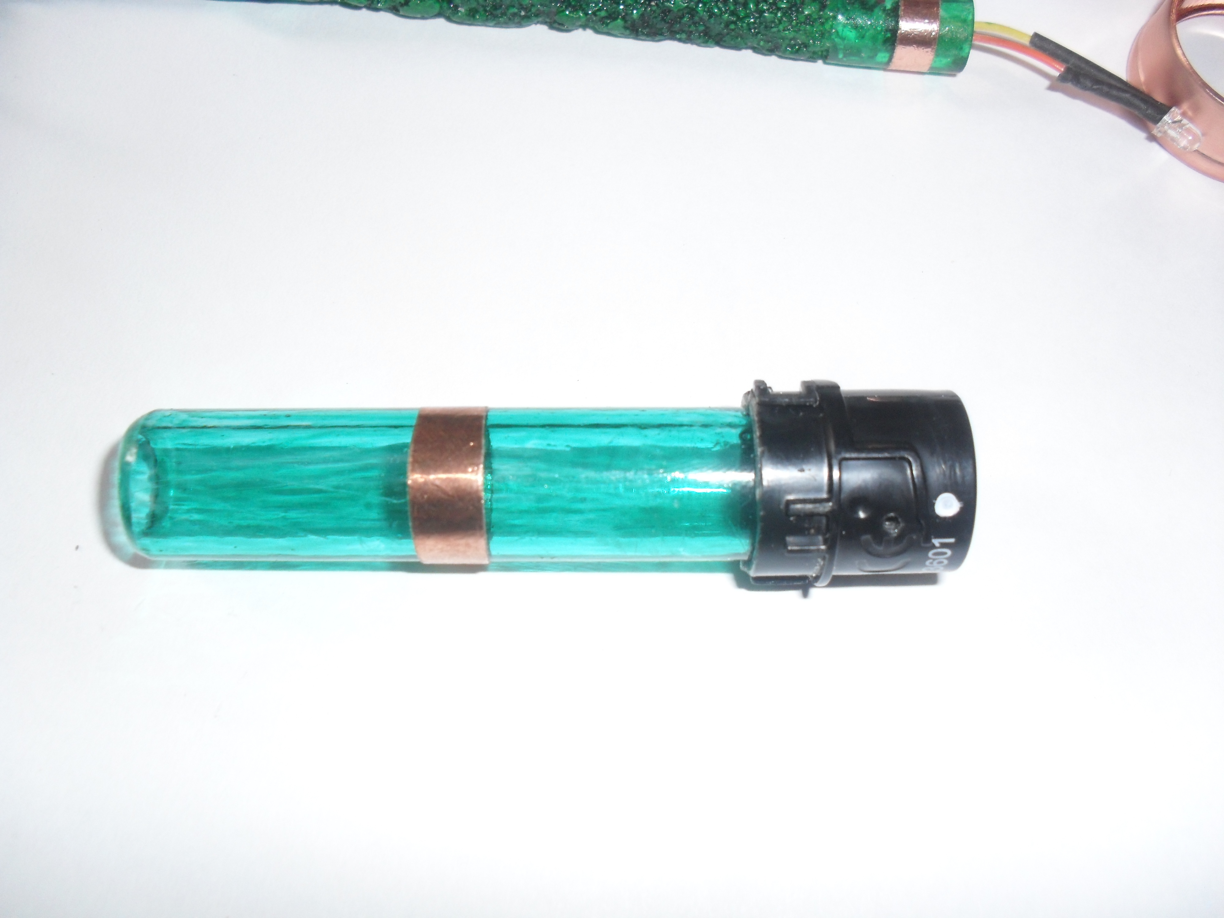

I wanted to add an additional feature to the core that's never been done before, since the Dr Who story line was/is that the TARDIS 'grows' the sonic, and the TARDIS console glows an emerald green, I tried to replicate this effect - after many failed attempts I ended up using two UV LEDs and a UV reactive fluorescent acrylic which makes the inner core and emitter head glow the same as the TARDIS core and the filming props head , I have developed this much, much further now , which means I can offer a core that is now very organic looking, adding a unique effect to an almost perfect prop replica.

The emitter core is then connected to the led to go in the emitter head and also connected to the sound board led connections and tested , the new core is fitted to the head with the emitter in place , and slid over the copper cylinder, the top and bottom pieces are re-connected, making sure the top half has it connection ring in place , the retained screws are reconnected securing the two halves together and the retaining rings screwed down and the sonic replica is finished.

Since the inner core of the copper cylinder is fitted within the colored acrylic tube , this allows the emitter core to slide easily up and down, the connecting wires are secured to the inner black core with hot glue, this stops the core flying out if you flick it very hard also the copper core also has retaining lugs to 'lock' it in place .

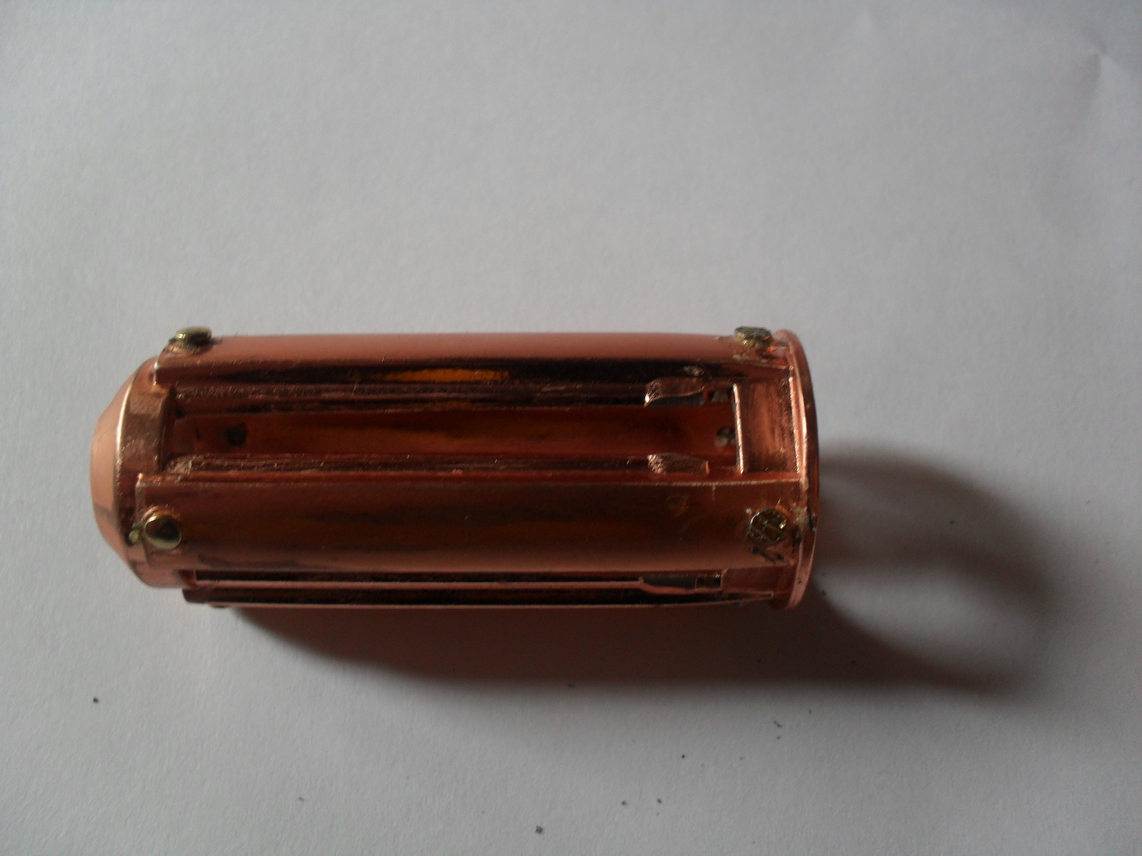

To ensure a smooth transition of movement , the cage and the arms must be cut and sanded a lot !! , if you look at the photos, especially on the arms and the copper cage -the inner ridge - this is ground or sanded down fairly smoothly - the lugs at the end of the arms are also reduced , this is so they 'jump' the bottom clip in the copper cage ,and 'lock' at the top when flicked open , the cage lower bars must also be cut out. Mostly, it is sand - test fit, sand -test fit, etc., etc, until you get a smooth trasition - I took two days of sanding and testing to get this right , I also used an inner guide, a tube of acryllic that holds the emmiter core straight and stable , you can see it attached to the black end cap in the photos. Once you get this right - inertia , when you flick it will send the heavy head up the inner fixed shaft and the head will 'lock' open and will stay open until you apply gentle pressure ,the lugs will slip over the set at the top of the cage and further gentle pressure will close the claws and the sonic will remain closed until you flick it open again.

Here are a couple more shots of the core and the arms
Here you should be able to see the areas that need grinding/sanding down , the bottom clip needs trimming back and the ridge up the centre of each arm need smoothing back , also lastly on the arms at the top near the head inside you will find little guide ridges , these also need sanding down , how much depends on how well you remove the pieces from the copper cage
Here's the cage , you need to remove the solid bars at the base , cut or grind them back to about what you see here, I took two full days grinding, sanding and test fitting these parts together , do not forget to add an inner acryllic tube liner
