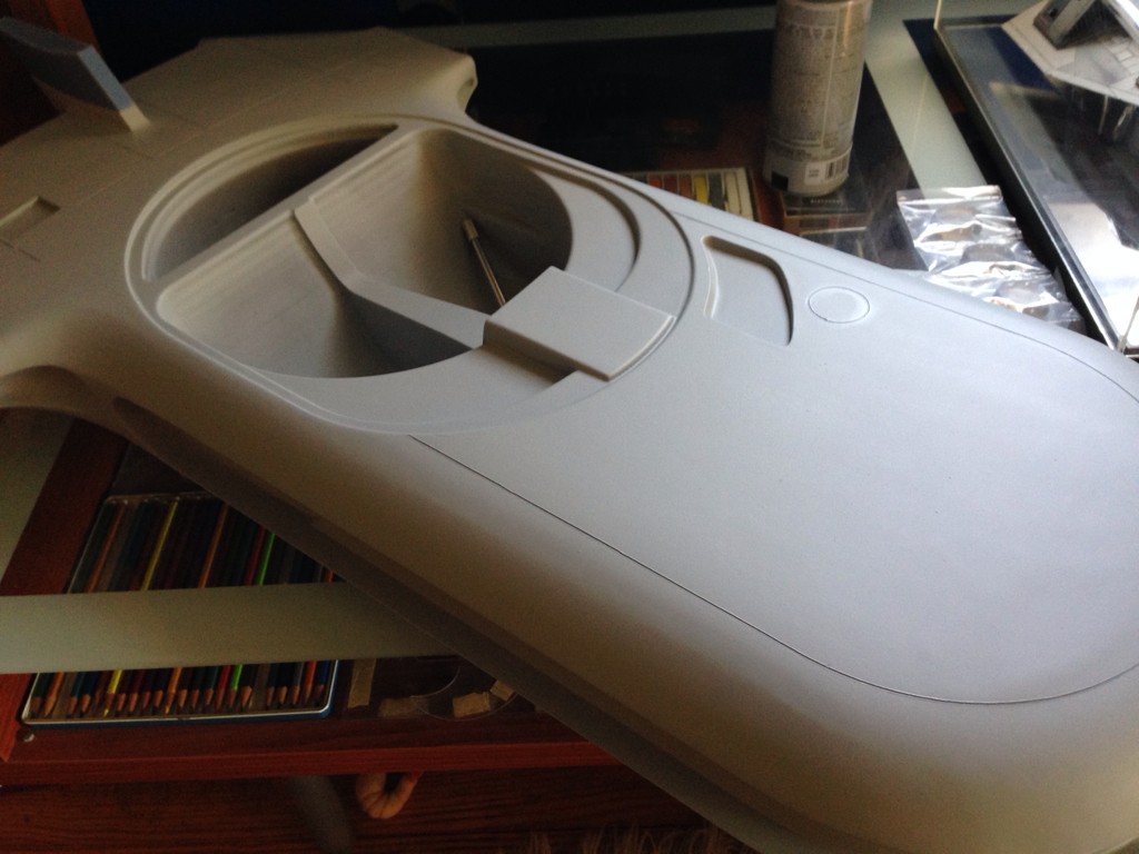

I have recently drafted a template I will laser cut out of 1/16th acrylic to use as a guide when cutting the panel line masks - I'm pretty happy how that problem was solved. On the 1:1 Landspeeder, the panel lines are very wide and shallow, so I decided the best way to tackle that is to mask them off with tape, and then do a few passes with sandable primer. Getting the curves right was gonna be a bear, but then I realized I have the original cad data, and I just went from that to describe the curves - voila!
ImageUploadedByTapatalk1399170260.462996.jpgpanel time

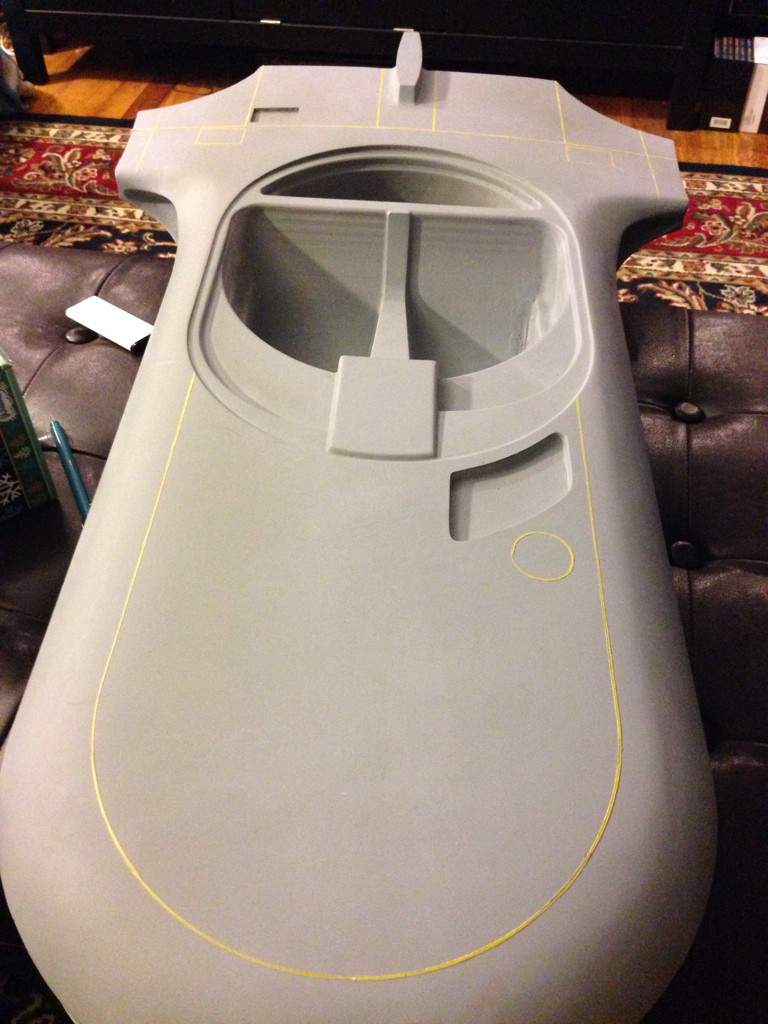

Tamiya tape! They just need a minor touch up here and there, some light sanding over all, and then I attack it with a Dremel for battle damage.ImageUploadedByTapatalk1399236671.452652.jpg
