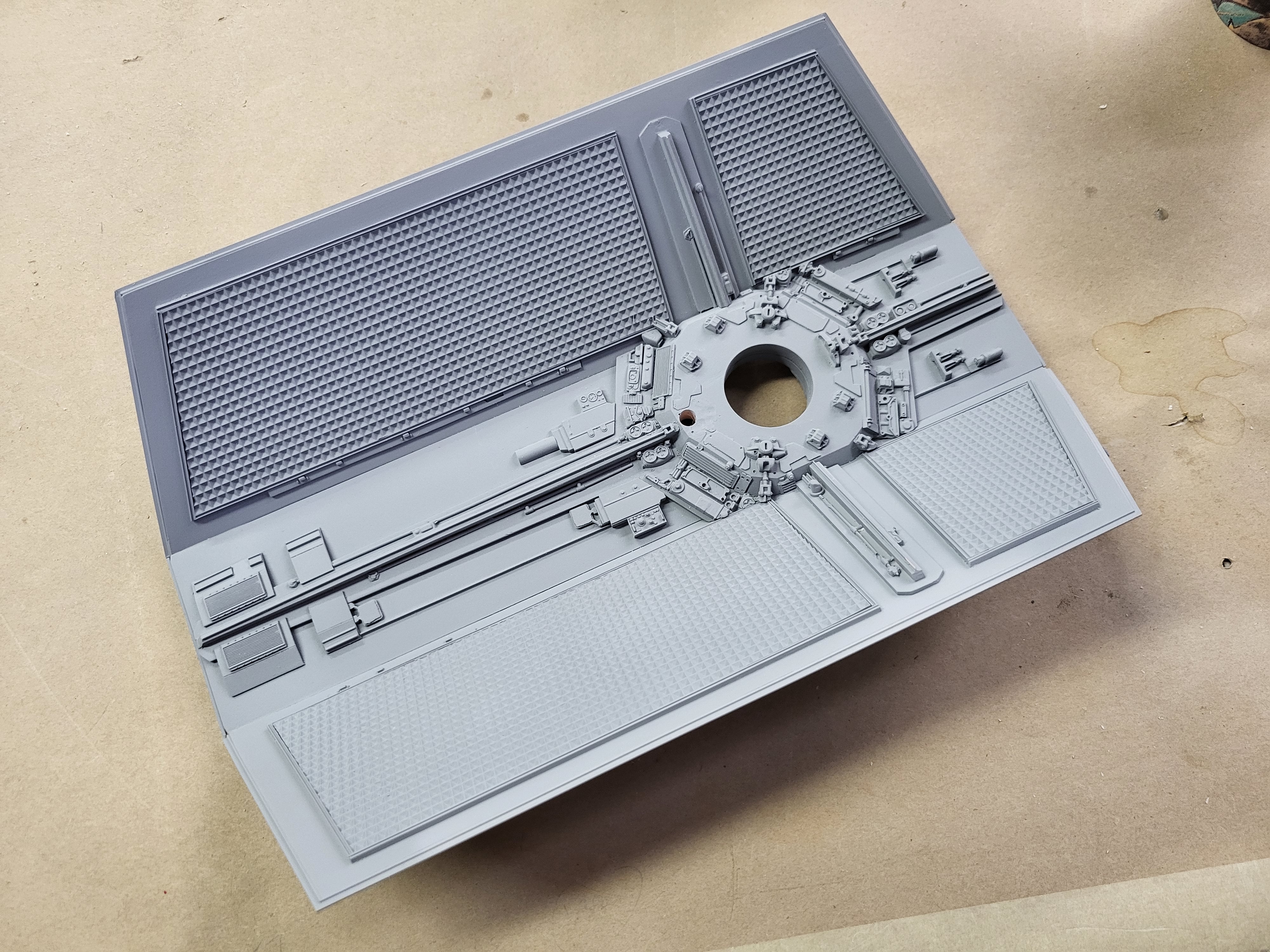

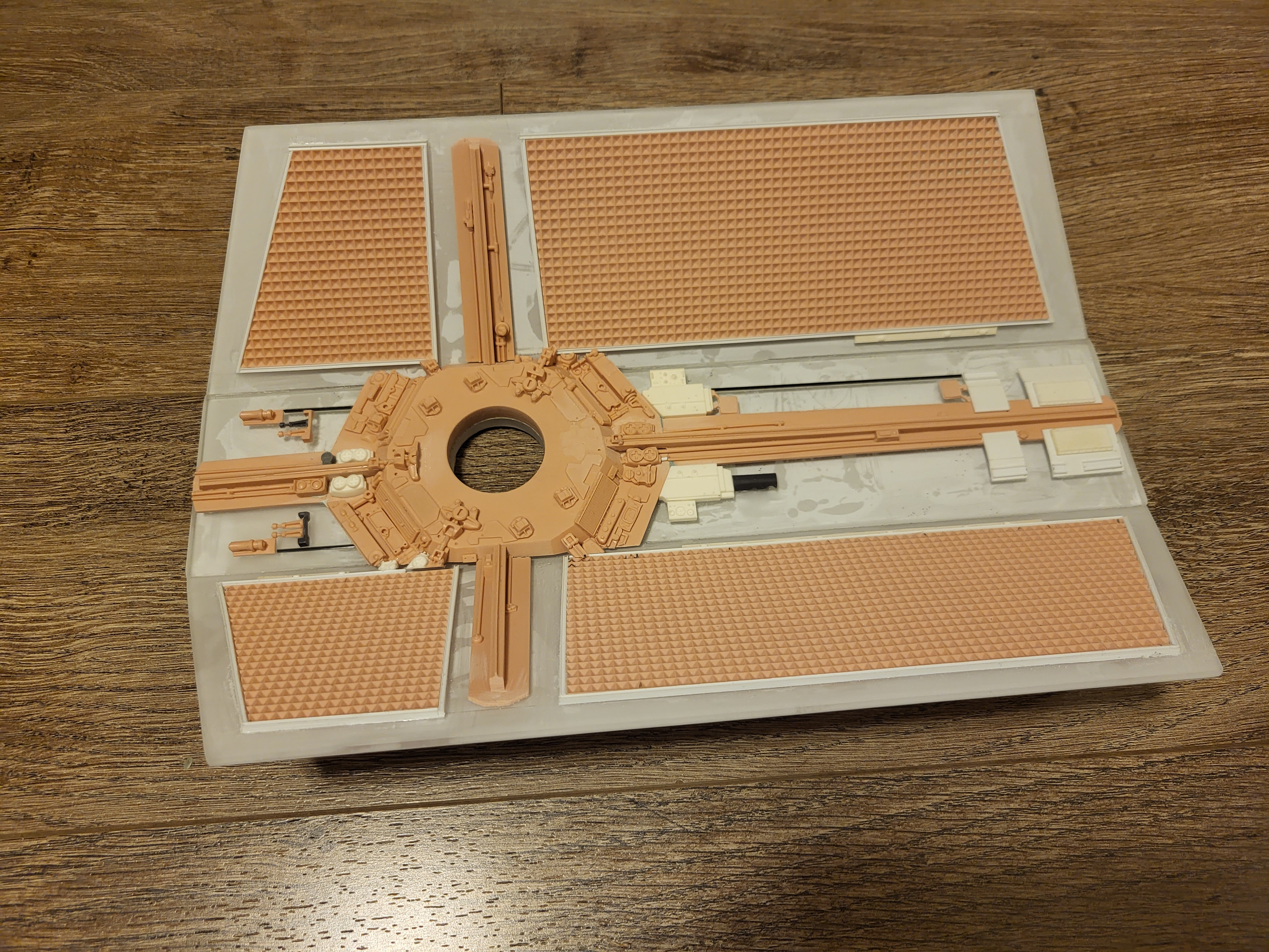

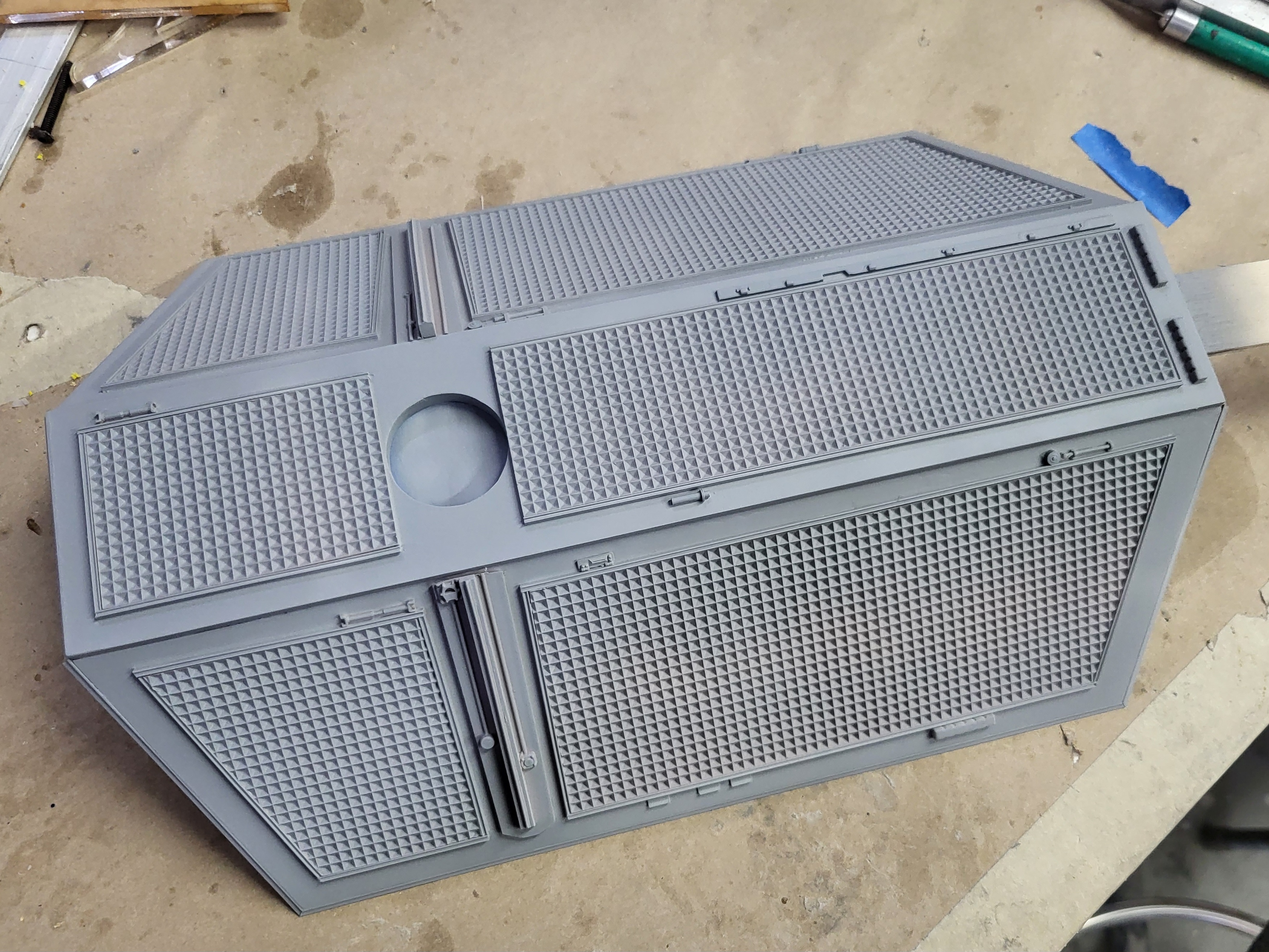

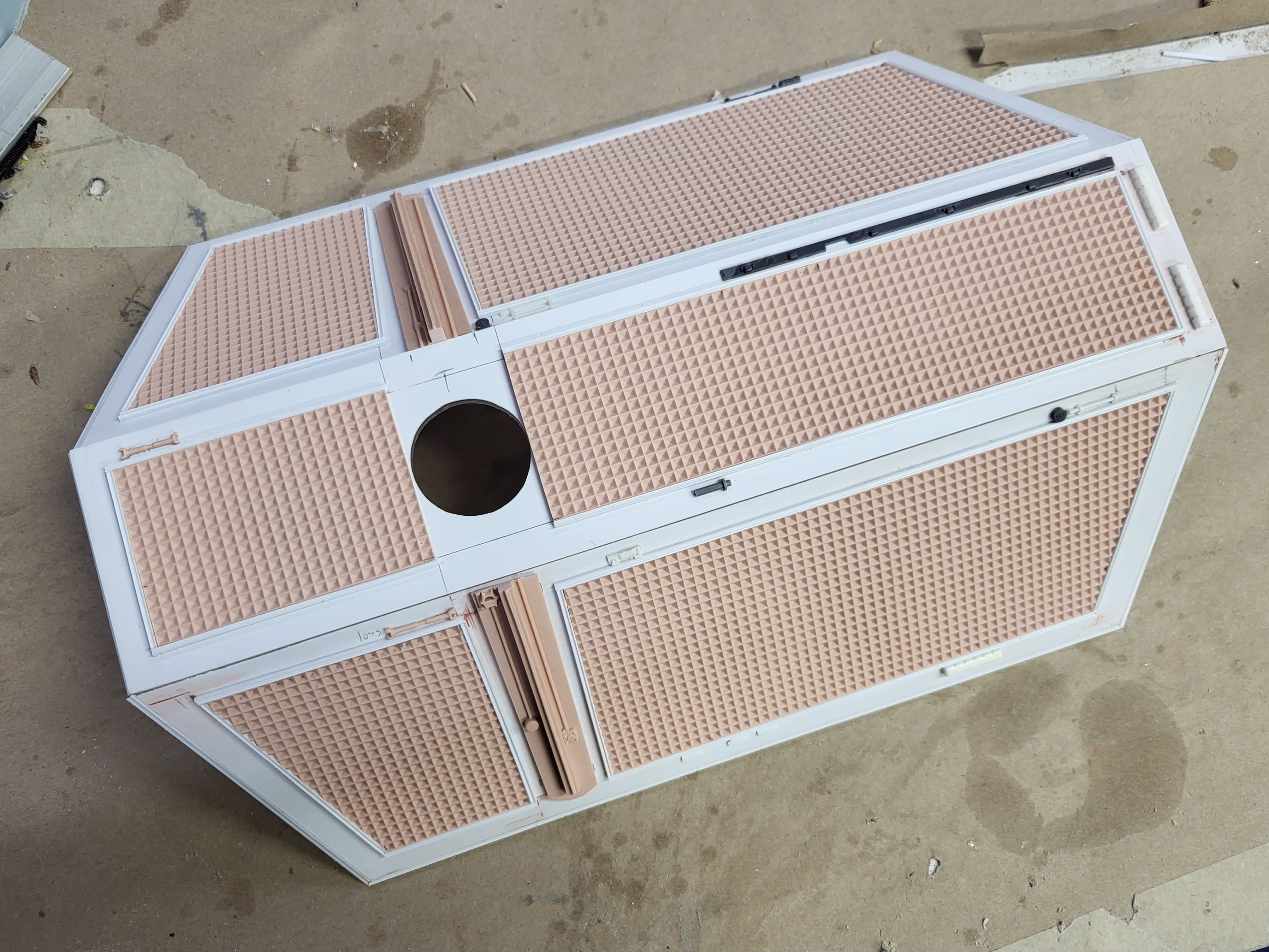

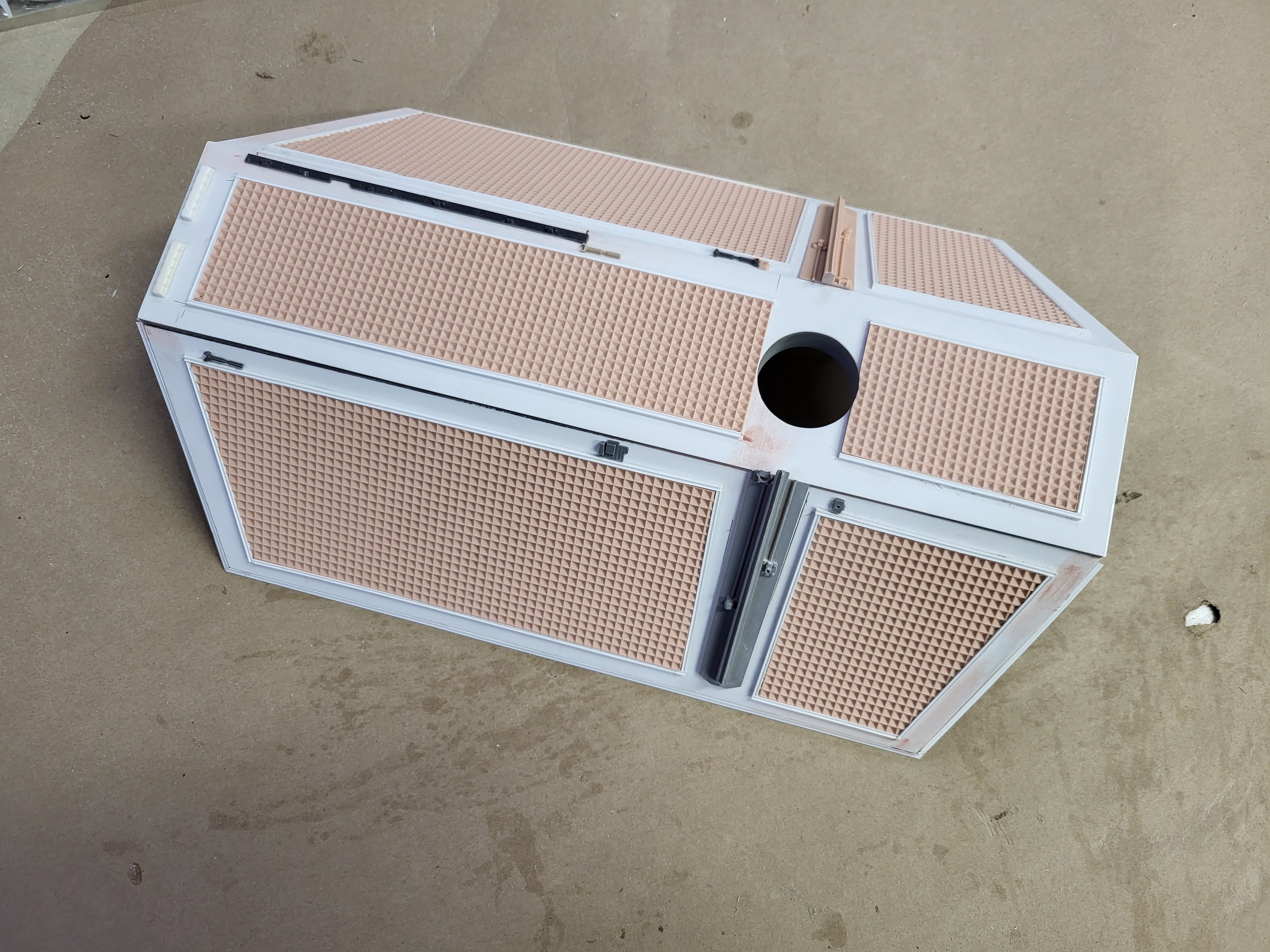

The first part I started with on this build that wasn't from my TIE Fighter project, was the wings.

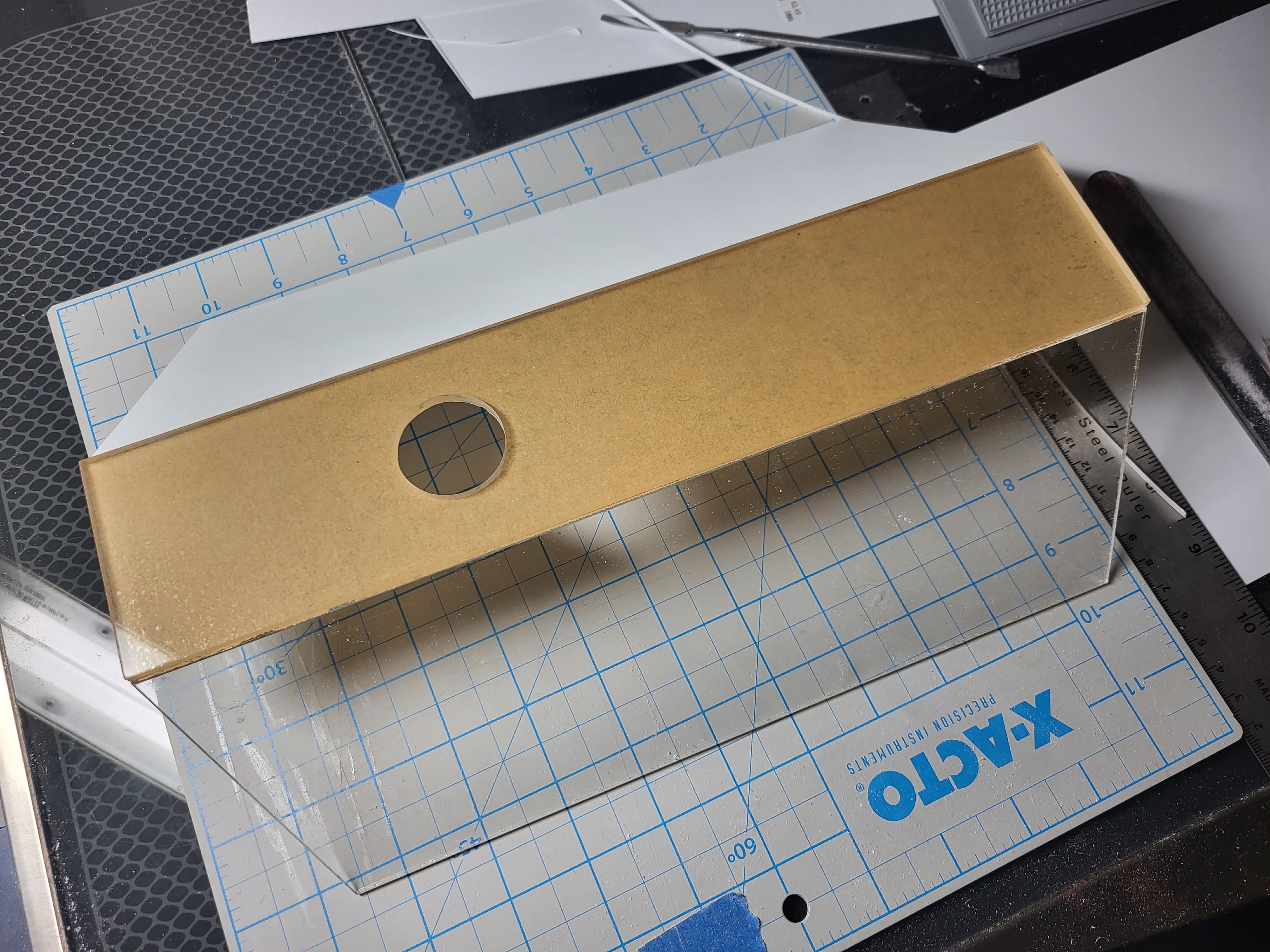

I did a lot of work on the computer trying to figure out the dimensions of everything and laser cut the acrylic for the wings. I couldn't find any acrylic that wasn't metric, no matter what the acrylic shop said. After cutting and gluing the wing parts together I compensated for the incorrect acrylic thickness with .015 and .02 sheet styrene.

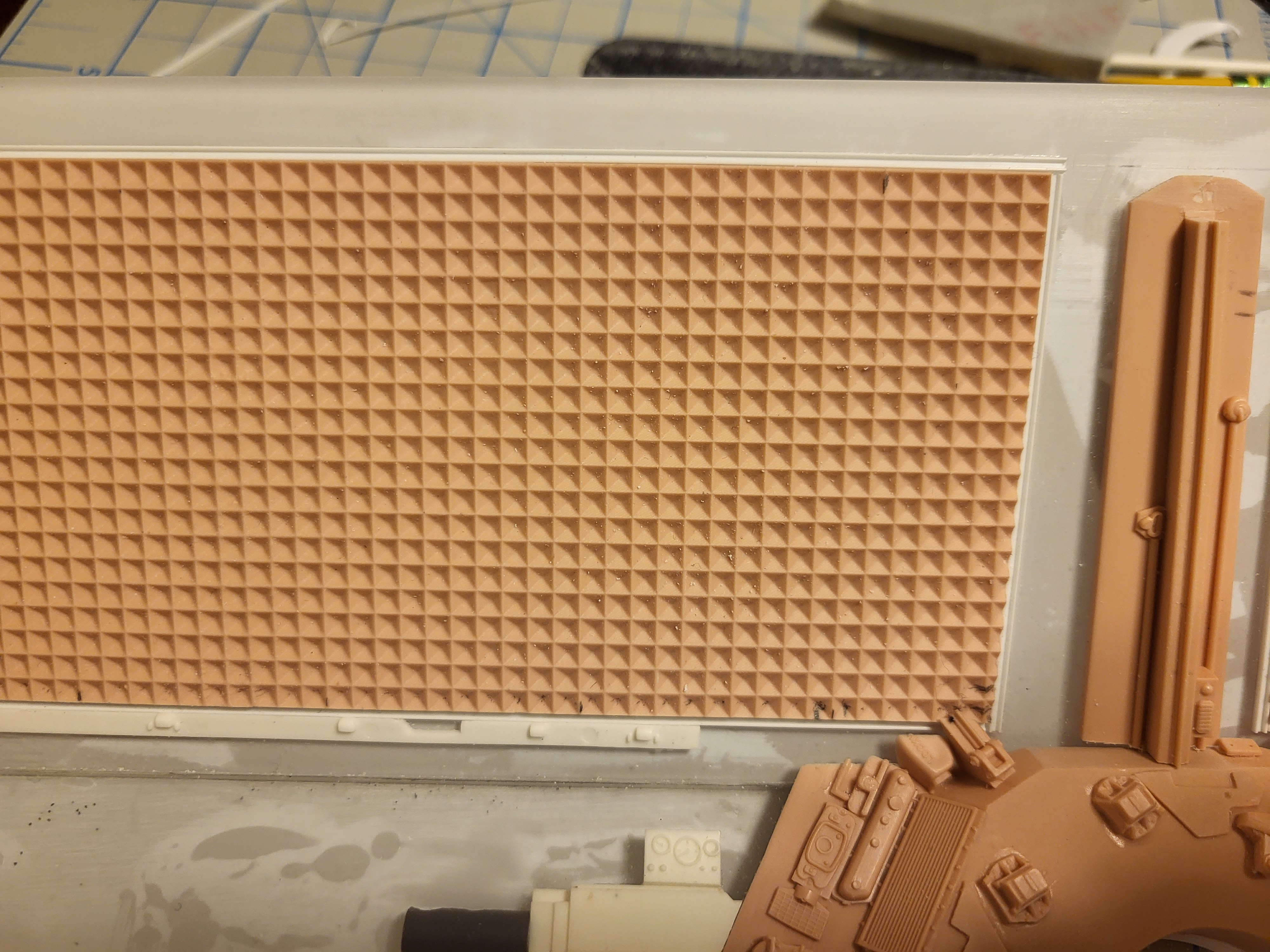

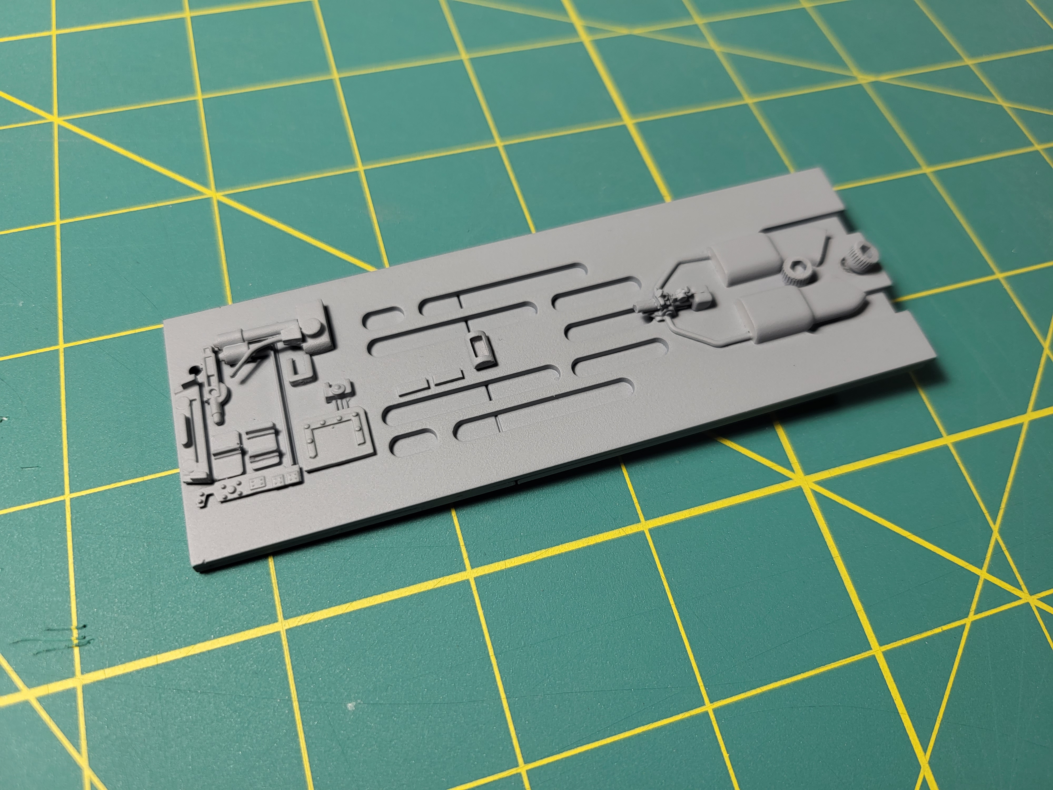

Next was cutting up TIE wing stars for the interior central detail piece and exterior and interior vertical ribs. After that I glued on the Panther G parts and sheet styrene.

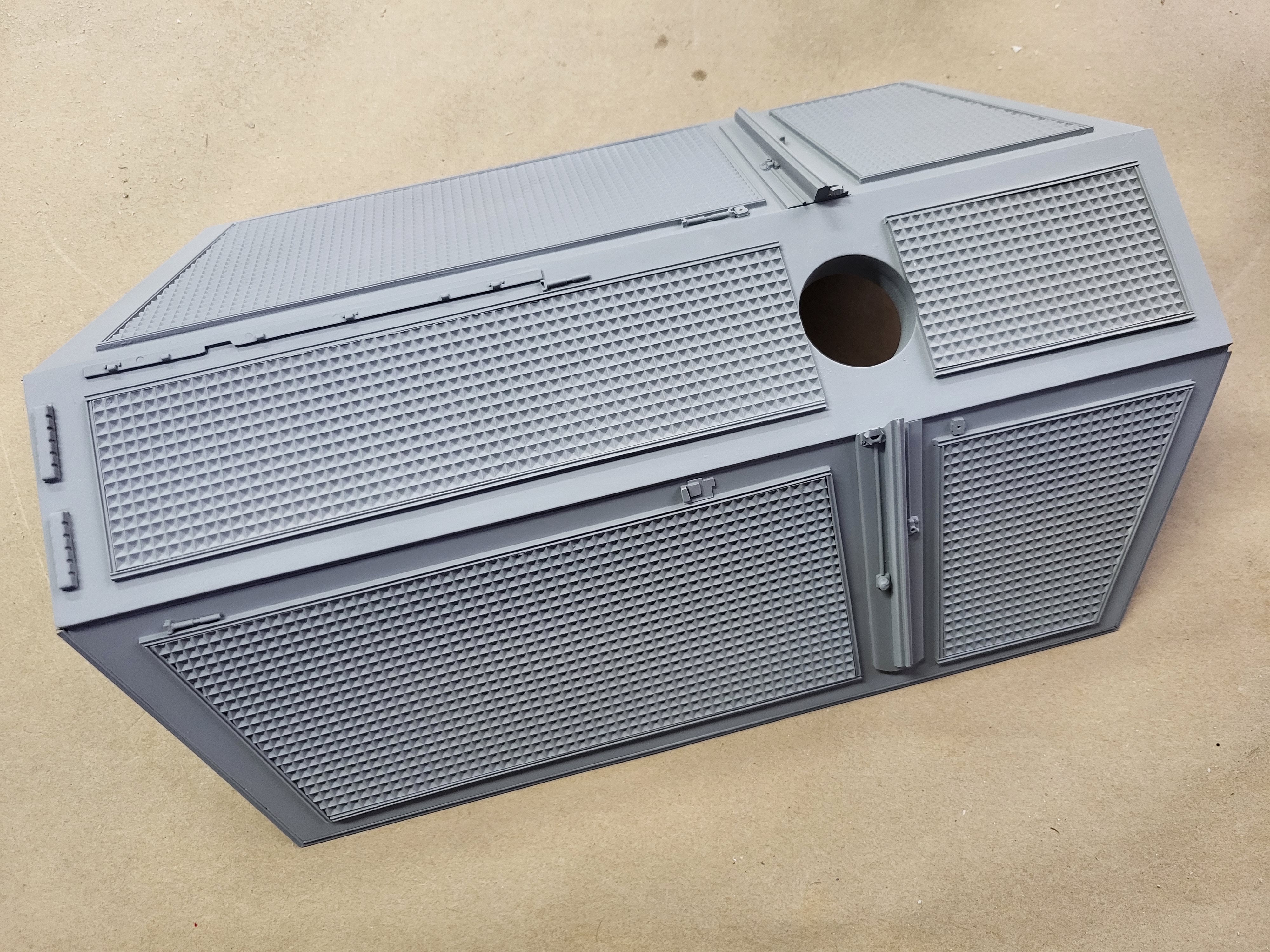

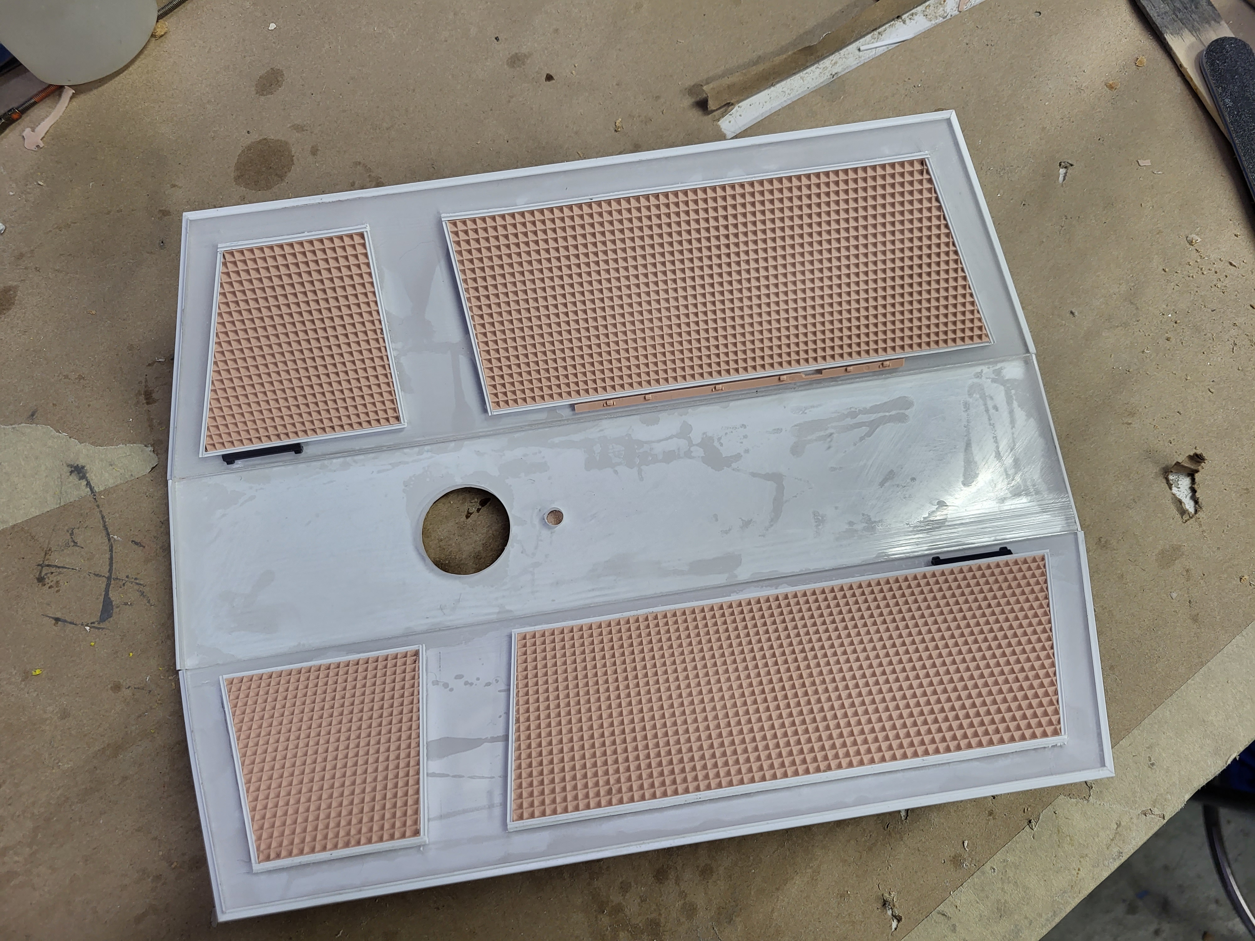

I could never find the correct light diffusion for the solar panels, so I modeled them in Rhino and printed them. I printed one master big enough for the largest of the solar panels (most of the panels are different sizes from inside to outside and from one wing to the other.) I then molded the master and cast all the solar panels, trimming each one to the correct size.

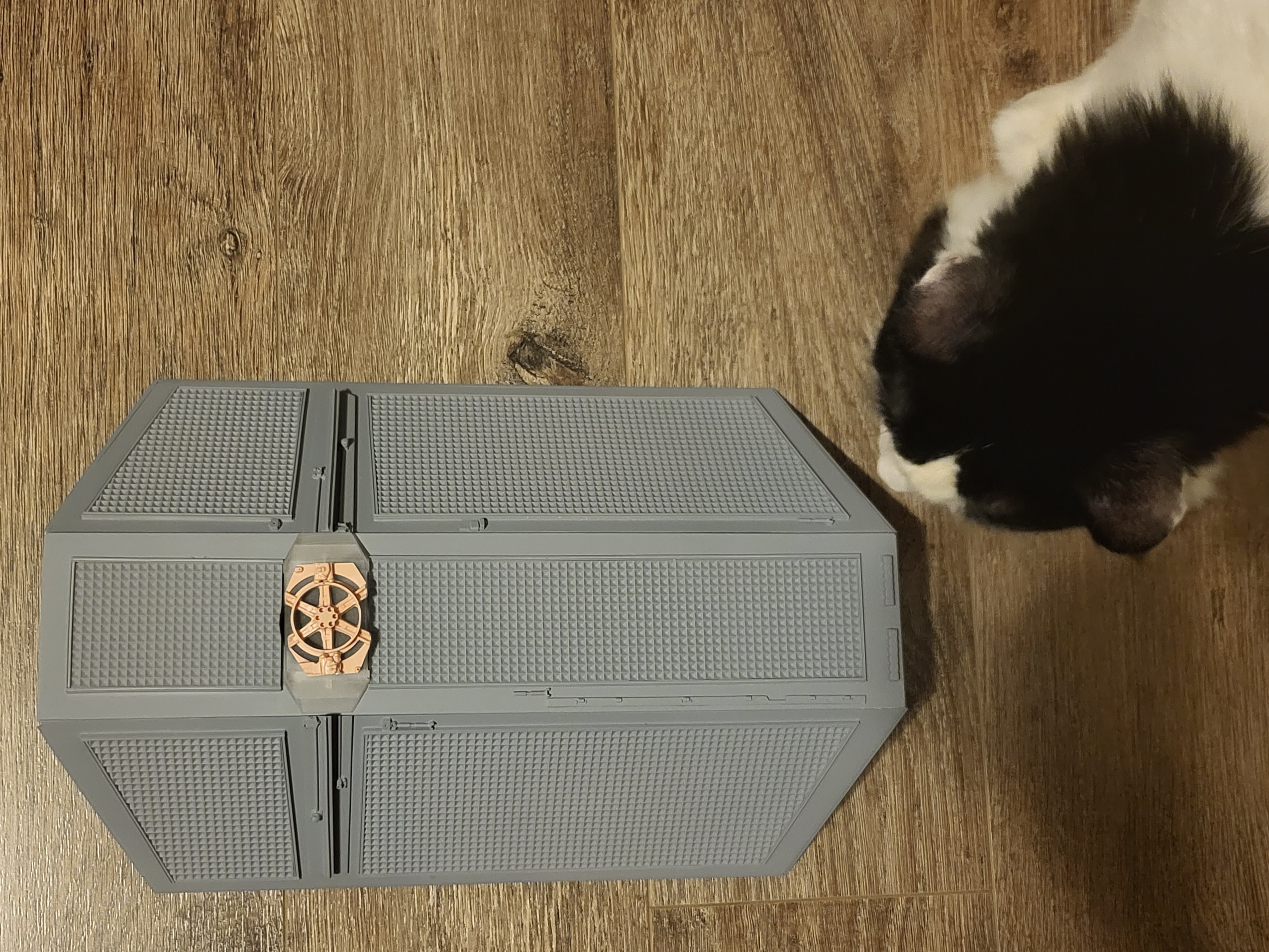

And cat for scale.

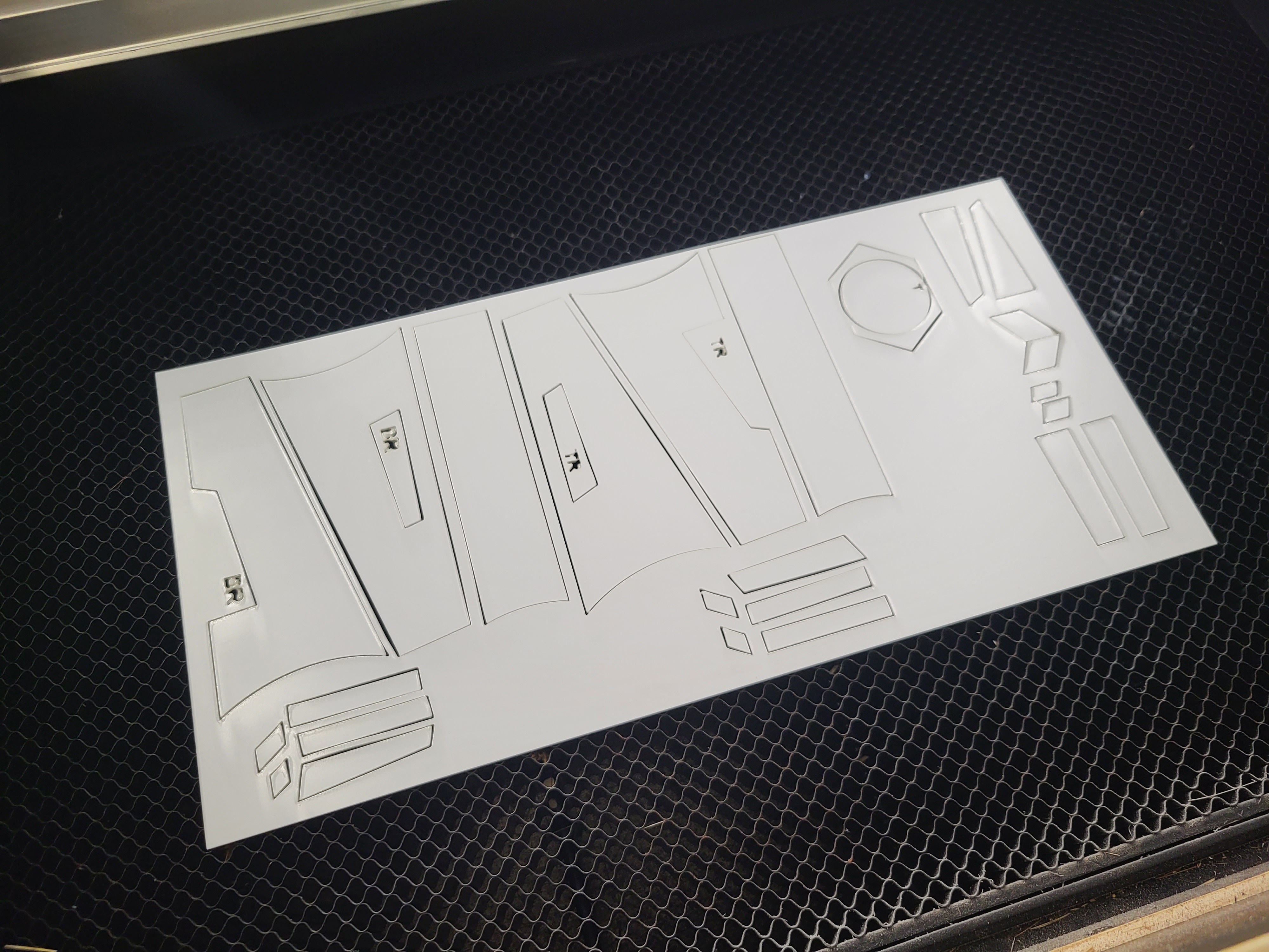

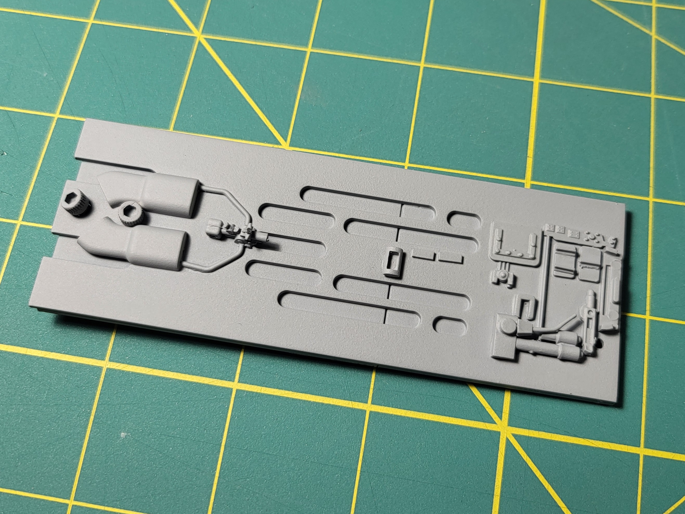

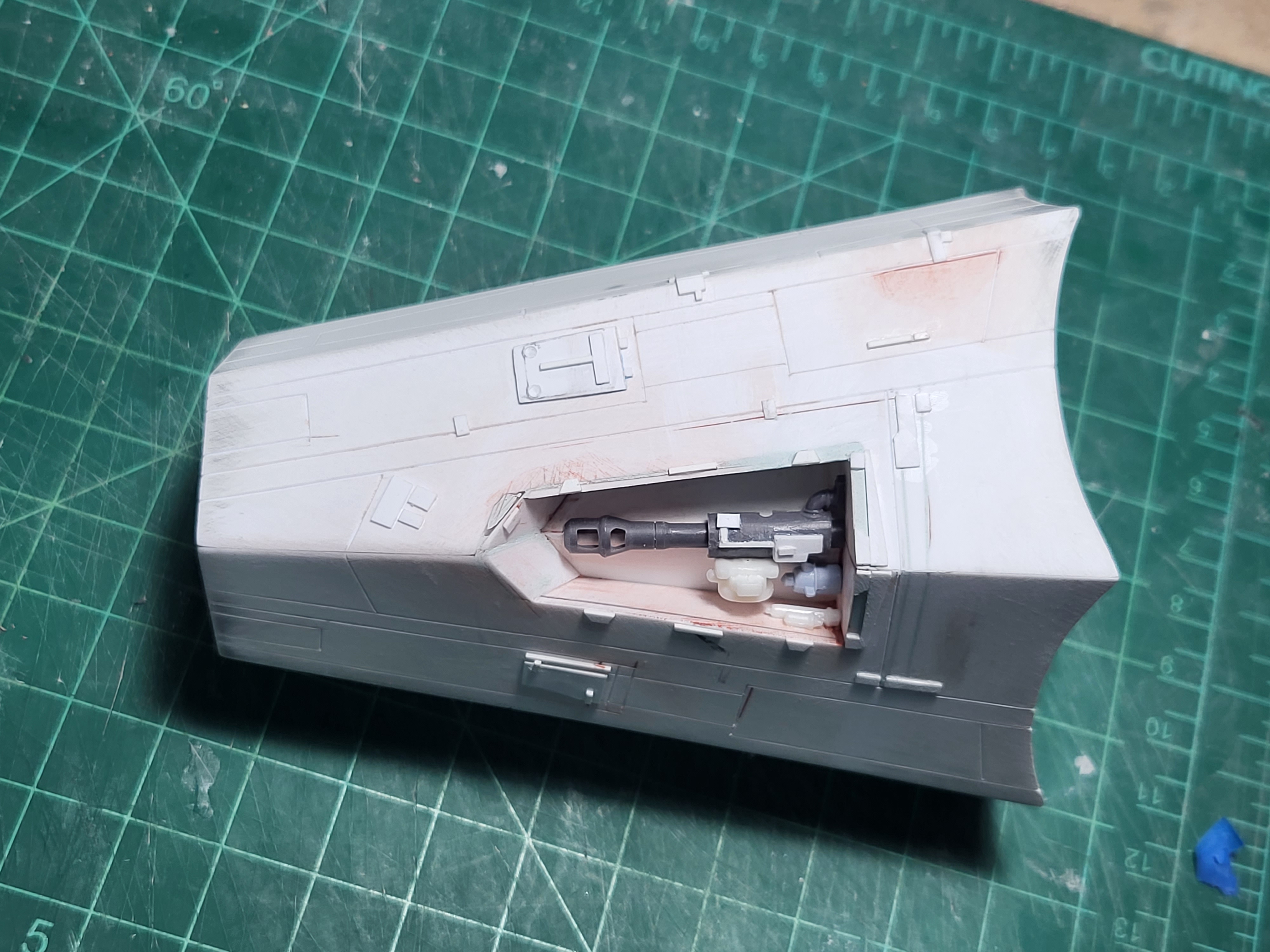

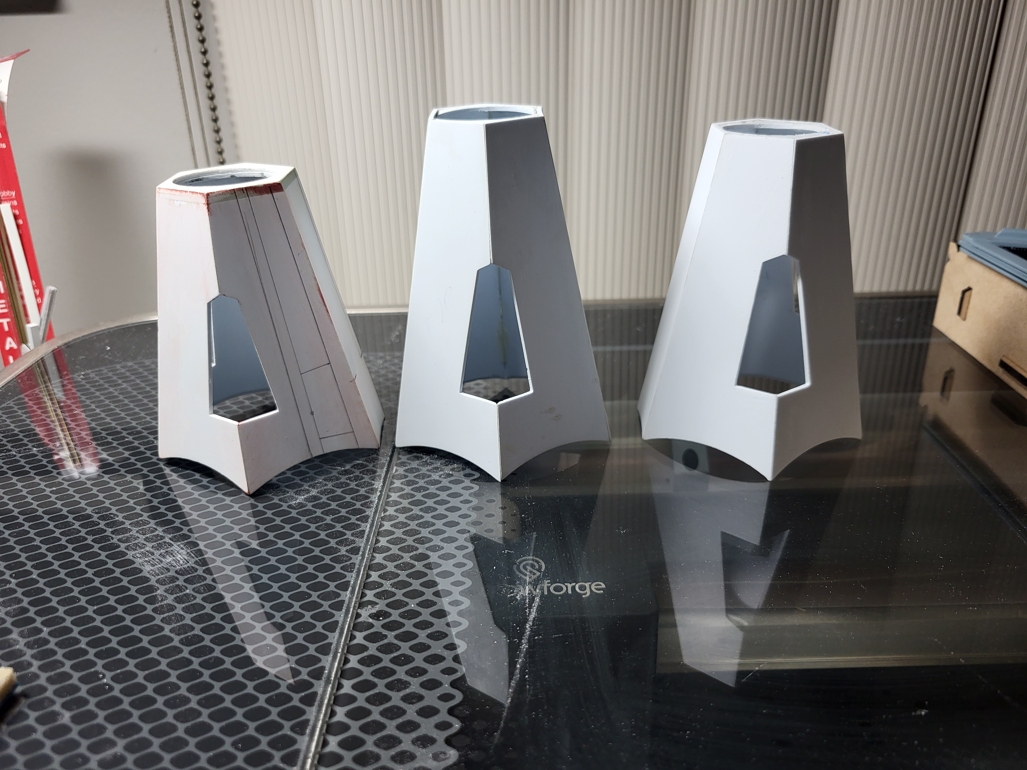

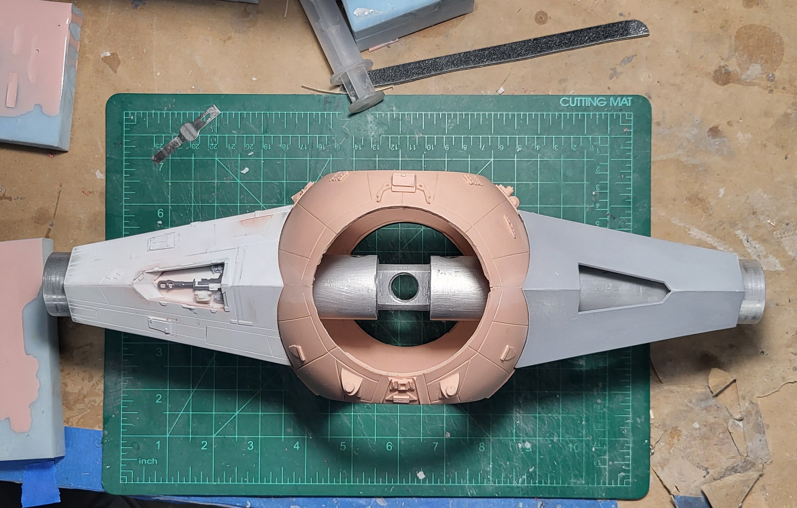

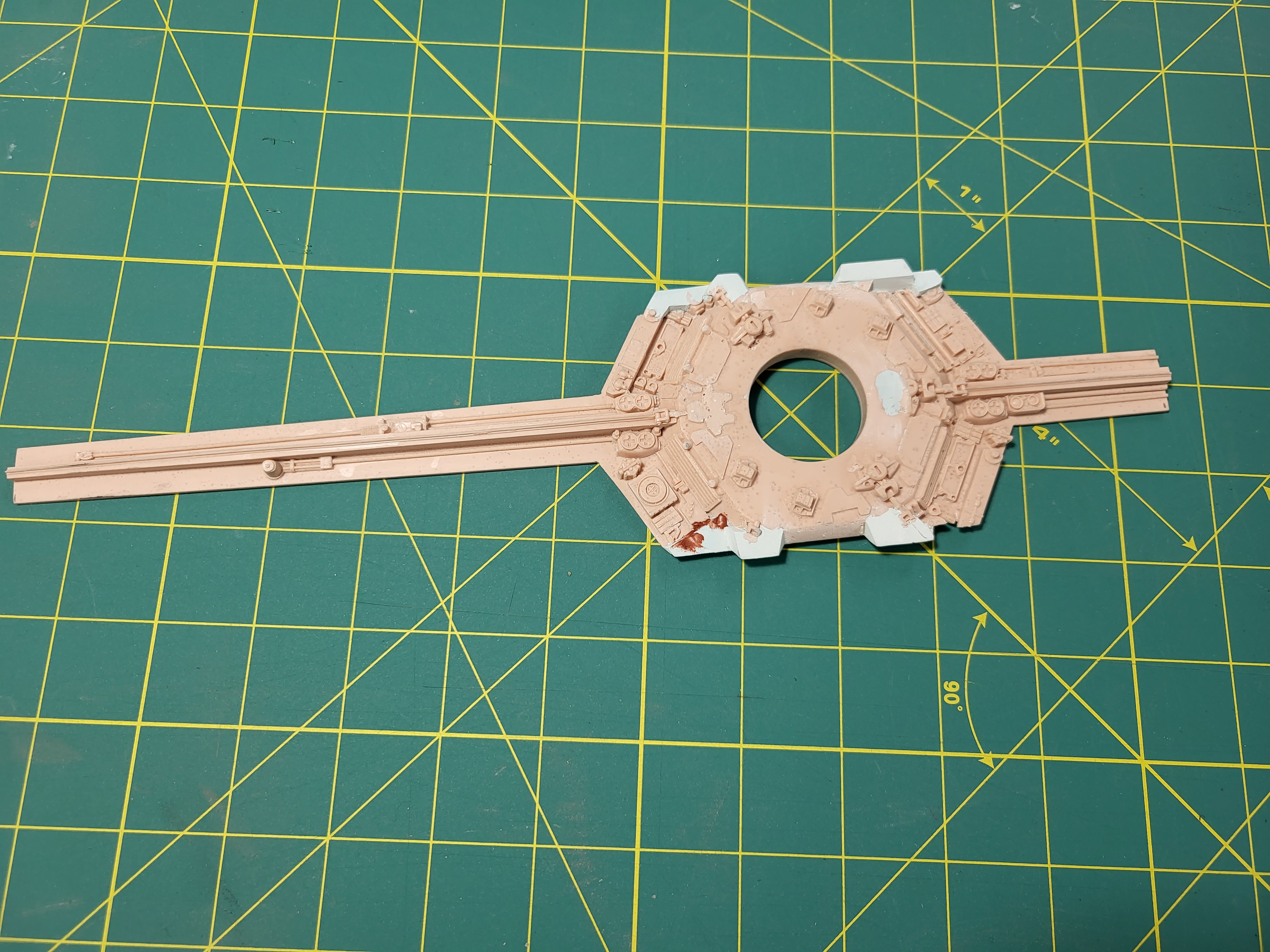

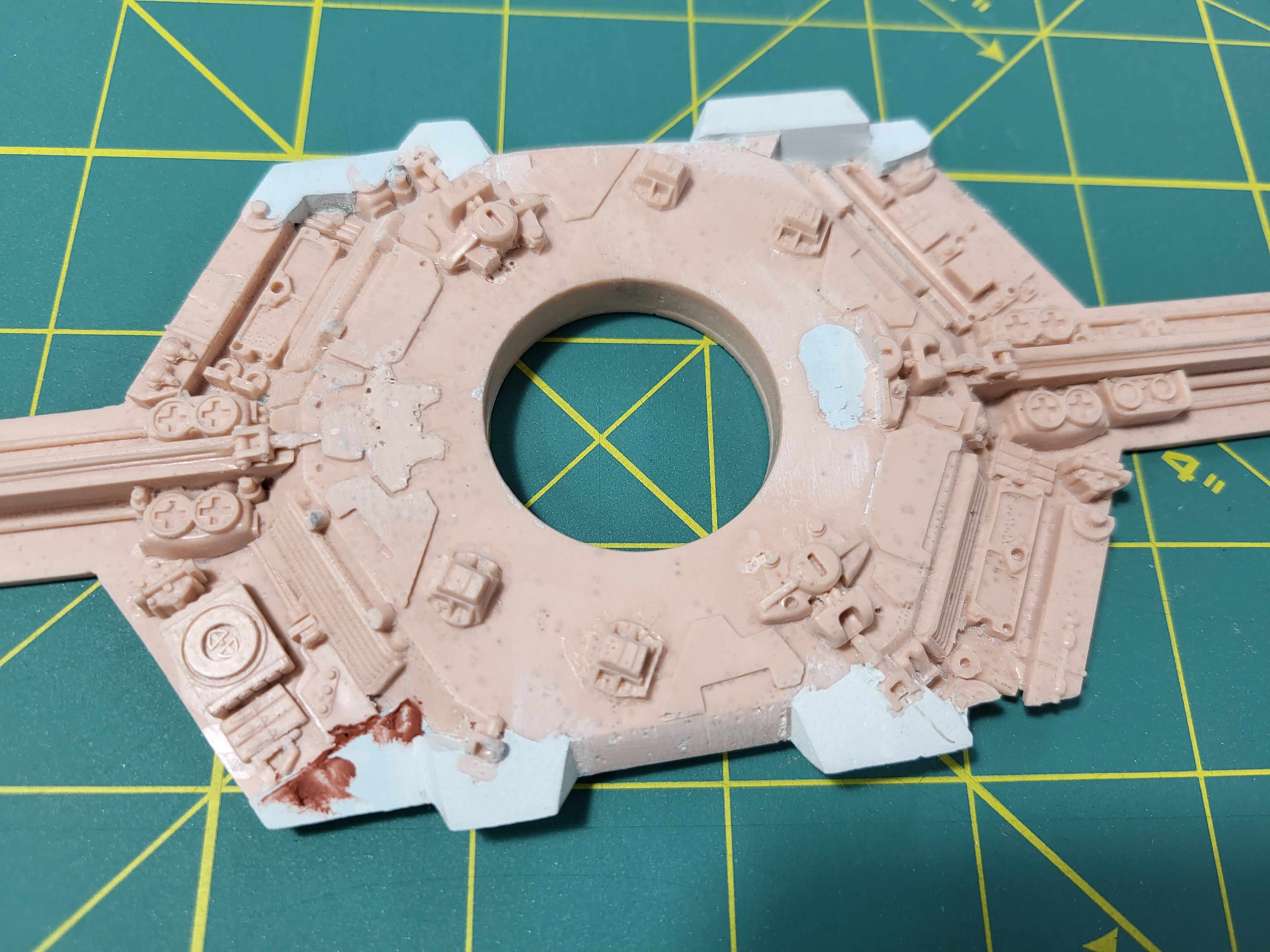

Next was the pylons (or what I call pylons). Again, I modeled these in Rhino and laser cut the parts out of .03" styrene. As with most of my builds, it took me three tries to get them (what I hope is) right.

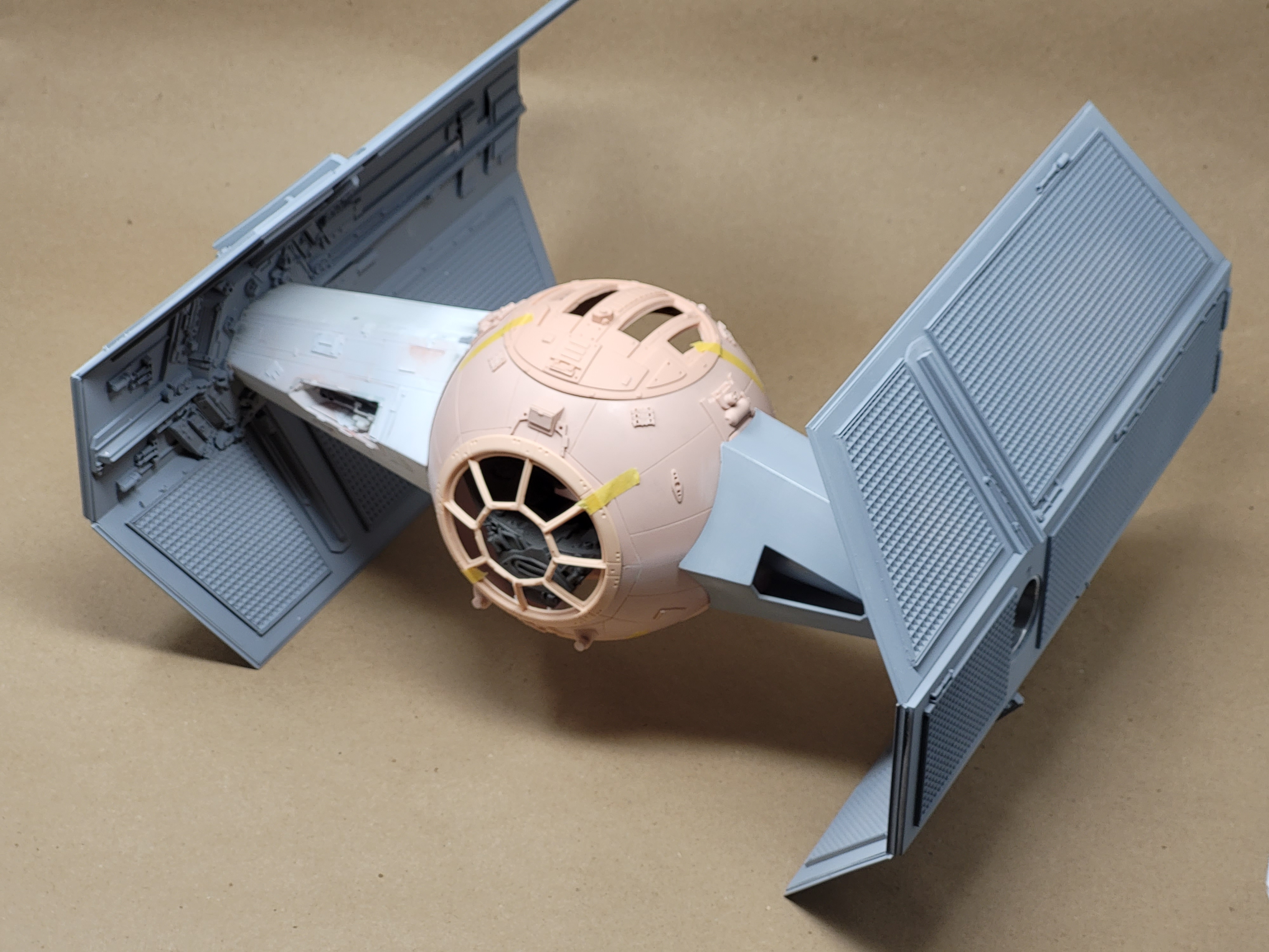

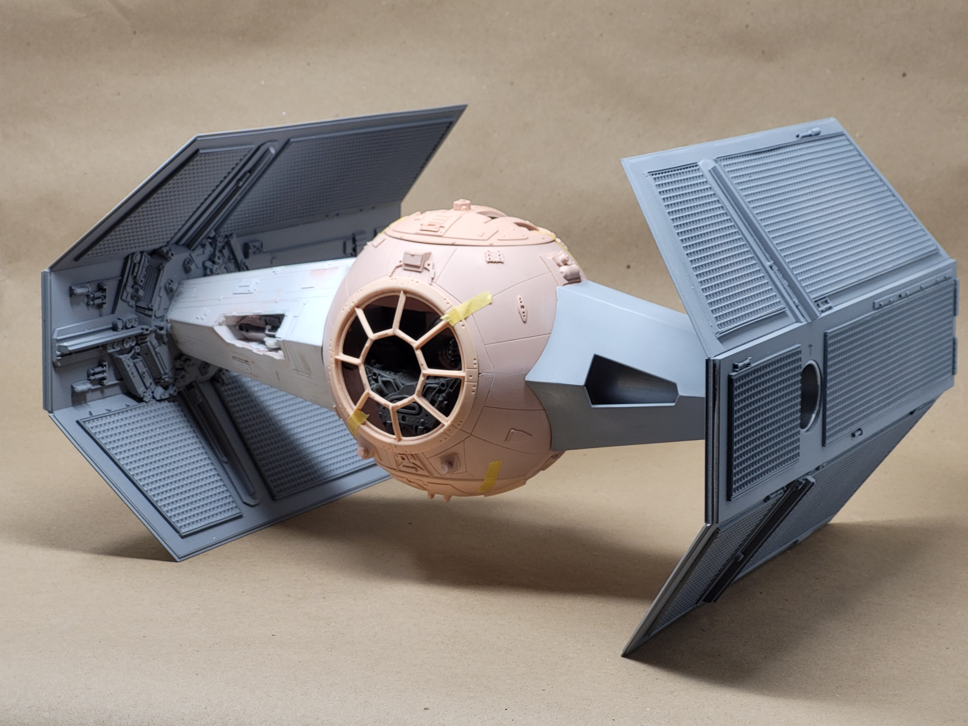

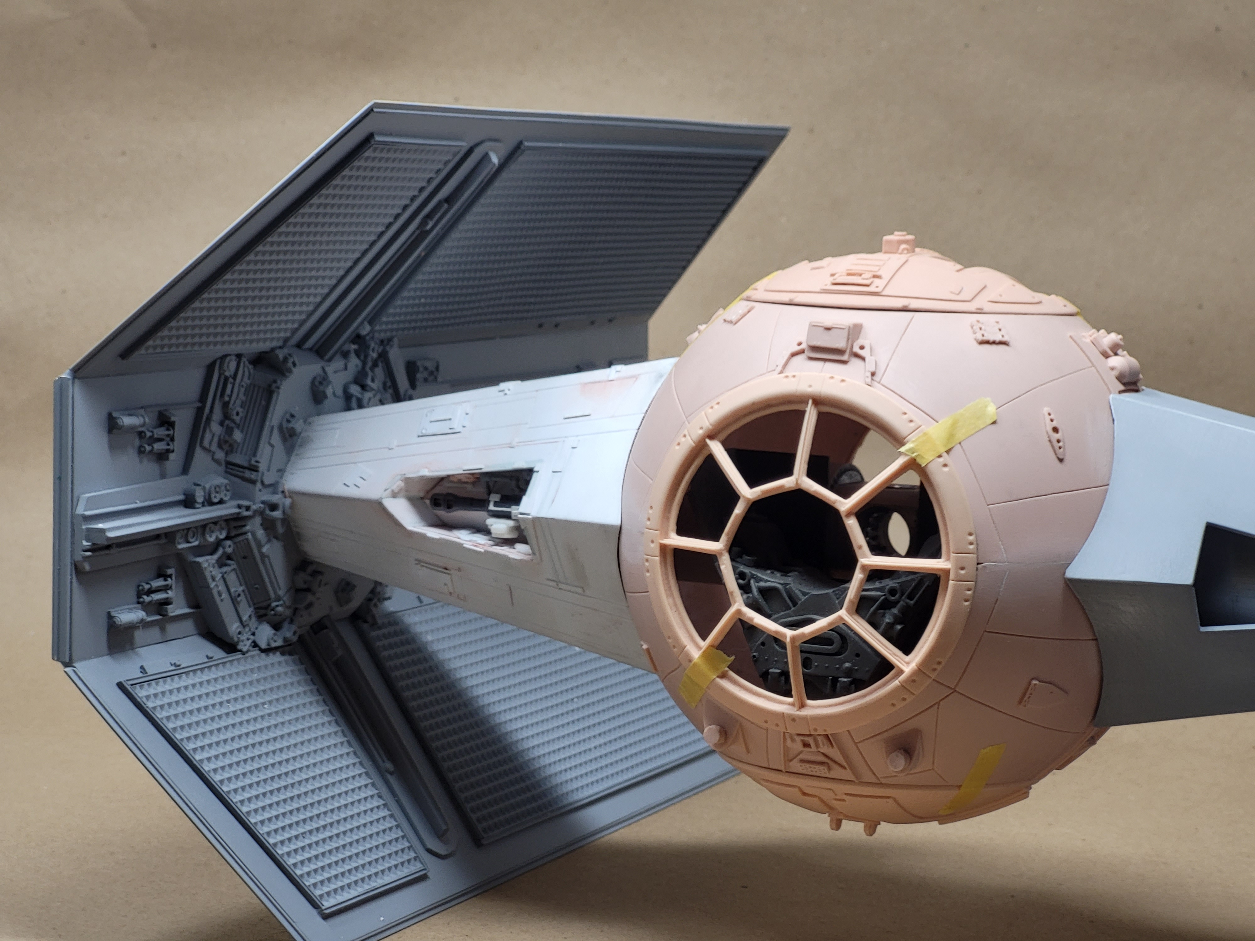

This is where it stands now. Most of the parts are just on temporarily.

And I did not know you could laser-cut styrene -- was always told it produced cyanide and was lethal
You're confusing it with other materials - laser cutting ABS produces hydrogen cyanide (among other things) and laser cutting PVC produces chlorine gas, which is not only bad for you, but it's also bad for the laser cutter.
A list of materials that don't do well in laser cutters:
9 Types of Bad Materials for Laser Cutting
That's good to know -- I thought ABS and styrene were synonyms:
From the article you sent a link to:
"ABS (acrylonitrile butadiene styrene) does not volatilize under laser cutting but tends to melt and burn. Cut edges are melted and fused. ABS thermal/oxidative decay products contain a wide range of toxins, including: cyanide, methyl styrene, phenol, phenyl cyclohexane, and benzene derivatives. ABS is also generally considered to be a fire risk because the lack of removal of material by char/volatility leads to considerable local heating and ignition."

Great work. Is the cockpit ball and armature from another kit?
Thanks! The cockpit ball and armature are from my SS TIE-Fighter build. Well the armature is new for this build.
