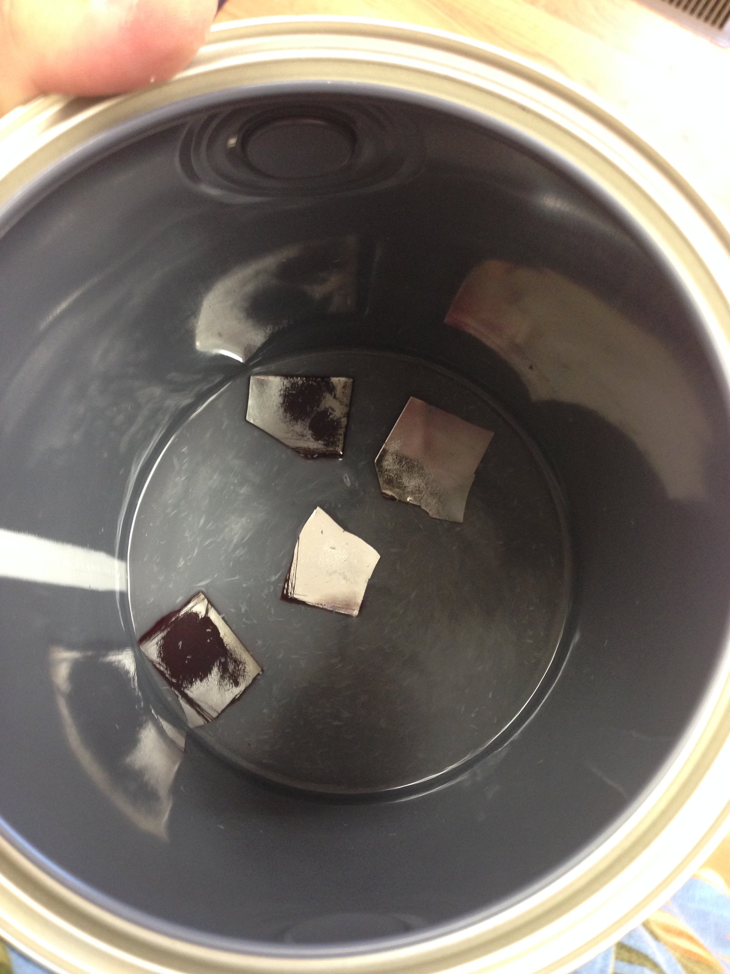

I wanted something a little more robust than the thin gel film that I've seen some people use so I cut up some scrap red acrylic that I had left over from a laser cut project that I worked on before. It had a backing material that made the acrylic have a mirror finish so I removed that with acetone in an empty paint can.

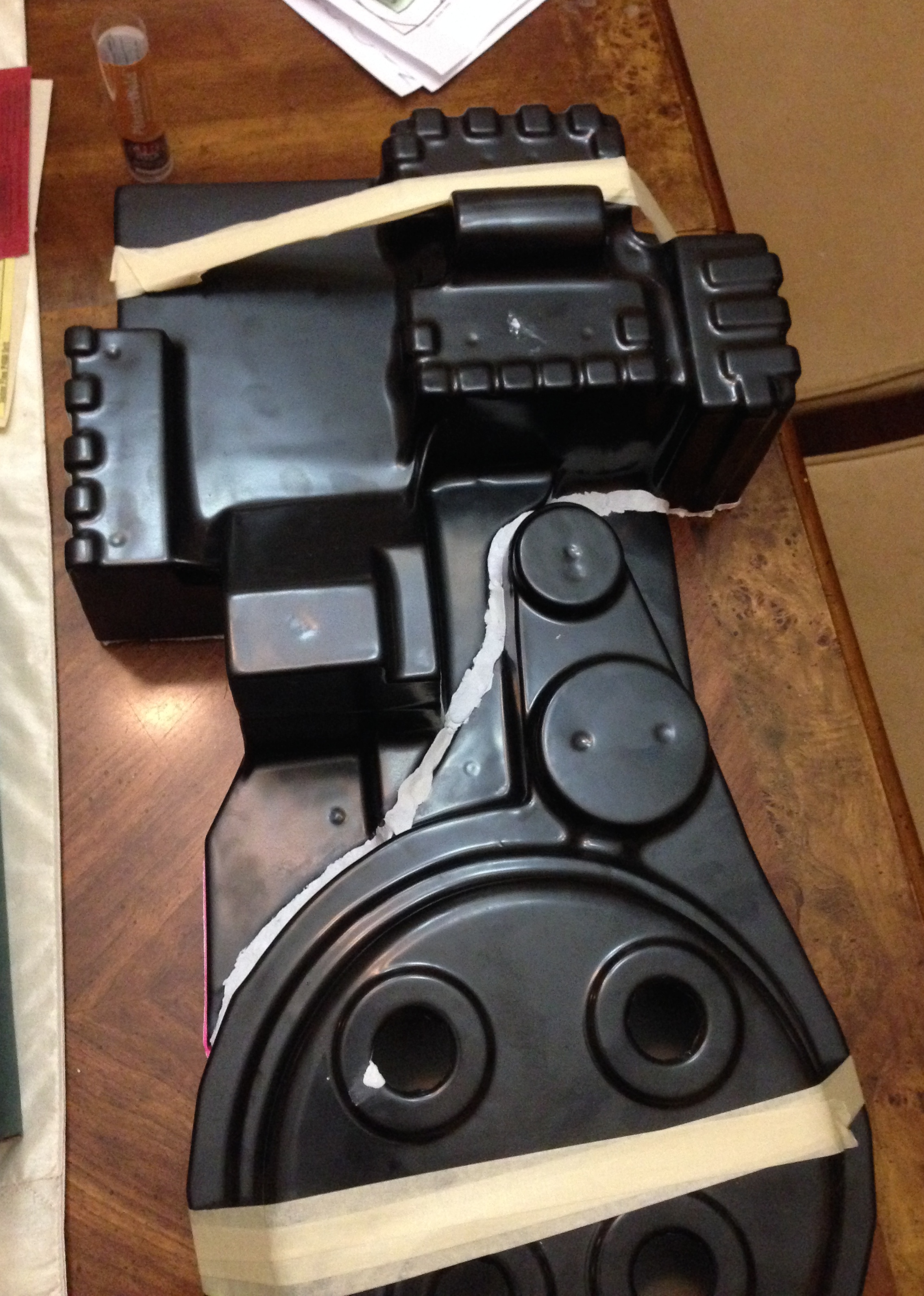

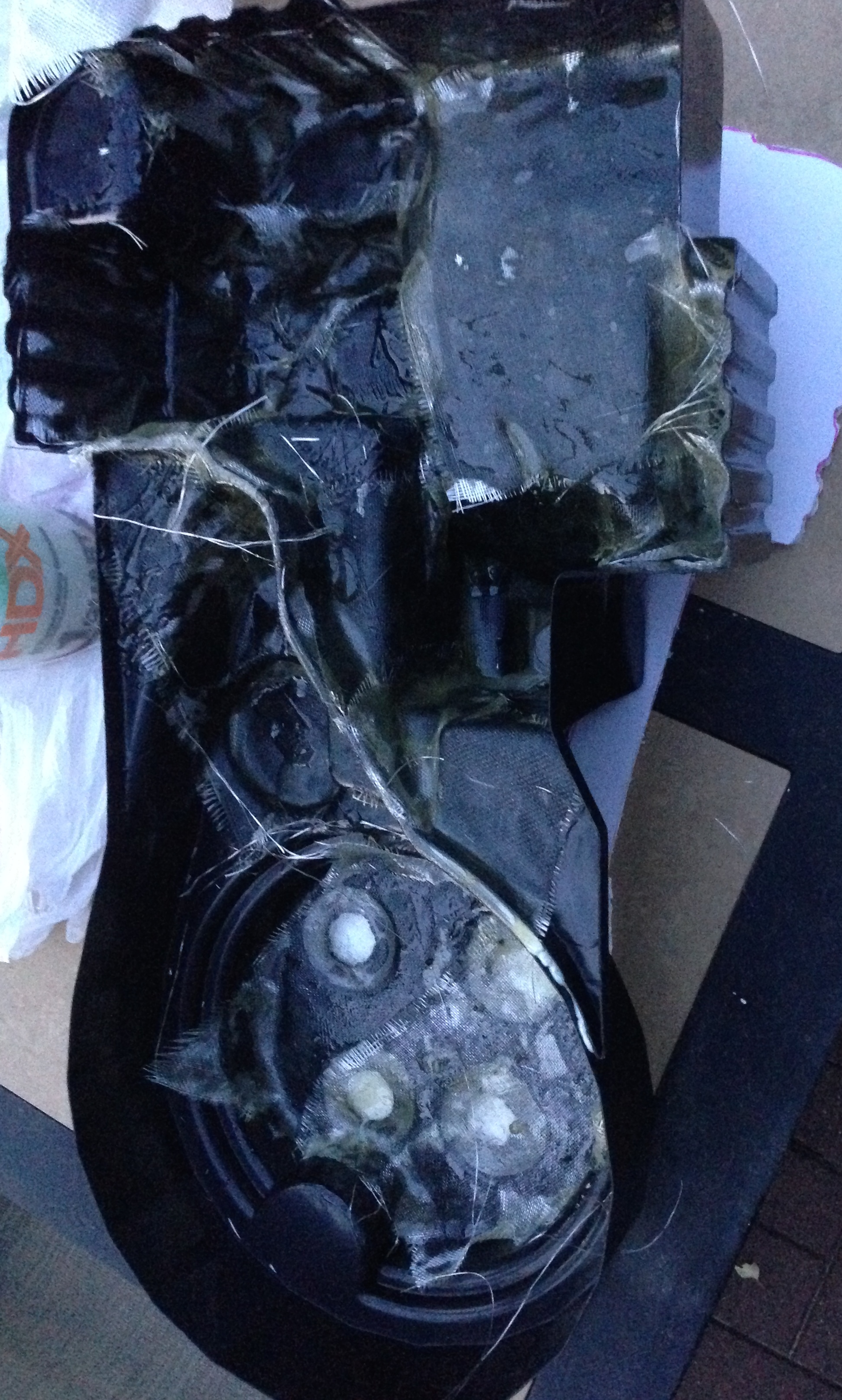

I joined the two parts together with plastic weld and will go over it later with apoxysculpt, then I went to home depot and got some resin and fiberglass, had lunch and then went to see Ghostbusters 30th anniversary re-release in the theaters! Later I came home, mixed up a small batch of resin and put in some of the fiber glass. It's outside drying out now and tomorrow I'll add more. This should stiffen it up a little I guess!

It rained last night and today so it's got me slowed down as I don't want my house smelling of resin. I did get the rest of the fiberglass in and the apoxysculpt on, it's curing outside on my front porch, I sure hope nobody nabs it!
robpenfold thanks for the fiberglass idea, it feels MUCH more durable now and only cost me around $15 for the glass and resin.

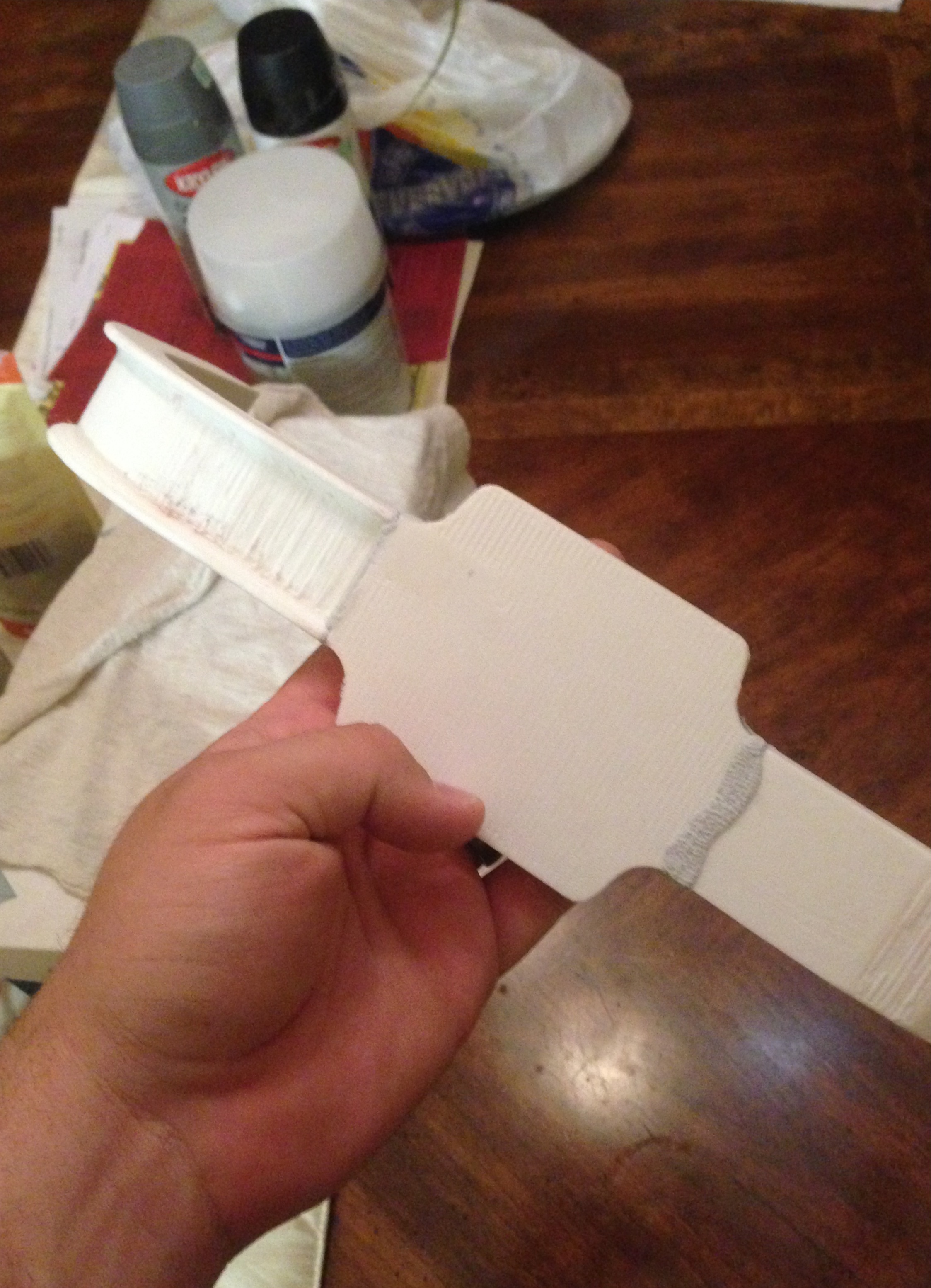

PVC, 3d printed caps, and apoxysculpt:
After some sanding:
