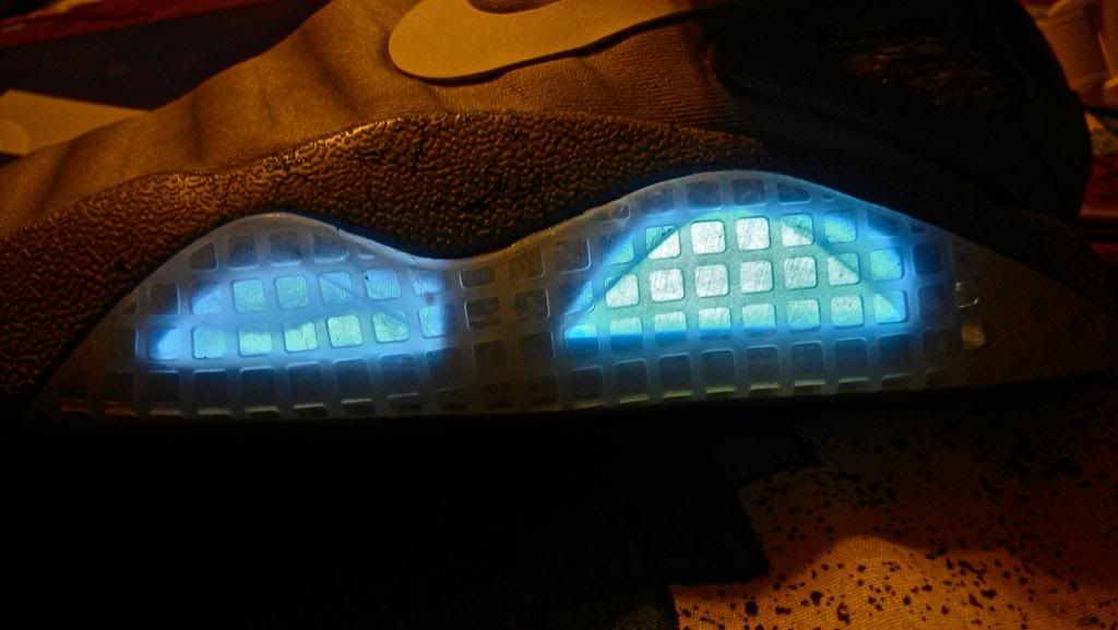

So I pried the sole open with a butter knife and hair dryer...The left half of it was okay until I started doing the right side of it....The glue wouldn't separate. Then I found two rubber stumps on the inside.
Triangle type things looked like this with light under it>>
So I thought I could remove them...
The left one peeled off with a pair of pliers. Then the right one really tore up the rubber inside...
So now when it lights up it looks like it has been battle damaged. I don't know how to make it smooth again. Chunks of the rubber are missing. I wonder if putting glue in the holes would smooth it out. Then actually glue to trim back to the gray part.
On the camera they look okay. But with the naked eye...ugh...I'm upset now that I failed my shoes.
Re: Nike Mag V2 mod discussion and builds
Sorry to say Pinn, but this is what happens when things are rushed. Those triangle pieces come out if heatd up with the hairdryer...no need for plyers!
99% of people will ever notice though...don't stressout about it.
