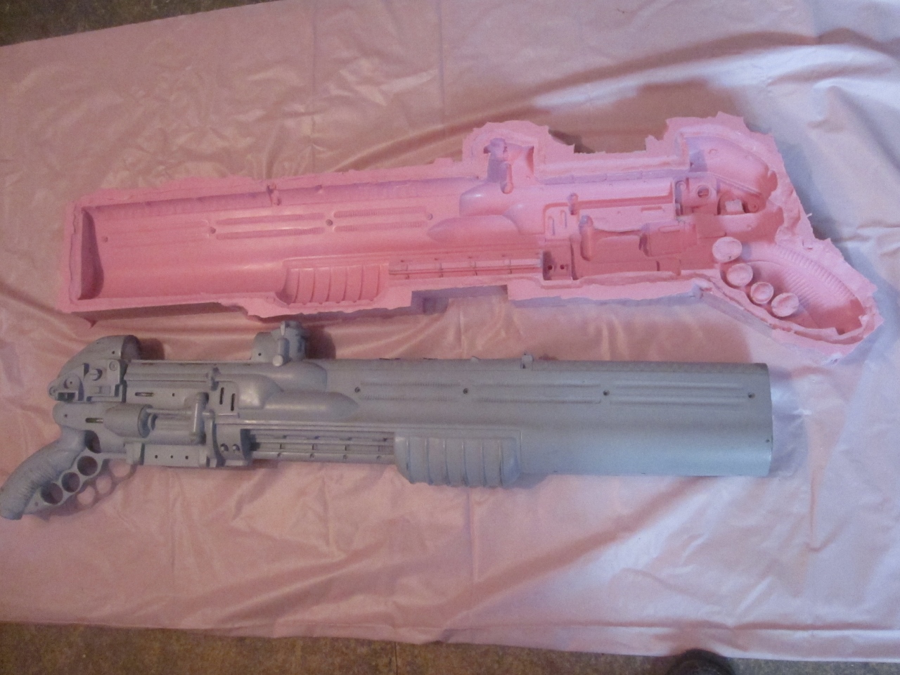

A very little update. Due to financial and health issues I have not been doing any prop stuff for quite awhile. Got a hair yesterday and finally got around to molding the first side of the pulsar. I originally made a fiberglass mold jacket but ended up going with a standard mold box. Not really much to show but it is what it is. As soon as I save up for another couple gallons of silicone ill do the other half. In other words.....it may be a little while. lol

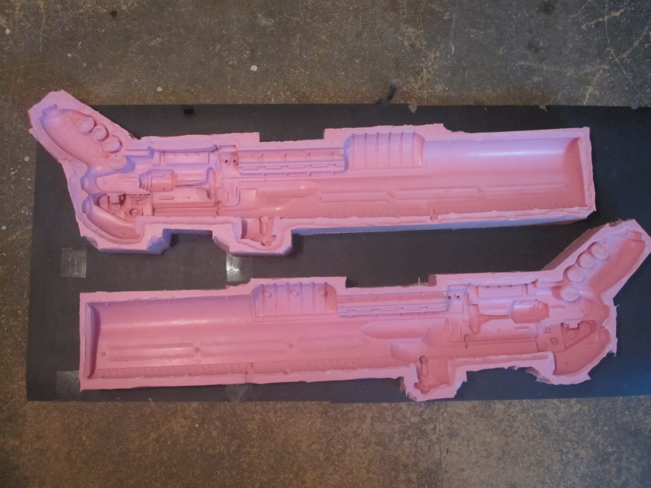

I'm curious what you are going to use for a mother mold to support the rubber when you make castings?

No need for a mother mold Duncanator. Im only laying a thin fiberglass and epoxy shell in each mold half.
