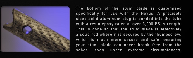

What if the design was similar to Ryan Wieber's where the set screw goes all the way through the bottom of the blade?
Yeah that actually could have been the case, though I'm guessing as far as Ryan knows, it's his own original idea. I actually have a couple of those Sabershop blades, that little hole makes it really easy to secure them in a hilt. I just wish they were a little longer. Based on the info available on http://www.proparchives.com, the movie used lightsaber props had stunt blades around 37" to 38" long when attached to the hilts, but the Sabershop blades are only about 32" long once inserted into a Novus. They're a little on the short side, but not so much as to prevent them from looking like Lightsaber blades once you add the effects.
As far as I know, any set screws were secured near the top of the hilt. You can see a screw on a Windu saber and there is a shot of an Obi Ep. III with a set screw - both in the emitter section. The idea here, as I found out with my custom V2 - the more material you have beneath the set screw, the stronger it can be.

Our Nova Carbon blades do replicate the pushrod that was present on the ROTS carbon blades. However, on the original props, those pushrods were simply glued or press-fit into the carbon tube with no fasteners needed. For Nova Carbon, we wanted the user to be able to swap between a long screen-accurate pushrod, or a shorter one that could be adapted (using the included parts) to fit in a 1-inch or 7/8-inch blade holder. So that's why we added the set screws. They weren't on the originals, but appear on Nova Carbon for that reason. It's our one minor departure from the originals, but in my opinion is a nice callback to the Ep1 and Ep2 blade attachment method, and gives Nova Carbon a nice kinship with those blades.
