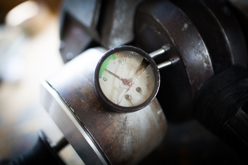

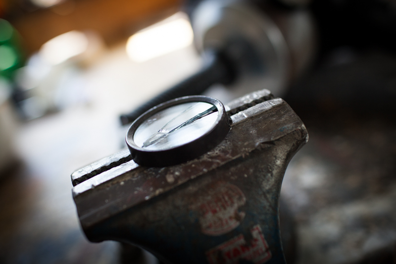

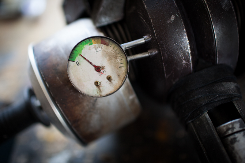

HALF - LIFE 2 - Gravity Gun Replica - 23.08. - 3D printing and illuminating things!
Wohooo, got actually something done :D
As I'm waiting for the last cnc-lathed part to finish up the backside of the gun I managed to get the gauge going, aswell as other parts for the front.

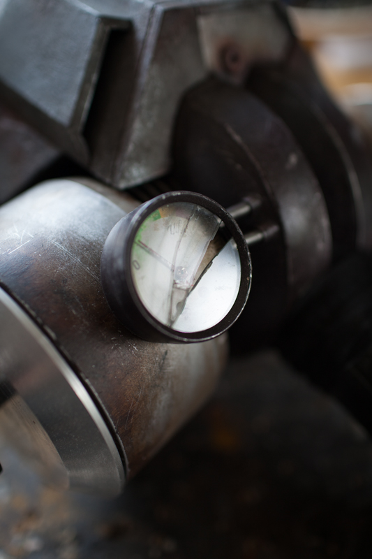

The initial setup of the gauge is quite simple. The face itself was designed in PS, post-painted with acrylics, then printed on some sticker paper and glued onto a special kind of white opaque acrylic which I used to distribute the light of the leds. As the base I used an old manometer I had lying around and teared it apart.
Didn't do much of photographying during this process so you have to be happy with the pictures below :)
Since I want the whole thing to look like it has been used under the roughest conditions the glass covering the gauge of course wouldn't survive this harsh journey. So I tried to crack it up a little bit :)
I really love how it came out although the glass will be painted a little bit to give it a dirty teint.

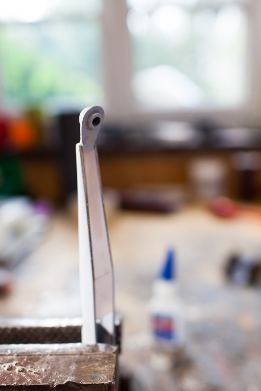

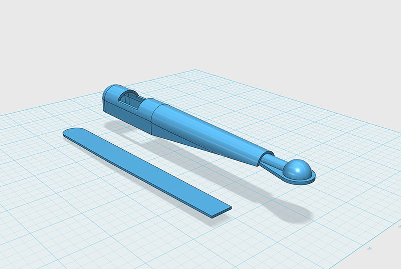

Since the backside is now practically finished I went onto the front and started designing the arms which are going to get mounted on the very top of the gun.
As the overall shape of them is quite... hmm I don't want to say complicated but it actually kinda is when it comes to replicating it I decided to draw it in 123D Design of Autodesk and have my buddy Harald 3D-printed them! :)

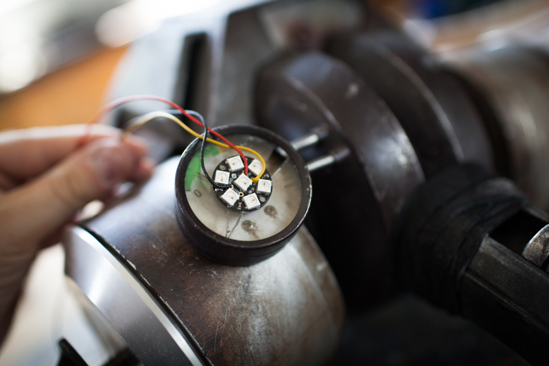

Each of them will have a RGB-led embedded in them which will be controlled by one of the Arduinos.

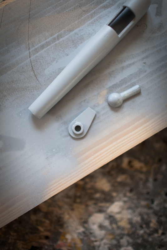

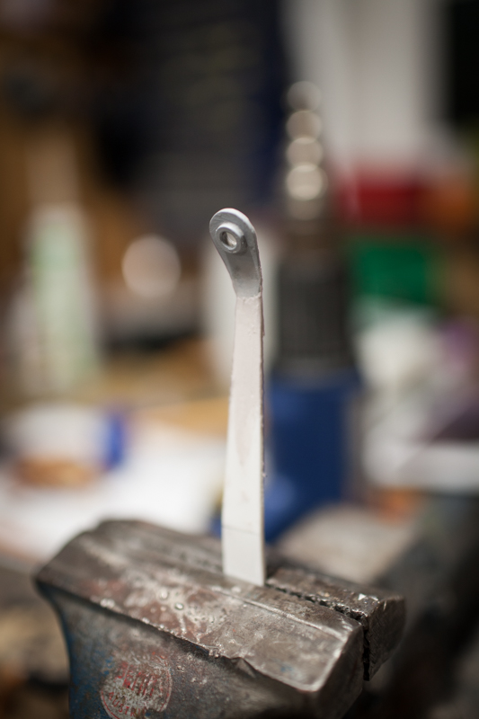

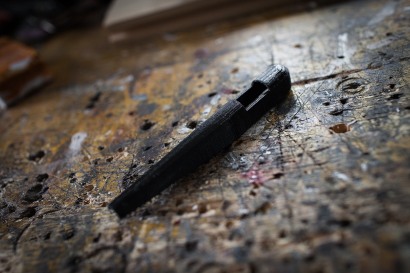

Since the printing takes it's time and I definitely wanted to stick my nose into casting this was the perfect first prototype to begin with :p

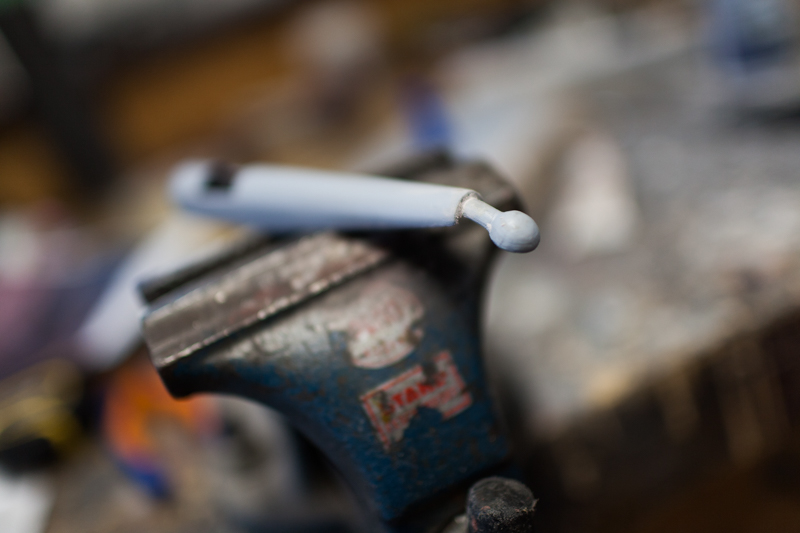

Here's the finished and raw 3D model fresh from the printer. The whole arm consists of four pieces which got glued together after sanding and filling them.
Harald also did film the process of 3D-printing this very arm and the spoon which gets attached in front of it. Thanks a lot man!! :cool

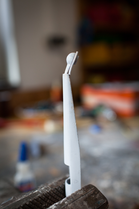

First coat after sandind them...
...and then they got glued together. The little spoon at the front is hollow so there's room for the led to fit.
After more sanding and filling the master for the final mold was ready :)
Now I need to cast them three times :) I will update you guys as soon as possible!

Good gauge there! Love the way you cracked the glass face. You're right, it adds to the "went to Hell and back" kinda feel. Also, with that kind of finish, the casting of that piece will be effortless. Keep up the great work:)

Wow, this is looking great! Definitely love your workflow there... I'm wondering about the arms, they look like they'd be easy to find parts that existed already. Like a bent sheet metal part used for a wiper blade, and a tierod end put together.
That 6 led disc you used there... Can you share the part number?
Sent from my HTC One using Tapatalk
Re: HALF - LIFE 2 - Gravity Gun Replica - 23.08. - 3D printing and illuminating thing
Thanks a lot man! I did search around a little bit to find anything with a similar shape but couldn't find anything at all.
As far as the LED-disc goes, here: https://www.adafruit.com/products/2226 :)
Haha yeah I had hoped it would break in a nice way which it then thankfully did :)
