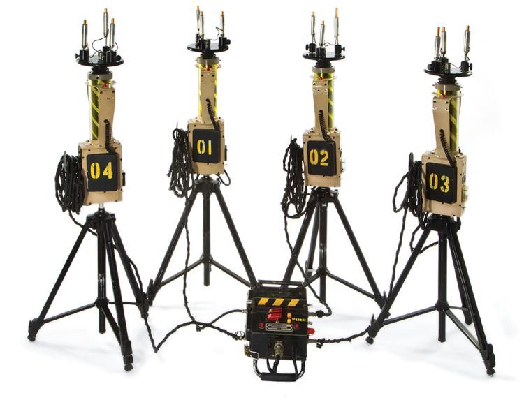

Also, sorry for the lack of recent updates...work has been killer. I also haven't had much funding to send out for the car and now will have a bit less after my newest acquisition from the Profiles in History auction:
I'm so excited!

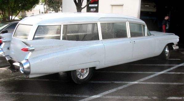

I was just curious - and I figured this would be a good place to ask - what are the differences between the MM hearse/ambulance and the standard Cadillac production car? (Aside from the obvious extended roof and back door!) Was the chassis lengthened, etc?
Could a standard car be converted into an Ecto? (hypothetically speaking!)

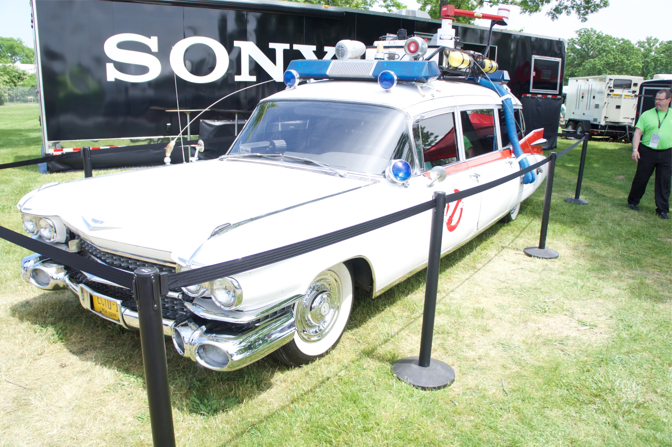

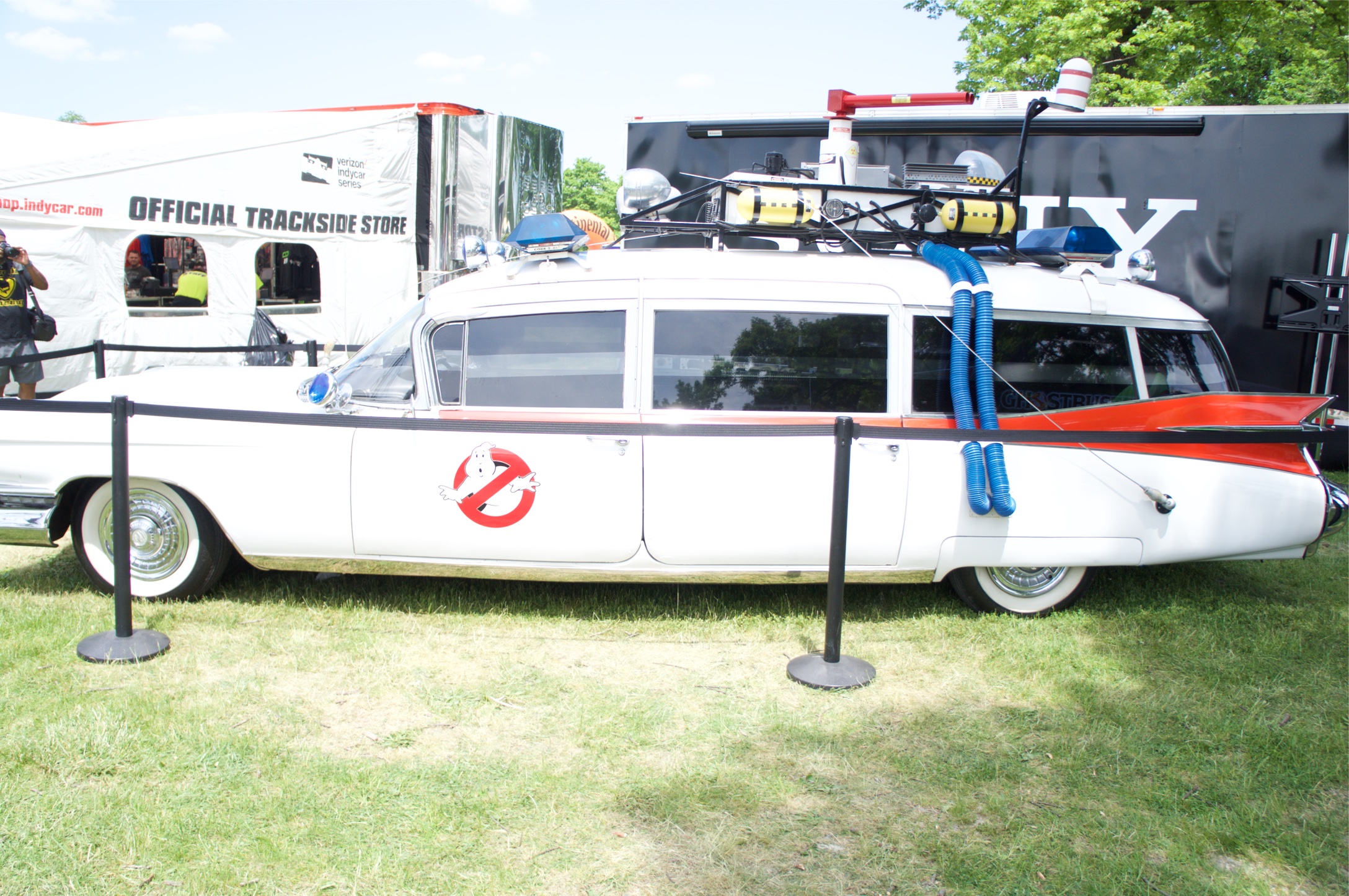

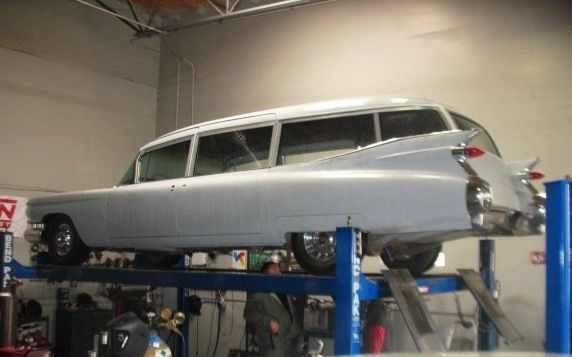

Not sure if anyone has had the chance to see this but it looks like Sony has had the original (I am fairly confident it is the actual car but if I'm wrong feel free to let me know.) car out at events ahead of the new movie, I took these pictures in Detroit a couple of weeks ago.
Obviously the car being built in this thread is more accuret than the car as it is today but it was still cool to see it in person.
is it true after they restored it the damaged the passenger front fender delivering it back to sony? thats what i heard
Sorry some how missed the other pictures, apparently I was distracted by my cute kids (I'm totally impartial)

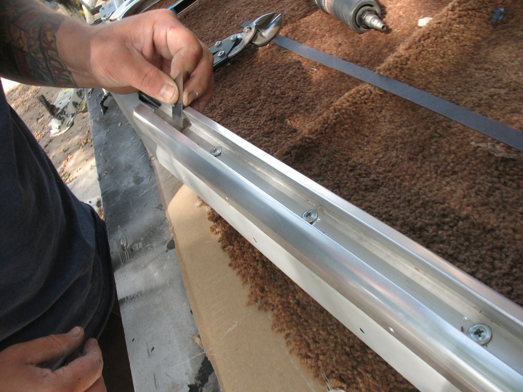

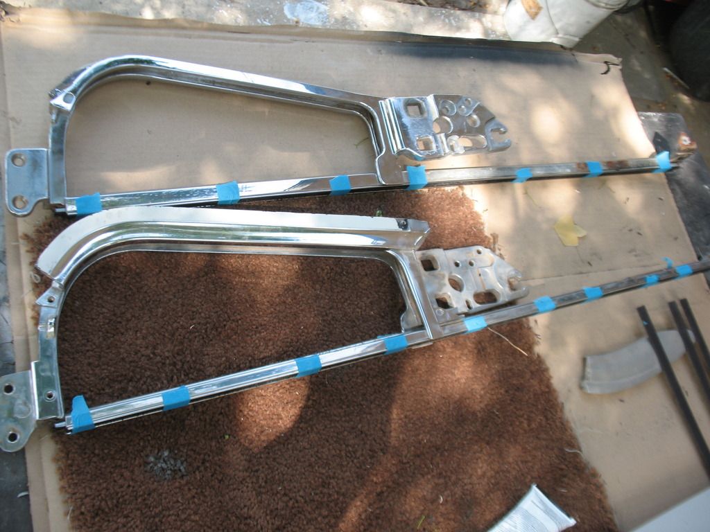

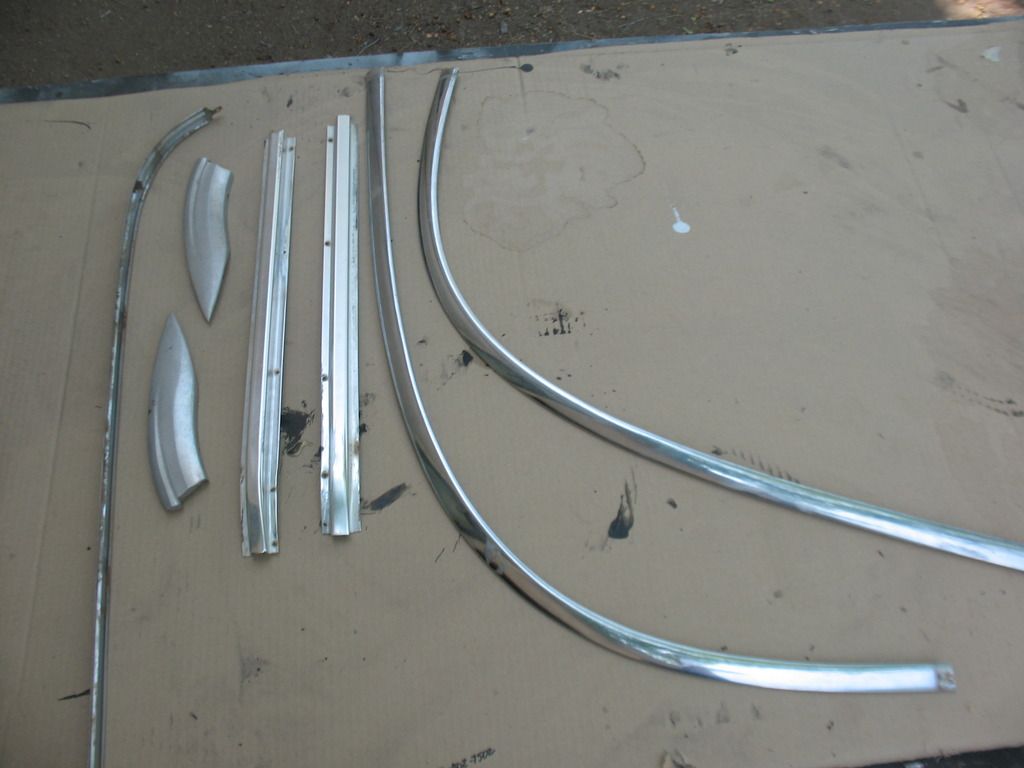

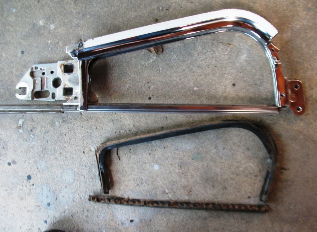

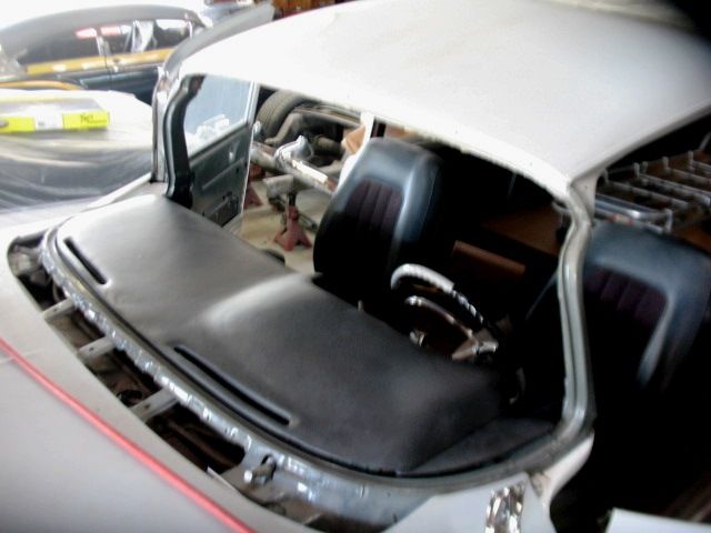

First up, the vent windows and window tracks needed to be restored. You can see that the vent window rubbers were rotted and obviously unacceptable. Getting them out was likely a pain in the you-know-what, but they are long gone and now the vent windows are all set.

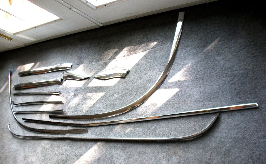

New rubber has been installed, new vent window cranks are installed, and all of the moldings for the vent windows, side windows, and windshield have all been smoothed out and polished:

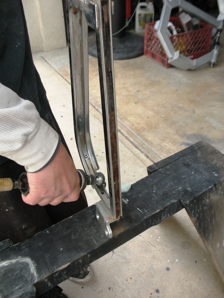

The actual side window tracks are all looking sweet too:

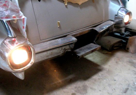

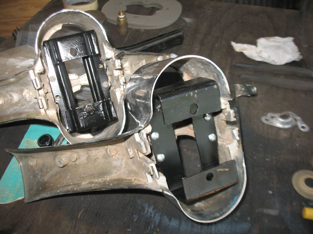

One of the taillight brackets was damaged. The other wasn't salvageable. The team repaired the damaged one with a sweet welding job and then they fabricated a bracket for the other side. You guys will never see these parts again most likely, so I apologize if this is boring...

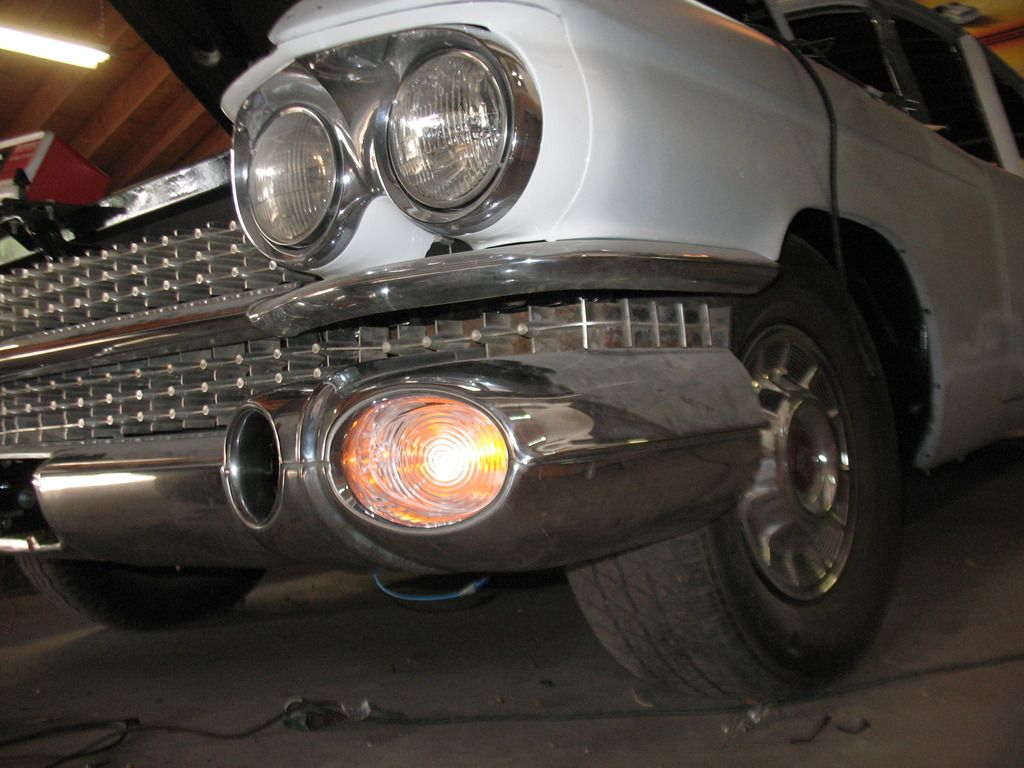

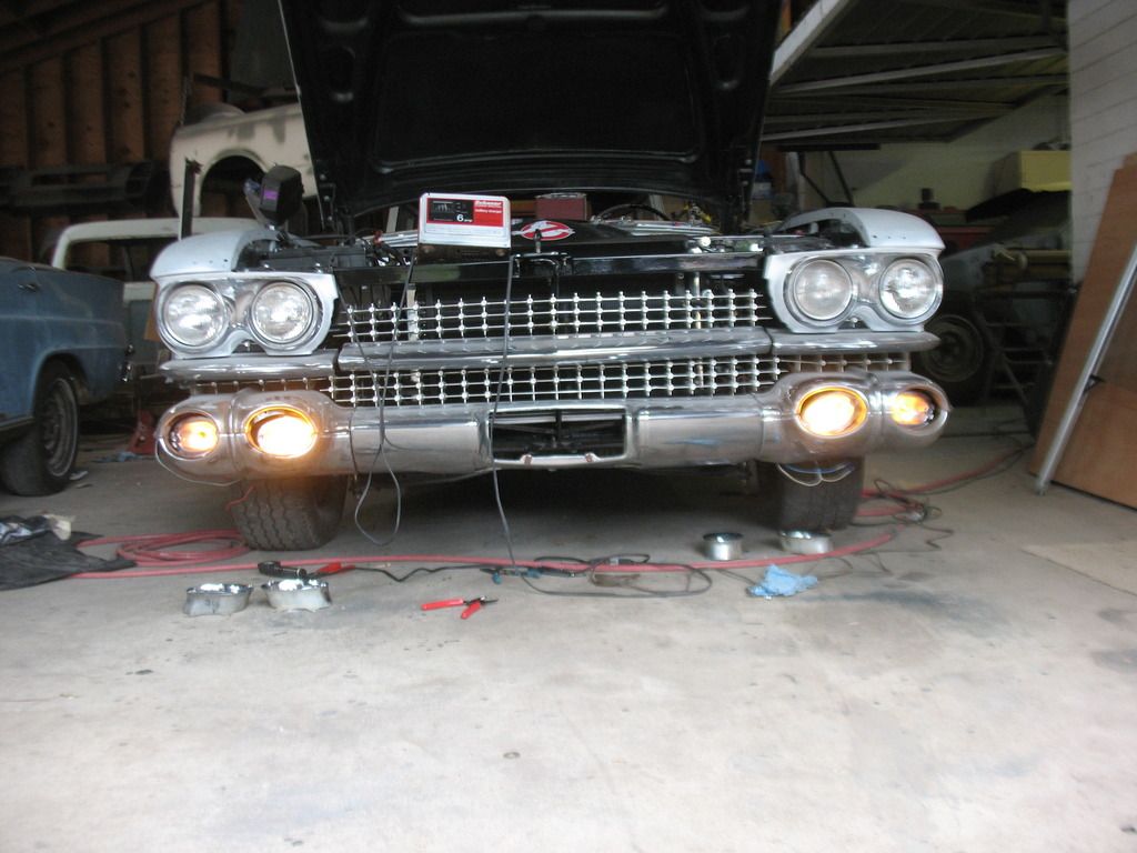

Now, many of you should recall that the movie car needed a bunch of stuff, including 'a little wiring' according to Ray. I can assure you that there is A LOT of wiring involved. Let there be lights!
Turn Signals:
Backup Lights:
And just because I love the look of it, another shot of the lights in the front:

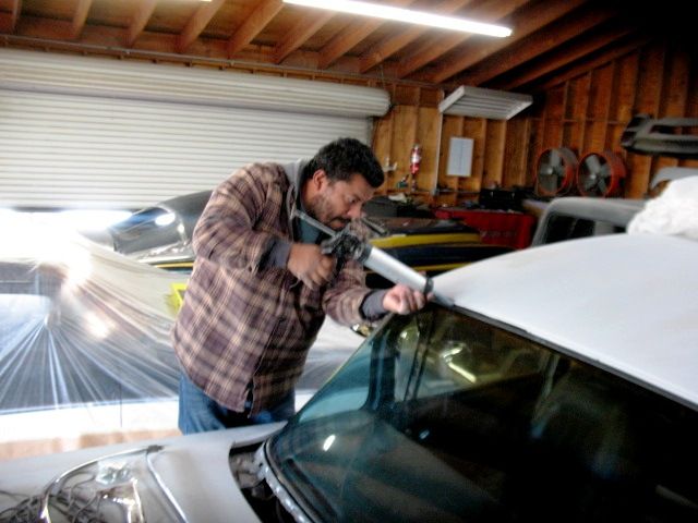

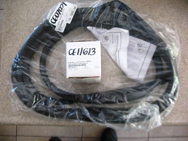

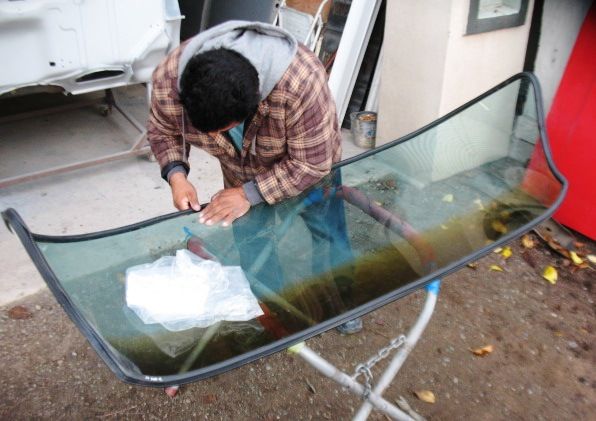

There was a bit of challenge with the windshield installation. It is seemingly impossible to find a single rubber to properly install it. The window guy has figured out a way to use two separate window rubbers to install the windshield appropriately. Rubbers!

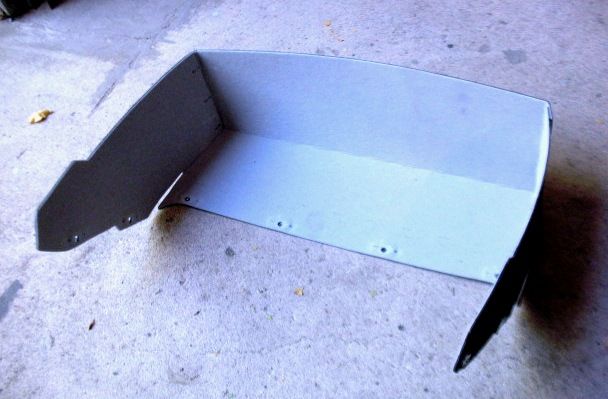

Speaking of new linings, the glove box will have a new one! I can put all kind of money bribe gags in the glove box now for when the cops pull me over for running the lights and siren...

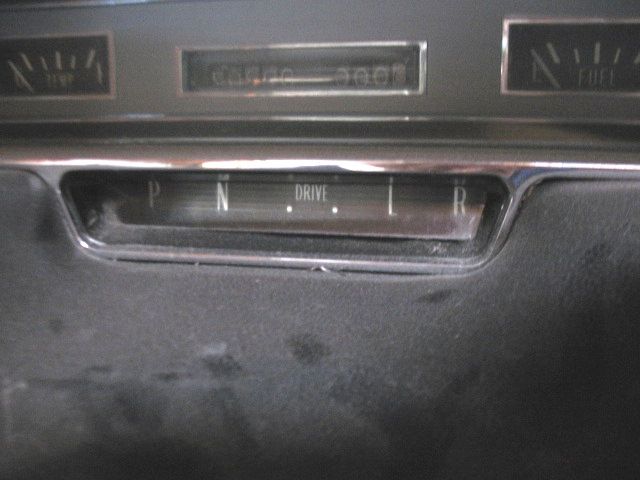

Finally, the current challenge we are facing is an issue with the dash shift indicator.
When we changed the transmission we never realized this was going to be an issue. The original transmission had a shift pattern of P N D2 L R. The new transmission shift pattern is P R N D 2 1. Basically, when I shift the new transmission, the dash indicator will not indicate the proper current shift after 'park'...this is being addressed as we speak. I will update you all on how we fix this issue.

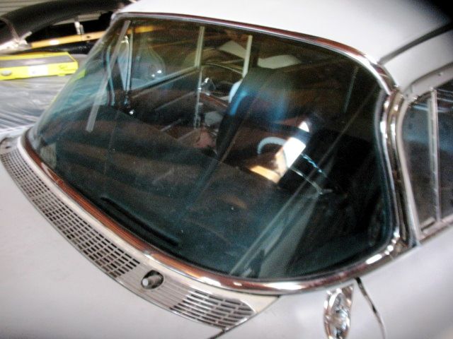

First, the windshield has finally been officially installed. It took a long time to figure out the rubber gasket needed, though apparently there are people that know how to easily find them for these cars, including a friend of mine. I, however, hate being annoying and bugging them for this info - sadly, a lot of people get a bit snippy when you ask for help. Next time I won't hesitate. Alas, check it out!
(I know some of these photos are a little blurry...I apologize, the cameraman isn't tech savvy, but he's incredible when it comes to bodywork)
The car before:
The car after:
That chrome is nice and shiny...you're seeing a reflection in it, not rust.

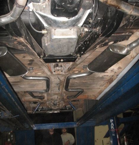

My baby went for a little trip two days ago to get a new exhaust system!
She was exhausted after her trip...get it?
Again, please forgive me for the rain and slightly blurry photos, still, the pictures have me really, really excited. A good buddy has asked about having the car undercoated. I do intend to pursue that once she is here in Pennsylvania. The wheel wells and inner quarter panels are already coated, but we'll do the entire underside of the car if my shop here can do it (I'm 99.99% certain they can).
Until next time, be well everyone!
Good call on the undercoating! We had our '67 Station Wagon undercoated and it has held up great for over 20 years. Just make sure they mask off any rubber gaskets as the flex can cause cracks to develop.
