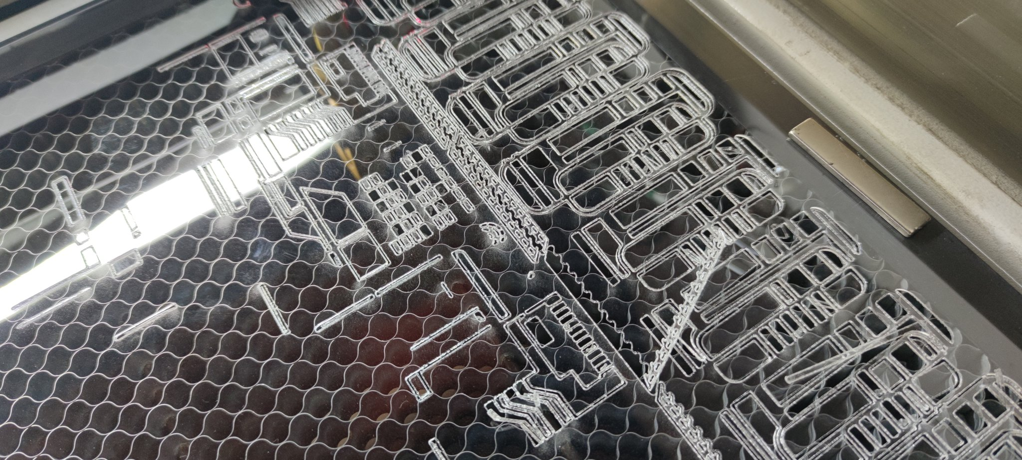

the acrylic isnt cutting well D:
The material... I dont think its acrylic... I have other 1mm stuff that smells and cuts like acrylic... (but expensive A4 size) This smells nothing like acrylic, smells like car body filler i think. And cuts like PETG.
Then the description given by the manufacturer is misleading because it does clearly say Perspex clip frame.
I deliberately wanted to use 1mm acylic sheet in conjunction with the other (thicker) acrylic on my project so when I found that stuff, it solved the issue - albeit I could cut the large sheets to size with a steel ruler and scalpel (and so dodged a bullet with the issue you’re facing.)
Doesn’t help with your problem though. Return the un-used ones for a refund?
Two tests you can do. Is the edge light and frosty or dark? And if you grab a corner with pliers and bend it, does it bend or snap?

its brittle like acrylic. Edges are clear.……
Yeah. That what I thought as well. Brittle and unlike polystyrene so must be acrylic. I wonder if the plastic cover sheet is interfering with the laser cutting in some way. I found with the 3 and 4mm laser cut acrylic, the stuff stinks until from the residue left on outer protective sheet is cleaned off.
You don’t have to be sorry on this forum. There are far more important things in life.
Good luck on your new job.
I really don't think it's acrylic. Unless it's some strange cast type that's out the norm.
It's also a lot more flexible in sheet form than normal acrylic. Just brittle after cutting.

As for the plastic, who knows what it is. There's a million and one different kinds of clear plastic out there. I know how to test for a few, but outside of that I'm stumped.
