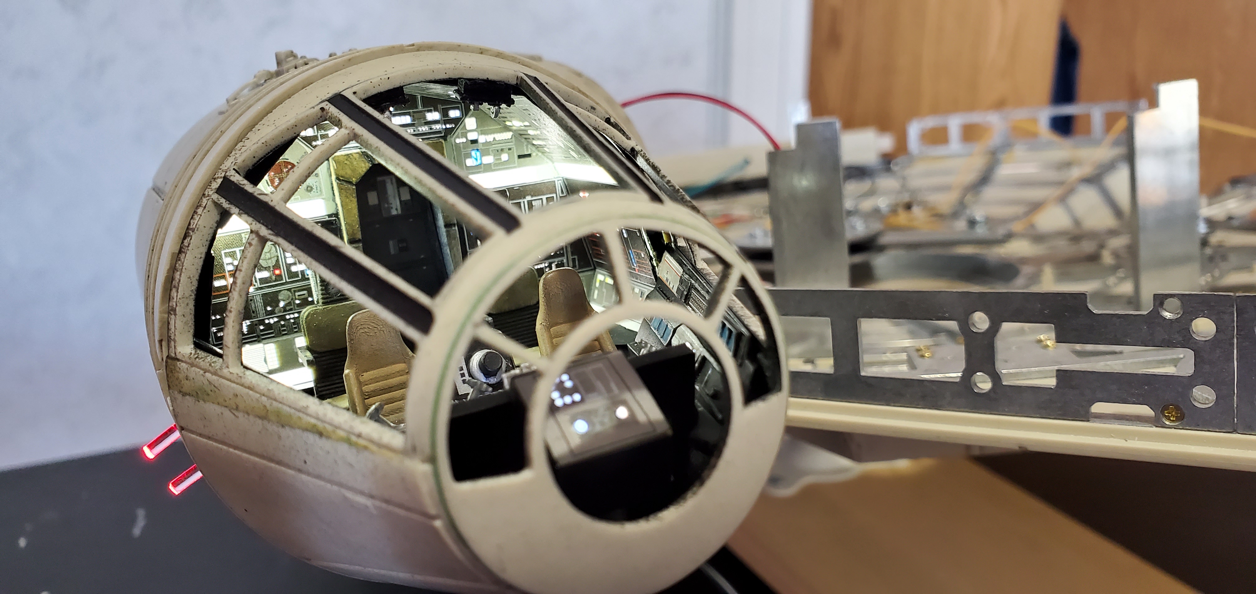

Cockpit almost done.
Two red led fibers can bee seen on the side. They just need to be trimmed.
A few more fibers to run inside the cockpit. Also have a little touch up paint to do here and there.
The nose cone is just a modification between the two that were supplied. The initial issued version and the 'corrected' version they supplied later on in the build.
Not shown: the engines are installed. The supplied led strips only half lit. So, I used some that I have on hand for other projects. I had to use two step up voltage converters to make it work with the supplied board.
I used another step up converter inside the cockpit so I could add more lights and light it up they way I wanted.

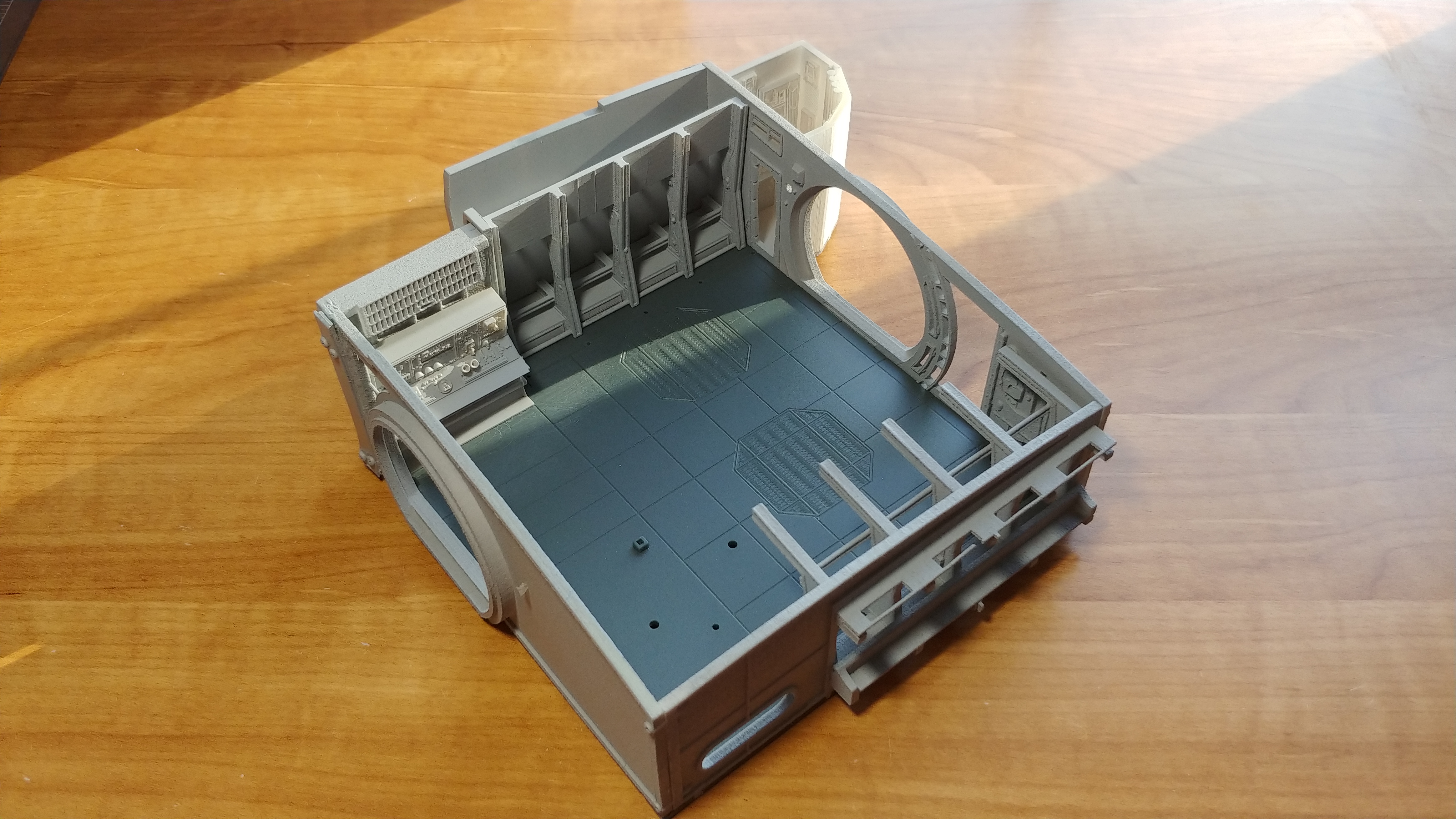

I spent most of the day getting myself familiar with the kit again. Seeing what I did to date and what is left.
I need to finish the interior first and foremost.
From what I see, this is going to take a bit.
Bench and bunk mostly assembled.
Not glued in place of course. Lights, photo etch and so on needing to be done.

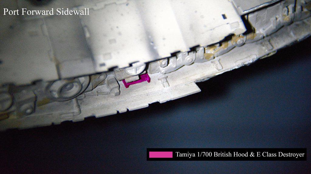

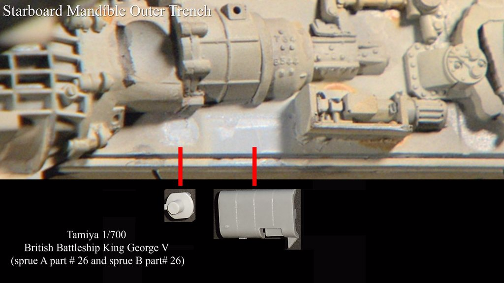

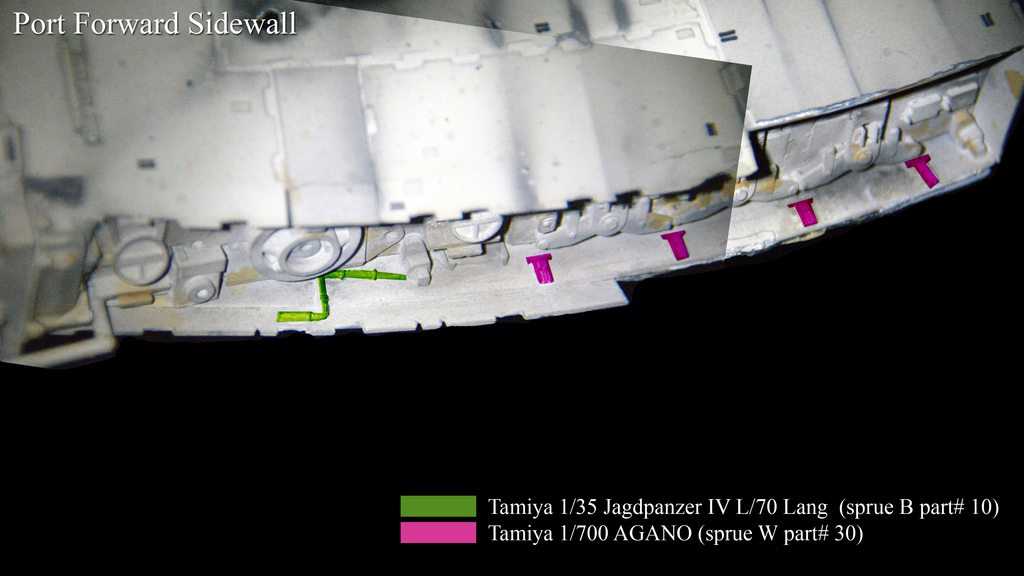

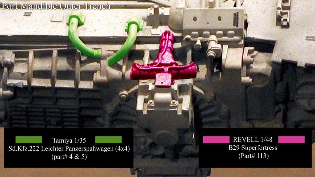

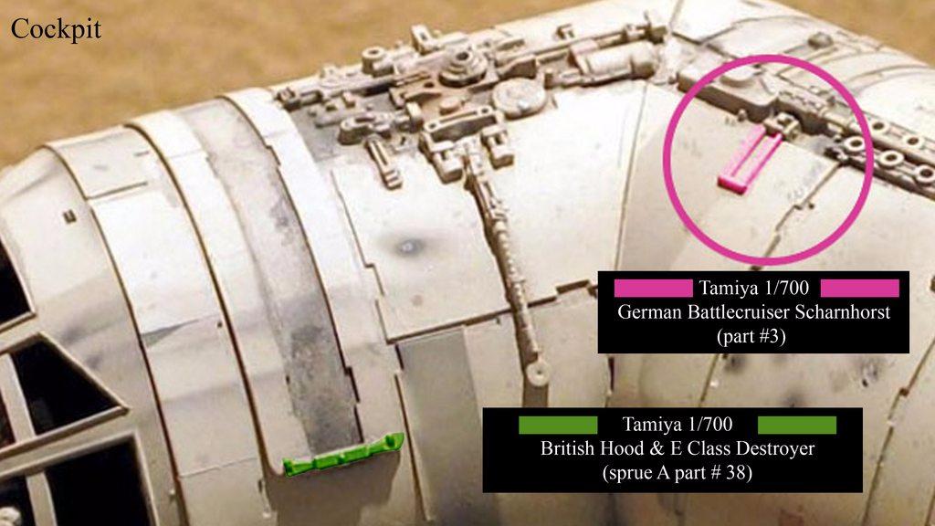

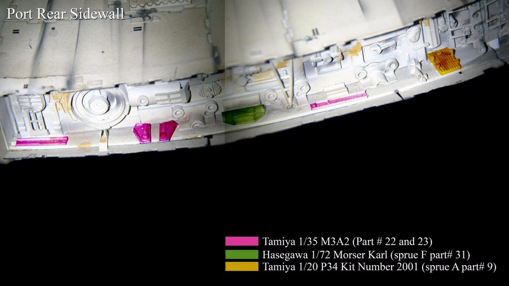

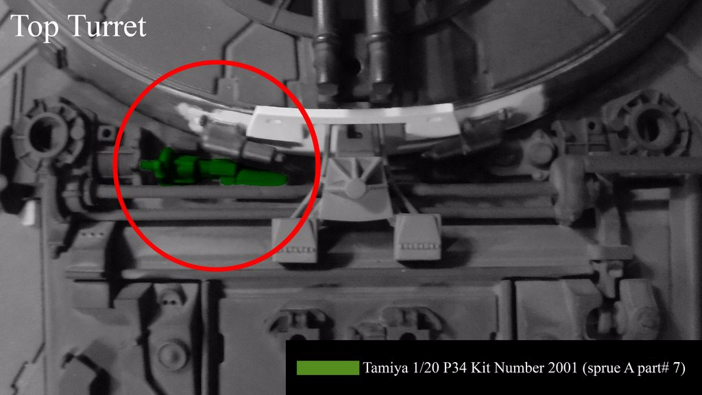

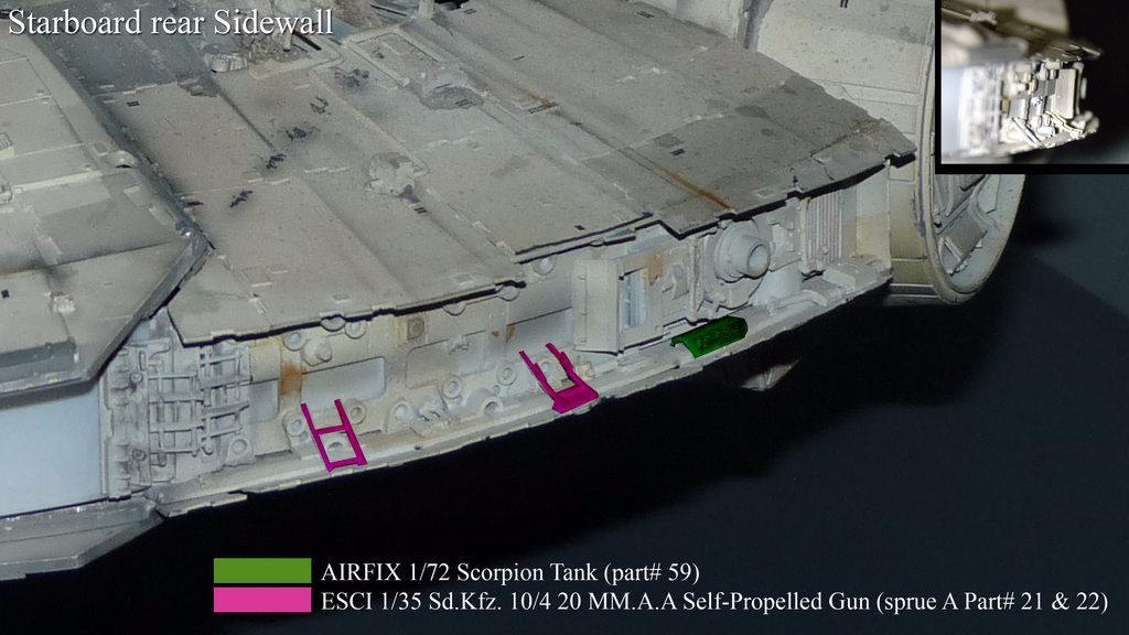

Parts Missing on the De Agostini Millennium Falcon.
The following photos provide the name of the model kit that the parts are located along with the part number so it is easier to locate the part(s).
Please note that I have not colored, marked or identified all missing parts in the following images. Some parts can be scratch built. Some kits that the parts are found can be expensive.

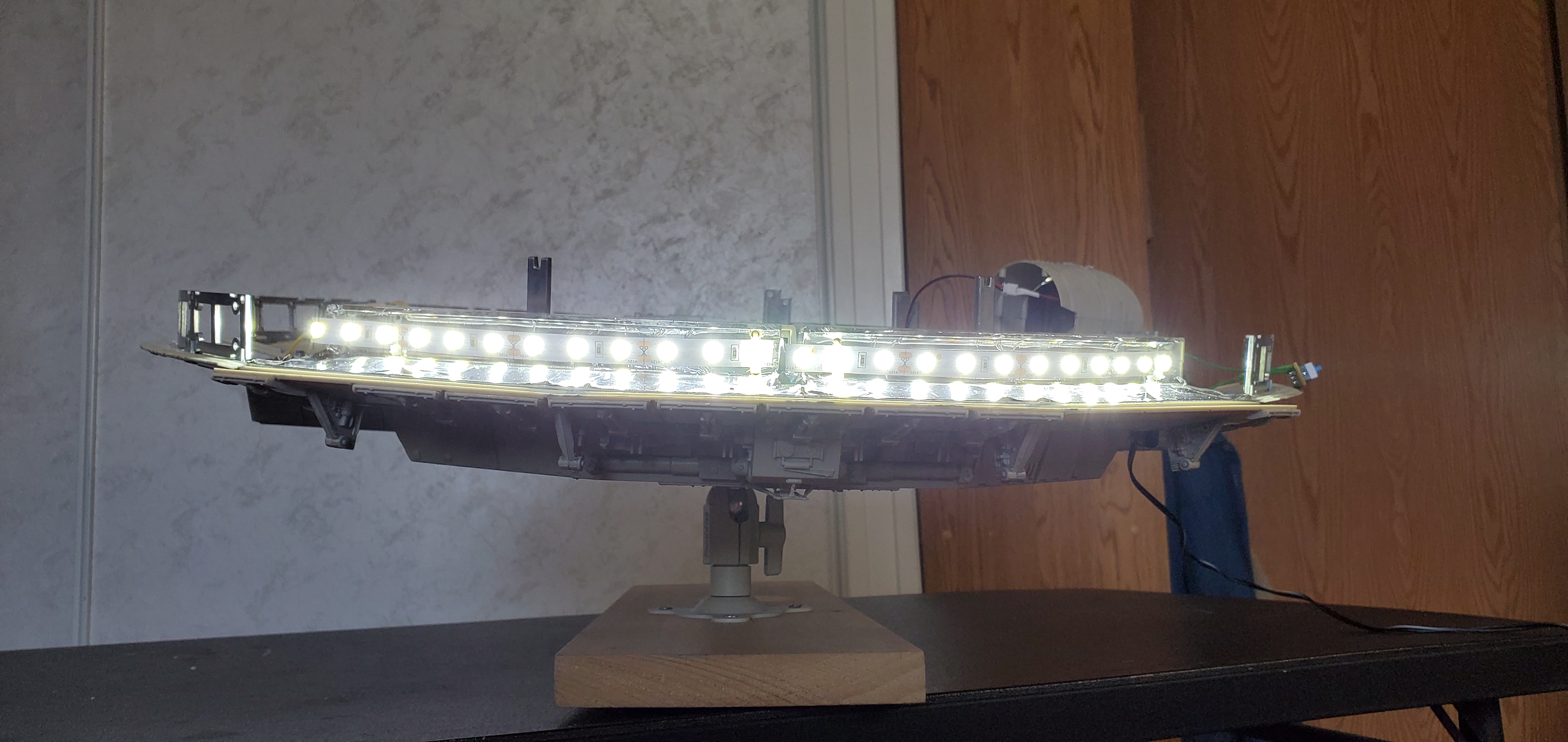

New wires run and working.
Looks like two rows of lights. Its just one. The other 'row' is a reflection from the aluminum tape.
