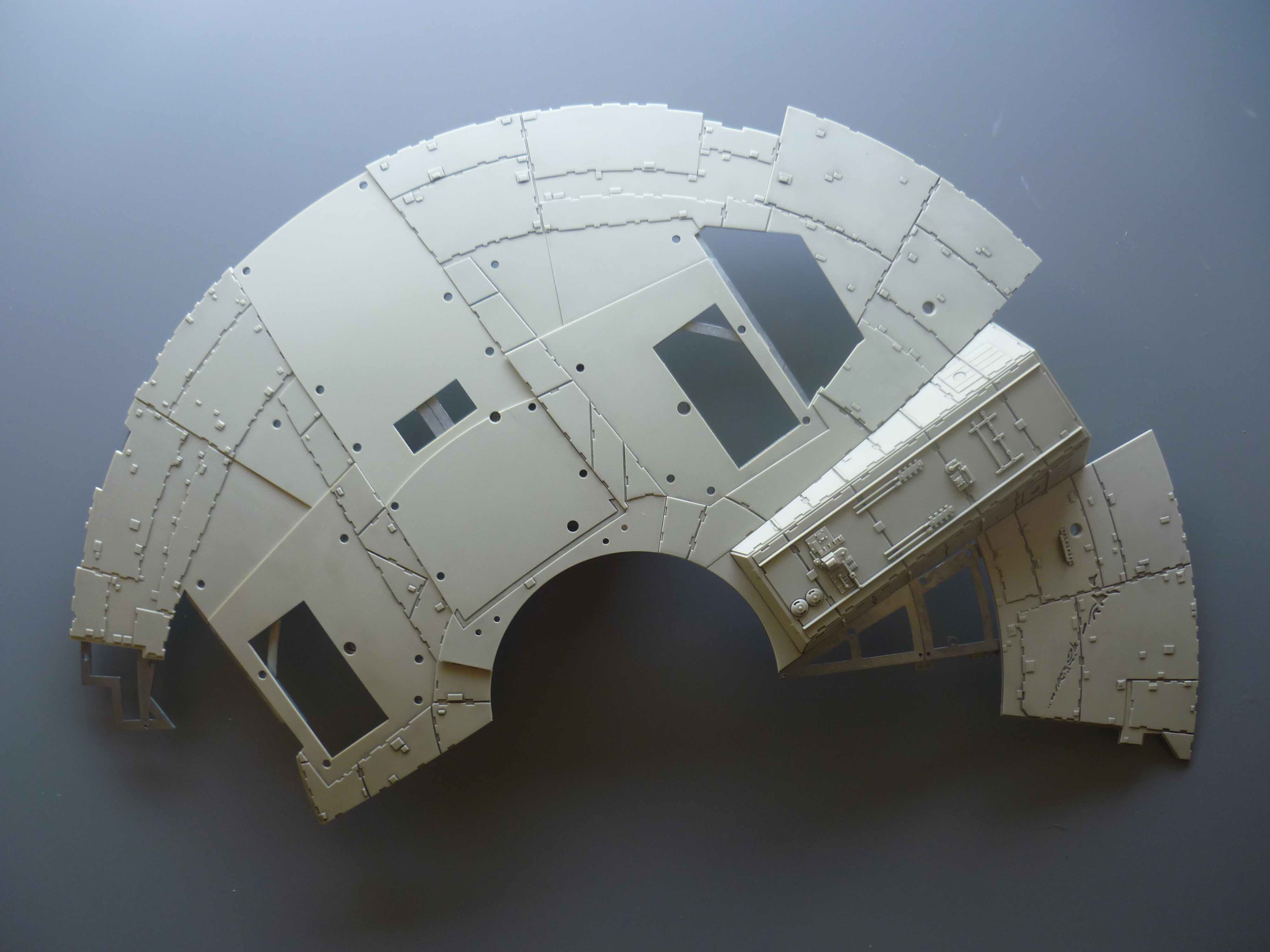

Confirmed today that the holes to the sides of the docking ring/ramp on the bottom hull pieces are for landing lights.

I figured out where the "living area" goes based on the hallway to the cockpit. There are two posts sticking up from the bottom of the hull that go into the two holes where the cockpit and other hallway meet. It's a bit different than I thought. While it is clear where the cockpit tube glues on there is nothing I can find that screws or glues into the floor of the living area yet.
Where the cockpit tube goes is the first pic.
I placed the model on the blueprint as exact as I could.
With top Gun Turret under:
With top Gun Turret on top:
You do realize that the hall tube will slide int the cockpit tube right!! That will change where the living area goes. Just trying to help
The hall tube going into the living area and the cockpit tube are connected as they will be on the finished build.
It also matches where it is on the video.
I may be misunderstanding what you are saying???
The long straight hallway that leads to the cockpit will sit inside the cockpit tube and that will bring the living area closer to the center and more forward. There is no way that the designed it that you could see the living area via the gun window. Lol I hope I'm making sense.. Keep up the great job!!
Okay, I see what you mean and it's an excellent point but where I have the cockpit tube is exactly where it goes based on the two posts that go into the two holes perfectly.
It also matches the video but you bring up a great point. What will we see through the gunner turret???
Looking at the video below at 30 second mark I think I have the living area and hallways on the bottom hull in the correct spot and just put the Gunners Window to far forward when I set it on top.
https://www.youtube.com/watch?t=10&v=DXFA3gIP6pw
Yeah I just messed with it again and I have the turret, in the pics with it on top, way to far forward and not enough to the right.
There is just enough room where the gunner hallway will end to put a gunners chair under the window. I think:)
