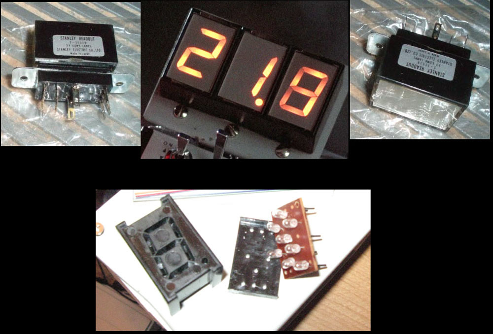

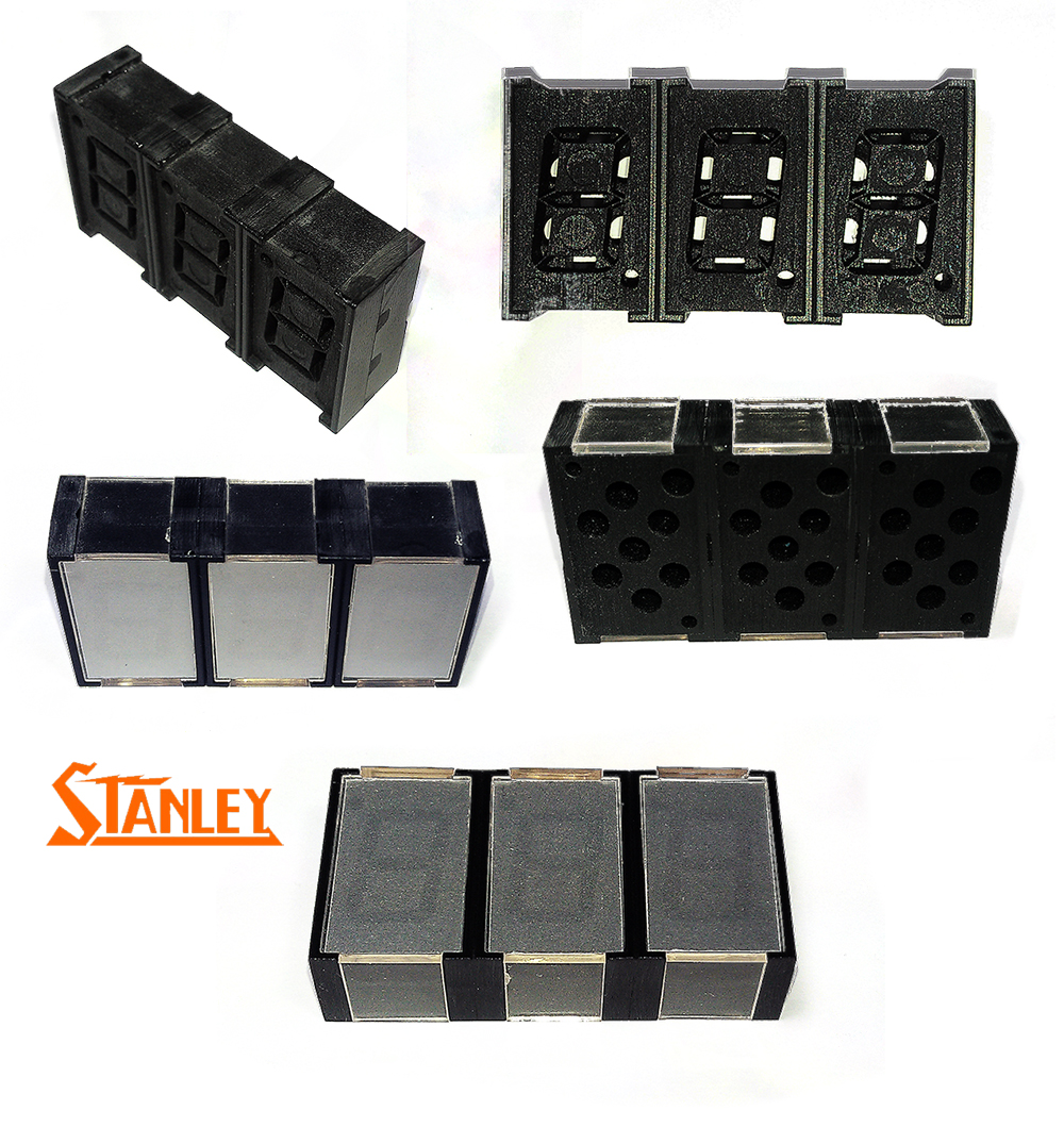

This post is regarding the Stanley Electronics Inc - Incandescent seven segment display.
- I've spent some time today and investigated - again - the display and how it is incorporated into the remote. I will repost some pictures for you which has been posted in the this tread before.
- Bellow is a picture from different angles of the display I have. This is a copy of the original which you can see on the right and finally a picture from the movie.

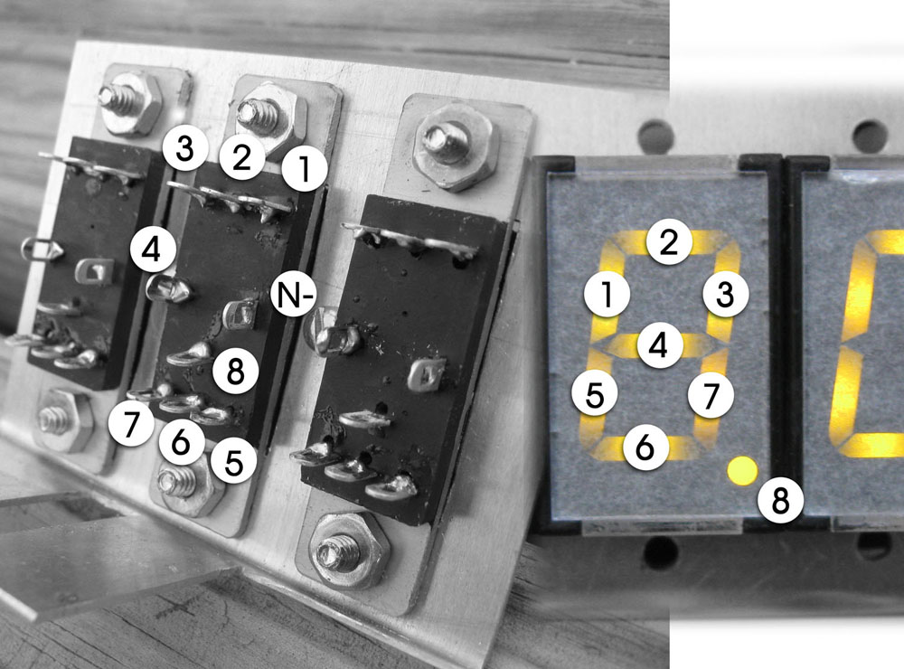

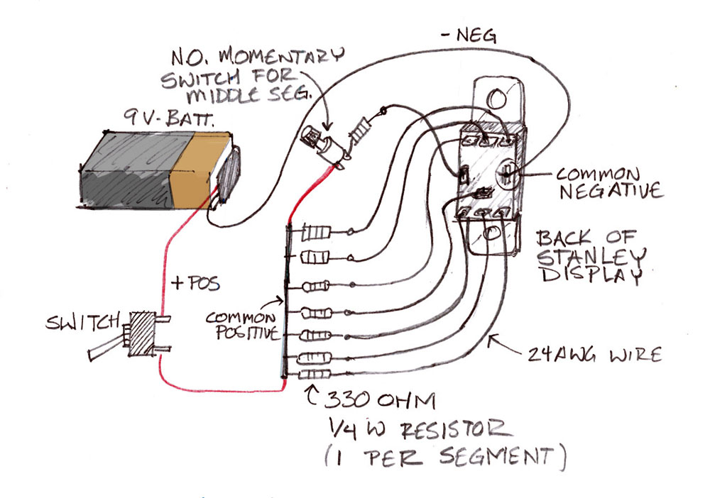

- I am fully aware of the fact that these displays are very hard to come by, I spent a looooong time before I obtained the one I have. I've been talking to another member here about making these available and I certainly positive to making this possible. Before I started to investigate exactly how the display(s) where mounted on the remote, I was sure that there where a gap between them, but looking at the pictures and movie again, I found that this is not the case. There is no gap, meaning: the display I have can be used as is in terms of how close they are to one another. I will then be able to produce a replica and skip the part of making single displays (3), it's simpler that way :thumbsup
- The original display use 5Vdc 60mA miniature incandescent lamp, anything ell's is not a true replication !

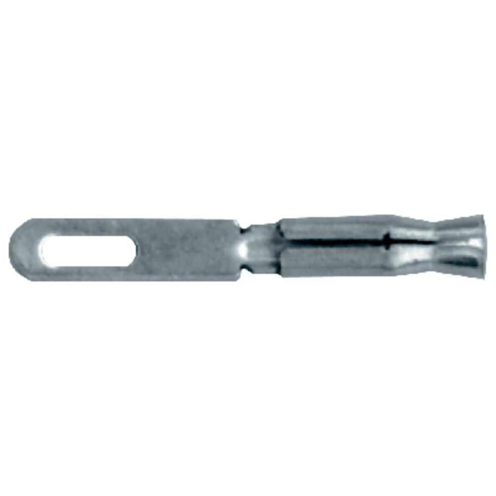

- What I am missing is the metal plate holding the PCB in place, the PCB itself and the bracket behind the display as seen in the second picture. These need to be developed and manufactured. Checking the picture, we can see that these are professional cable lugs with a flat pin exposed for the wire connection and I am planing to use this.
- The picture below shows the display and wire connection - common (-) ground. Reposting from prior posts.
- I guess that is it for now. It's time for me to make a mold and sort out the problems that might occur. Also design the backplate and PCB.
- When I am done, I will offer the display as a package with all parts necessary to make it work at a reasonable price.
