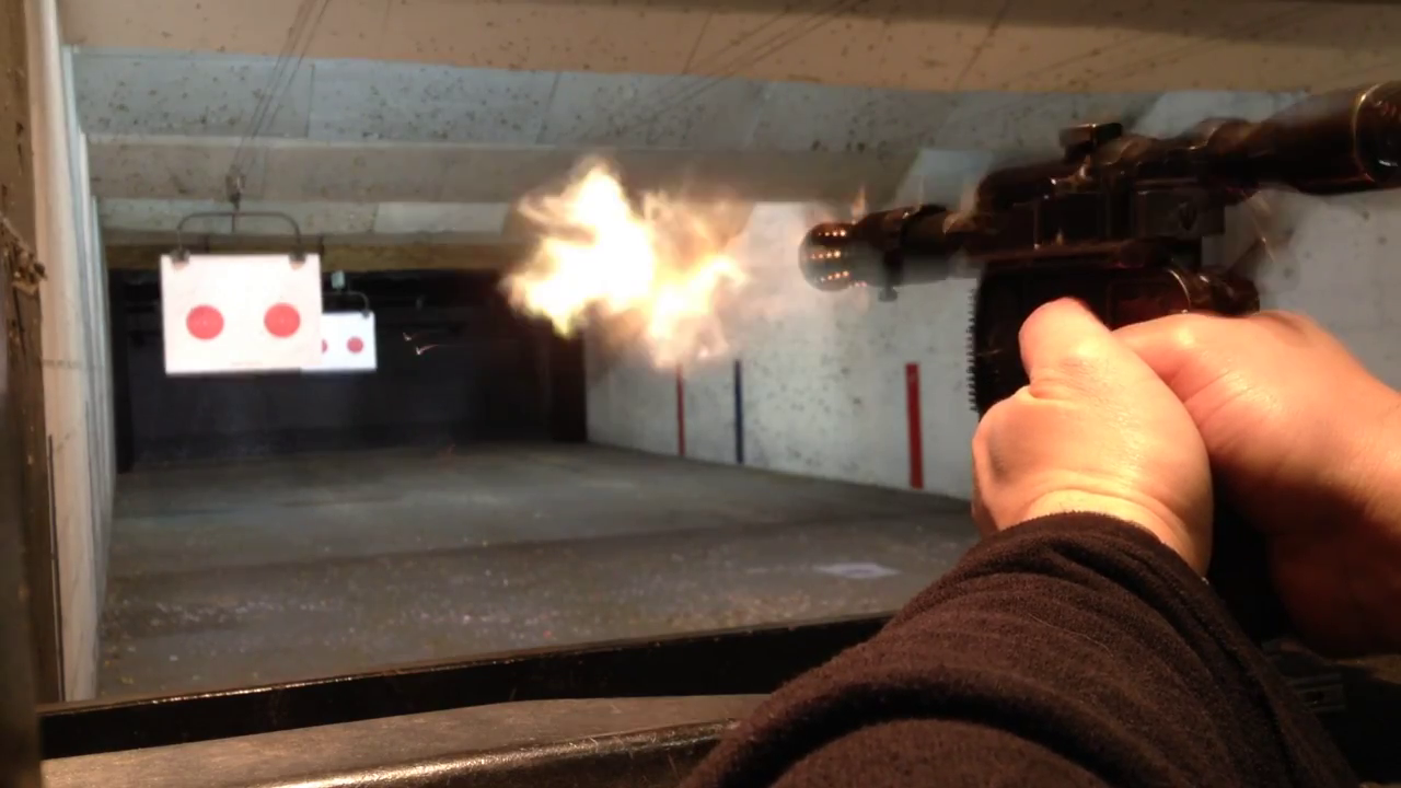

Fired today...
The brazing on the rear mount didn't hold... and the flash hider and bull barrel set screws came loose. Not dangerously but loose.
So gotta fix the stupid mount... thinking about drilling and epoxy this one. IF the other breaks loose will do the same.
Also, it will only fire a single round. As far as I can tell the bolt doesn't blow back to chamber the next round... so I have to manual cock, eject, load each round. bummer. No idea if it's because of the weight of the parts, or weak loads.
After I fix the mount I will try again with parts off to see.
Range guys freaked out over it though. ^_^ Looks cool on video with big flames

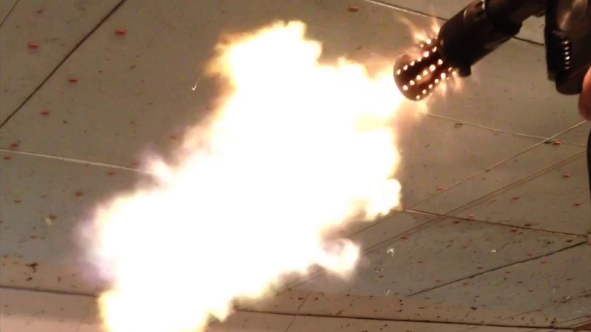

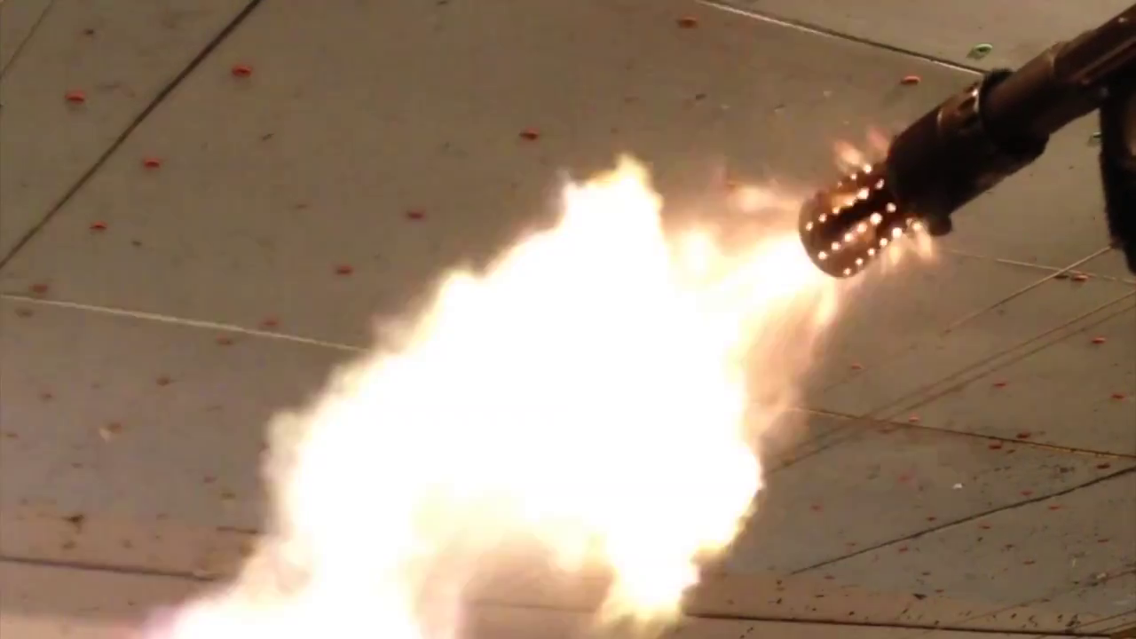

(stills from the vid!
Ferocious!
lol... I can try the solo limp wrist and see.
I was cool for sure, but the cycle issues were frustrating. Also because those springs are strong and pulling the bolt back manually so many times sucks with the scope in the way.
Still I put 50 rounds down range and toward the end figured out how to sight it even without my top sight greeblie. I got good groups toward the end...
...may be frustrating, but I give you points for not cursing...on tape. ...not even a "nurf hurder" slipped thru your lips!

That muzzle flash is incredible, what's it like without the "flash hider"
