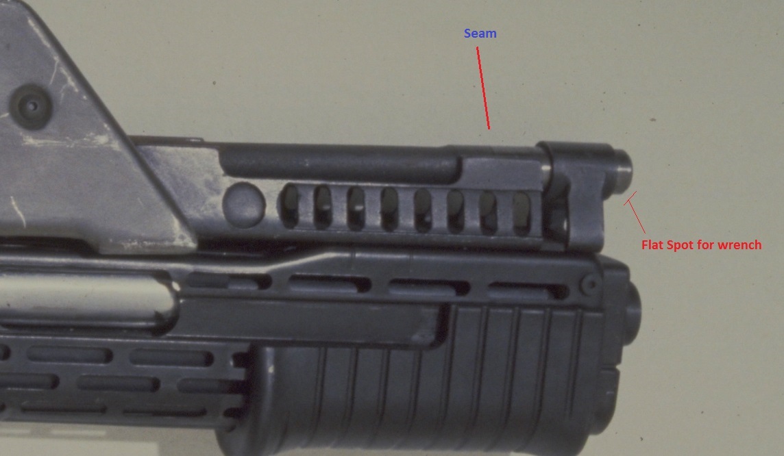

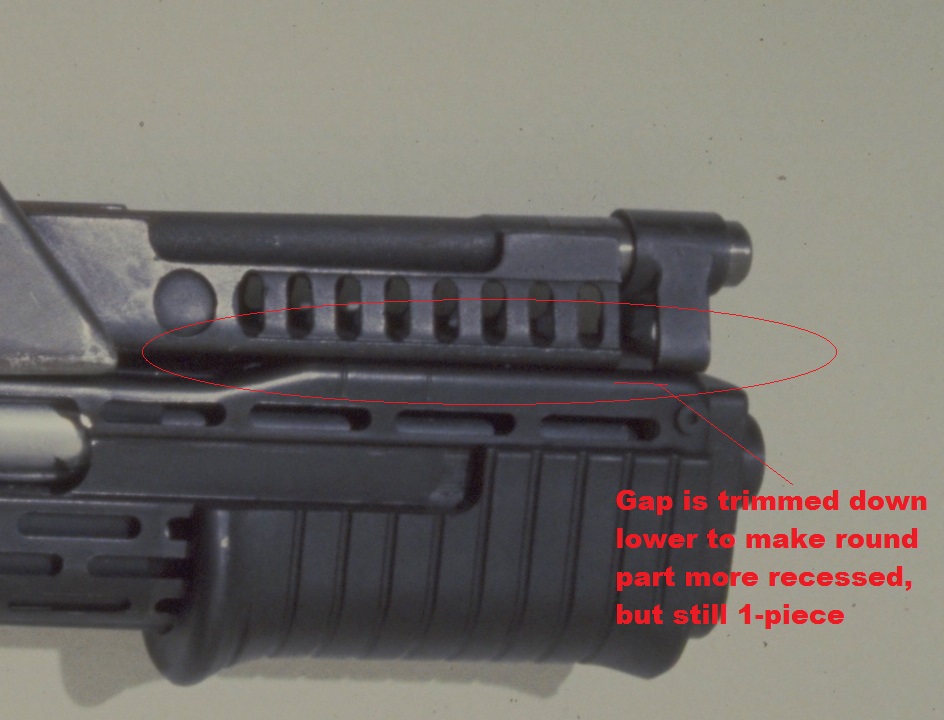

As for the 8 hole vents being 2-pieces, why is it that you say they "had to have" 2 pieces? I see a ridge on the metal in the gap that I can't help but interpret as being a continuation of the single assembly. The gap was cut back lower here to remove the rounded edge, but material is still there between them.
Vent Gap.jpgPlus it just makes sense as a 1-piece construction can have more mount points to the SPAS and provide overall stability. The is a LOT of weight on that forward sling point and there is no advantage to reducing its footprint but making the front triangle separate from the vent.
