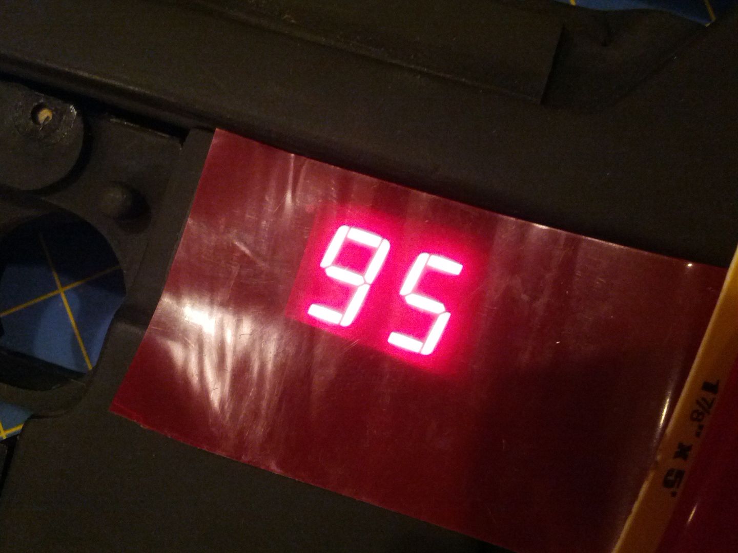

Lens filter was a thought of mine, too. On a whim while grabbing some groceries for dinner, I thought I would take a look around to see what I might find. As luck would have it, I came across this
Looks to be the right color I am wanting, and looks great over the LED counter
Best part is it is tape, so I don't to worry about any kind of adhesive

I think what I will end up doing is using two layers of the red tape with a thin piece of clear plastic over the top. Should give me the right coloring and diffusion that I'm looking for :thumbsup

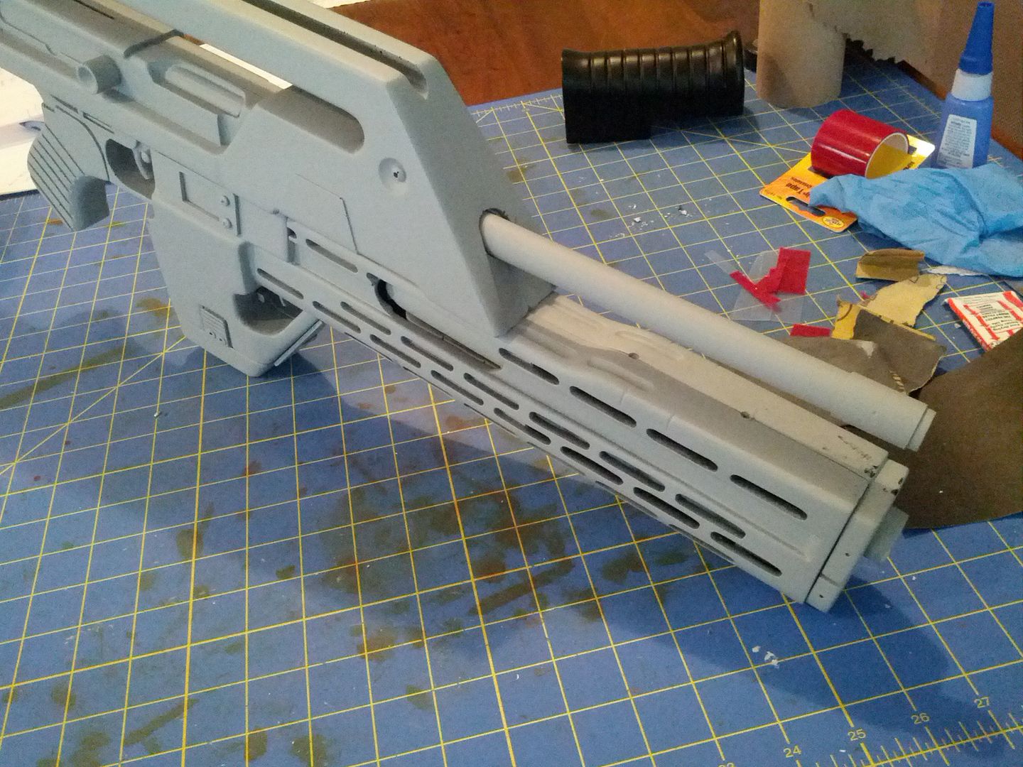

This morning I decided I would take a look at the barrel/vent assembly to see what I could do to create my own for a more authentic look. Took some measurements and went to the hardware store, and bought some 1/2" PVC pipe and a 1/2" brass coupler to make the barrel. The vent assembly will most likely be made from styrene. Cut the PVC tube to size, slipped the coupler over the end, and then using a 1/2" bore bit I drilled 3" into the shroud so that I could sink the barrel in and keep it secure.
It's just slightly crooked, but I can certainly straighten it out with a bit of sanding and keeping it straight while gluing.
All the parts have been sprayed with flat black and are currently drying right now. Just need to draft a pattern for the vent assembly so I can cut those from styrene and get them ready for paint too!
