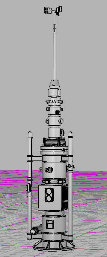

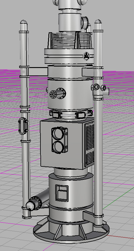

The first step was research. There aren't a lot of good photos of the Episode Four Vaporators, there are a bunch of the Vaporators from Episode One which are still standing in the Tunisian desert but I wanted to base mine on the original. But they are pretty simple objects and one fairly clear photo provided most of the info needed. There was also a copy of the blueprint for the Vaporator in the Star Wars Blueprints book which helped with overall dimensions and proportions.Using these as guides I created a 3D model of the Vaporator using Rhino modeling software.
The computer model allowed me to work out which parts would be made from scratch and which parts would be 3D printed. In the end most of the structure was built up out of acrylic and most of the detail parts were 3D printed.

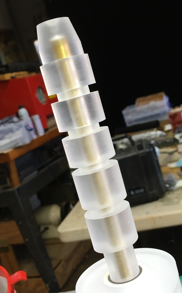

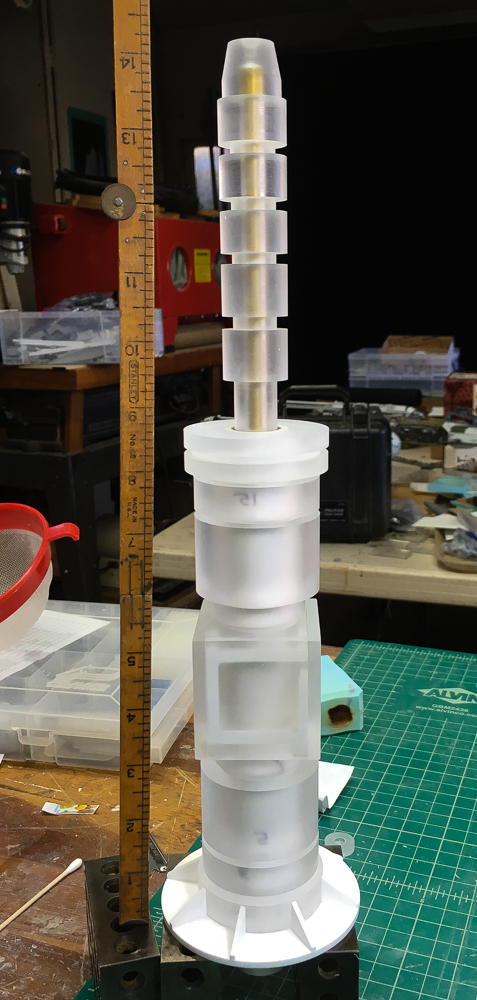

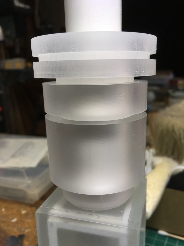

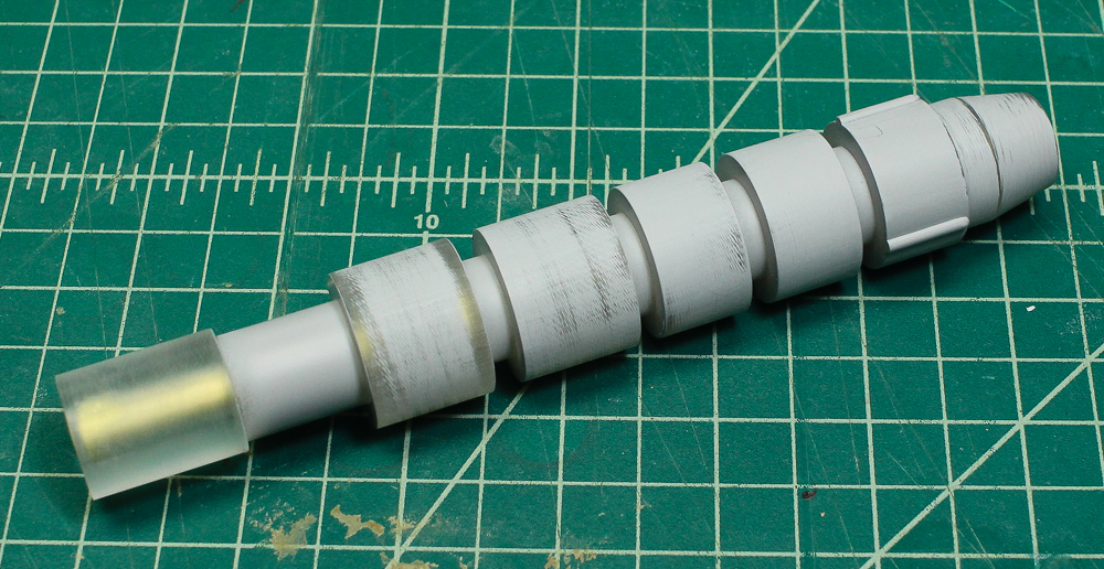

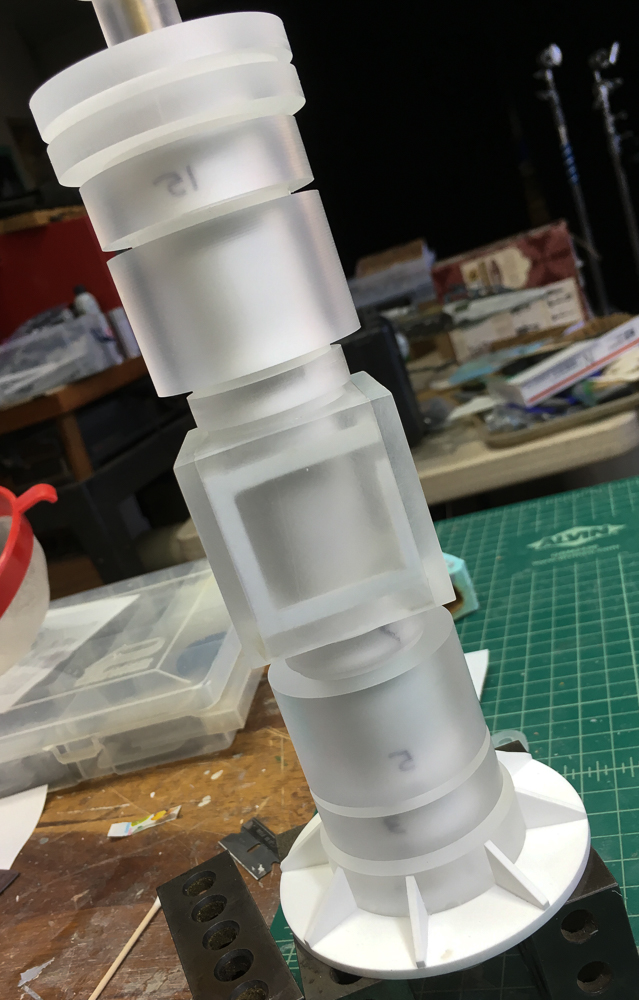

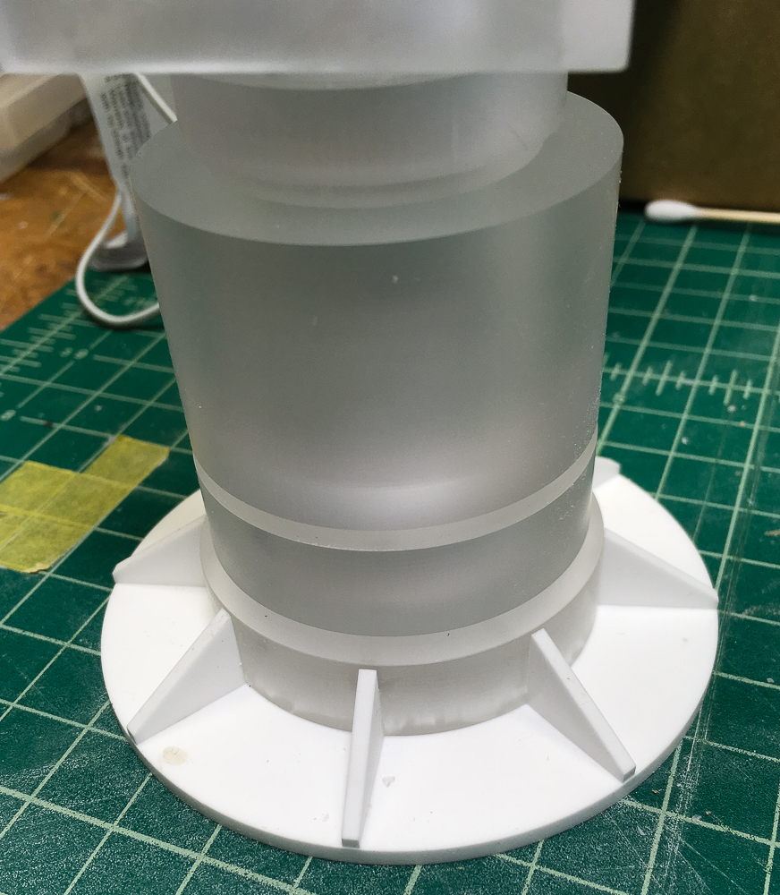

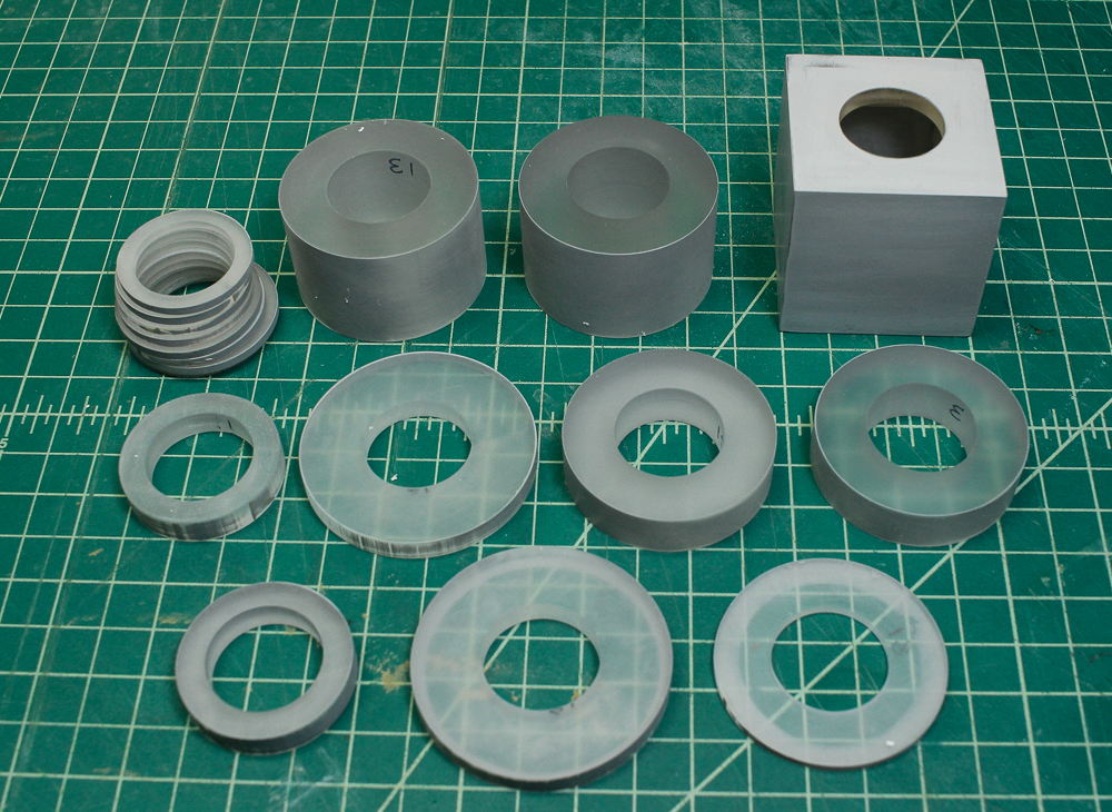

The first step was to turn the various round parts of the body out of acrylic on a machine lathe. Rather than turn the sections together I decided to turn each part separately and the stack them together on a core. The cube section was built up out of 1/4 inch thick acrylic sheet.

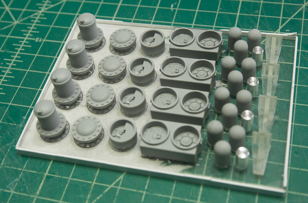

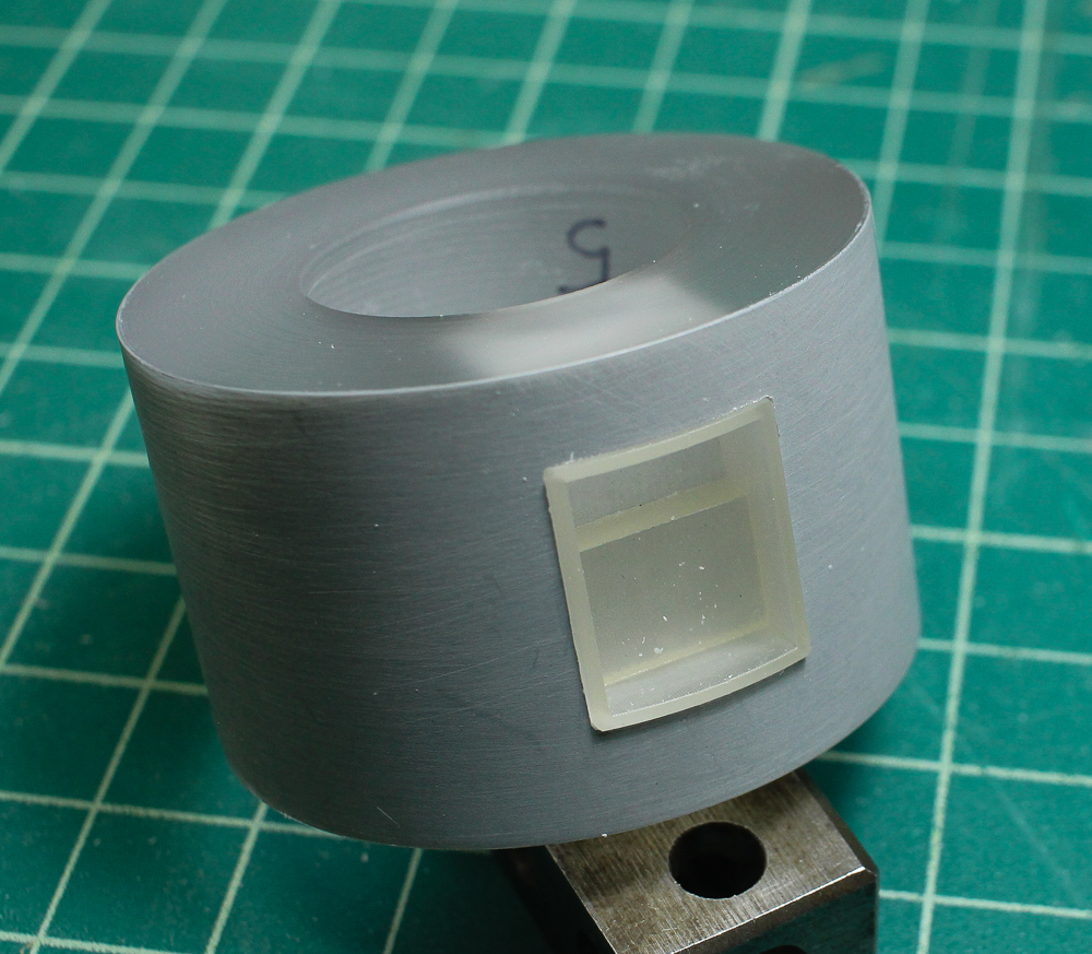

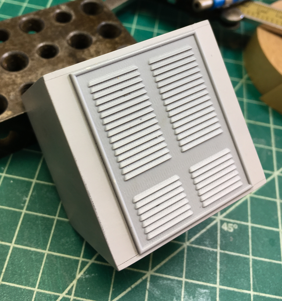

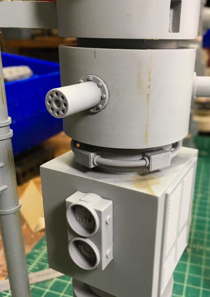

The fine detailed parts were mostly 3D printed. Some of the parts were attached to the main body to be cast in place while others would be molded and cast separately to be assembled later.

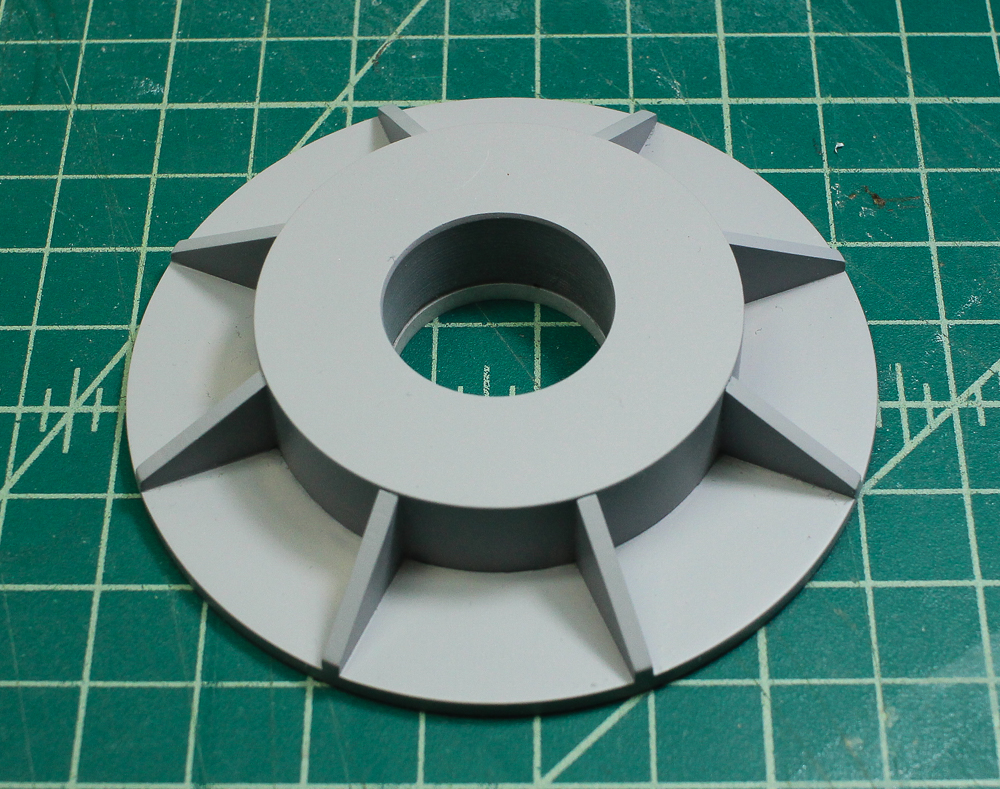

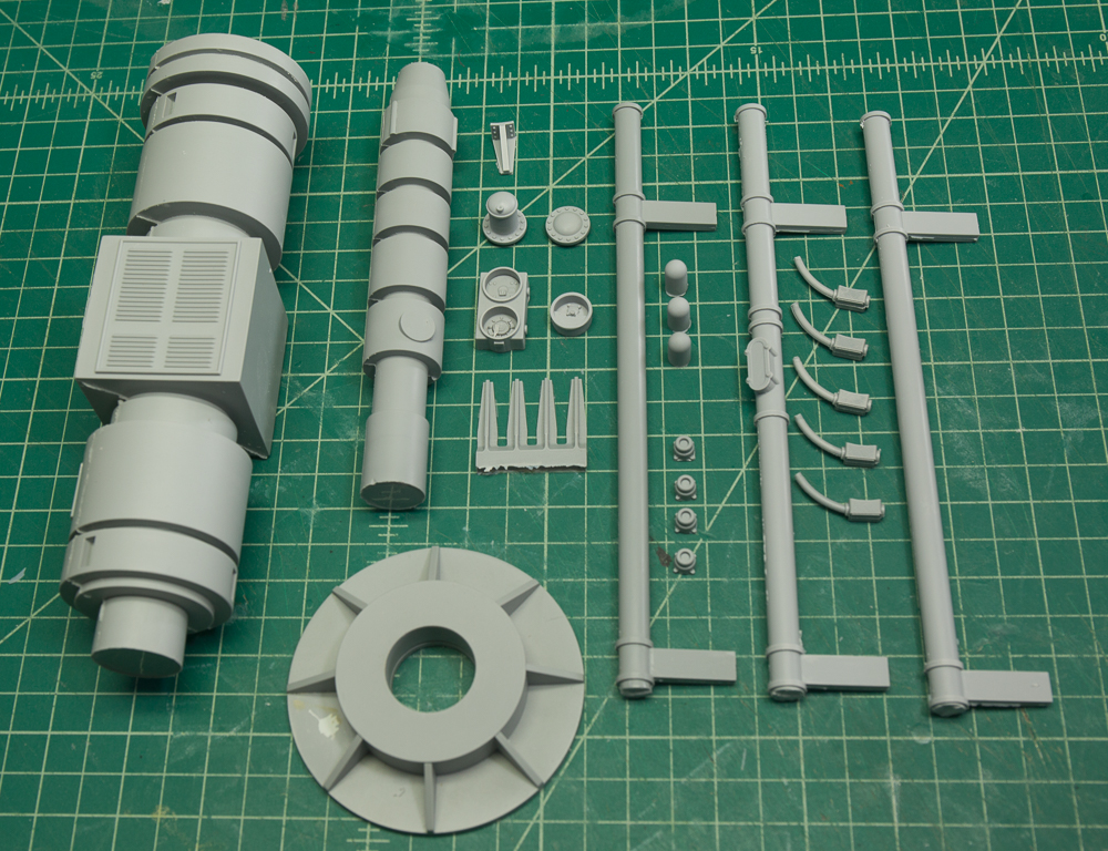

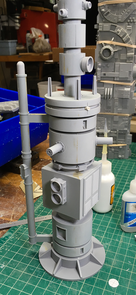

All the main body parts were disassembled, primed and sanded smooth, then reassembled into three major sections for molding,; the Base, the large Main Body and the smaller Upper Body.

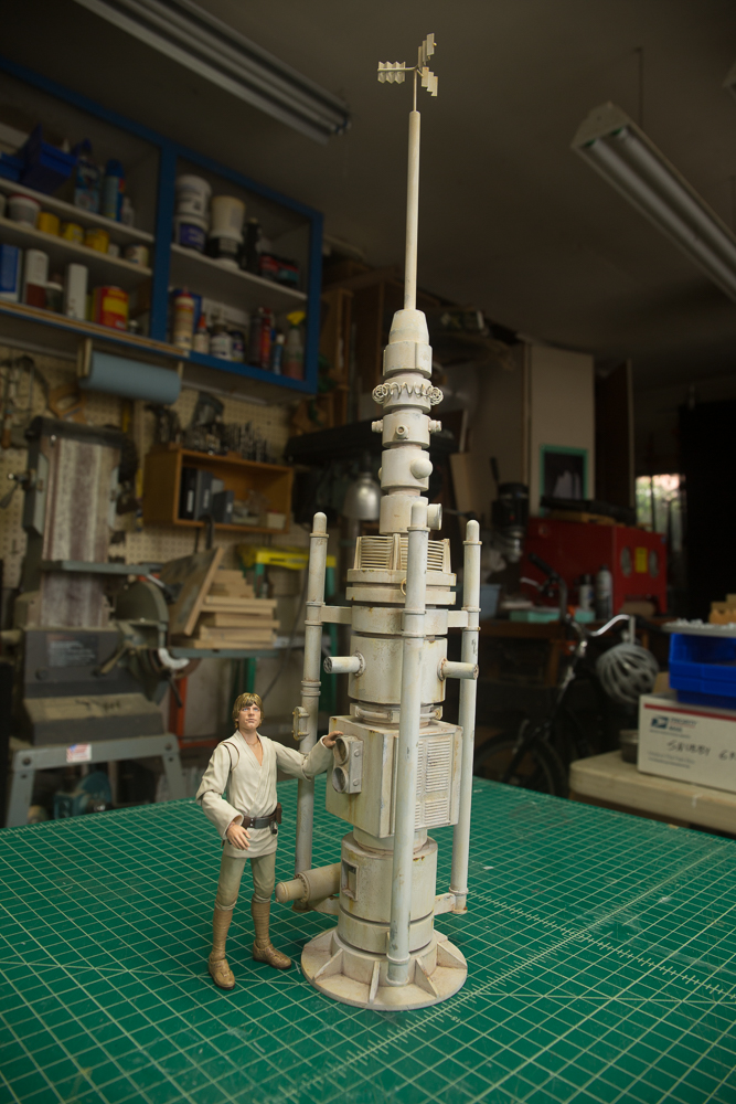

Here is are all the pattern parts fit together prior to molding. The three vertical Wing pipes were made out of brass tubing with 3D printed details. It was so cool to see the whole thing together for the first time!

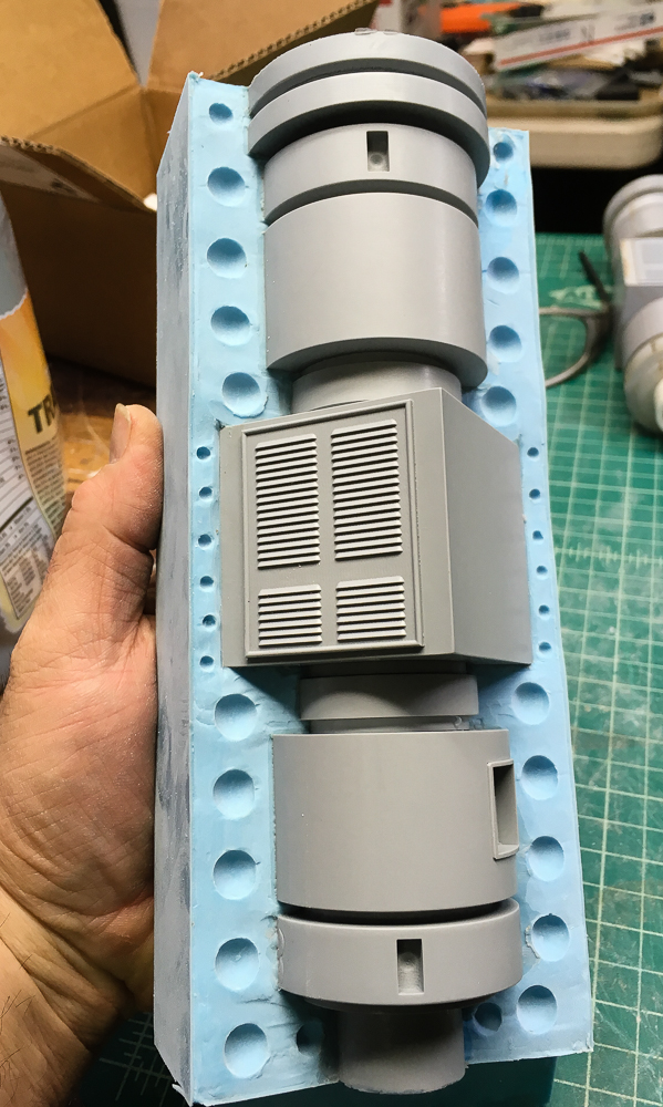

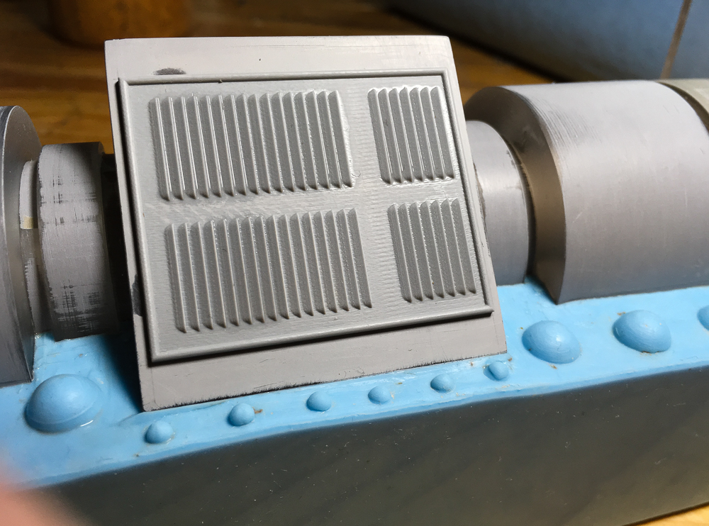

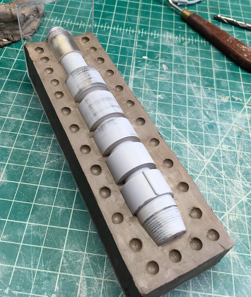

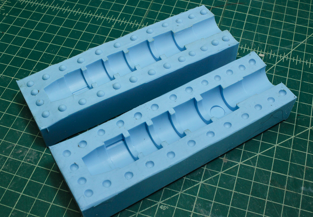

On to molding and casting... All of the major sections required multi piece molds. The process was more or less the same for each, the part was imbedded in water based modeling clay (I like WED clay from Laguna Clay) which is carefully contoured to the desired parting line. Then negative hemispherical locking dimples are cut into the clay and the first half of the mold is poured. After the silicone has cured for 24 hours the mold is flipped over and all the clay removed. This is why i like using water based clay, it can be cleaned off completely with warm water and carefully brushing. The cured rubber is coated with a release agent and the second have of the mold was poured. In the case of the main body part a three piece mold was required for the top surface.

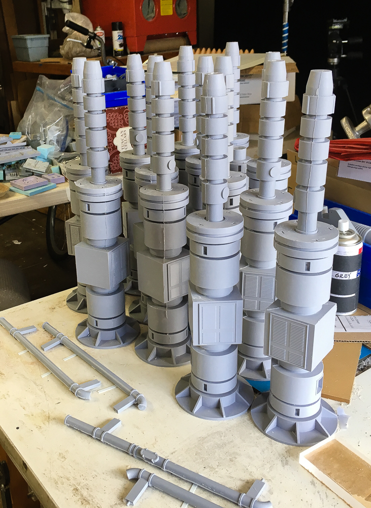

Pretty much every part was molded except for the brass tube mast and copper wire used for the condenser coils. Gang molds were made of the small detail parts so I wouldn't have to make so many individual pours.
The parts were pressure cast in grey tinted polyurethane resin.
The beginning of a decent Moisture Farm!

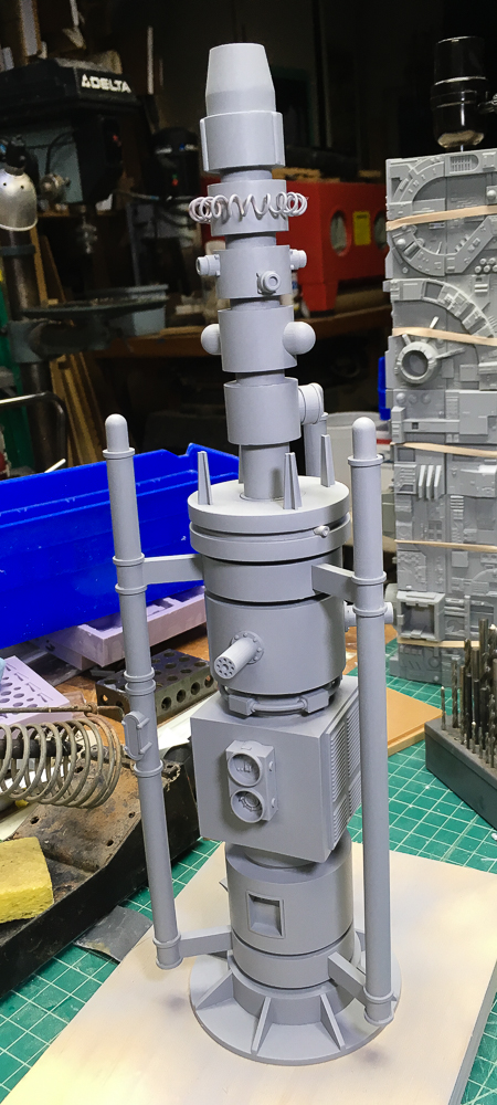

The minimal flash lines were cleaned up and the first Vap was assembled and primed. The castings went together pretty much as expected with only minor adjustments.
Now it's ready for painting and weathering!

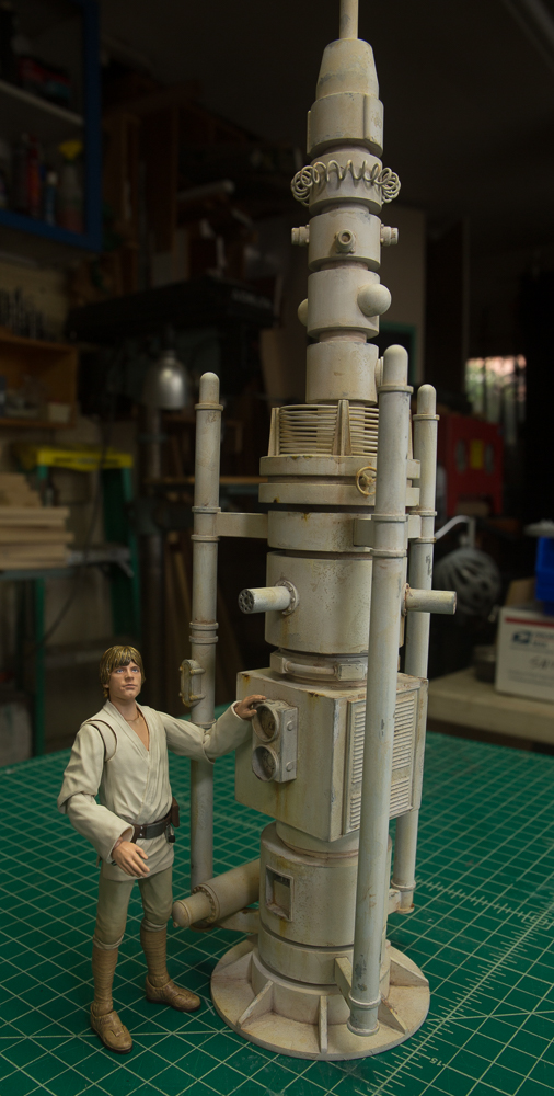

My buddy Mike Stuart did a fantastic job painting the Vaporator for me! It really looks like it belongs on the dusty plains of Tatooine!
And yes, kits will be available... stay tuned!
