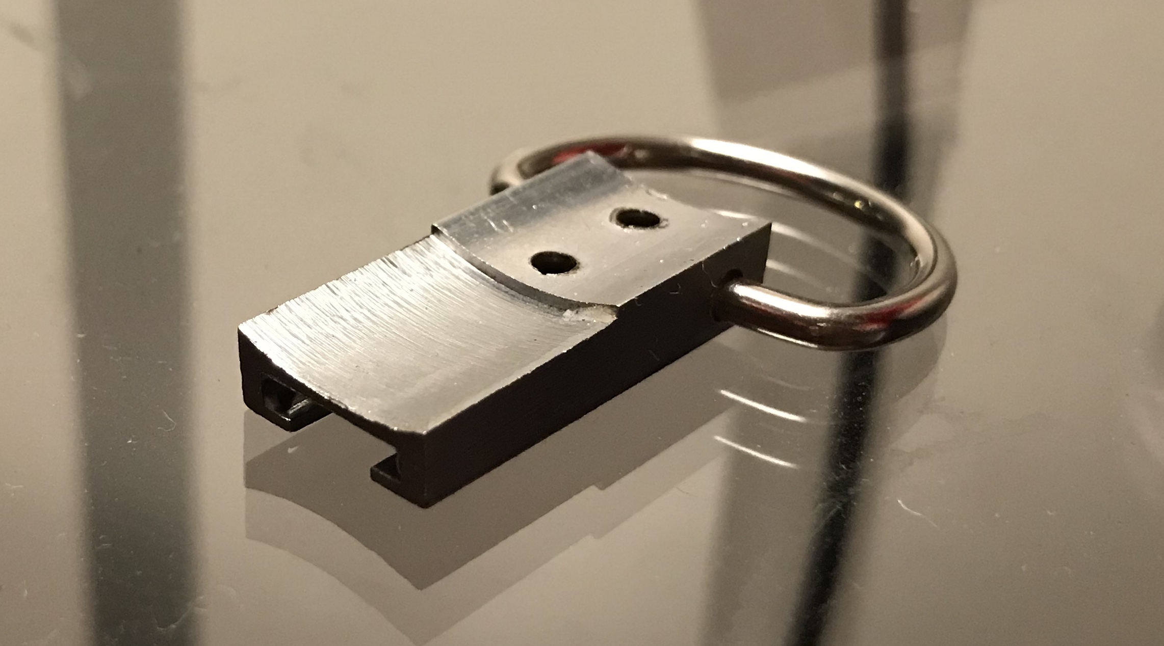

I’ve been collecting parts for this build for a long time. The Kobold clip came from the damaged Flash I used for the severed hand saber. I found an extension board on the bay from overseas.
I finally picked up a graflex with a camera kit last week (and it’s been through the ringer)

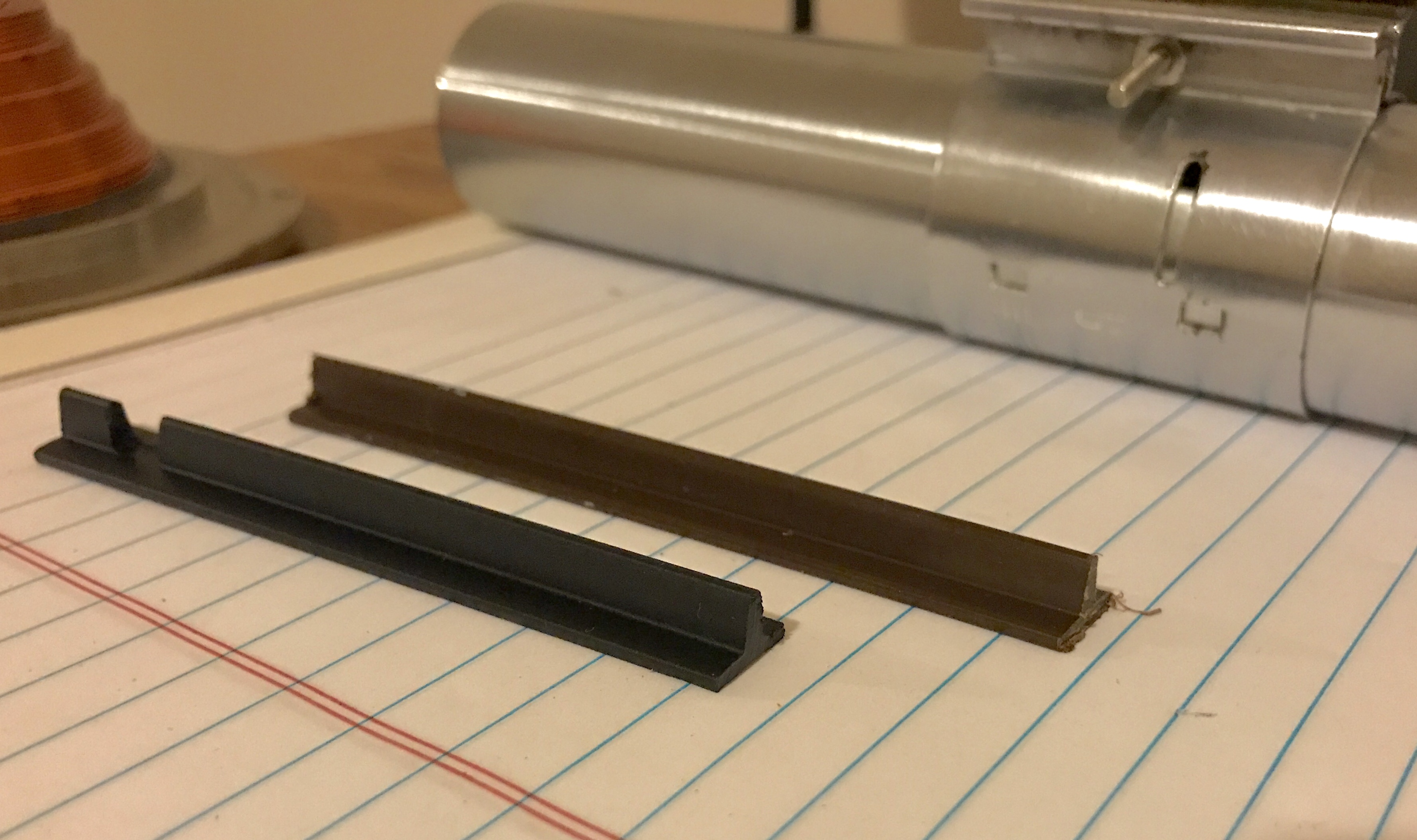

today i sculpted some of that awesome T strip from Malaysia wth a Dremel. It takes such a light touch! I filled in any over cutting with a little smear of apoxie sculpt.
A little satin black krylon and flat krylon clear coat and they shape up quite nice!

Hey thd9791 ! Those look GREAT! It looks like you sanded the bottoms a bit too. Did you use the sandpaper on a pipe trick?
And did you leave the bottoms unpainted so that the glue/tape will adhere better?
Thanks everyone! I actually hit the bottoms of the track with a sanding drum. They came out a bit sloppy underneath, it was helped by a half round *needle file*, but really the important part is that only two parts touch the graflex and that would be the edges. They all have a bit different glue channel! In the end they work basically.
Heres the camera and card!
and I painted the whole thing. I was going to leave the bottoms untouched but there was an edge that risked flaking off if touched wrong. I wanted a full sealed coat

2) tell you that the thickness of the base is identical to GINO's track. The width is 1/32 less and the height is nearly identical as well. Other than the shape and lack of a glue channel ... this is REALLY close. (Gino handled and worked with props from the archives I think and that's why he designed such thin track. Roy and Todd's are a bit thicker and feel less fragile, albeit less accurate to obsessive geeks like us)
I'm using e6000 on them right now. They slide around and won't set as quick as epoxy so I electrical taped them to the flash overnight. :) the silicone glue should take the vibration of a drill better than epoxy. so excited!

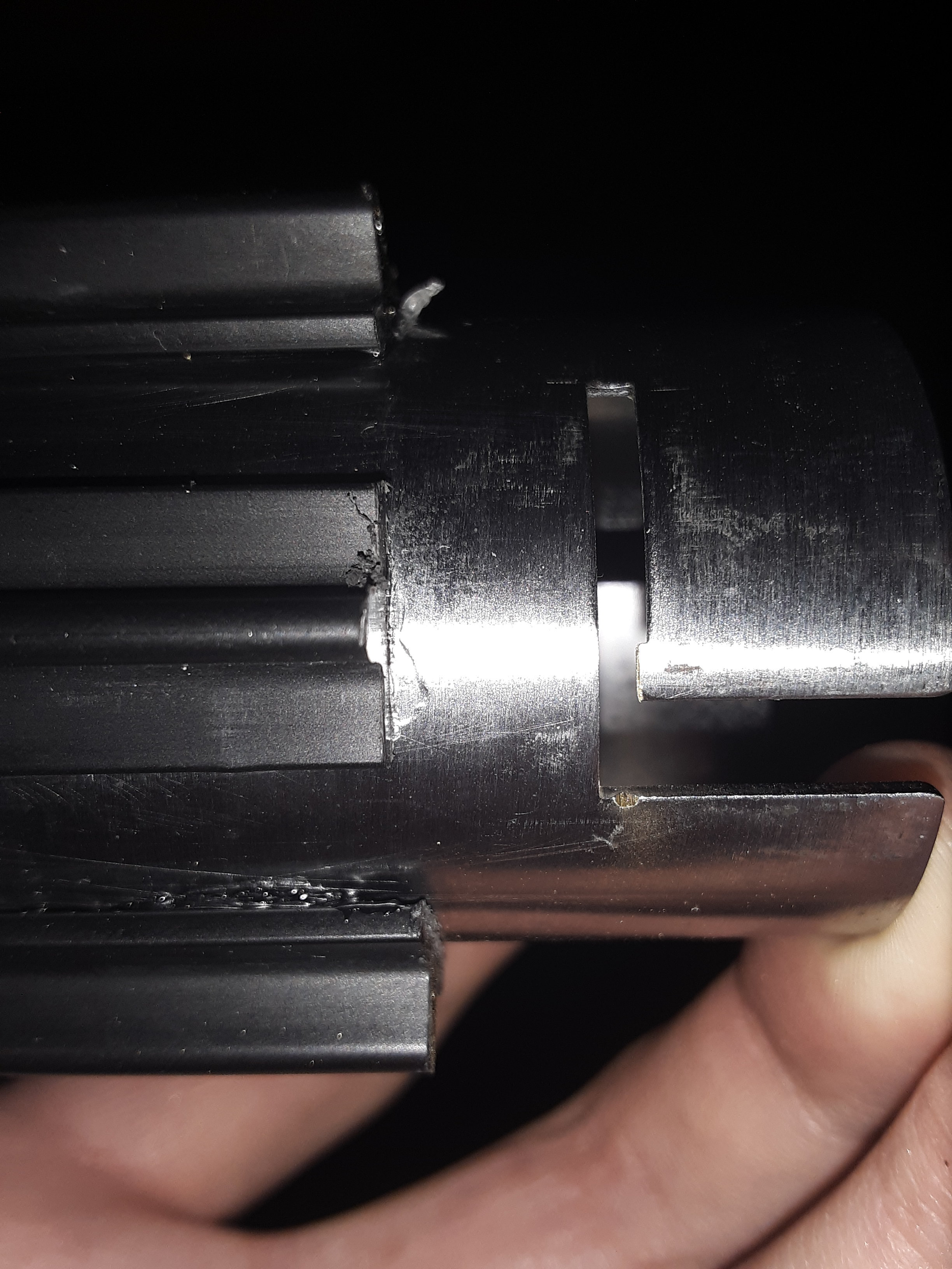

After drilling the holes, turning the screws I got from Roy in there and popping the rivets on, I spent some time sourcing some vinyl mirror tape! Here are some shots next to my “less” fragile and ongoing projects, and the ol’ Piano tuning supplies. oh the pop riveter was so strong the rivets pulled the graflex endcap outward, making the kobold hover on one end. I took a wooden dowel and used it as a buffer to hammer the kobold down, and thus flatten the endcap!

Hey so I updated this saber a bunch. Found a better real clamp and stuff...
I also ripped off these grips. They NEVER cured well. So I unscrewed the screws, slipped a plastic putty knife under there and peeled the e6000 off!
I could thankfully use the original holes (replaced the screws with self tapping vintage electronics screws) and managed to trim a set of wannawanga grips one by one to match the existing holes.
I did this using a grinding stone bit to eyeball the hole location, sinking it through. pausing to drill the hole, and opening up the notch afterward.
The grips were a tad too long, so I actually trimmed the "tooth" as an experiment. It worked

I left the real kobold in place too - here are some shots before the xacto trimming of glue
also slid the grinding stone against the ends of the t track and it left some of them slick and smooth!
