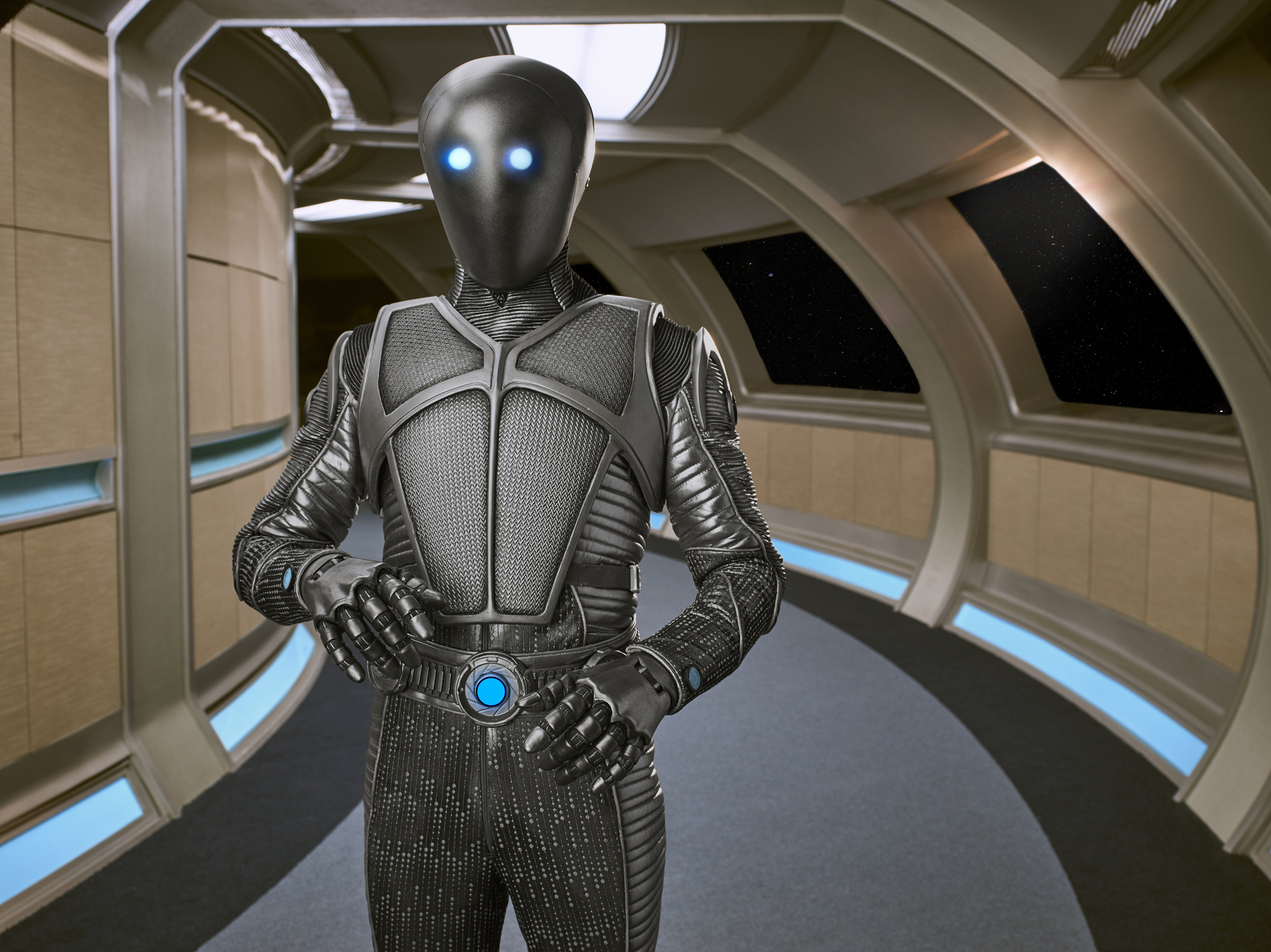

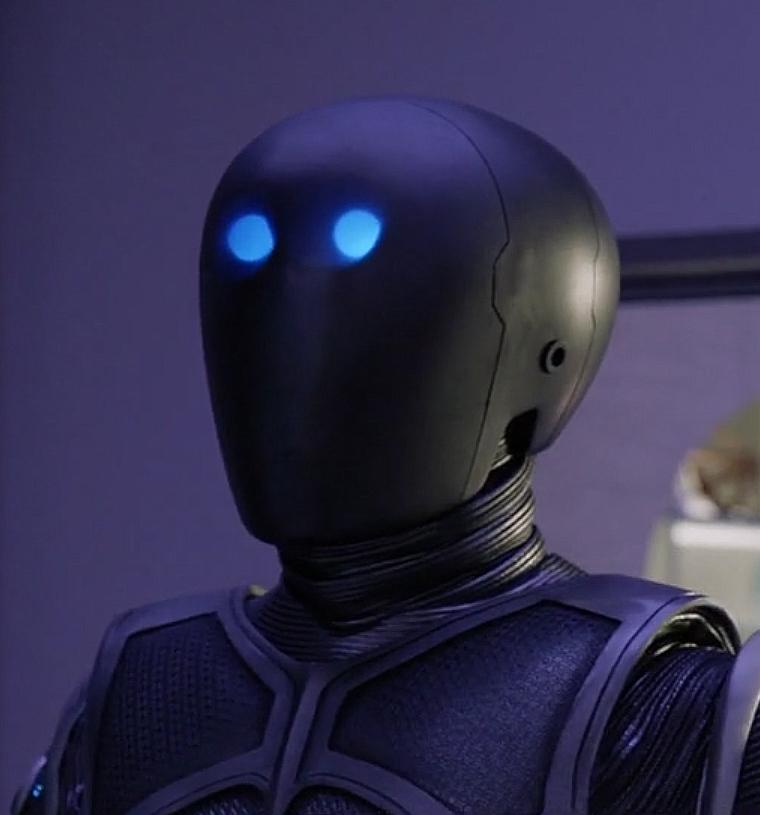

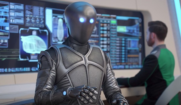

Well the wife and I just finished watching the second episode of The Orville on Hulu. I love this show!!!One character that I already love is Isaac the Science officer from Kaylon-1. Wouldn't it be cool to build his outfit???I am planning a build... What do you guys think?

I think it's a great idea.
I was wondering if anyone was going to challenge costume builds from the show.
https://www.therpf.com/attachment.php?attachmentid=759698&d=1505786324
Breathing would be one thing and seeing would be another.
Since this is a costume you can use creative license and make the face cover out of a type of breathable mesh.
And you may be able to partially see through it.
Added note:
If the face cover was made of a rigid perforated material then covered in a titanium metallic color nylon (etc),
then lights (blue LEDs) could also be attached on the inside.
I think the body suit is going to be a huge challenge. Would love to see your technique.
Post progress pics.

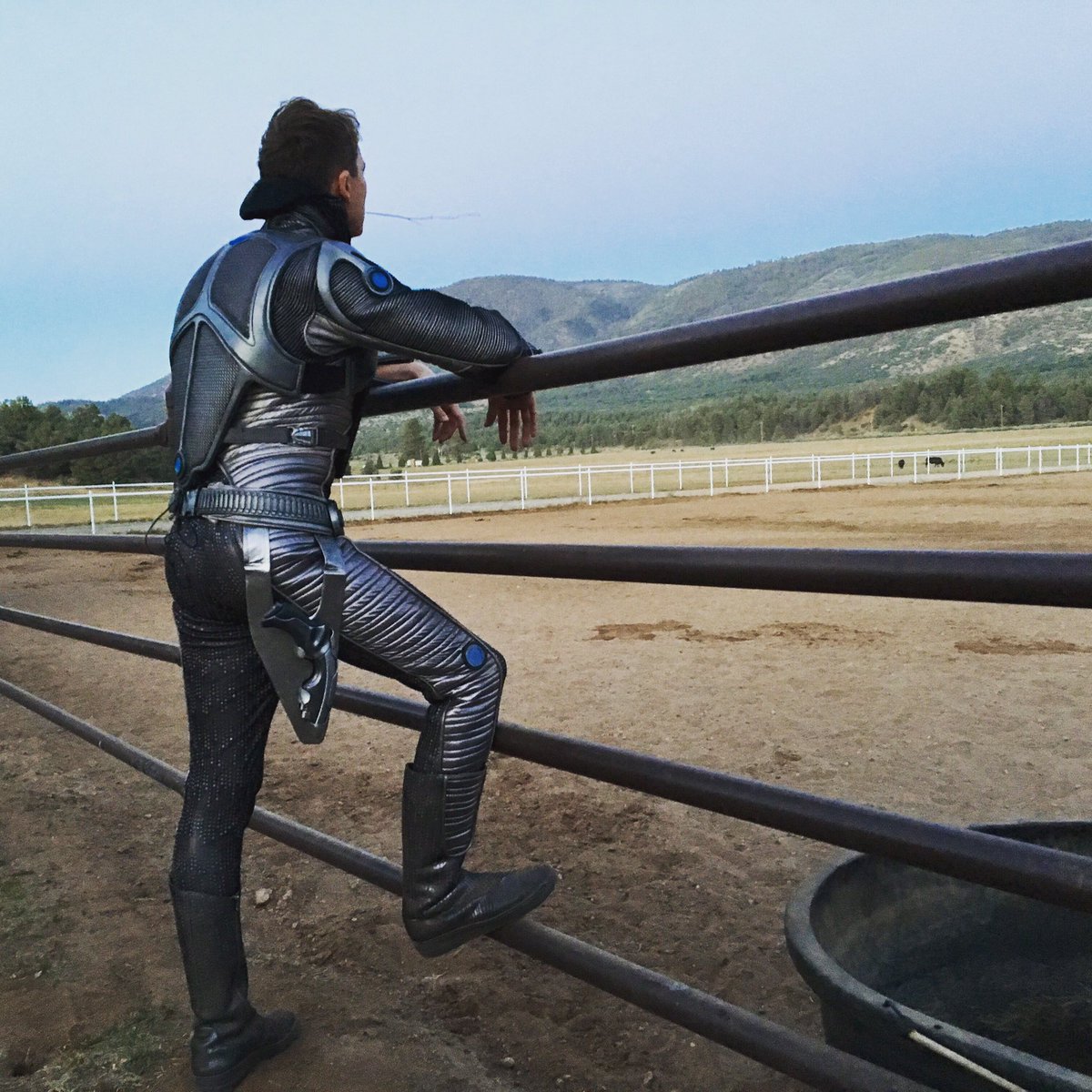

Looking at the picture above, it appears someone off camera is guiding the character by a voice radio transmitter and receiver.
I think these are his handlers on set:
It seems that if you go fairly accurate to the face shield of the helmet, you won't have to see through it at all.
But you will have to breath :)
Just have a "handler" guide you around a convention floor while talking to you via radio.....
Is this something you would consider doing for your costume?

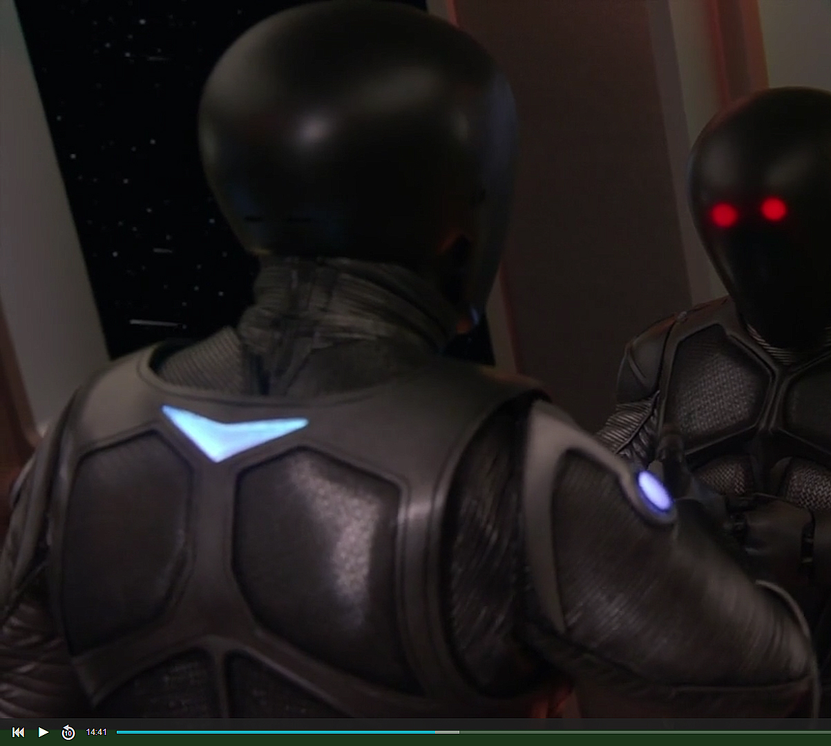

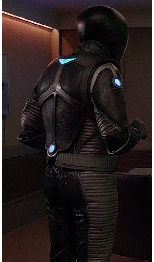

Incredibly helpful photos guy!!! I couldn't find a picture of the back of the suit.... Disappointing that the back of the suit is so bland.... I tell you guys the hardest thing that i can see to this build is to try and find the material for the legs...
Honestly the part of the build that I most excited about is the helmet. the rest is really straight forward sewing with a little bit of sculpting work on the chest plate and shoulders.
The basic form of the helmet is just going to be fun to hand shape. Then Vacuum forming 2-3 mil plexi over the plug.
Does anybody have ideas about a Chrome looking film like window tint that could be applied to the plexi? This would keep it see through from the inside.....

I reckon the front of the head is formed in clear or tinted perspex, then lightly misted with silver paint to leave just a little ision at the front. The lights are probably either LEDs or circles of EL tape mounted at eyebrow height.
I'd love to see this done. The helmet, at least the front section, is definitely a clear piece that's been misted with a one-way transparent silver. The eyes look like half spherical lights, probably mounted just above where the actors eyes are.
