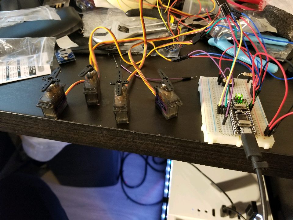

As for total progress, i was able to figure out how to code arduino (kinda hard for me while simultaneously learning java). And the servos are up and running, I bought another mask to use as a permanant face shell, and I hope to have time to do it sometime this week!

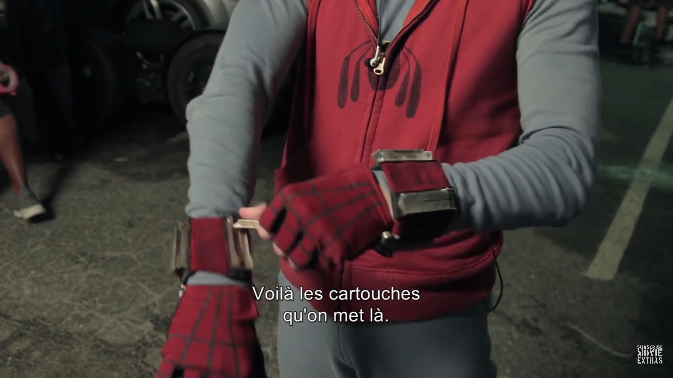

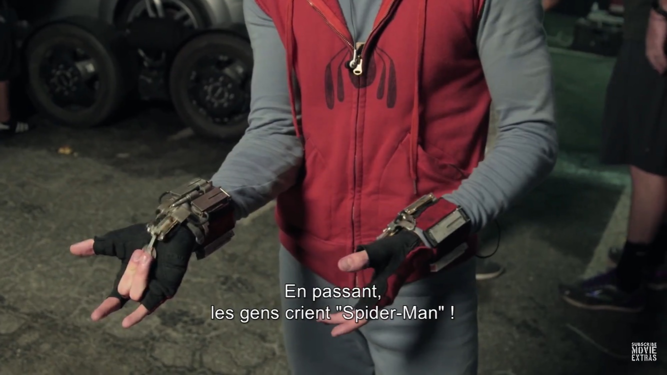

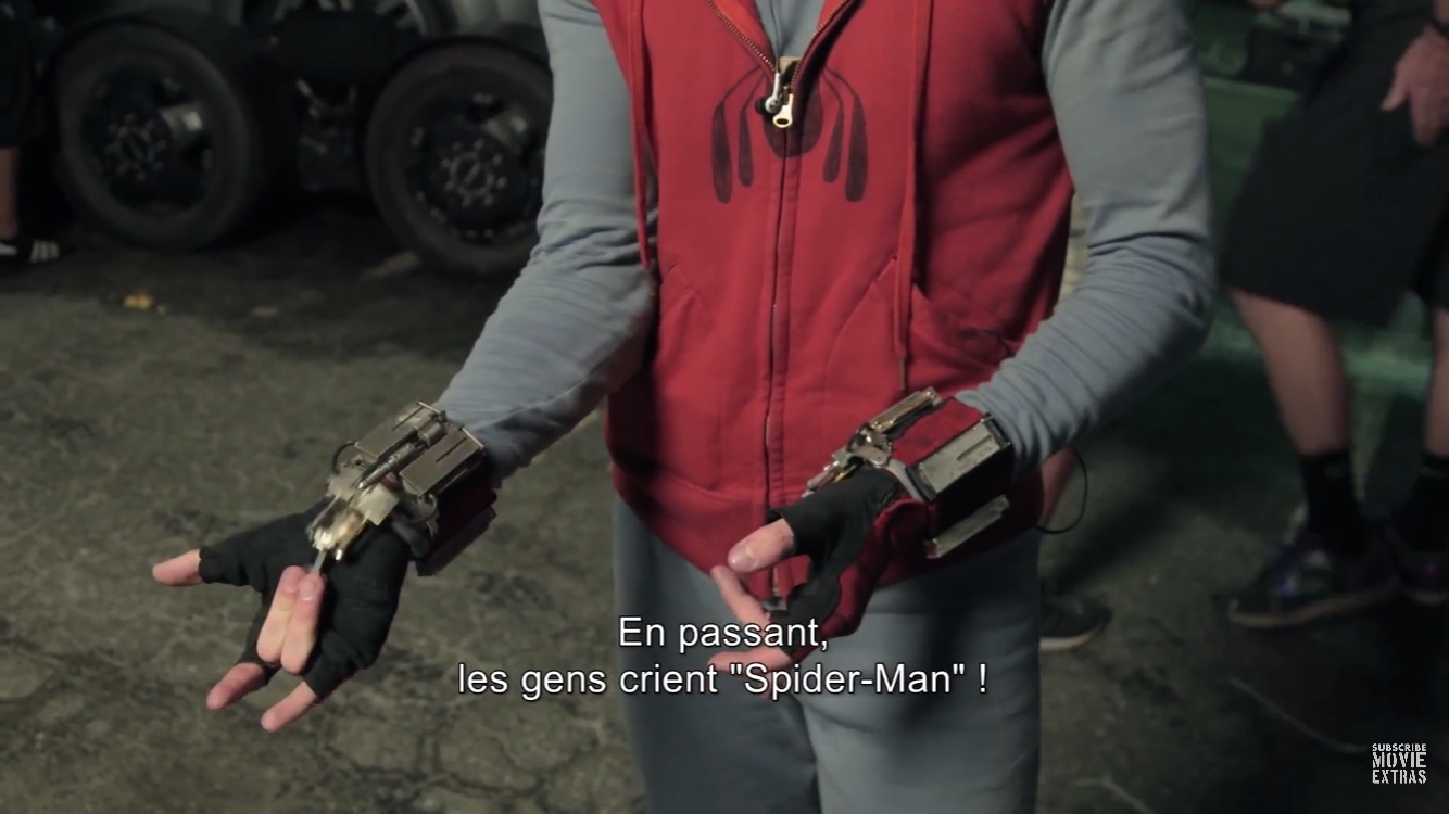

I got some pretty good reference for the homemade web shooters if anyone needs it don’t ask me why there are french subs I don’t know either. Does anyone have any more good references for the homemade shooters cause I’m trying to make a pair

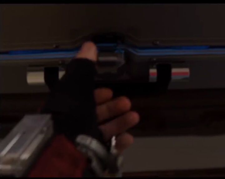

I already incorporated it! I'll tear apart one of the darts soon but inside the suction cup as a counter balance, I have a small magnet behind the suction cup. If I shoot some beams in my basement (which a suction cup wont stick to) it has SOME attraction. Obviously not enough to counteract a bounce, but I'll definitely look into making a full magnet dart! Love the sack idea since it will probably need to be more than a single magnet
Also I added a release mechanism behind the cartridge so the empty cartridges can pop out when the lever in the back is pulled. Heres a demo video, but I missed my mirrors when shooting the dart this time...

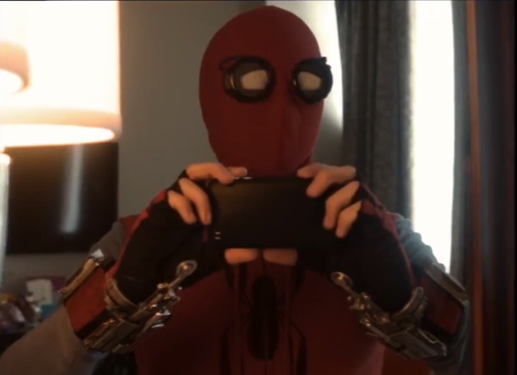

So Ive been working on the lenses for the past year, and I have been thinking of techniques involving servos, solenoids, puppetering, and even rubber bands.
AFTER A YEAR OF THINKING HOW THIS WOULD BE POSSIBLE, IVE DONE IT.
(Also ignore the hot glue, the lens wasnt made for this faceshell and I 100% plan on making a new face shell and lens setup for the final assembly. All of this is just proof of concept now)
These are, what I believe to be, the most convincing electronic lenses that are on the internet.
Yes I only animated the top lens as of right now, since I essentially wanted to see if my mechanism even worked before putting the effort to apply it to both lenses. Expect another video with the full animated eye soon and a more flush lens soon!
Just finished hooking up the bottom shutter and it is everything I ever dreamed it to be. I already have the materials for a vacuform so I plan on vacuforming my actual facemask (since this white one is temporary and too large) and have the lens fit a bit more snug than they do in the video. One of my servos is broken so thats why you hear a residual noise when the shutters are in the closed position, but thats an easy replacement.

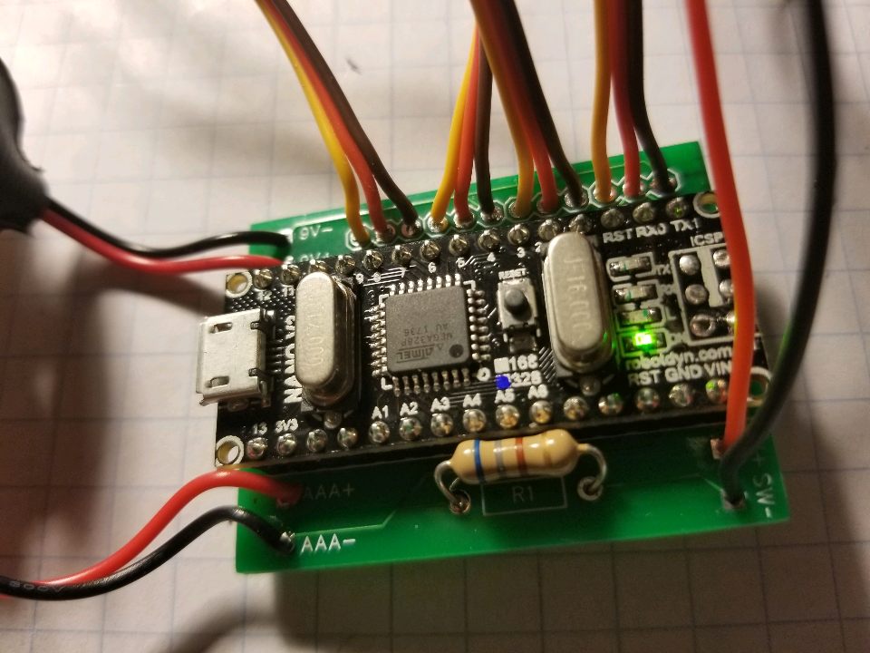

Update, kinda big? but not an exciting big update, just a major step toward a final product!
I designed a custom PCB (Power Control Board) to house my Arduino Nano, resistor, battery leads, and servo leads!
Here is before with the breadboard:
And this is after the custom PCB!
Here is a video of the entire thing in action, (one of the new servos I received from amazon is also bad so im probably going to order another set )

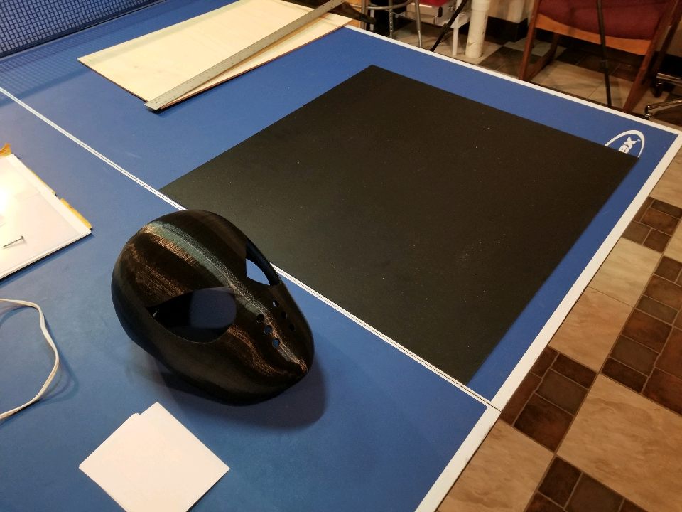

Small update, but I finally made a vacuform for my new faceshell!
The faceshell im using comes from User SpeedyDemon on thingiverse (Since im in college and cant afford a professional faceshell from tjack fx)
Spider man Homecoming faceshell w/ eyes by SpeedyDemon
I printed it on the larger format 3d printer i have at my work!
Next to is is the material I plan to vacuform the shell with, 1/16" PETG. I have done a test with a golf ball and the results were very sobering. I definitely need a better heating source for the final pull:

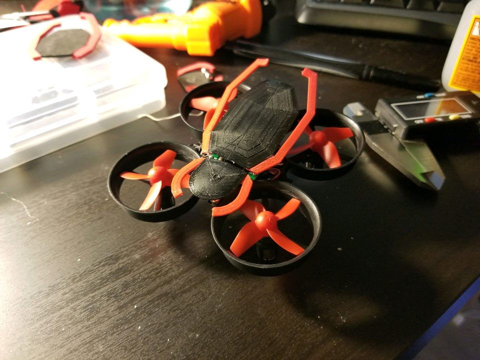

I also finally got around to designing the body parts for the tiny drone:
It came out as well as a 5 min designed part can come out to be i guess. Not really focused on this bit of tech anymore since the web shooter and lenses have taken so much of my free time lately.
