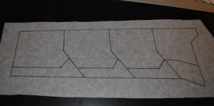

As usual, the first step was to create a fitting mock up. I created the mock up in muslin, sketched out the initial design lines and sent it off to the client.
He then sent me back images of the test fit. The mock up is tight on him and should be. There will be a number of areas of the costume that will be made of stretch fabrics to allow for fitting ease and movement. What I was mainly looking for in this mock up was proportion. I wanted the shoulders to fit, the curves to follow the body and the cut lines that will make up the larger shapes on the arms, chest and shoulders to fall in the right places.

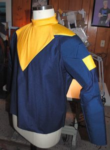

Once I had the mock up back, I began with the undershirt. Like many of the costumes of this type that I make, it will consist of an undershirt with the structured sleeves and the vest that will fit over and coordinate.

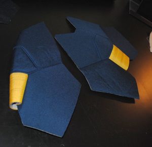

The started with the sleeves. Working top to bottom, I fist assembled the shoulders and upper arms. This particualr Wolverine has full sleeves that are primarily blue with yellow details on the upper shoulders and outer biceps.
The yellow accents on the upper shoulders were added and then the stretch segments of the sleeves were set into the upper arms and all of the detail stitching for the upper arms was completed. The forearms were then assembled and inset into the sleeves.
The undershirt was then built entirely of the navy blue stretch with a section of yellow stretch at the upper front and a yellow collar. The shirt will zip up the back.

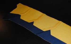

To illustrate how I make a segment with small inset pieces with a lot of sharp angles, I'm showing this piece back to front. When confronted with these types of pieces, I usually cut my mock up apart directly off the muslin and don't trace them out, omitting seam allowance from the actual cutting patterns. I then trace these patterns onto the back side of the fabric and cut the pieces with the seam allowance added in.This way, I can see very clearly where the actual finished stitching lines are supposed to be as well as all the pivot points for all the angles. This image shows the yellow segments being inset into the rib section.
Once all the sections are inset and trimmed, the yellow segments were backed with 2mm craft foam (tacked down with Super 77) and then the entire piece was backed with headliner foam (also set down with Super 77).
