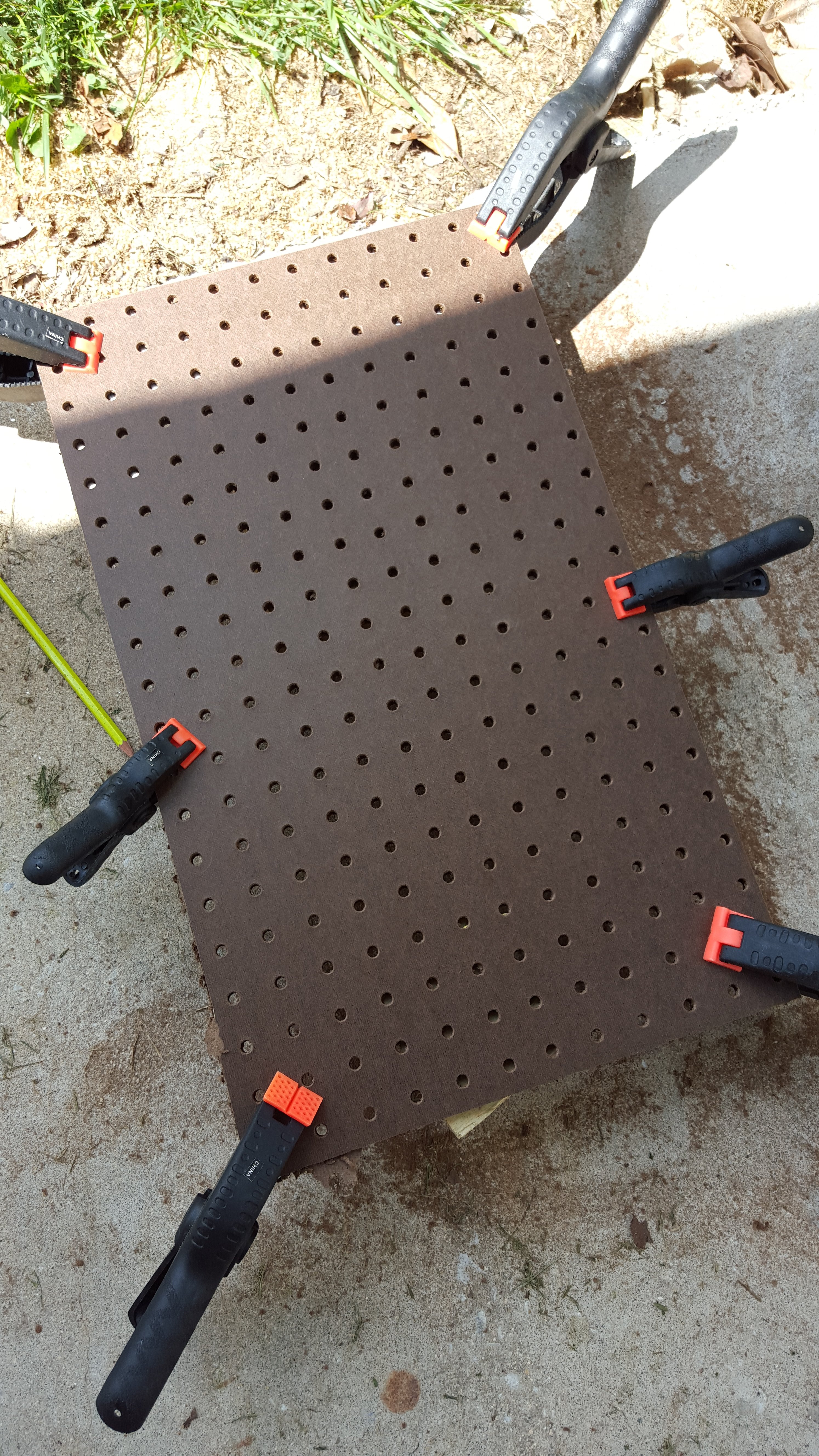

I started with a wooden pegboard. I then cut it down into two 11 7/8" x 19 3/4" pieces. I then glued them together for added strength. This piece is called the "motherboard". The film motherboard (and many replicas) is made out of metal. That's both expensive and heavy. I found that the pegboard would work nicely because it had pre-existing holes in it for the screws I'd use to attach other parts.
After the glue had dried (thank goodness that it's a hot and sunny August day...) I painted the pegboard with silver spray paint. I wanted to get the metal effect without actually using metal.

That motherboard is the only part that's struggling me. But I'm sure after I get that piece, cutting the Hammond boxes will be a challenge. I have no tools!
Cut the mother board out of wood. Paint it silver. Draw the "holes" with a Sharpie Marker. Or use a peg board.
Yeah, that was my struggle too! The pegboard is working wonderfully for me right now. It's really versatile! I was messing around with it, and I can move my tackle box to whatever side I want without worrying about drilling any new holes.
