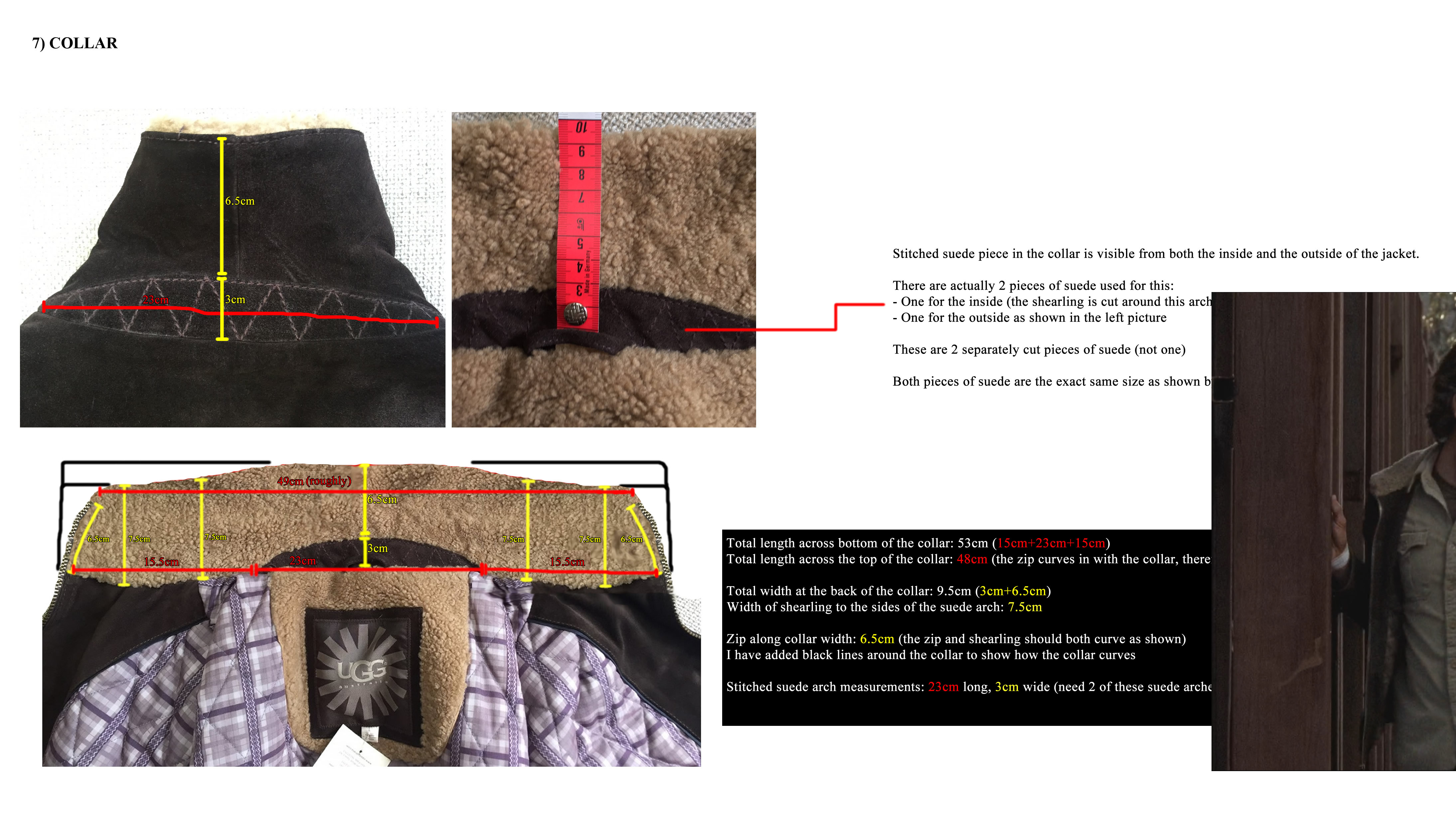

Nope. There's no fur or anything like that. Just the suede arches.
Are you able to confirm what accidental said? 21 teeth (teeth that are visible) from the start of the collar? What length of shearling does that equal to along the zip? And then how much extra shearling do you think there needs to be for the fold over part by the zip?
Is that just the one layer of suede too I'm guessing? It's not a separately cut arch for the inner one haha. I'm guessing the shearling was just cut to have that arch in it.
There are actually two layers of suede: one on the inside and one on the outside, but no fur inbetween the two layers of suede.
21 teeth only measure 6 cm. Add to that extra fur that gets folded over and you get 6,5 - 7 cm along the zipper. Remember that 21 teeth may be visible, but underneath the fur that's folded over the zippers there are more zipper teeth present. I think 28 teeth is the safest one to choose, especially when you consider the fact that in that picture the collar doesn't have as much extra fur folded over the zipper, whereas in the second picture you can see only 21 teeth, but also quite some fur covering the other teeth that are underneath. 28 teeth measure 7,5 cm along the zipper by the way.
Note that because the collar gets folded inwards and the edge gets a curved shape and part of the zipper disappears underneath the fur, the actual length (when measuring straight) becomes less. You'd end up somewhere around 6,5 - 7 cm which is perfect IMO.
21 teeth only measure 6 cm. Add to that extra fur that gets folded over and you get 6,5-7 cm along the zipper. Remember that 21 teeth may be visible, but underneath the fur that's folded over the zippers there are more zipper teeth present. I think 28 teeth is the safest one to choose, especially when you consider the fact that in that picture the collar doesn't have as much extra fur folded over the zipper, whereas in the second picture you can see only 21 teeth, but also quite some fur covering the other teeth that are underneath.
Okay, so for the stitched arches, I'm guessing the inner arch was a separate piece of suede cut into an arch and then they sewed once (from which side? front or back? Or doesn't it matter?) to attach the inner arch to the main suede back? Would just have to make sure the inner arch is well fitted into that gap in the shearling, otherwise it might look odd being able to see that it's a separately attached inner arch suede piece.
And in relation to the zipper along the shearling, yeah that makes sense, although it depends if we can explain how to do the shearling folding over part, that's one of the main things I'm going to struggle to explain, even in pictures.
I'm happy now that the back shearling is 6.5cm above the arch, and that it then comes round to about 7.5cm on the front, just depends how we go forward with either folding the collar over or just having the collar cut by the zipper into a curve, we could achieve the look of the 28 teeth zipper picture relatively easily I think by just cutting the collar into a curve by the zip. It doesn't look like the shearling is folded over much as you say.

(I guessed 48cm for the top of the collar due to it curving in - that would mean it curves in by 2.5cm on each side)
I have also had a reply from Suzahdi saying they will make another sample following Razors measurements (I made a new Imgur album with the measurements - with a few tweaks - http://imgur.com/a/dqasZ )
They have also said they will look for a thicker brown lycra but that it would take more time (which is fair enough) - I have also sent them pics of the lycra of the real UGG jacket and a good reference pic of Rick showing the lycra colour - hopefully they can find something a bit closer)
So they will make a sample following that latest Imgur link and then they can work with scaling it down etc

The top of the collar is much 'pointier' than you point out in the black outline. Here's my take on the collar.
I understand nladyman's concern, but I don't think Like Mike is that much off. I jus remeasured the collar to be sure and perhaps 54 cm is more accurate than 53 cm (at 53 cm the collar edge wasn't completely flat). So 49 cm would be more accurate I think. But really, we're talking 1 centimeter, even millimeters now. I think/hope they get the picture by now.
Yeah yeah the black lines were just meant to be a rough marker to show Suzahdi a right angle, so they can see more easily what has been cut away and the angle its been cut away at. But yeah I shall tweak these things later
Hows this?

The collar looks alright to me I guess.

Not sure we'll get the collar much better than that.
Nice spot with the thread, I'll mention it.
