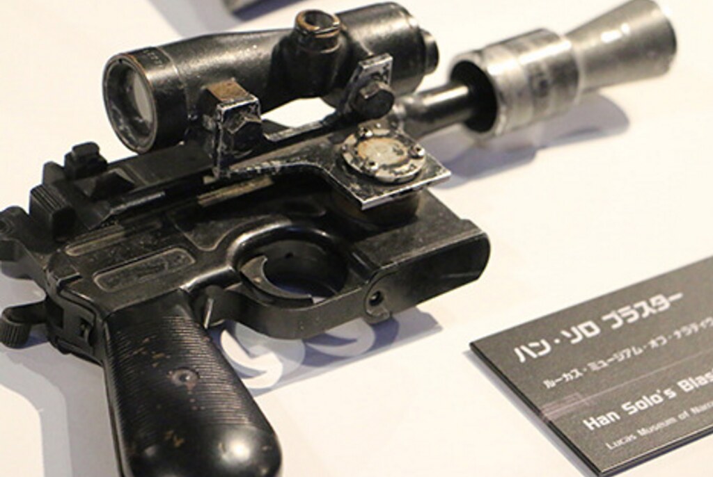

With the bigger knob/cylinder on the scope mount I started going back and looking at something that had caught my eye previously. In looking at different sellers that make Han and Luke holsters, a few different references, some movie stills(but it's really hard to see it), it seems there is a trend that the Luke Holster HAS a bigger, more squared cut out on it vs the lazy "S" curve that Han's has. This would fit the larger spacer behind the mount as well as the cylinder sitting on top.
Maybe the Hoth blaster was made first along with Luke's holster. Perhaps it was intended to just be Luke's blaster, or the only one that was built for/brought to Norway. Since it was the only one brought, it gets used by Ford as well but since his holster hasn't really been modified much since ANH, and with the cold, it just doesn't stay on after a few scenes are shot/reshot. Heck, the part may very well still be out there somewhere lol.

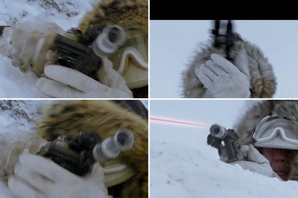

made some screenshots today I'd like to share with you guys. Although the pics aren't quite sharp due to Han's fast movements, you can still see the bronze spacer and the distance between the scope mount and the blaster.

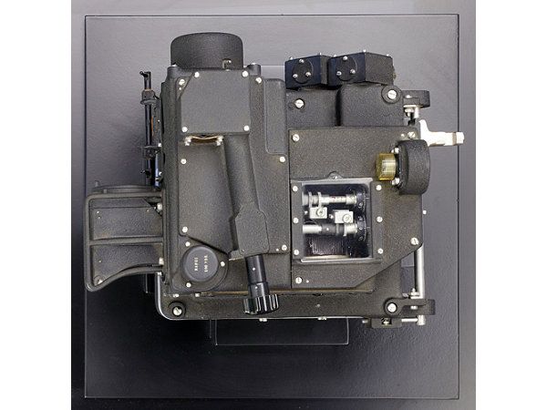

In regards to the disk...
I think it could possibly be from this piece of WW2 era B24/B26 bomber.
Check out this k-3 computing unit. It has disks like this all over it. Not sure about any scaling on here, but it could be a match :thumbs
When we thought it was the Thorens disc, it was inwards.
Now, it appears its one solid flat disc, maybe black paint on the outer rim, and glue from the black cylinder in the center.

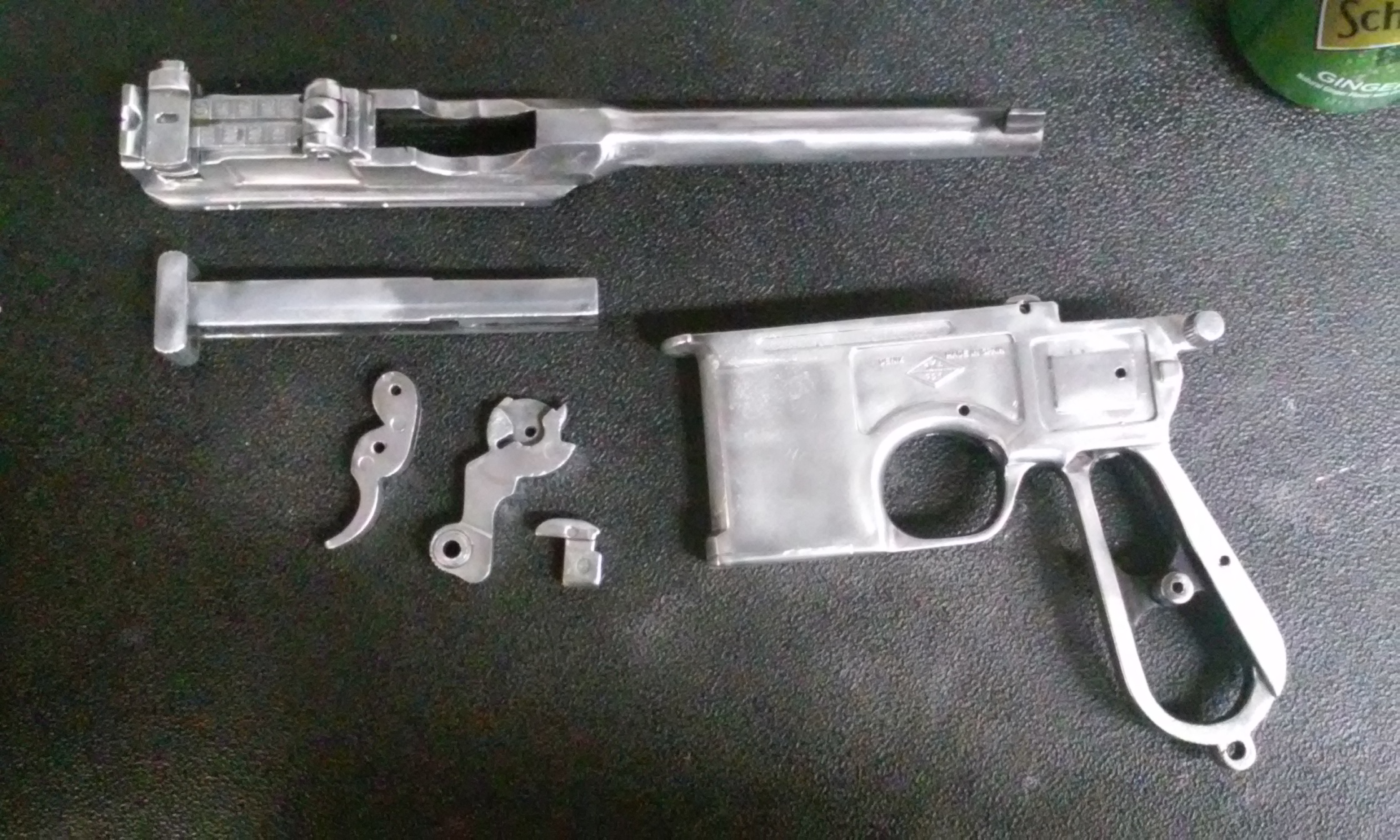

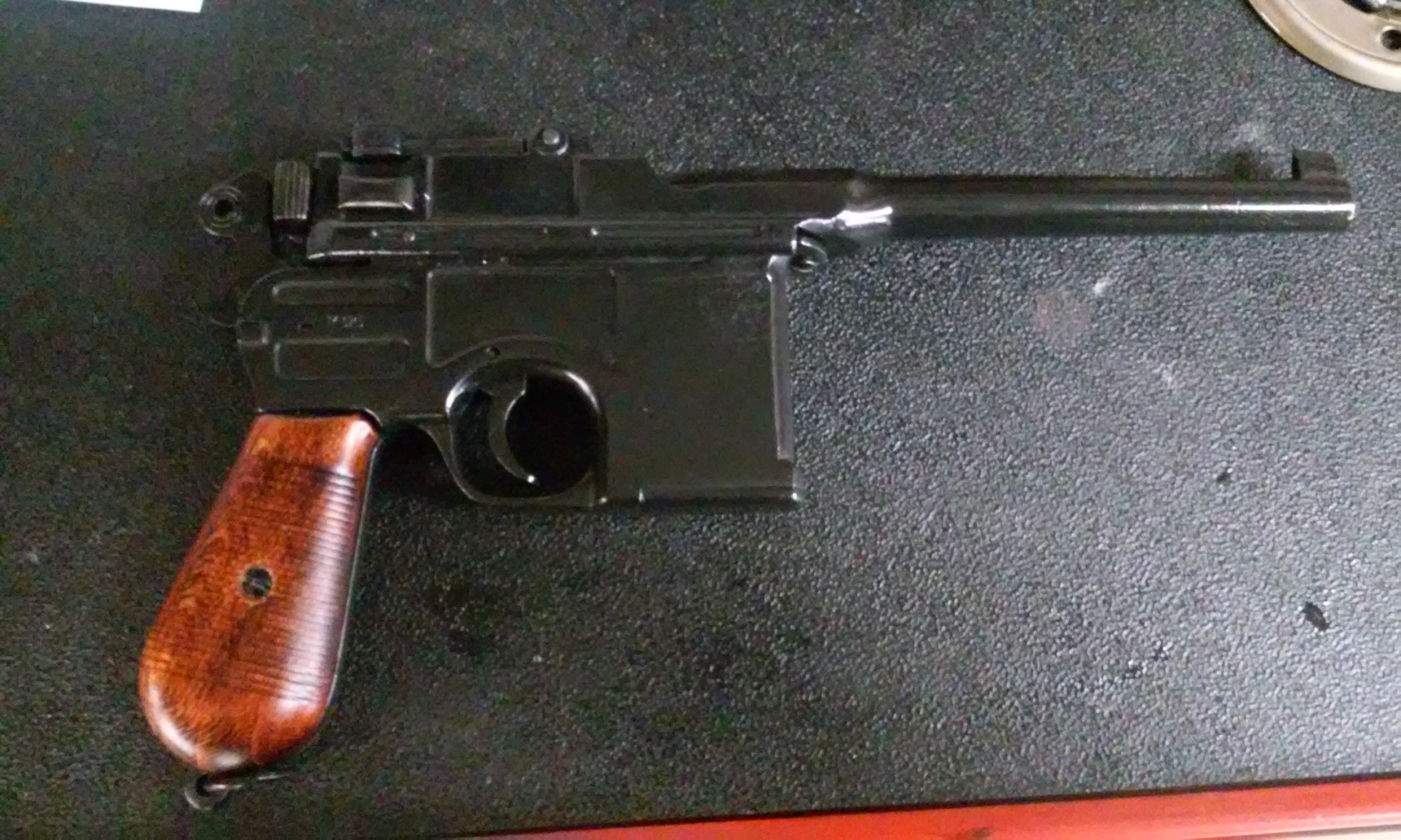

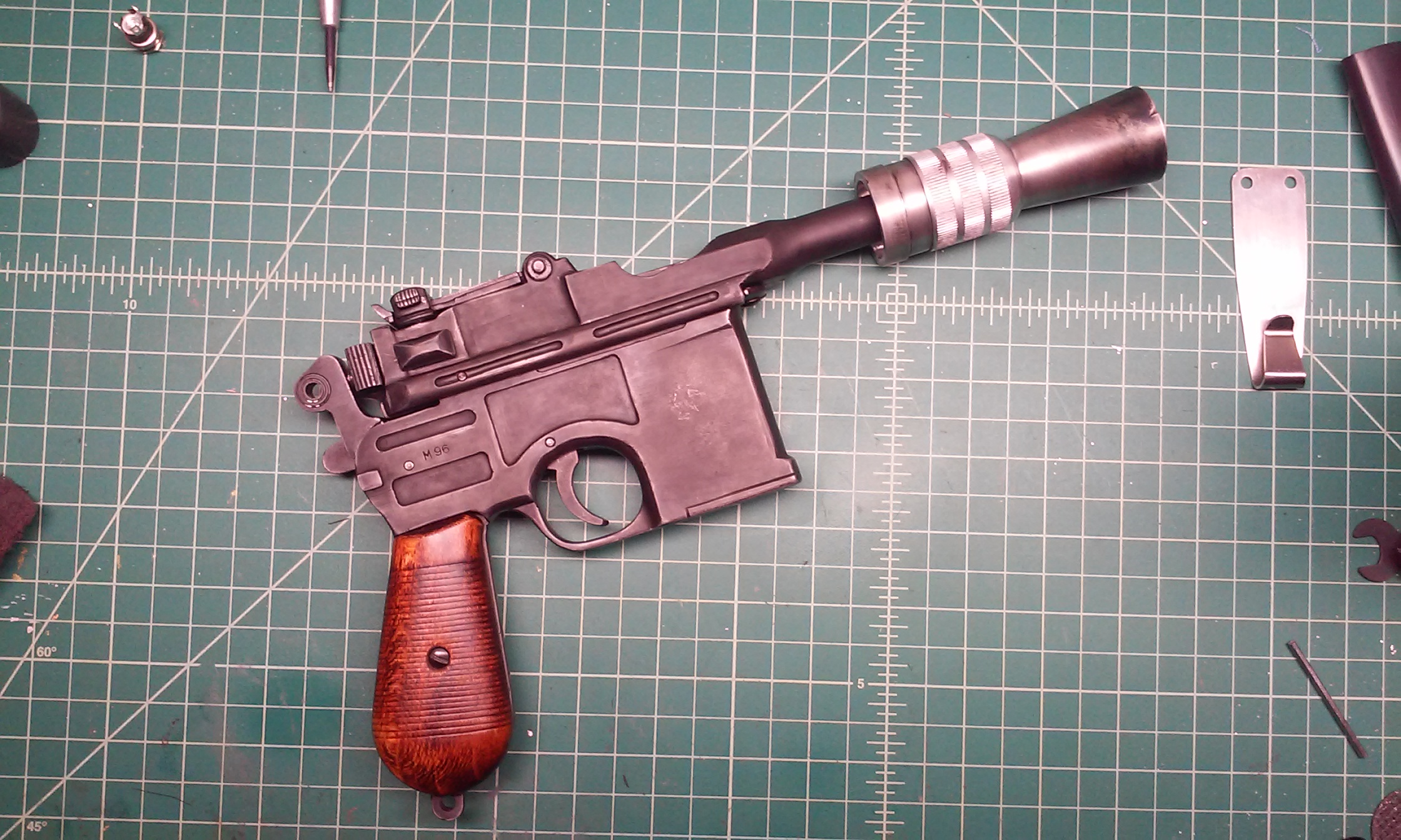

Here's what I have so far - I was unsatisfied with the finish on the Denix so I stripped it down, ground down and sanded smooth every piece (leaving the perfect amount of subtle imperfections). Removed the logo on the left side, added some milling marks and finished the whole thing off with Aluminum Black. Oiled it and weathered it for an true worn, yet authentic firearm finish. I'm going to weather the grips, etch the ejector port detail into the slide and a few other small improvements as well as install full light and sound.
Crappy pic, but this is the Denix straight out of the box. You all know how rough they are.
Here it is after removing the original paint. I haven't sanded anything yet at this point.

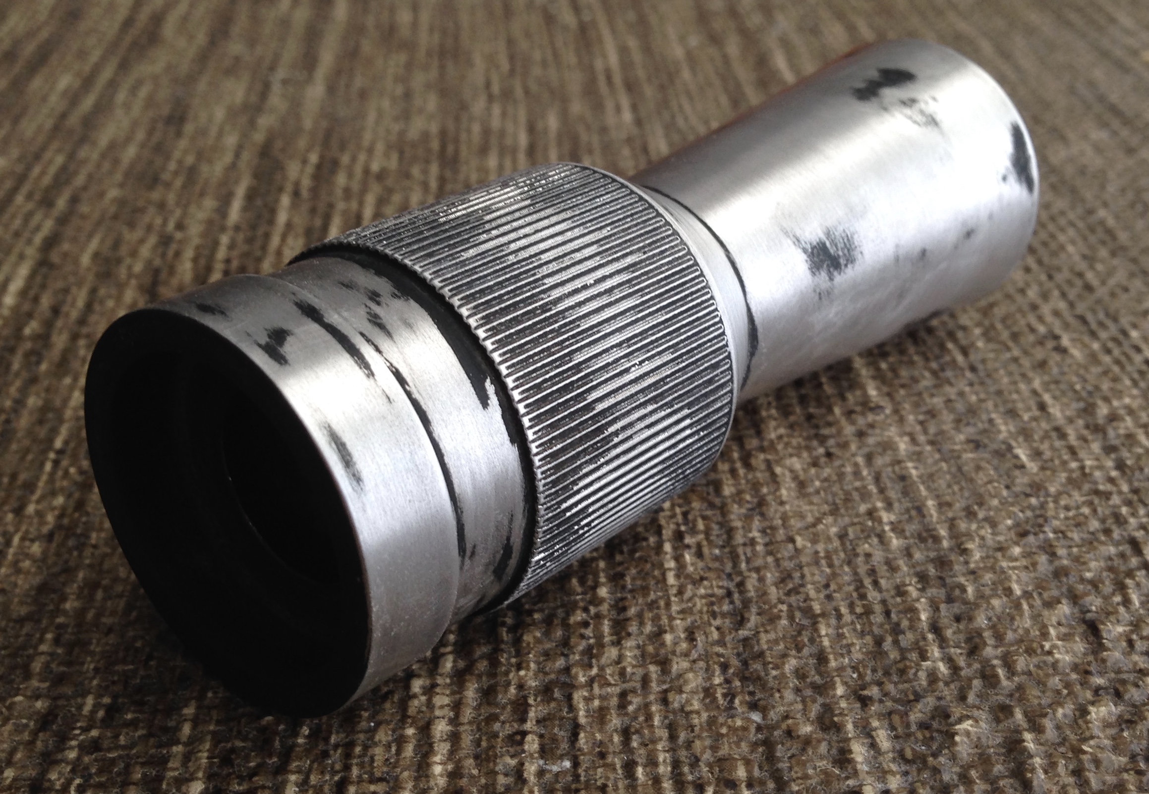

And here it is fully finished and weathered. I added some small "chips" to the muzzle and weathered it with Aluminum black. So far I'm happy with it! The picture doesn't do it justice (my phone camera SUCKS), the finish in person is amazing.

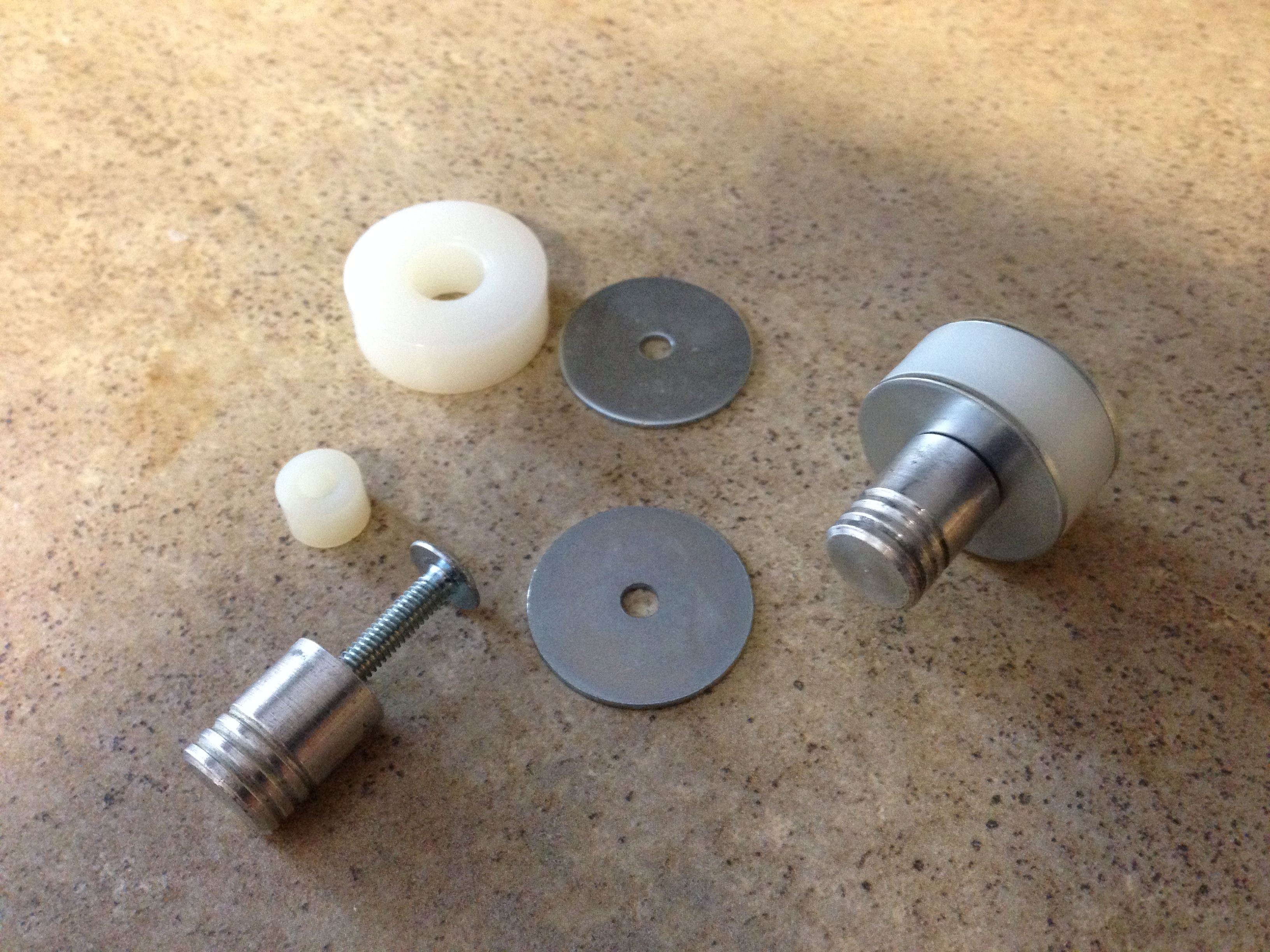

As far as the spacer for the Luke Bespin. I do not know the prevailing thought on it. I have built a few in the past and I have found that nylon spacers from the hardware store work well with the addition of some black paint.
Here is a picture of some 1" diameter spacers I got last week for a different project.
In the picture I also bought smaller spacers to put inside the bigger spacer so the screw going through fits tighter for that project. You could do the same if you felt the need but not necessary as I would suggest you use add glue on both sides of the spacer to keep the mount from pivoting. No matter how tight you twist the bolt, it will move around.
