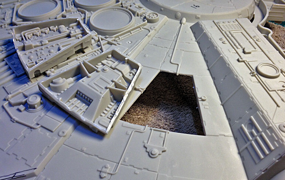

I'm remaking some of the pits:
http://i1119.photobucket.com/albums/k637/jaiteastu/Hasbro Hero Millennium Falcon/IMG_1397.jpg
Still a bit more to do on this one:
http://i1119.photobucket.com/albums/k637/jaiteastu/Hasbro Hero Millennium Falcon/IMG_1396.jpg
Thisis it just set in:
http://i1119.photobucket.com/albums/k637/jaiteastu/Hasbro Hero Millennium Falcon/IMG_1395.jpg
Thanks for looking
John
J, what is the part in green plastic? Thanks for posting your progress, really helping me with my own ;)
Michael
Michael
I was going to ask the same but I ended up researching and IDing it just to see if I could, if I'm right it's an Airfix Panther Tank 1/76 hull.......
Unless you are talking about the 1/76th Airfix Sherman hulls
Hi Michael
That part is from an Airfix 1/72 King Tiger......another wee cheap kit...£5.
It goes as the main part for here:
John
EDIT: Yep HH, A Panther will work as well,....I just knew that the particular King Tiger's hatches could open,....maybe the Panther kits do also
