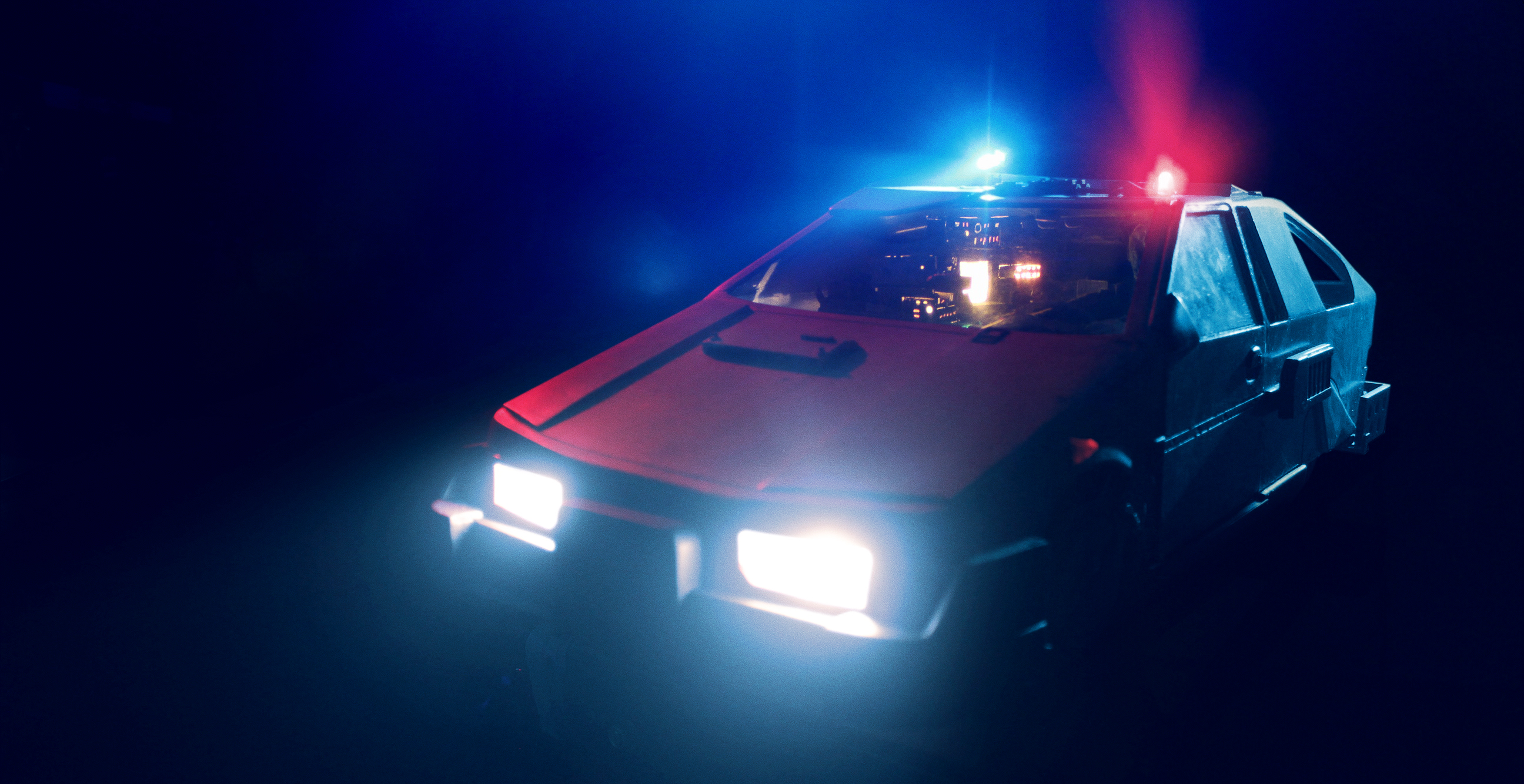

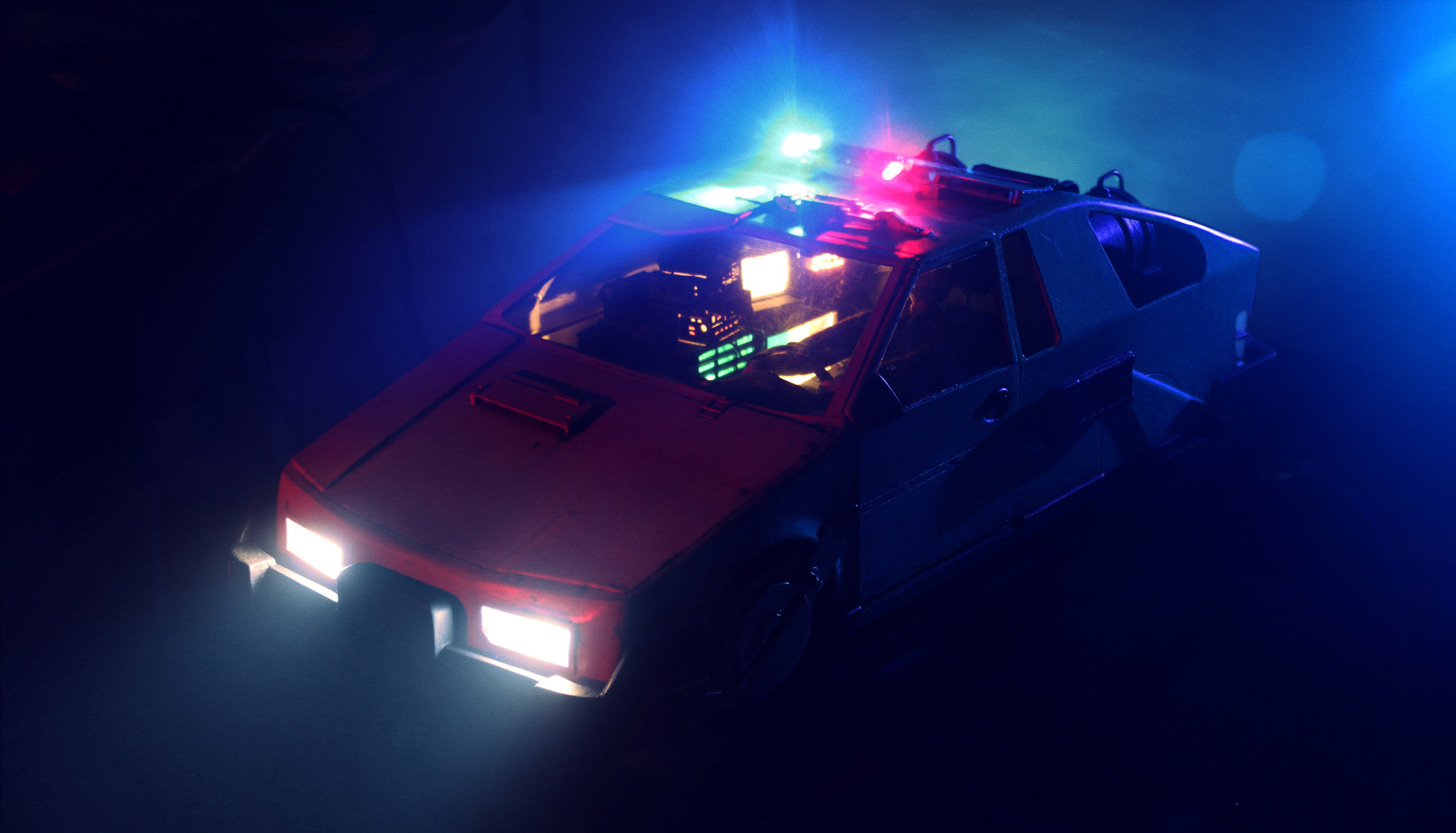

Okay, I'm so happy right now! Today I got my camera back and of course immediately I had to do a proper car test !!! With CHRISTMAS LIGHTS! :lol
And Here it is:
(click for larger picture)
This is the first time I have seen my car like this and I am totally blown off right now! Until now I have only seen it like this in my head. :D This gives me hope... As expected, Twigman is not really seen which is great since he totally sucks, haha.
So, as I said it is illuminated from inside with Christmas lights, and I changed their color from yellow to blue/red/white in photoshop. Everything was warm yellow originally.
My friend will help me connect proper LEDs inside the car some time soon, and we will use correctly colored LEDs to get this look, of course.

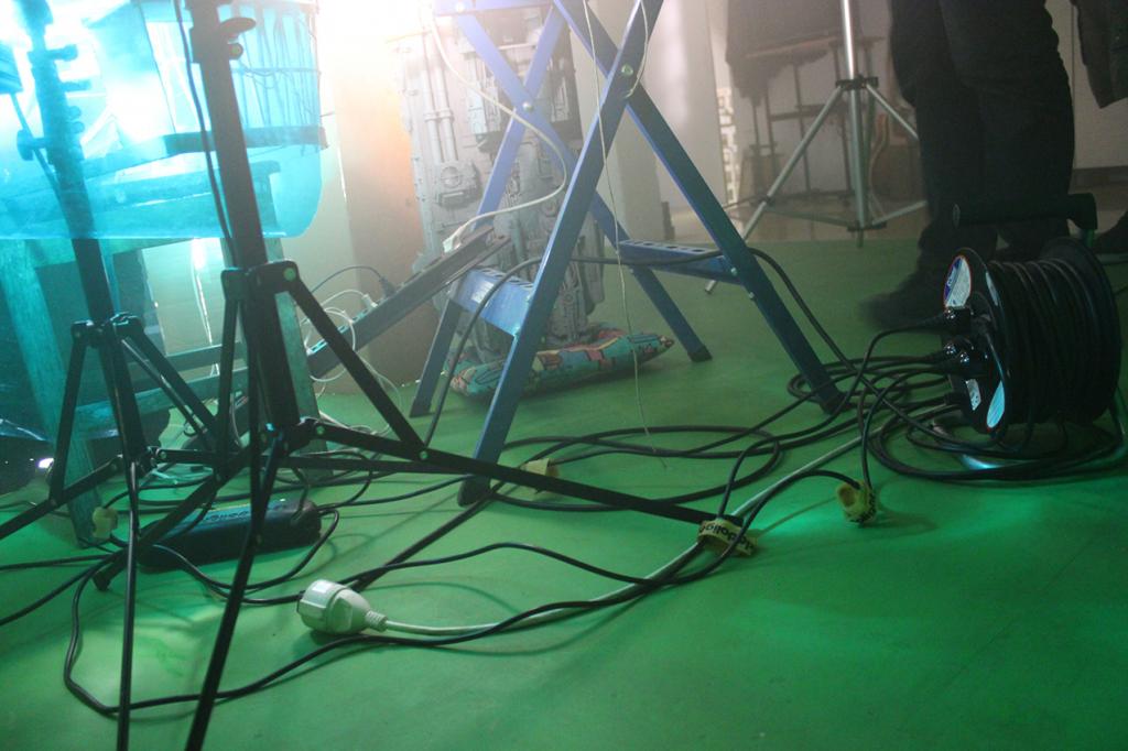

The back side of the setup is not so magical, just a pile of cables:

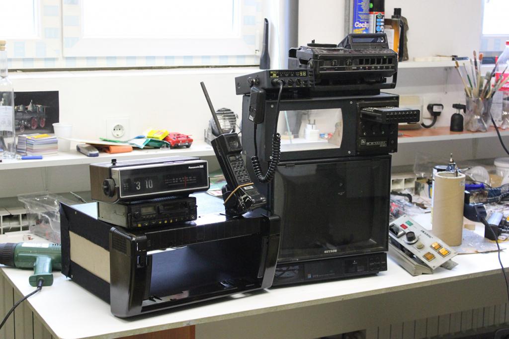

The day we start filming the film is dangerously close! I hope in 10 days we are good to go. Right now we are trying to rent a car that we will film interiors in. We have a couple of 80's cars with satisfactory interiors in mind so we will see. Meanwhile I'm trying to fit together all the monitors/junk that will be on the passenger's seat. So here are a couple of photos:

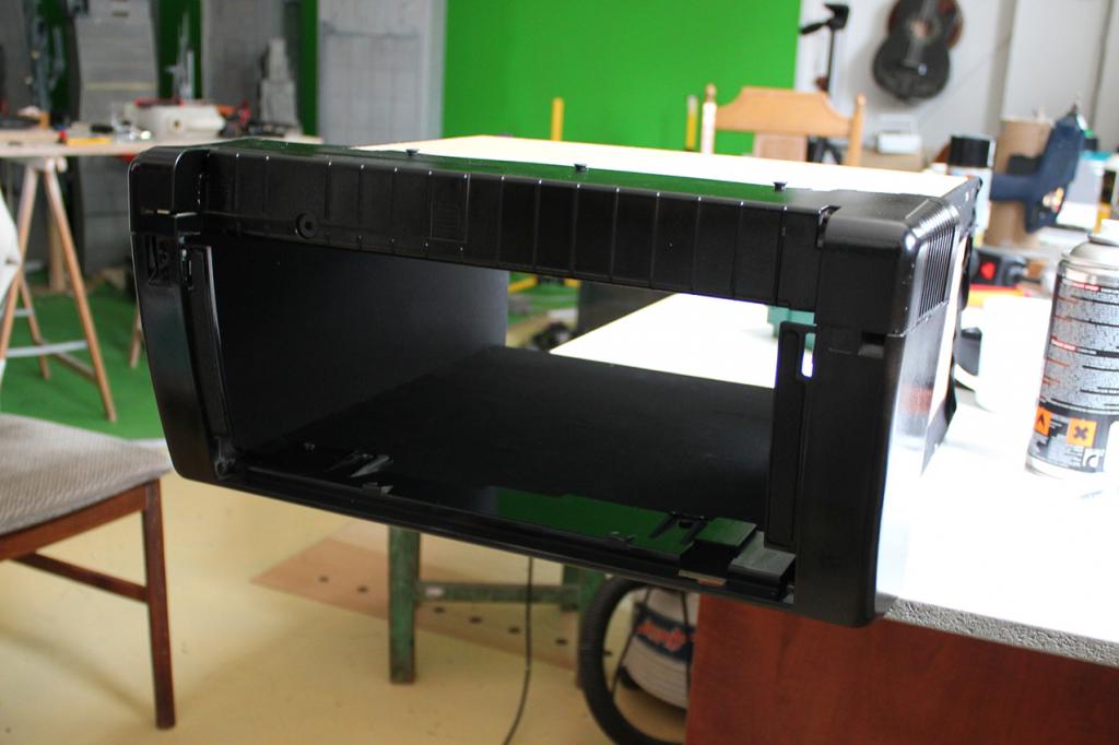

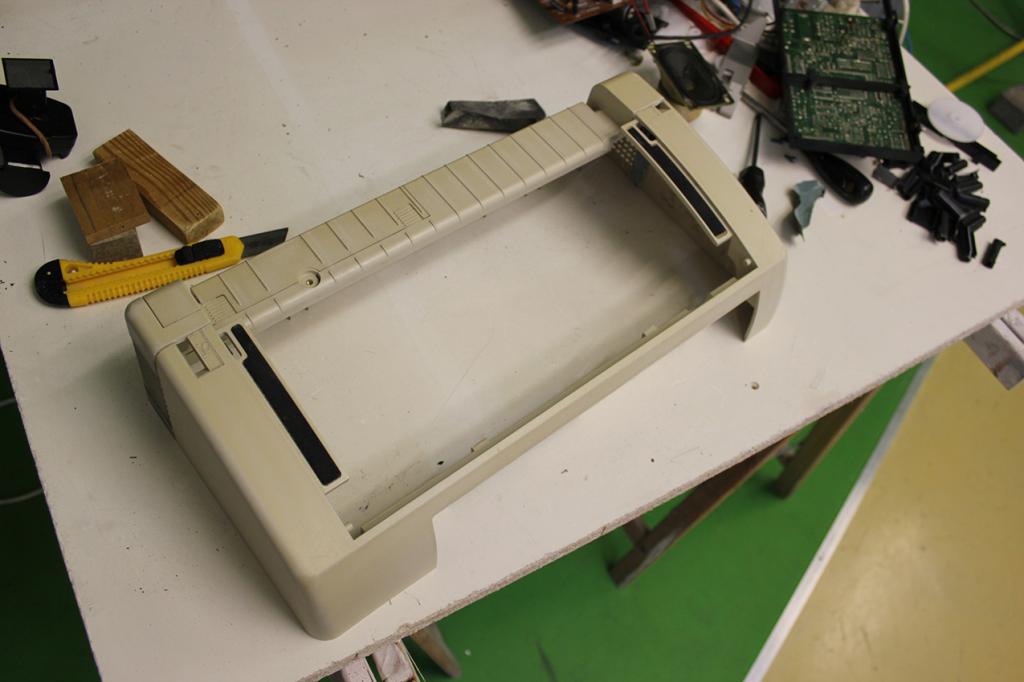

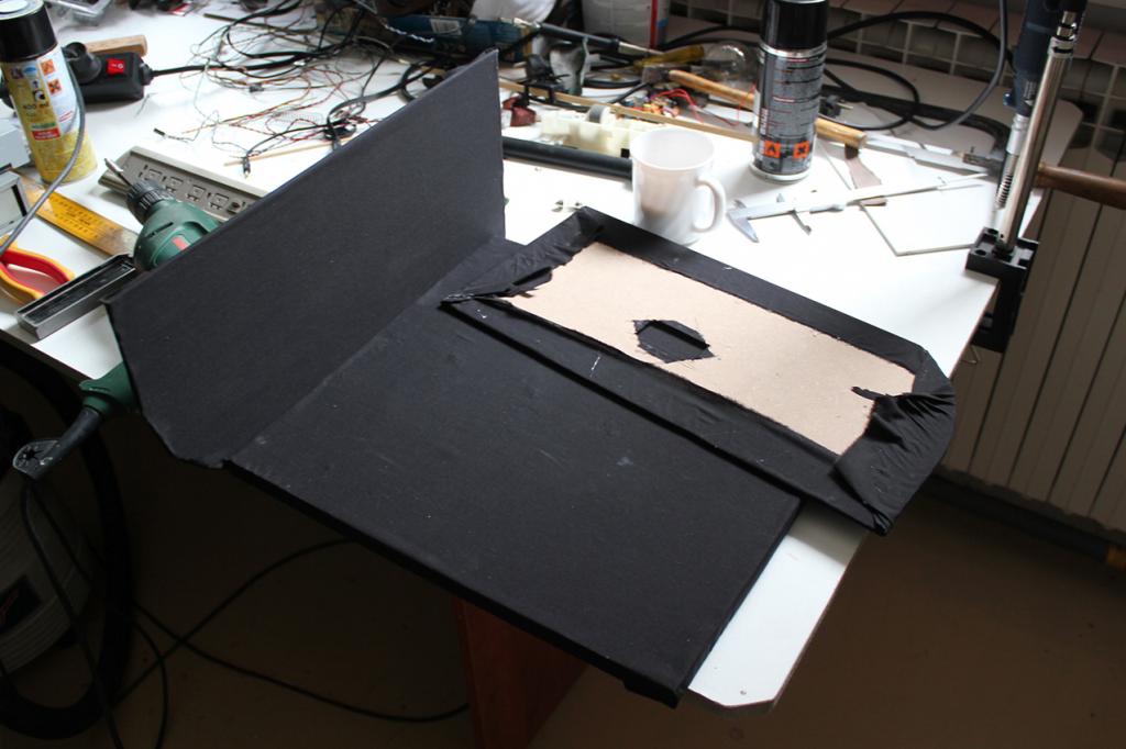

Yesterday I made a glove compartment from an old printer !?!
I built the inner walls and upholstered them:

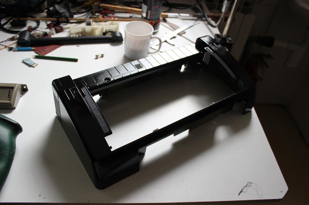

Spray painted the printer:
And screwed it all together. There is also a lid at the front but its drying somewhere..

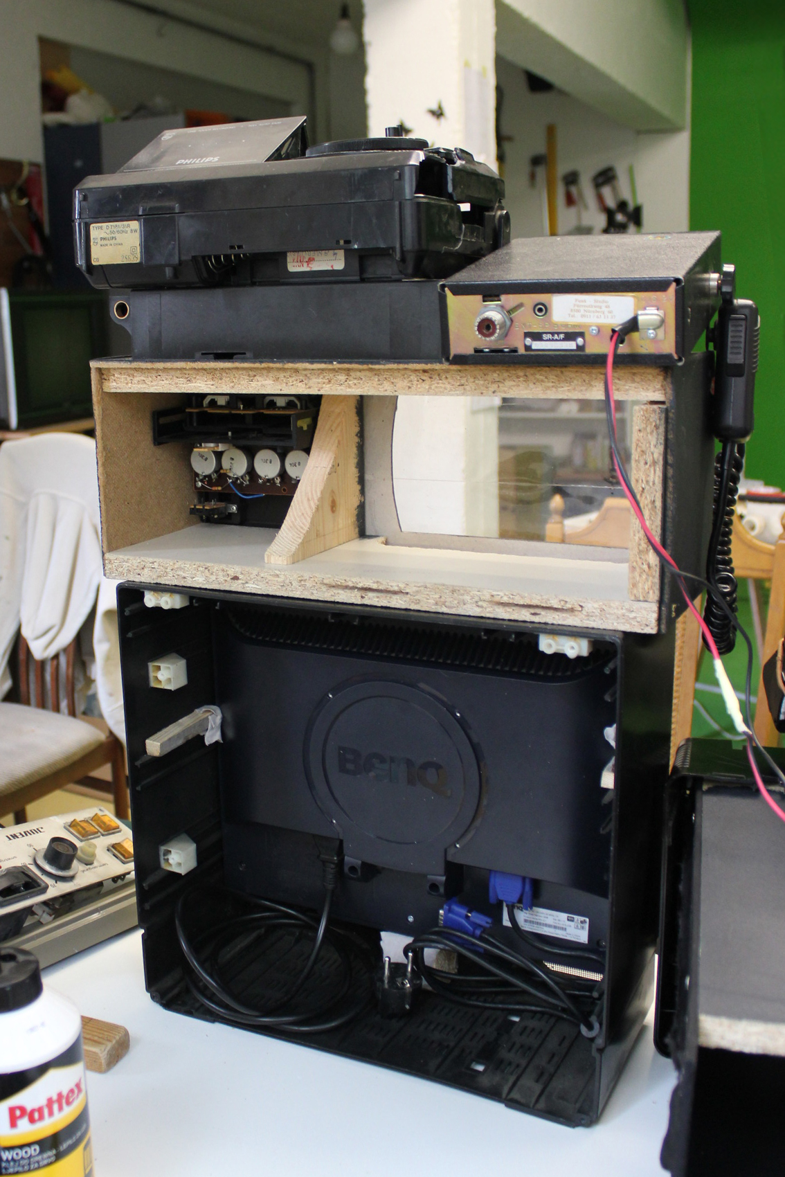

The idea was to build something with the same vibe as the VK or Esper machine. So here is all we have for now:
It's just thrown on top of each other for now, and one more monitor is still missing, but you get the idea. Since none of these old TV's don't work or they don't have the inputs we can use to play our videos through them, we had to fit computer monitors inside empty TV cases. We will also use small LCD displays (for example in that upper wooden case)
