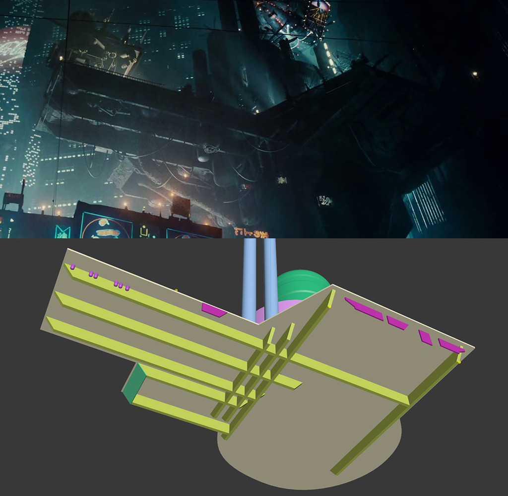

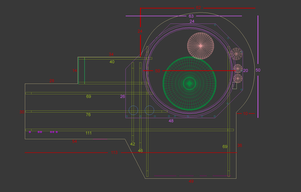

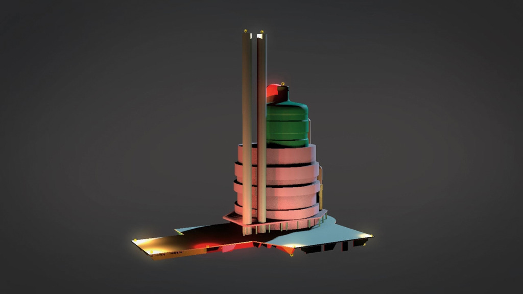

Before we actually started building anything I made the 3D model of the building just to figure where the bigger parts generally go, and to help myself with measurements.
All of the measurements are in centimeters. This thing will be around 2 meters high.

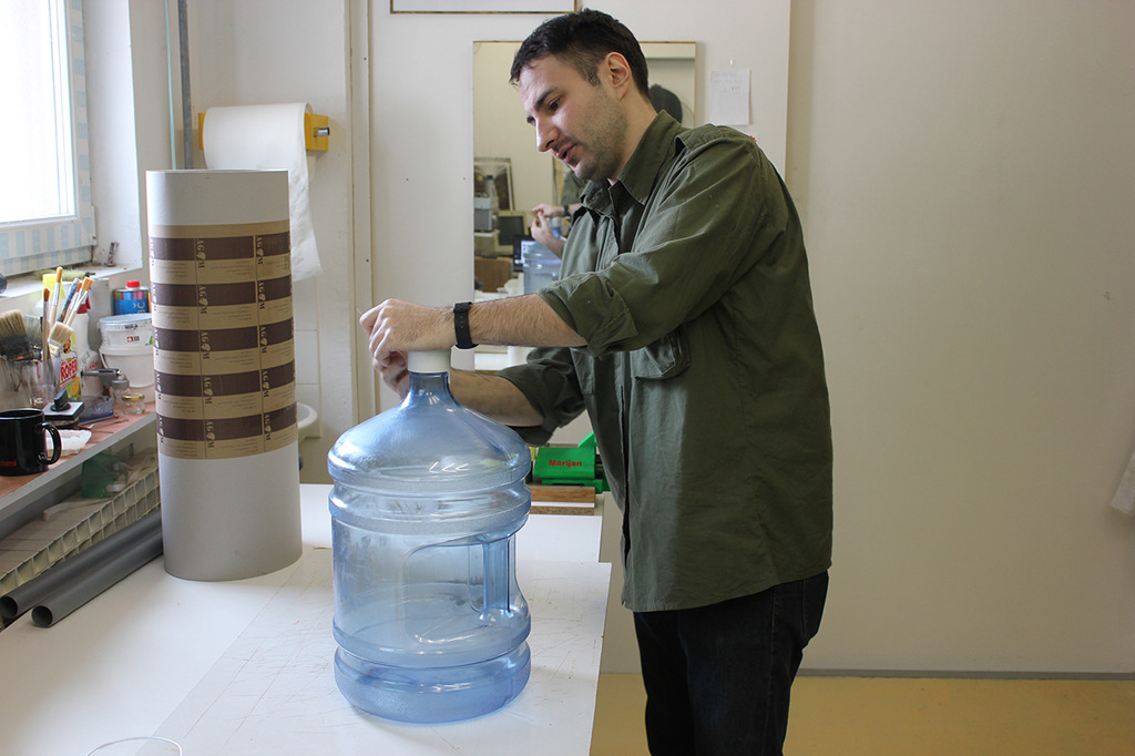

One of the most important and recognisable parts of the building is the water bottle at the top of it. There is no way for me to find the type that was used in US around the 80's so we found something similar. Here is my friend sanding the bottle.

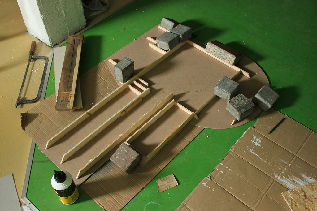

I tried to replicate the underside grid as close as I could:

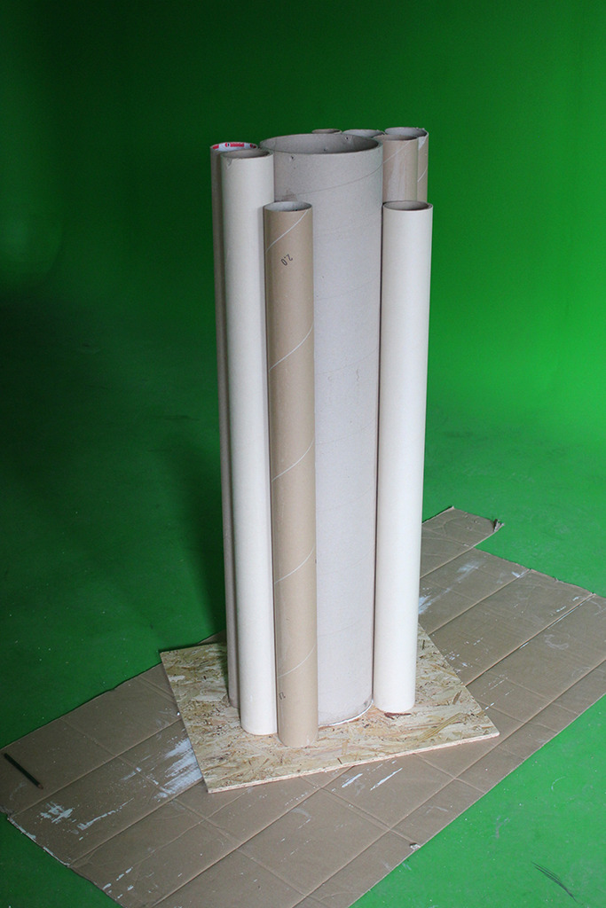

For the lower part of the building we just glued together cardboard tubes, and later we'll dress them with wires and random junk:

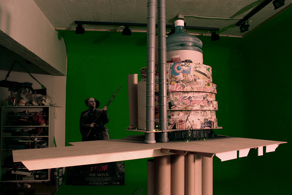

The main part of the building has a lot of levels so we cut them from styrofoam, and covered the sides with cardboard:

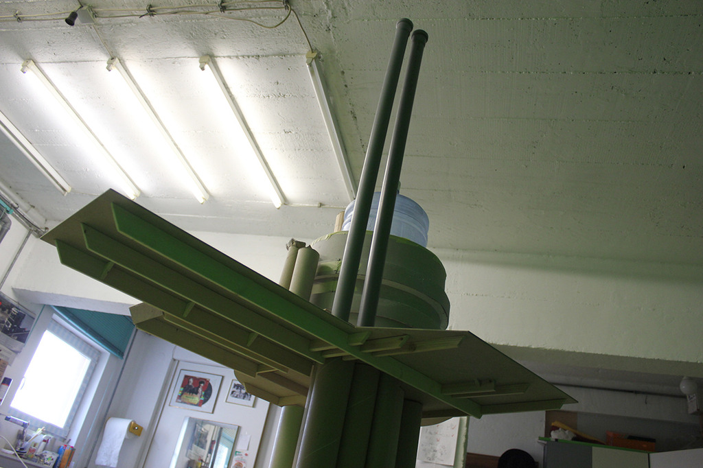

It's starting to take shape:
The last shot for now is not that glamorous... :) Nothing is glued yet so its not at the angle. We covered the main part of the building with paper-mache technique. Water thinned wood glue + newspapers. It is totally cheap, very hard when it sets, and it gave us an uneven texture that the original had on these parts:

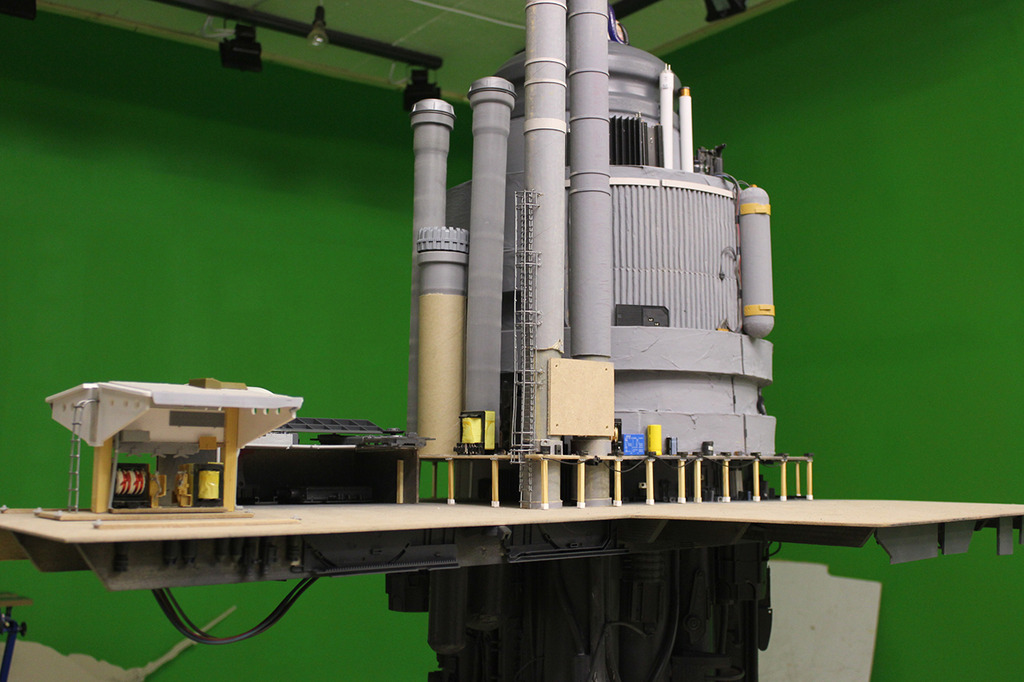

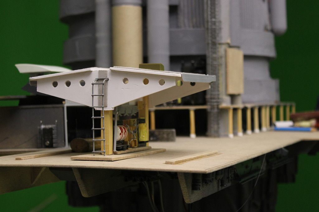

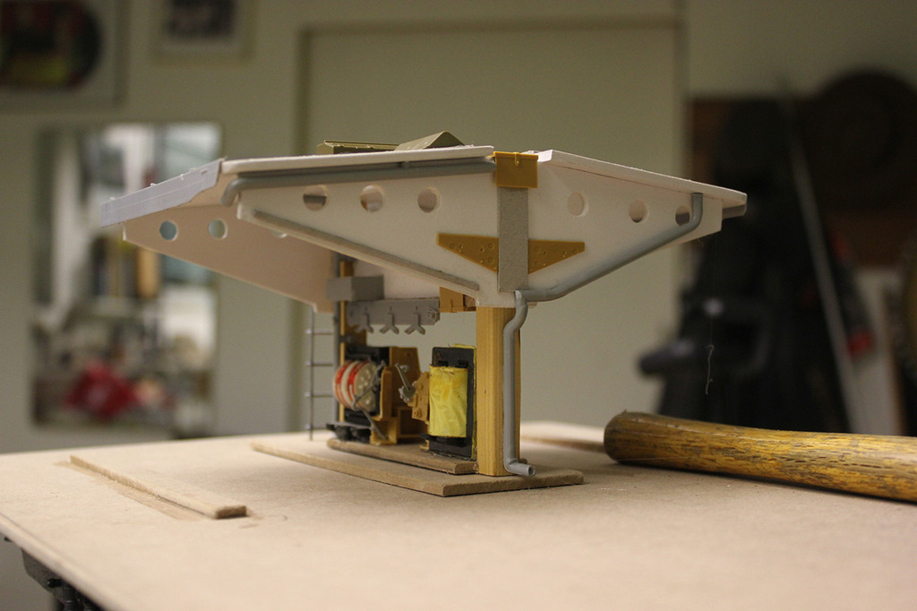

Today I tried to recreate the small "gas station".
Of course, since I'm working from a bad resolution photos, I only copied the main shape and made the rest of it up. It is not finished yet, Ill put some more details, and put the "gas tank" on the roof.
Here is another angle. I used mostly computer parts and some kitbashing from tank kits.

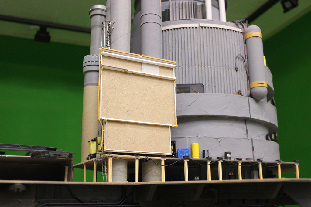

Meanwhile, a friend made the ladder and safety frame for it (google says its called cat ladder??). It leads to the top of the billboard that is not yet attached here. I'm totally sure there was no ladder on the real model but I wanted something interesting in that part so we improvised.. :$ Most of it will be hidden behind the billboard, anyway..
Here you can see where the billboard will go:
And, traditionally, a quick christmas-lights-test-composit for the end of the post :). (The gas pump will never be this close to the camera in the film) Its amazing how much the lighting matters. You can get away with anything with good lighting. (Which comforts me :lol)
That's it for now.. Another couple of days of detailing, and then paint.. I'll post when I have something new.
