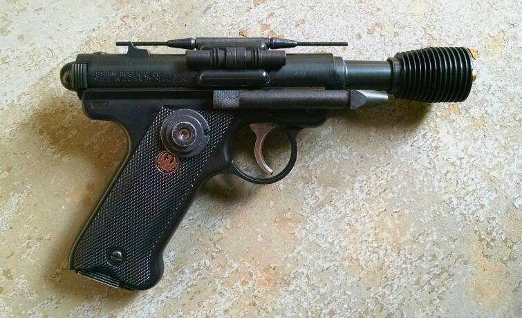

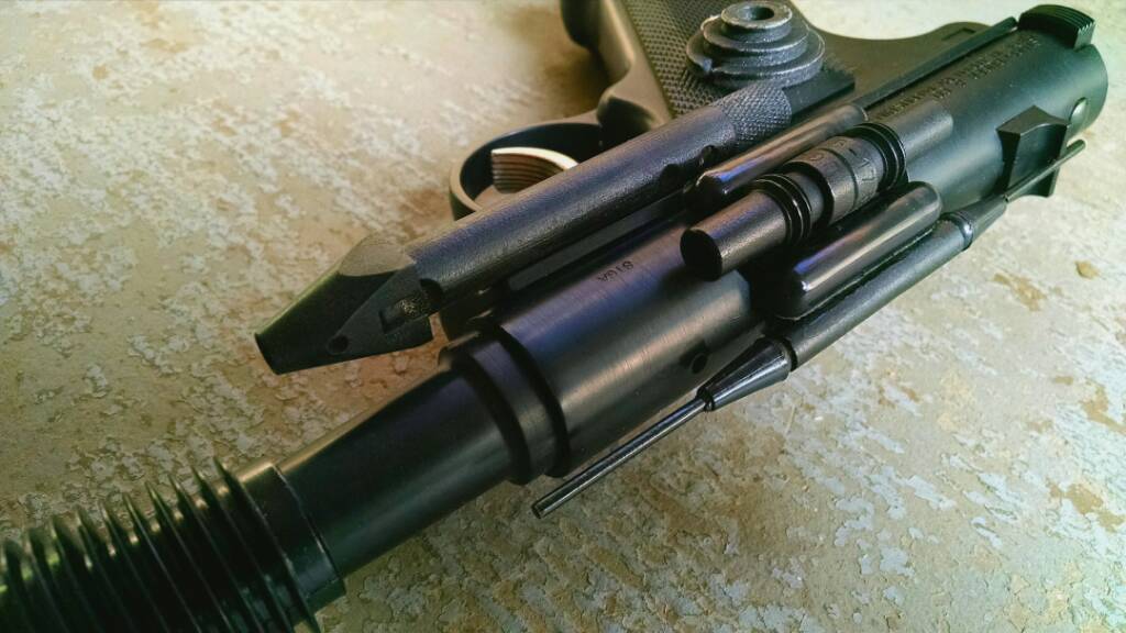

Does it look to anyone else as if the transrotor connectors are rotated 90 degrees on Greedo's gun from their orientation on the Jawa gun?
What's everybody seeing as far as orientation and placement of the whole "missile" assembly?

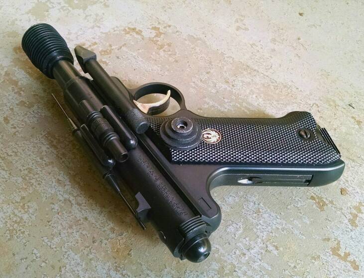

Here's what I'm seeing on Greedo's gun.
Also, I think the connectors from Shapeways are too short.

I drilled into the bolt and threaded 8-32 for the cylinder cover, tapped the plugs and threaded them together with 1/4-20 all thread, then cut a small divot into one side to sit on top of the screw head holding the cylinder cover to the bolt. Glued that sucker down.
Used a fellow members idea for the push rods, cutting the stems off, drilling, and using a brass rod through the entire assembly for rigidity.
Also, to mount the stylus brush rods straight, I cut some thin lengths of sheet styrene, glued them to the receiver, then glued the missile assemblies to them. Still not 100% sure on the orientation of the stylus brush rods (holes facing up/down vs facing out sideways) and the transrotor pieces (which I believe are too short). When we know for certain, I'll likely find a more rigid way of affixing all these parts. For now, I've got everything set up as I'm seeing it in the (tiny, blurry) reference photos that we have.

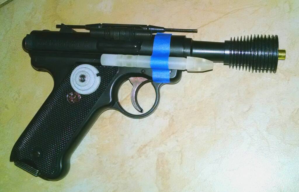

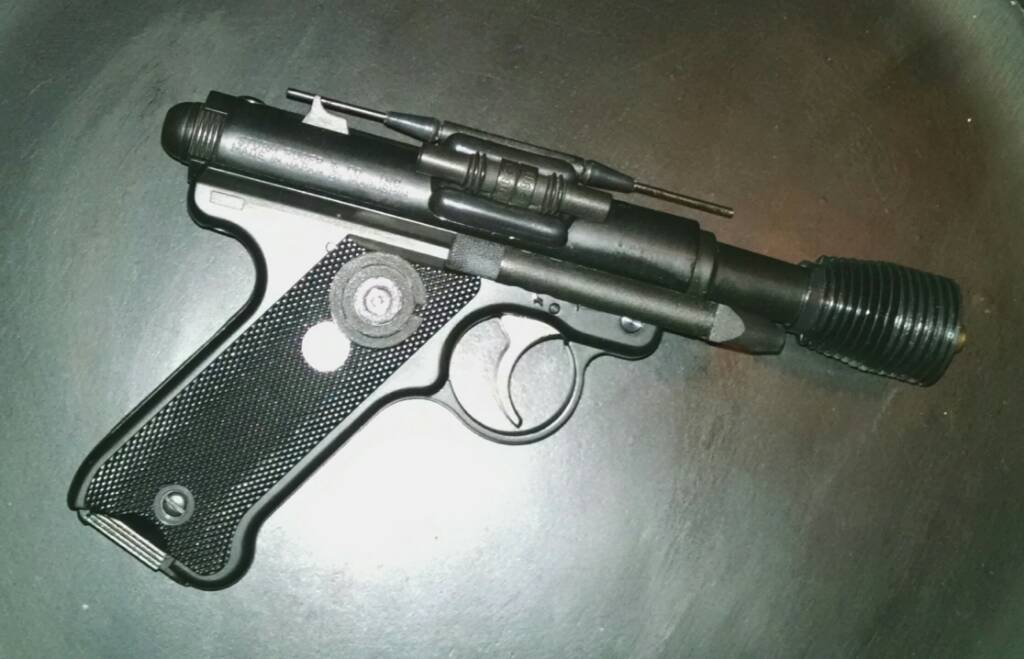

I'm just starting with my Greedo Blaster Build using an airsoft Ruger,
just gathering parts at the moment, was going to just use what I had laying around the house but figured if the Mitchell parts are on shapeways I'd rather use them than a pen :lol

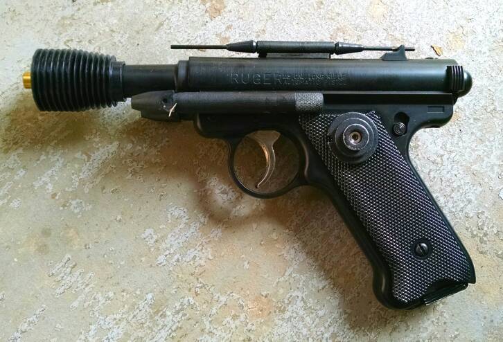

I know good pictures of this blaster are scarce especially the left side but I was wondering what people are doing on the left hand side of their blaster builds?
I've been looking through build threads but can't really find pics of the left side of peoples blasters

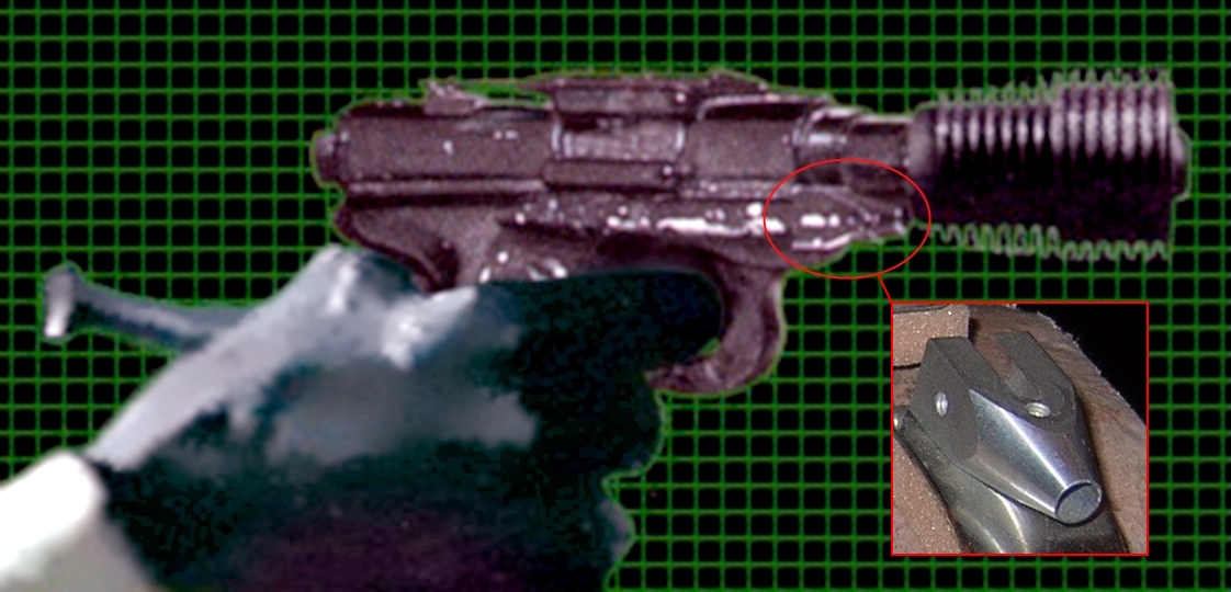

Dann, it looks like you need to rotated to the trans rotor piece so that the cut out area is on the outside. It can be seen in these reference photos. Also looks like you may need to move the whole rocket assembly back a little bit. Just my opinion base on these photos. Hope this helps.

But that's the jawa version. If you read my previous posts, I'm saying that on Greedo's gun it looks like those parts are oriented the way I have them. Look carefully at the photo with George where Greedo is sitting.
The way the light is hitting the transrotor part is showing me a curve, hinting that they're turned 90° from their position on the jawa gun.

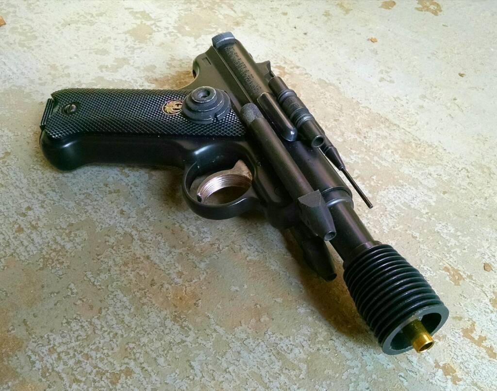

Here's better photos.
uploadfromtaptalk1406934717573.jpguploadfromtaptalk1406934724052.jpguploadfromtaptalk1406934731656.jpguploadfromtaptalk1406934738691.jpguploadfromtaptalk1406934745863.jpg

Actually that second photo is a photochop job. It's just a picture of the jawa gun with Greedo's hand pasted in. That's from the partsofsw site. It's the exact same photo of the jawa blaster you posted, just rotated, and the muzzle is also photo shopped in.

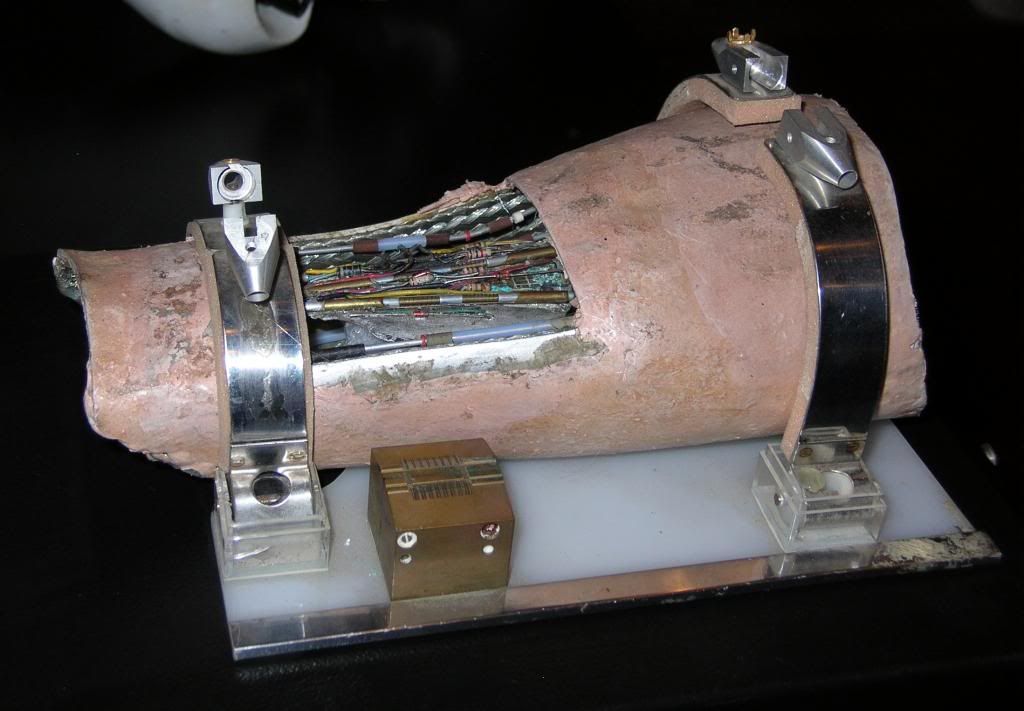

Also, regarding the trans rotor parts, if you go back to the first post, I'm looking at the photo of Luke's arm. I think the correct trans rotor parts are the ones on the right, further up his forearm. They're slightly longer. The ones at his wrist are the ones you've replicated. From comparing the photos, it looks like the ones on the right are a touch longer, and I believe those are the correct ones.
I'm sorry, I didn't put it together at first that these were your work. I think you've done a darn great job with the parts, and I'm happy with them. I'm just trying to get it right, as are we all. If you end up making new trans rotor parts, I'll happily buy those, too. It would be awesome if you also made the sweep arm part that sits at the butt end of the missile assembly.

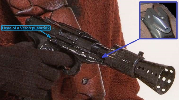

The two larger fittings appear to be one of the parts previously making up the 'missile'-like pieces that are cast into both sides of Greedo's blaster:
2oasfoedit_zpsa81715b9.png~original
-Carson
