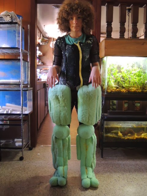

Currently this is where the body is at--still need to add the third toe finishing on the center, the torso and fix the toes connecting to the shoes a bit more. There won't be any foam on the arms and the mesh will be cut shorter before it's finished but it's left as is for now.
Lol...kind of embarrassed at my horrible zipper but luckily the front is going to be covered in feathers so it won't be noticed. At least, not much. You can see how the bottom of the toes still need adjusting before gluing on any velcro. And how the third toe toward the middle still needs adjusting, I've made the clay claw for those myself since I wasn't fond of the one's Monoyasha sells. Let me tell you about these legs though--my major mistake? Making them too tight! I have to sit down and yank 'em on and it takes ages. I have little zippers in the ankles on the back which is a good idea imo but it's too tight.

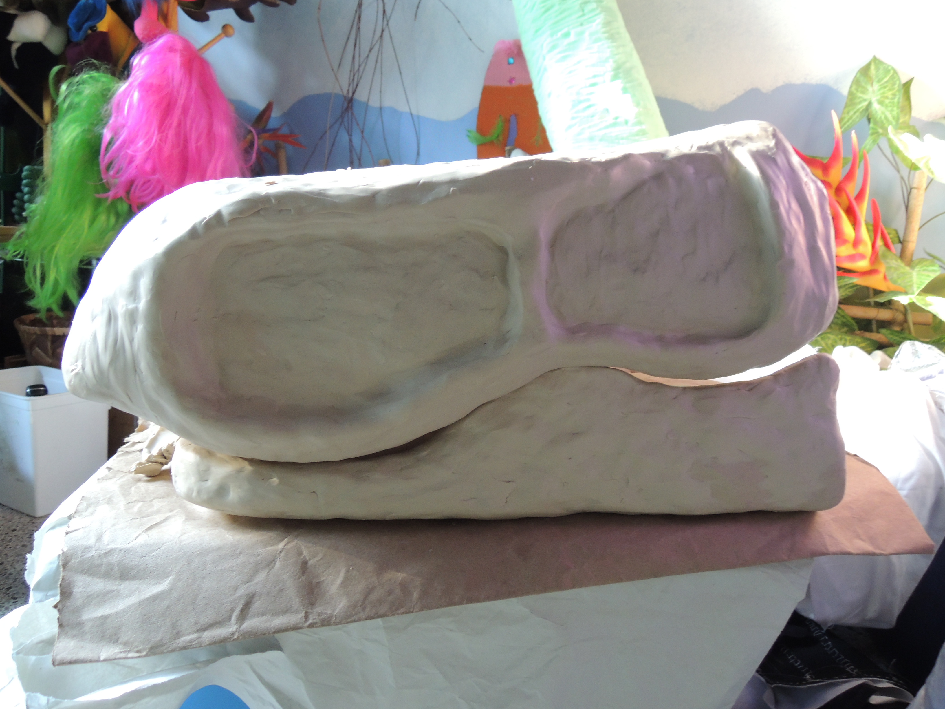

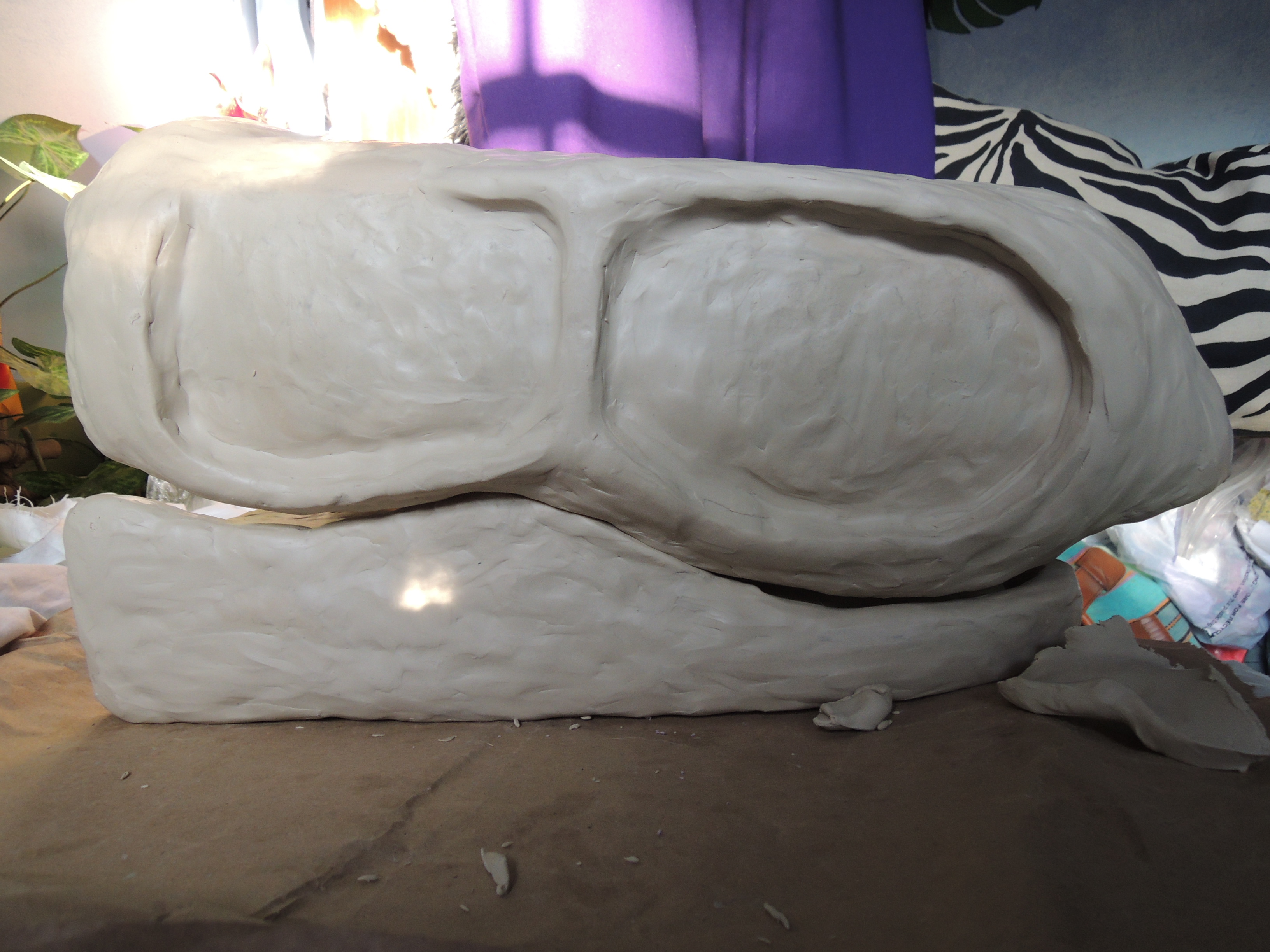

Annnd it's been a week since I've posted here. I've been sculpting constantly--every day for 5-14 hours. It's a bit excessive and I'm just really slow going, lol. Figured I'd share some pictures. :)
I've actually got a whole lot of sculpting done on the head recently but no pictures yet...whoops. :p
Unfortunately this is the best I have for the lower jaw currently.

I've made slow progress, the goal is to have the head completely fiberglassed by end of this month.
(these images are over a week old--I've worked a LOT on the jawline and the nose area)
I've used 20 lbs. of clay on the head so far and there's also the claw mold in there too I think...turns out I don't have enough silicone, I don't think. Not sure what I'm going to do about that, I have covered the claw entirely so you can't see the clay or anything beneath it but I still don't think it's enough. Either I'm going to have to scrape out the little bit left in the bottom, but if that's not enough I'll have to order more which I'm so not looking forward to since that's $30 a kit. :s
