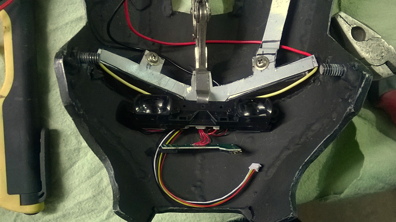

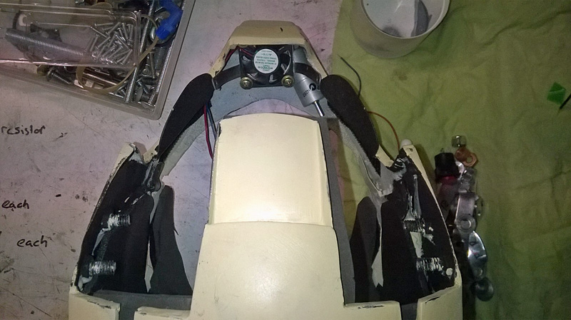

Shuffled things around a bit. Now I can fit a geared motor under the fan. I gutted the video glasses then set them closer to the faceplate so the centre doesn't hit me on the bridge of my nose any more.
The glasses came from Alibaba or ali-express and the camera was from DX.com Model number SKU:234280 US$11.47 - AU$25 landed in Australia.

To provide limits to the faceplate actuation up and down, micro switches provide feedback to the motor.
